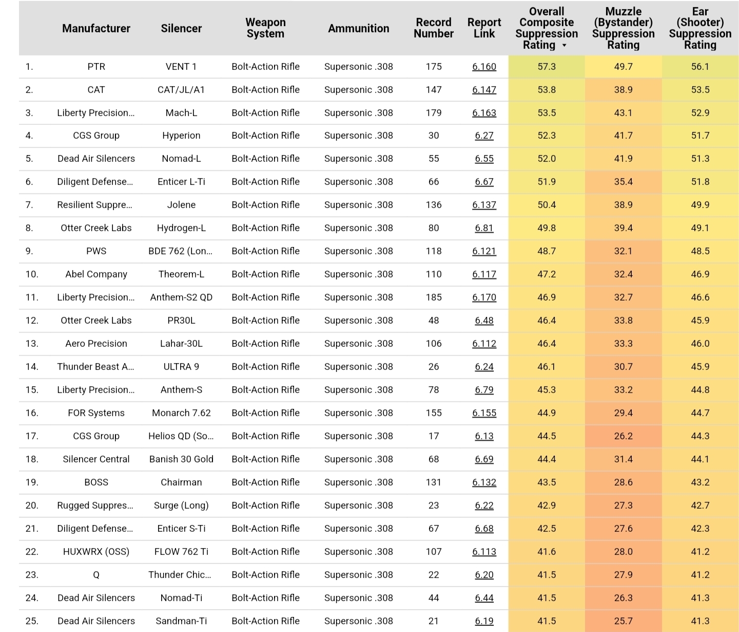

The Q suppressors are much better in sub sonic flow regime. You'd get better suppression from other options with free stamps.

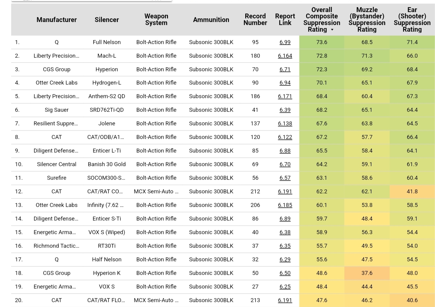

Q is mostly known for their Subsonic stuff and it's what most of their stuff is designed around. Like 300 blk and 8.6 blk. While they will obviously work on other things still testing has shown they perform much better in the subsonic flow regime vs supersonic.
For example on Pewscience testing the Q thunder chicken is below average for it's size on .308, but on 300 blk the Full Nelson (direct thread thunder chicken) is at the top of the list.

It doesn’t perform that well according to PewScience.
