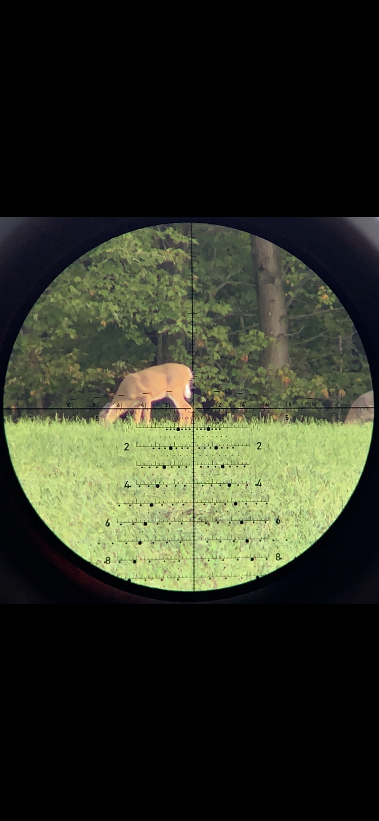

this is the direction they are going
perhaps if you can learn to ignore an H59 except for when you are using it, you can learn to put anything in the back of your mind and pull it to the front when you need it.
when i look through the scope, i am not thinking about all the marks.

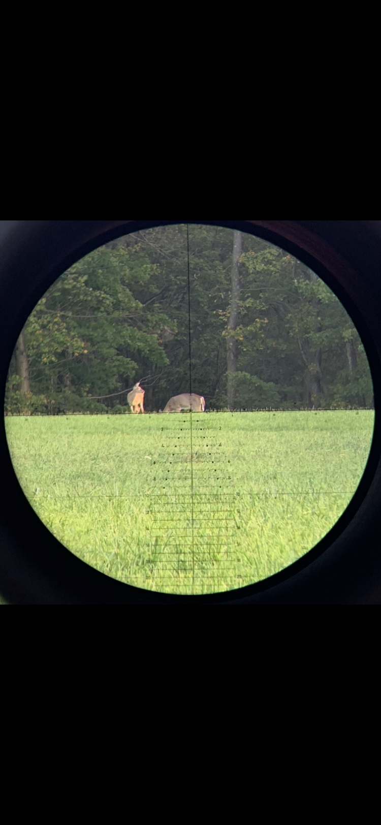

How hateful is the non illuminated tremor 3 for hunting/etc
Depends on how low your bottom end is and what your environment is. My 3.6-18 Mark 5 is admittedly hard to pick up at 3.6 in the woods. My 5-20 Ultra Short is small but usable at 5x. My 5-25 PM2 gets pretty small under 7x. FFP is what it is in a low mag hunting role.
Reactions: deersniper

I don’t mind shelling out for the illumination...I’m curious if anyone has a picture of an illuminated Tremor 3 at low power against a wooded background? To clarify, at low power my concern is the main crosshair, not the grid.
I had the chance to look through the CCH in person and can’t imagine it would be very useful at the lowest power setting, and if I’m not mistaken the main lines on the Tremor 3 are the same thickness at .05 mil.
You’re not going to get bright enough illumination in any magnified optic to be daylight bright without washing out the entire image. Just the nature of the beast. They aren’t red-dots. Fortunately Leupold does their illumination right On the T3, and the entire reticle is illuminated, not just the center crosshairs.
The concern you have with picking up the reticle on low power against a dark background is what has plagued FFP reticles since the advent and is why SFP still rules the hunting market.
My 3.6-18 non-illuminated:

Great pictures, thanks!
