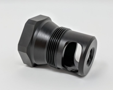

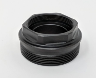

The other issue I have with the 419 system - for the Omega specifically - is their adapter does NOT have a blast baffle. The TBAC adapter does, but the Omega does not. I can't back it up with data, but I personally want a blast baffle as the gas comes out of the muzzle.
TBAC 419
Omega 419
