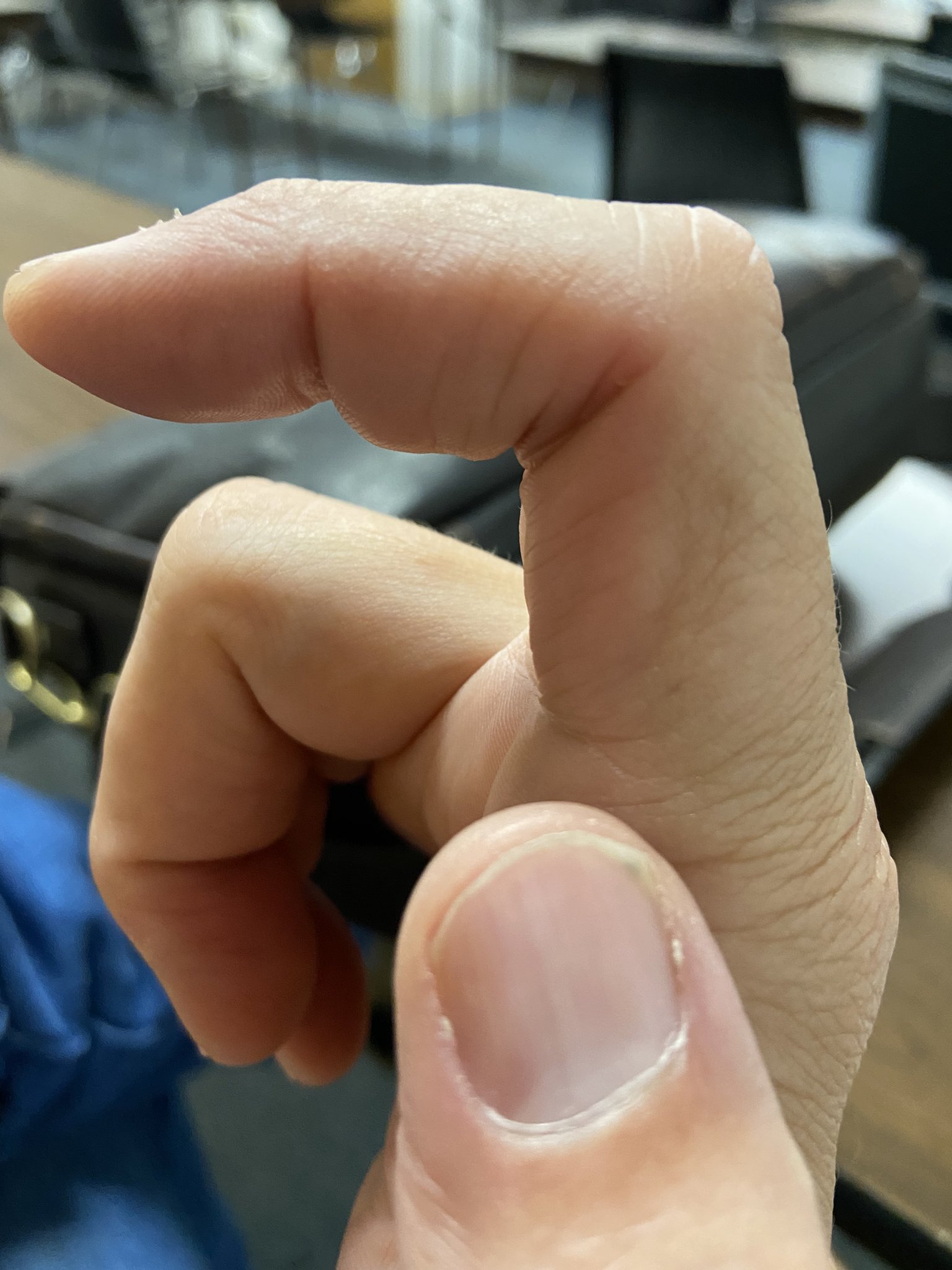

Ok so from what i see just about everywhere from anyone who shoots ELR or competition, I should be placing the pad of my finger center on the trigger, and most keep their thumb on the same side of the rifle as their hand. While this is not uncomfortable, its causing me personally some issue. I can simply shoot a better group holding the pistol grip with my thumb across and the trigger in the first fold of my finger. Trying to do what everyone says is the correct way causing some issue with the group and poi vs poa.
Photos below because i suck as describing this. Just spent the last couple hours, laying prone on my semi-trailer deck, dry fire practicing on a white piece of bark on a tree 500 yards off. Every time i use the "correct" hold, my point of aim shifts to one side or the other. When i use the other way, i can keep my point of aim on point thru the follow thru
Any info or suggestions. I'm not a competition shooter, no do i aspire to be, just want the best performance out of myself, as i can get.

Angles matter,
But not on the pad of the finger, grip is too loose, finger is not a 90 degree...
i have a better grip, with a straight pull on the trigger when firing. Just no good way to place my hand, and hold my phone for the photo lol. It's more awkward than it looks. I got long fingers, large hands, and long arms. Being 6'5" makes things not "fit" me as well as others. I feel that may be one reason the thumb over, trigger in the fold works better. On paper, and in practice. All shooting and practice done in prone. I know from my other rifles, holding my hand with the thumb on the side works better when standing, or bench type position. Just seem to have ill effects when in prone. I'll have to get someone else to get a photo of my grip when i'm in a shooting position, and a photo of my entire position. Maybe that will help.

not pulling rearward at all. After reading the link above im thinking that may be my issue. I try and relax my entire hand as much as possible and focus ONLY on my index finger. According to the link above, that is incorrect. So ill give what you just said a try in the morning with more dry fire practice.
FWIW I agree you are not getting enough tension on the grip (pulling back) and your angles are off as a result...
its not the grip size but it looks that way from the pics, like there is too much reach from grip to trigger shoe

Get your hand and length of pull set up so that you’ve got your trigger finger at 90 degrees to the trigger shoe
set the trigger shoe in the middle third of the pad
Do not put the trigger shoe in the crack of the knuckle. That will cause pulling of the rifle off point of aim
pull straight back “firmly” with your graspers. Don’t worry about the exact amount of force.
only use your support hand to manipulate the rifle laterally and vertically using the rear bag NOT pulling back—-leave that to the graspers of the shooting hand

ok, so it's a nice cool morning (not common) so i was out doing more dry fire practice. This time pulling with my trigger hand and not my off hand. HUGE difference keeping point of aim exactly thru the trigger pull and follow thru. Oddly now its backwards. When pulling if i have my thumb wrapped around the grip, i cannot hold as steady and move off target when i pull. Testing this with the rifle on safe, pulling harder than usual to see if there is a shift. So now the 90* trigger finger center of pad, thumb on the side type of grip makes more sense. Now that is working far better than anything. Also ended up moving my scope back towards me 2 notches in the rail. Didn't notice it until this morning, me correcting me, to fit the eye relief. So tha may have helped as well. Added a new butt pad system since my last live fire that is a little less than 1/4" longer, so that probably compounded it a bit. Anyway, less eye strain and a more natural head position. This also made me need to adjust my cheek rest a bit to make up for the other changes. I don't know if the scope seemed extra clear due to being early and not directly in the sun, cooler weather (less mirage), or the fact i was more comfortable and not cooking in direct sunlight in 100*F+ weather. Combination of all maybe?
Anyway i feel that link posted here got me on the correct track as i was honestly moving farther from doing what is mentioned there. That was the most stable dry fire practice i've ever had in my life. Before this morning it has always been a game of trying to pull the trigger right as i get on target. Like trying to catch it so to speak. This was much more stable and i can stay on target, pull when ready, and stay on target thew the entire ordeal. Never been able to do that before. Can't wait to re-zero and try for another group. (i wait for zero wind days)
Side note. I got accustomed to using grips with a palm shelf as it helped with keeping the trigger hand relaxed, NOW i see why everyone else says that shelf is pointless. Crazy how i was looking for a crutch to solve an issue when the issue was of my own creation. Now the new challenge will be breaking that bad habit that i have done all my life. In this case, muscle memory is my enemy.

Everything you just said worked amazingly this morning, like in my previous comment. All of that i have been doing incorrectly my entire life. Seems silly im sure, but im pretty damn excited seeing what i was seeing. Over 100 dry fire pulls this morning all flawless. Keep in mind i have a 2" white dot painted on tree bark exactly 500 yards from my set up to practice on. If i can stay on at 500, 100 should be cake. You guys are awesome. Ill keep posting here after i get the chance to try again for groups. Im feeling pretty good about this. Just want a LOT more dry fire practice to break old habits first.
