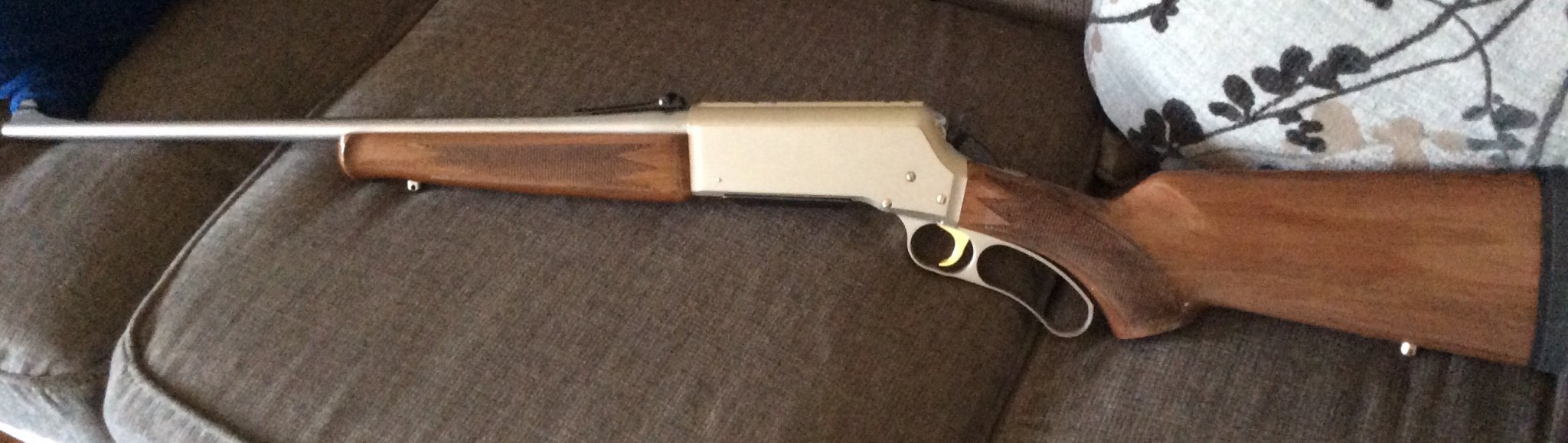

I bought this lever action .308 Browning. It has a horrible trigger. I see people recommending sending it to neil jones to get worked over. The opinion is that they are hard to do for diy guys. Anyone done it or know the pitfalls? I am a mechanical guy and slick up marlins and saa colts for examples of experience.
