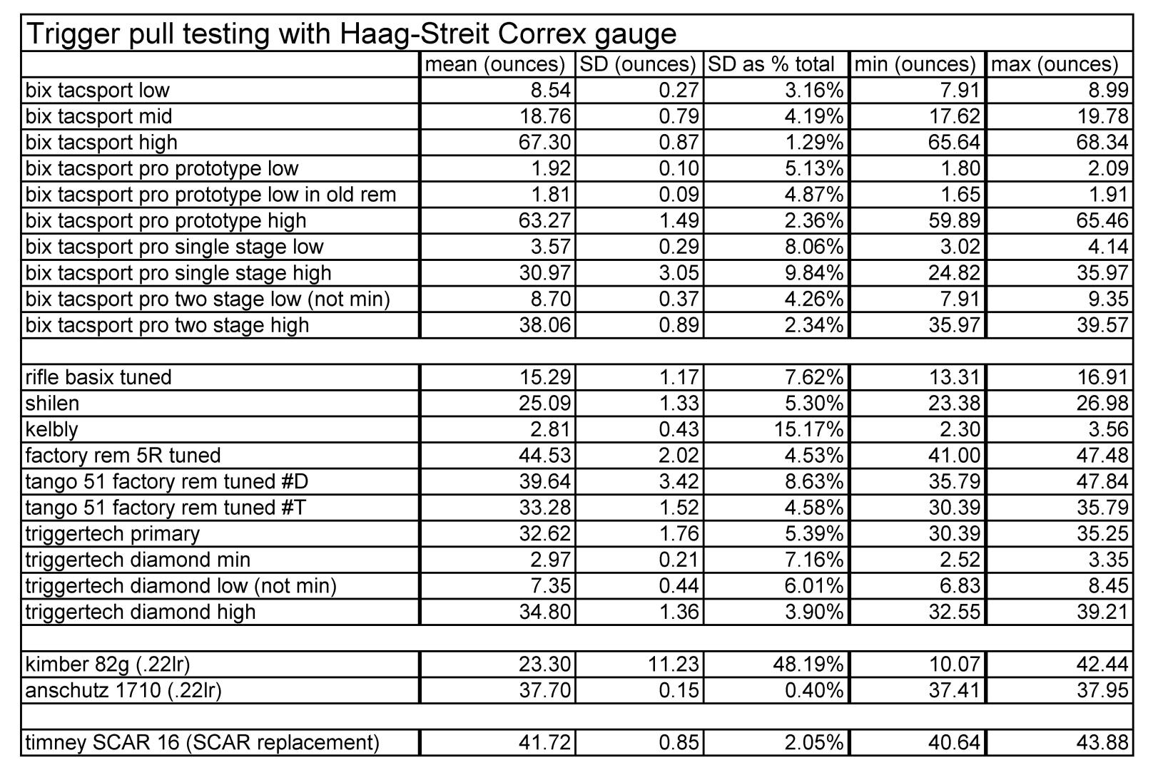

X-Treme shooting sports makes an 82g trigger. This is the only 82g trigger I am aware of. I have not tried any of their products personally so I don't have any firsthand knowledge of how good they are and of whether they are worth the relatively high cost of $300. I do have a great deal of experience with 82g rifles. Some can be quite good. I have one that is substantially better than .5" @ 50yds. This degree of performance might well be worth putting a first rate trigger in even though the initial rifle cost was not all that much more. I do also know that the trigger included in the 82g is terribly inconsistent. Even carefully adjusted and lubed it has massive pull to pull variance in weights. You can see that in the pull weight table for various triggers I created as part of the Bix n' Andy review I did last year and which will also be used in a TriggerTech review this year.

I have not stoned an 82g trigger to see how much it can be improved. If you try that you should know this is something that must be approached with the knowledge that it is very easy to mess up resulting in an unsafe trigger.
