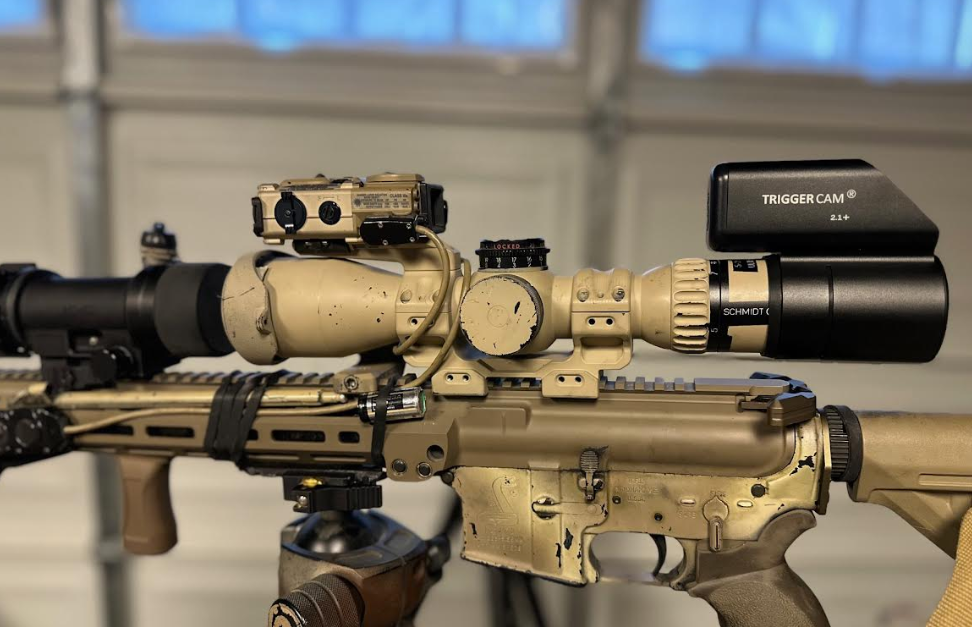

Labradar site has them (they are distributors). I haven't purchased yet because the site implies it will ONLY fit oculars 48-51mm in size. Does anyone know if that is true? I have also sent an inquiry back to Labradar. I don't want to buy this to use on my ZCO and then find out I also have to buy another $600 regular Triggercam to fit on smaller scopes. I would have thought they would include a full set of collets with this thing to use on most scopes large or small.
Reactions: Dogtown
I haven't tried anything but my ZCOs. However, it comes with 8 sleeves, with the thickest one having an internal diameter of about 39.5mm. I'm going to guess the range is going to cover 40mm to 51mm or so. Back when TriggerCam had the spec page up, I vaguely remember they had a range that started below 48mm.
Reactions: Conqueror
I can confirm it fits on the newer S&Bs with the flared occular.
NF ATACR 4-16x will probably work if that weird lock ring can be removed (yeah, I unscrewed it but it doesn't seem to come off easily)
The geometry of the ocular end of the NF CFS 6-36x spotter prevents it from getting fully installed - might be useable; will have to test.
Granted, I've never actually used one of these before because it would never fit, so we'll see if I'm totally wrong. Seems to sit pretty far back.

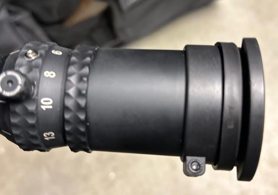

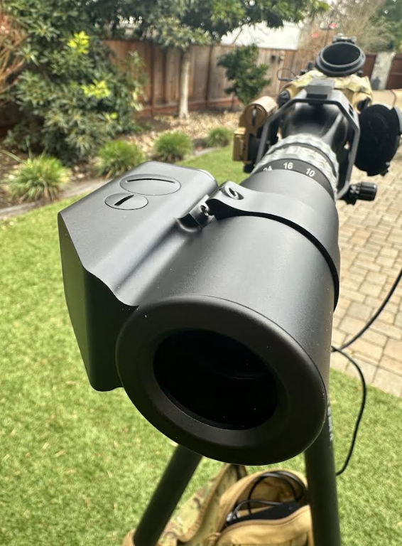

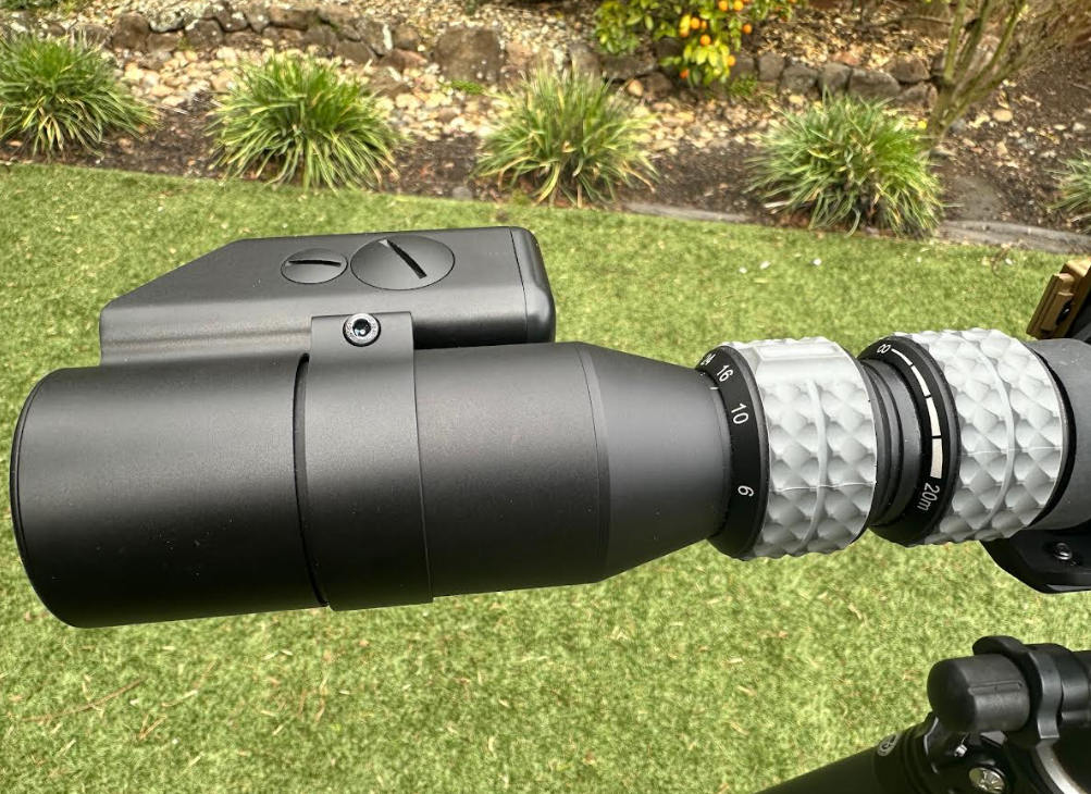

Any update on using it with the CFS? I’ve been trying to find a good way to film through mine and haven’t found a good option yet. This is would be ideal if it worked.
@Stag556
I did a bit more in-depth test trying to get the Triggercam 2.1+ onto the CFS to no avail. Even with no collar and the tension bolt backed all the way out, it still won't fit. Even if you just sort of get it part way on, I couldn't get a very useful image.
@Stag556
Thanks for posting an update. Shame it won't work. I grabbed the NF extension piece thinking I could mount a GoPro to it but the camera can't get low enough to look through the eye piece properly. Maybe ill look into those magnetic scope caps, not sure if they sell one to fit the CFS or not though.

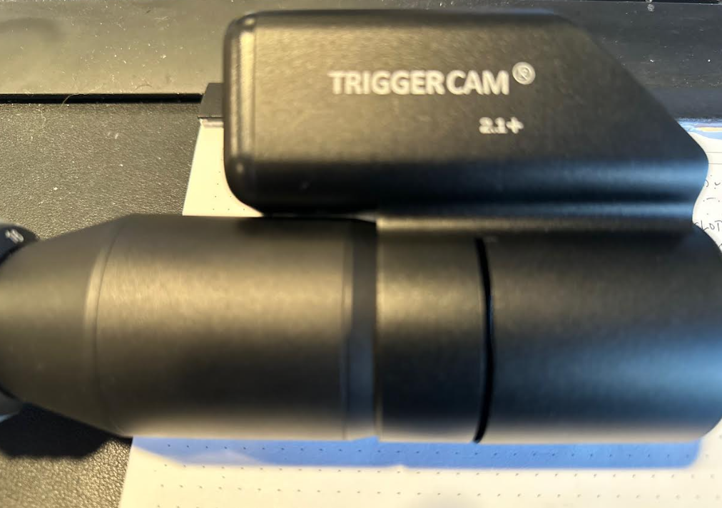

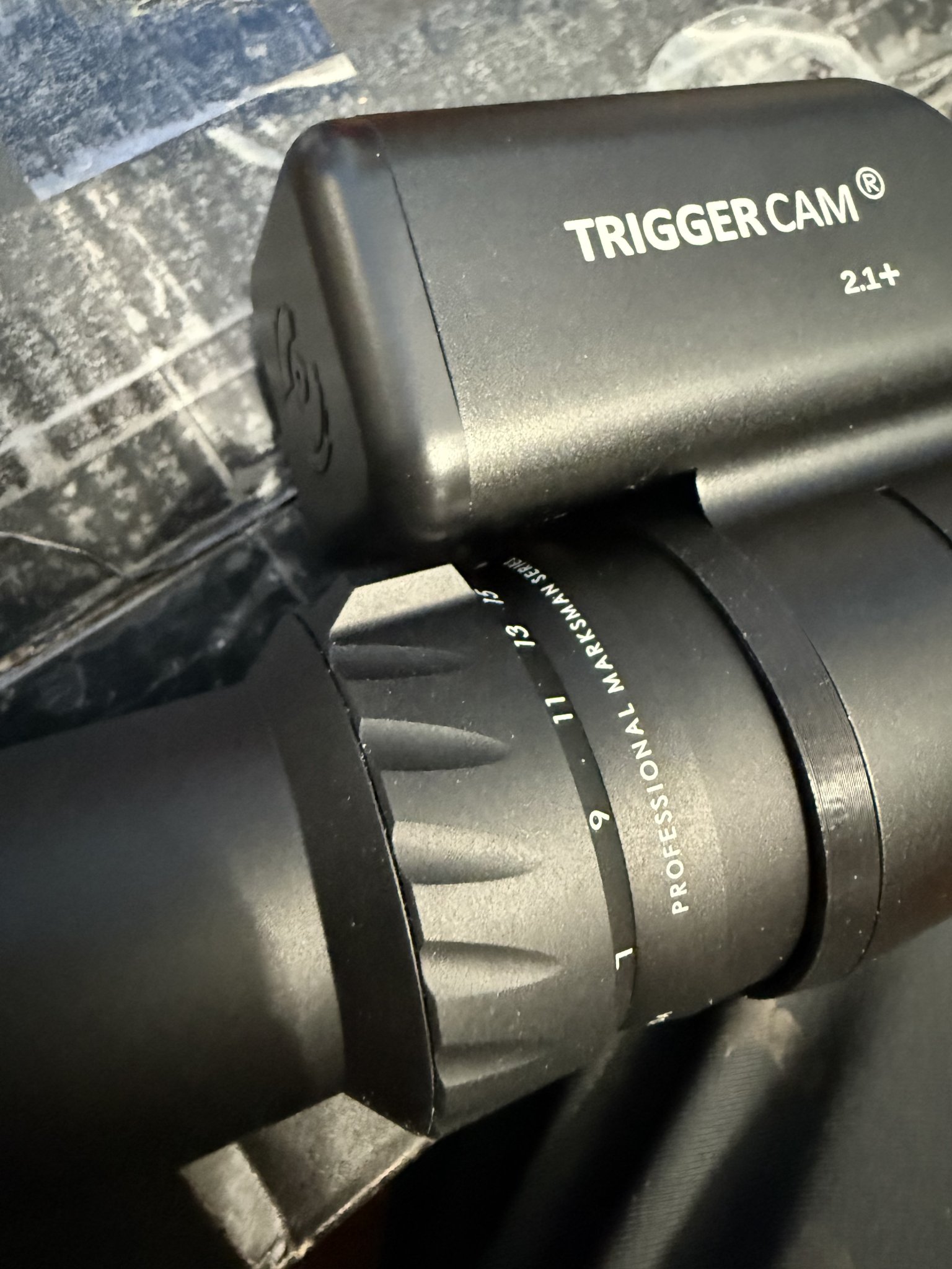

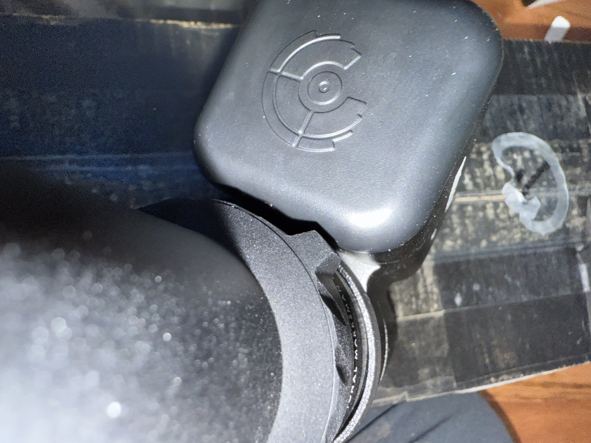

One disadvantage I’ve found with the new Trigger Cam 2.1+, and I hope that I’m just missing something, but don’t think so, is on the Tangent Theta 735 it has to be mounted at a 90, and even still interferes with low/high zoom as it interferes with the zoom throw, which is surprising because it’s not that large in the TT, unless I’m messing something up mounting improperly…if so please let me know, especially if your already running in on a TT 735. Here it is all the way engaged forward on the TT 735, not tightened in the pic, but the outcome is the same in the normal top position.

I dont think the new 2.1+ will help anything on ZCO scope.
Yes, you can mount it on the scope with the sleeve, but you can do that with the old model, just with out the plastic spacer.
The magnification finn is still there, so i dont jump and scream, i want the + model.
