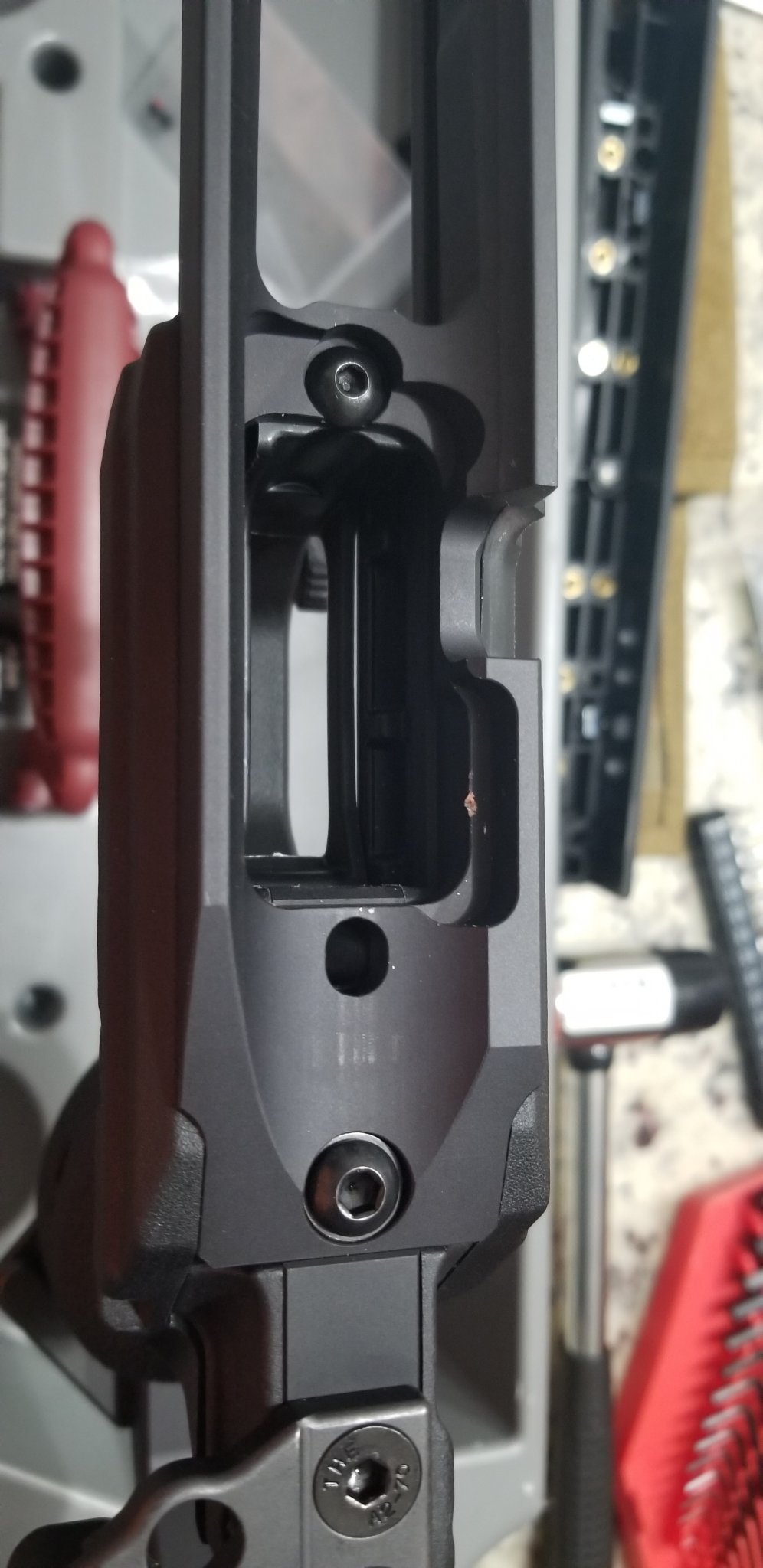

So i picked up the Diamond 2stage (Green).
Installed, adjusted, set the safety... Pulled hard... "click"... uh oh... I panicked a bit.
Took it apart, realized there was a little mark on the aluminum chassis and the safety lever. They were touching.
I had to grind a little notch in the Aluminum rail to allow the safety lever to fully engage rearward. Then, no issues.
Soooooo.
If you install this trigger in a KRG Bravo, set the safety, pull the trigger stiffly and see if you get a click. If so, grind a little slot for the safety lever.
Smarter people will chime in but this is probably more due to an aggregation of various tolerances from action, trigger, and stock causing fit issues.

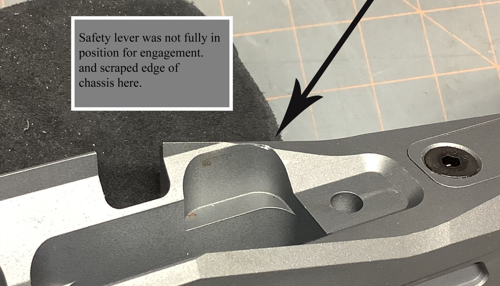

You’ll need to remove your action from the stock and check for interference with the safety lever. You should see some sort of wear mark. I used a dremel to make a small relief cut for my safety. Doesn’t take much.
^good advice above. The wear mark will probably look something like this, notice the silver gouge caused by the safety (this was my KRG W3 and TT setup, when it wouldn't initially fit and required relief):
