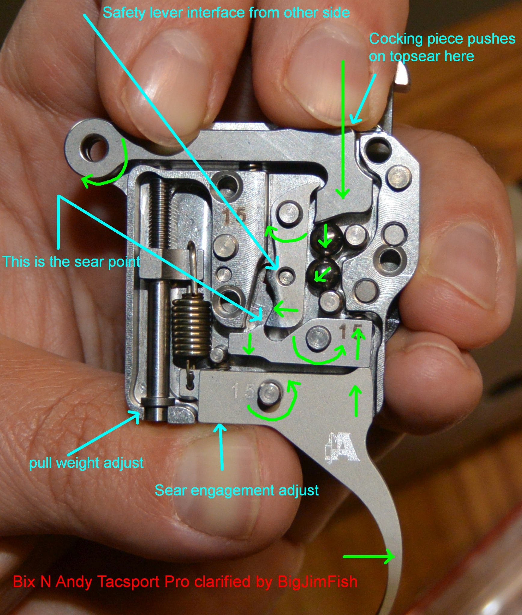

I could totally be wrong here, but I believe: B&A offers different top sears that engage the cocking piece of the bolt, so you can get the correct one for the action you are using to prevent too much contact and too little contact. They also have an adjustment for sear engagement in the trigger which is basically how much overlap the two pieces of metal have before they break free from each-other.

Almost every aspect of the Bix 2-stage is user adjustable.. 1st stage travel, 1st stage pull weight, 2nd stage pull weight and over-travel as well as sear engagement. With that said, it's still important to have the correct top sear to start with. Top seat is the only thing that requires disassembly, but once correct doesn't need messing with.

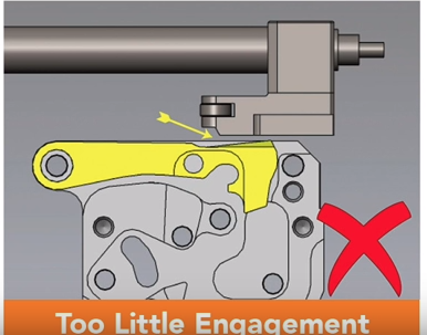

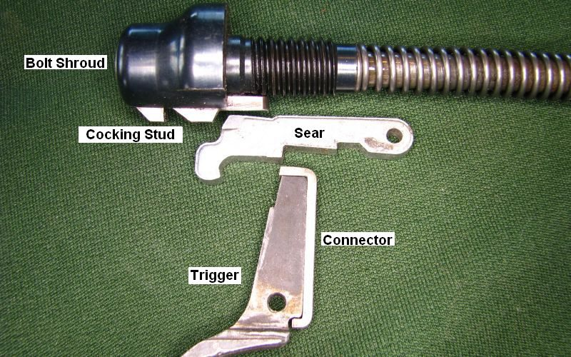

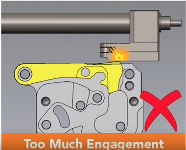

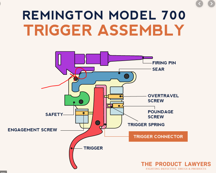

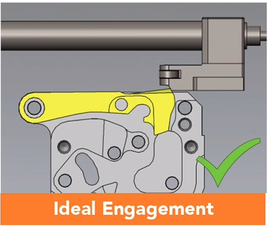

So the sear is what catches the firing pin and holds it back against the springs forward pressure until you actually pull the trigger to release it.
I drew a little red arrow to where that interaction takes place. The rest of the trigger design will be different depending on he exact trigger but they all catch the firing pin and hold it backwards.
If the sear (actually top sear)is too high in regards to the firing pin that can cause the firing pin to drag over it instead of being cleanly released and this robs ignition power and consistency.
Too little engagement and it wont hold properly and the firing pin can just ride freely over top.
Ideally it is positioned high enough to catch the firing pin but not so high that it interferes.

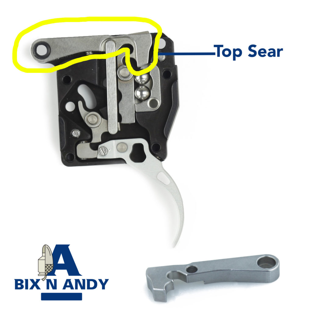

So with something like a bix and andy you can actually control the height of that top sear with replaceable pieces that are different heights, 3.6, 3.8 & 4 mm tall. This allows you to control the pieces actual physically dimension, you can still control how much overlap there are between the two pieces by adjusting the sear the replaceable parts just are a little more customizable. Most triggers dont have this set up, traditionally altering the sear geometry meant having to actually get out a stone or file and actually fit the pieces together.
Most triggers that have sear adjustment only allow you to control how much pivot is allowed to the sear which controls the amount of overlap with the firing pin instead of the sears actual geometry. Turning a screw in or out controls how much these two little fine ledges actually overlap. If there isnt enough overlap then the rifle can easily fire accidentally. Too much and it can feel less than ideal for precision, its balancing game.
The interaction between the green and yellow shows that relationship and how they overlap and catch in an ar15 set up

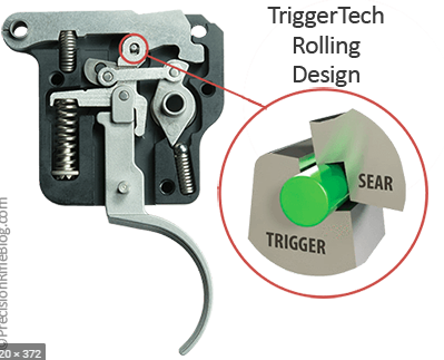

Trigger tech kind of gets over that too much sear feeling by removing the two parallel surfaces dragging along one another and instead introduces the roller to replace dragging friction with friction free rolling while still having adequate sear engagement for safe operating.
Edit: the bix has roller balls as well but it also has some dragging bits. The actual breaking sear surface is down in the lower third and a two surface arrangement, the rest above it is just helping it fall away from the firing pin elegantly.

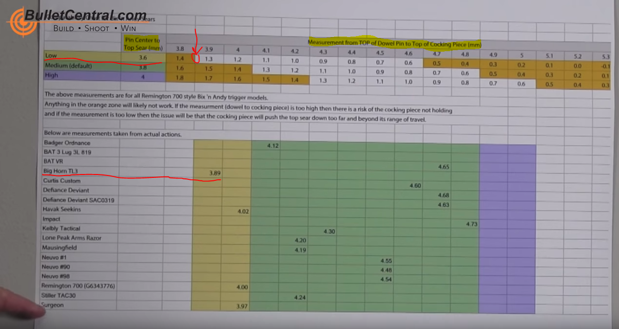

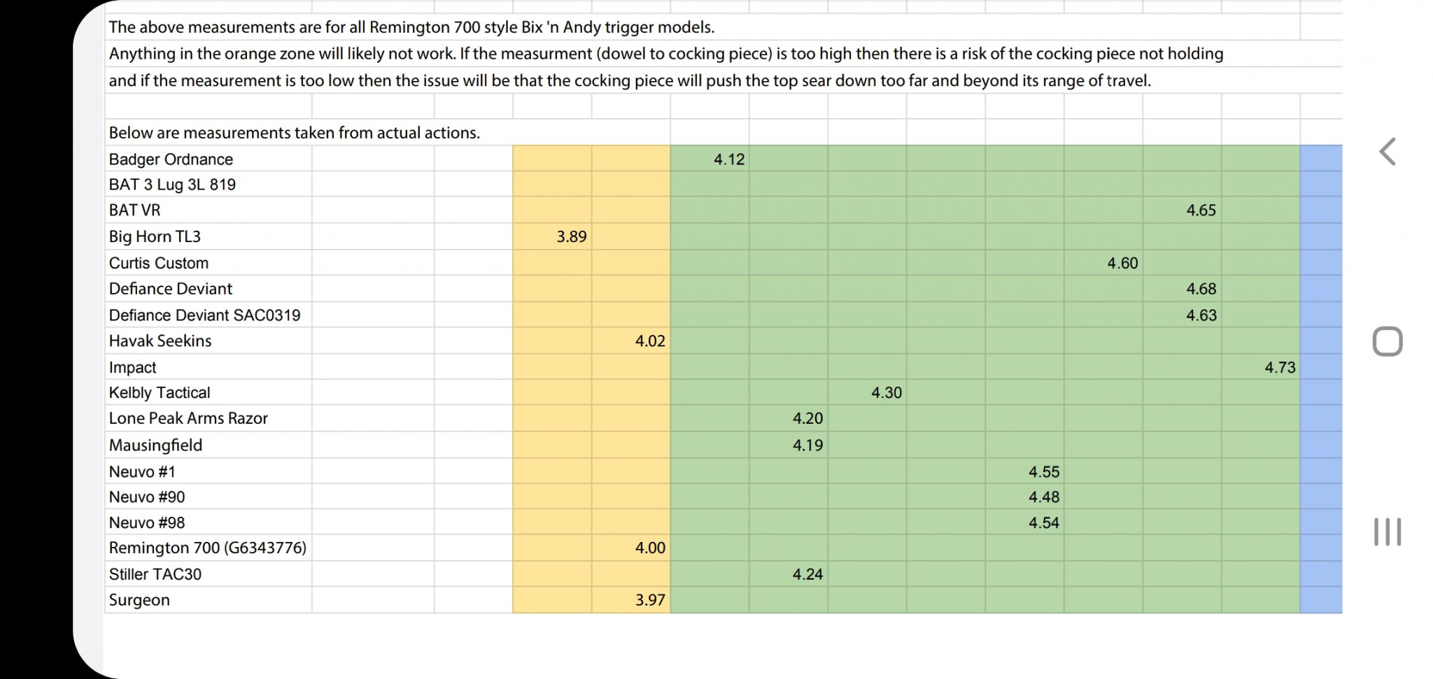

Just a random question, does anyone know off the top of their head what seat height I need for a B&A in a BH TL3? I had it written down somewhere and can’t find it.
I beleive its a low 3.6mm, it is according to their old now removed charts and my origin is a low, but you should measure it. Knock the trigger pins in and measure it with your calipers depth gauge. Bolt in and closed put the base of your caliper on the trigger cross pin. Then extend the depth gauge until you hit the cocking piece keeping the calipers 90° perpendicular to the action to measure the distance.
Start at 7 min 42 seconds

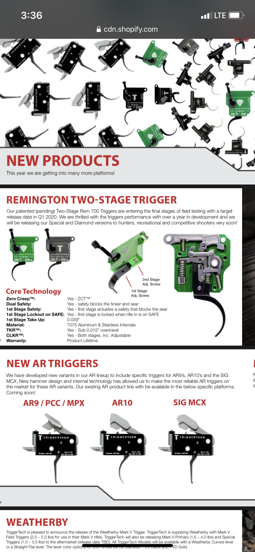

Weird because I tried one a couple of weeks ago on a friends rifle in the U.K and i can assure you we usually get everything at least a year after you guys ? It was really nice, better than my TT diamond and the first stage take-up felt just right. No after travel. Exactly as I would want it to be. I will definitely be getting one.
What those will be like when they go on sale remains to be seen, personally my enthusiasm has gone from sizzle to fizzle due to their lack of coherence between marketing skills and ability to deliver a product without teeing off the customer. Announcing a product at SHOT Show for the quarter following SHOT and then not having them out by the time the next SHOT rolls around, not even having a tentative statement on when they might hit the market on their web site is just bad business practice at this point; especially with all these rumors of sightings, and trial runs flying around.
I love their products but this has been tremendously counter productive to their initial marketing. A few of my friends who swear by 2-stage and were waiting by now have gone with Bix'n Andy, if I wouldn't have had a bad experience with them in the past I might have gone that route myself. I just did not care for the feel of the Bix, so I got a single stage TT instead, but I'm a bit disappointed to say the least.
I feel the same, so opted for a TT single stage, otherwise it would be a second year on a build without firing a shot. Give a dog a bone for christ sakes, at least post an update on your website TriggerTech!;)
