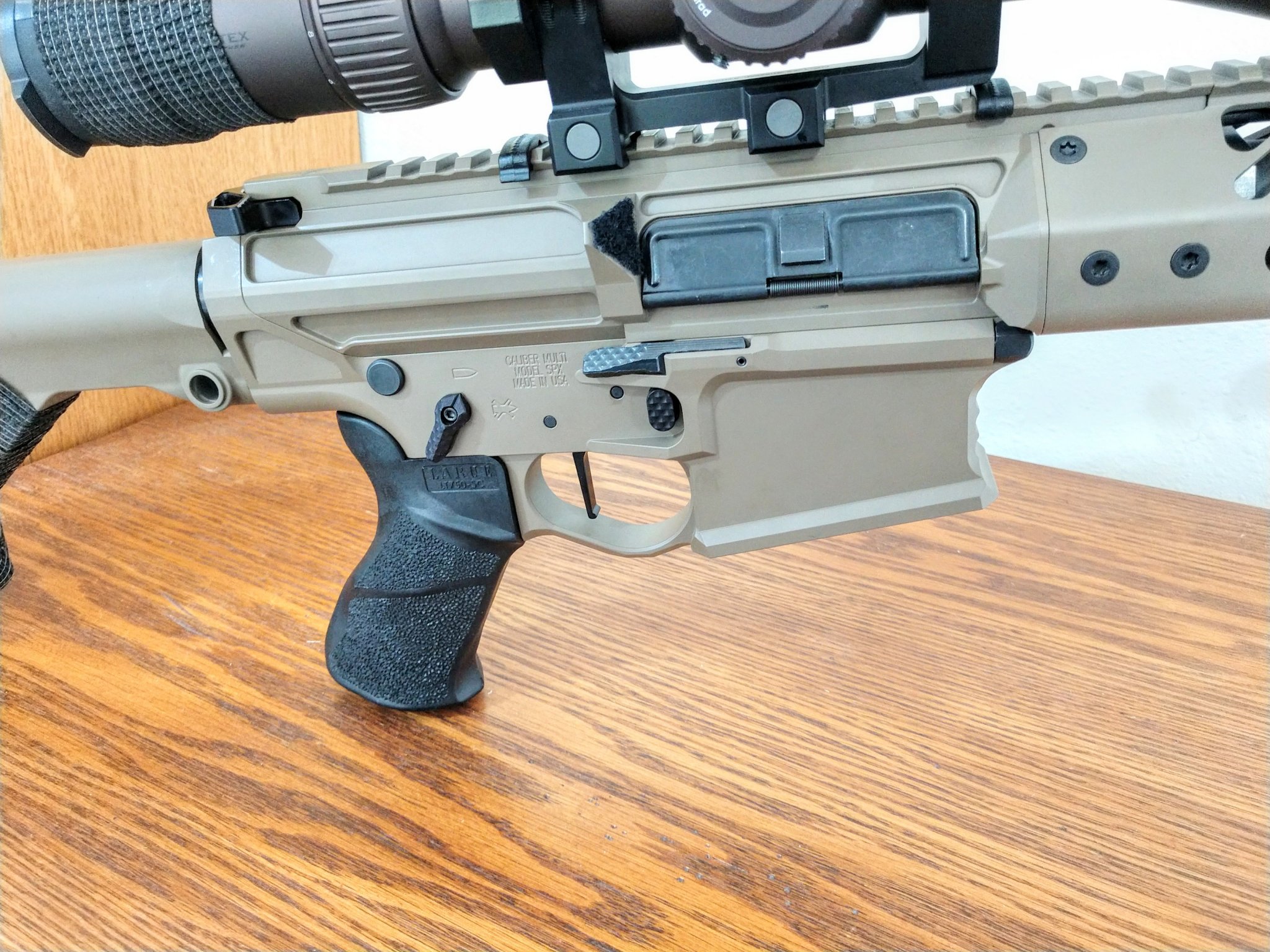

Triggertech AR10 Diamond... Pure SEX!
bigjake83
Golden Shellback
  • May 19, 2013
    4,952
    3,851
    Southern Idaho

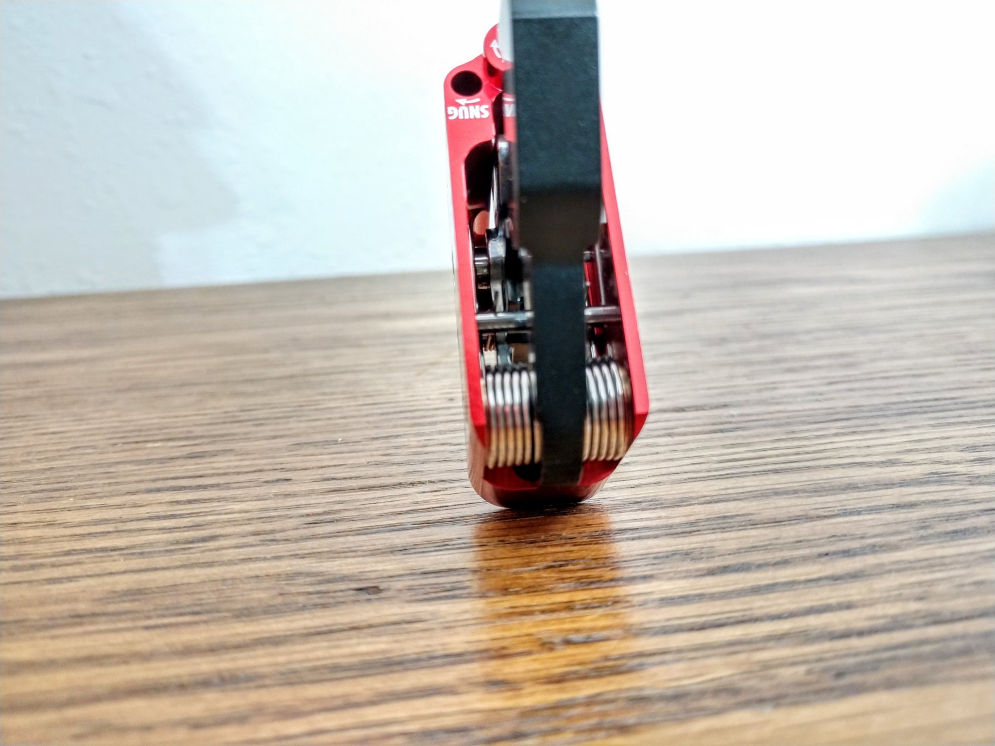

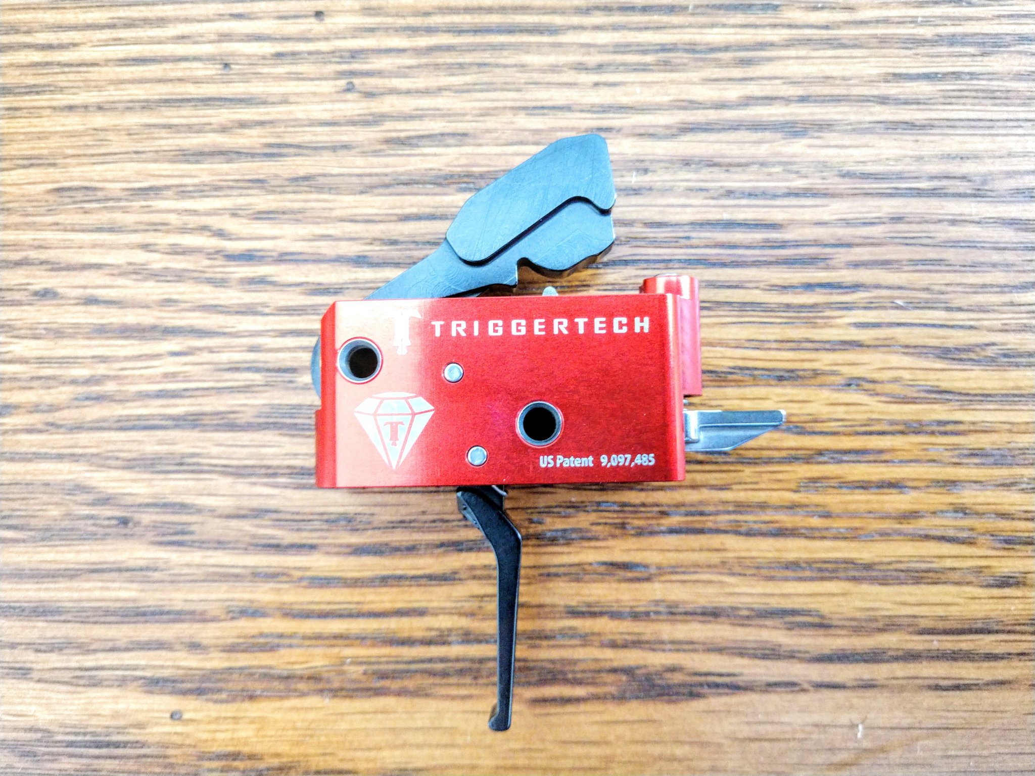

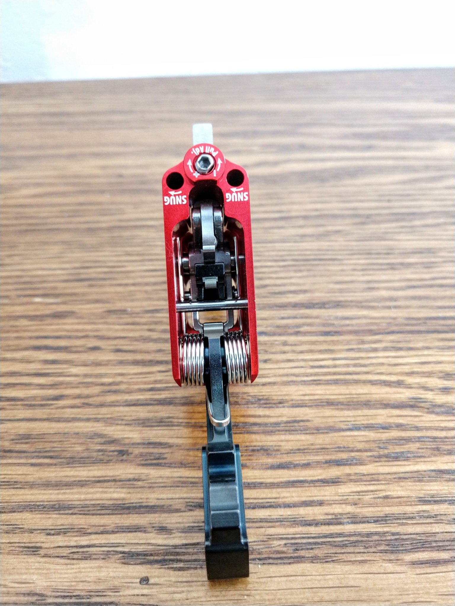

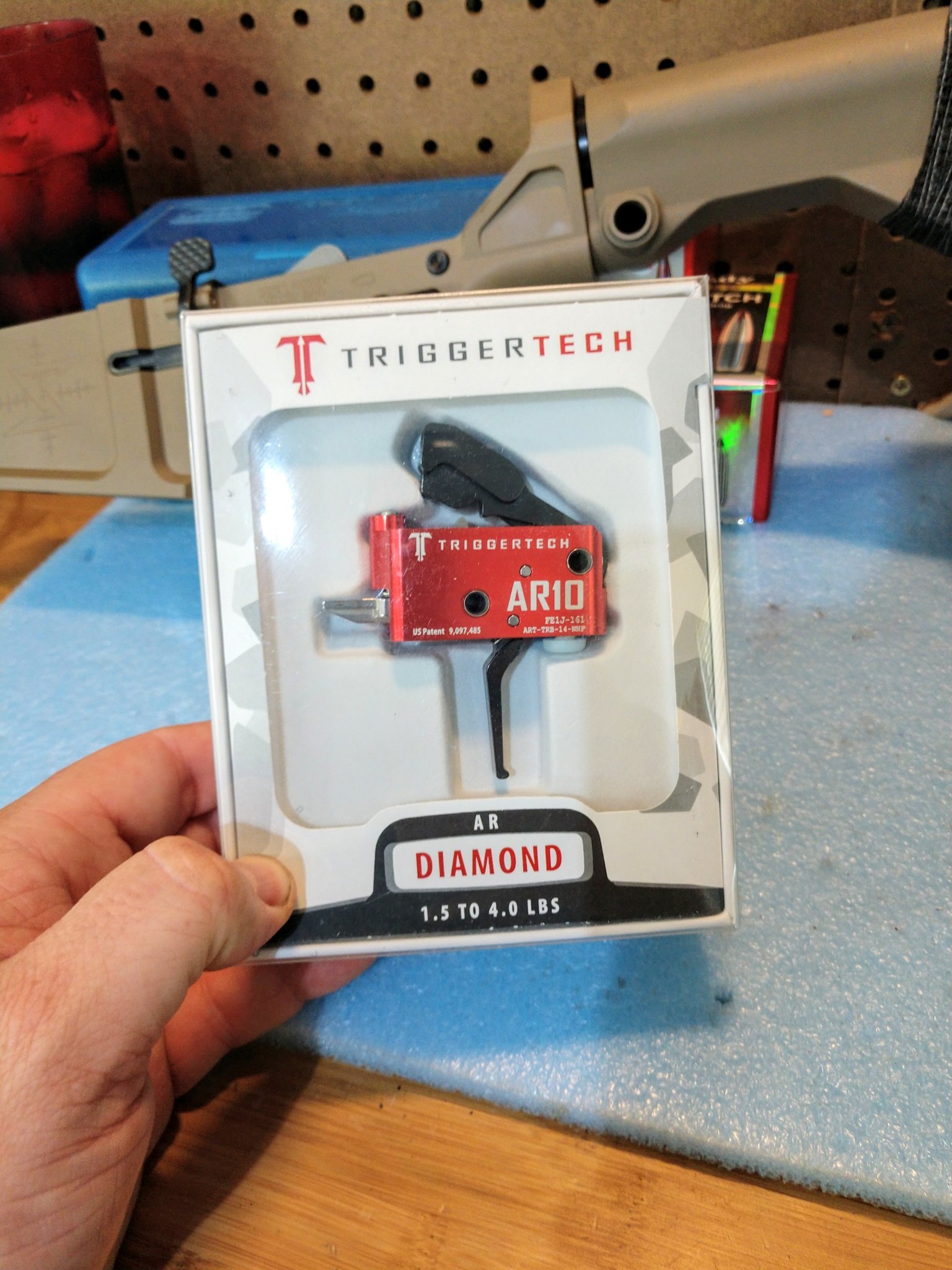

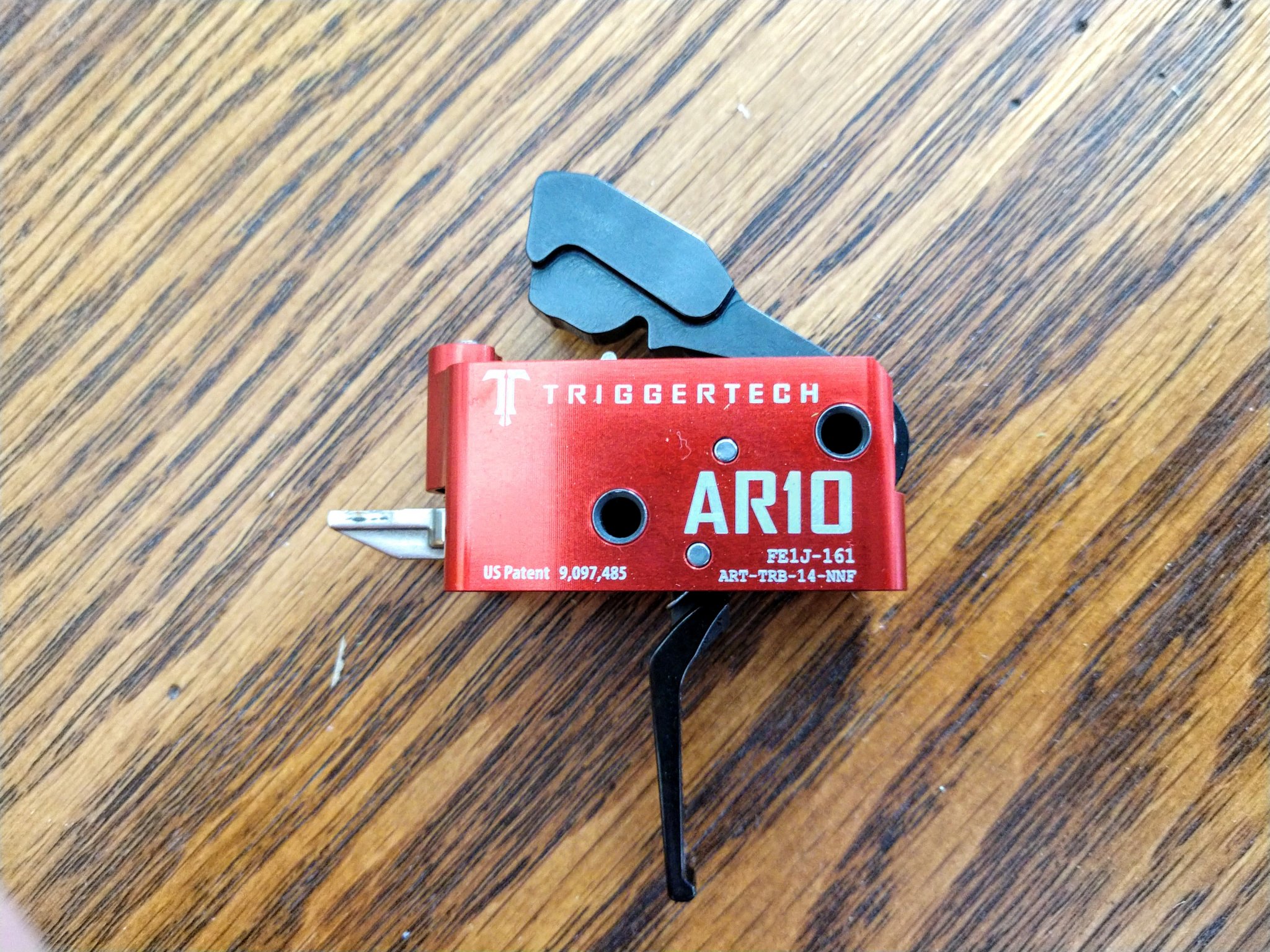

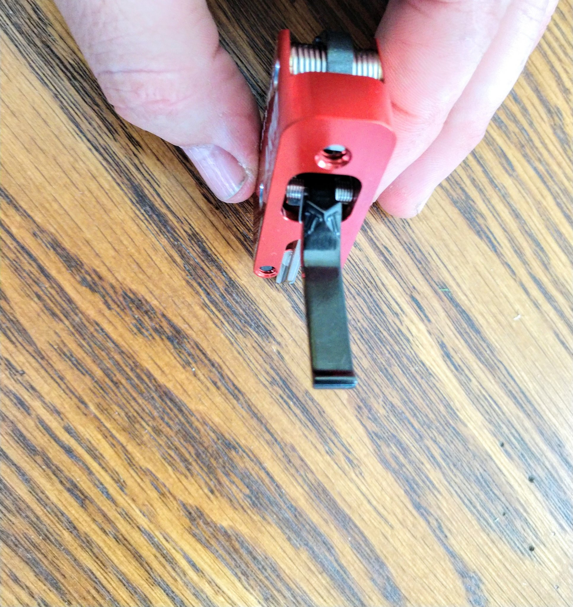

    Just received this beauty, the fit and finish and attention to detail is absolutely outstanding!!!
    Installation was easy and straightforward, the pull weight adjustment has a very clean tactile feel and audible.

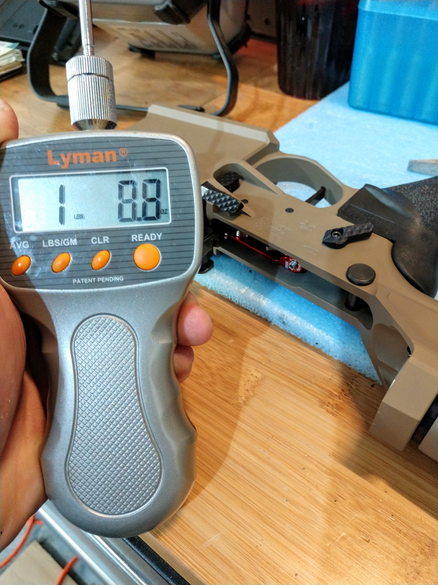

    The trigger easily reaches it's advertised pull weights.
    You feel no resistance other than spring tension on the first stage take up, it's ridiculous how clean the second stage trigger break is with absolutely no perceived overtravel.
    The only minor complaint I have at this time is the reset is a bit soft so if wearing gloves it would be hard to feel it but it's audible.
