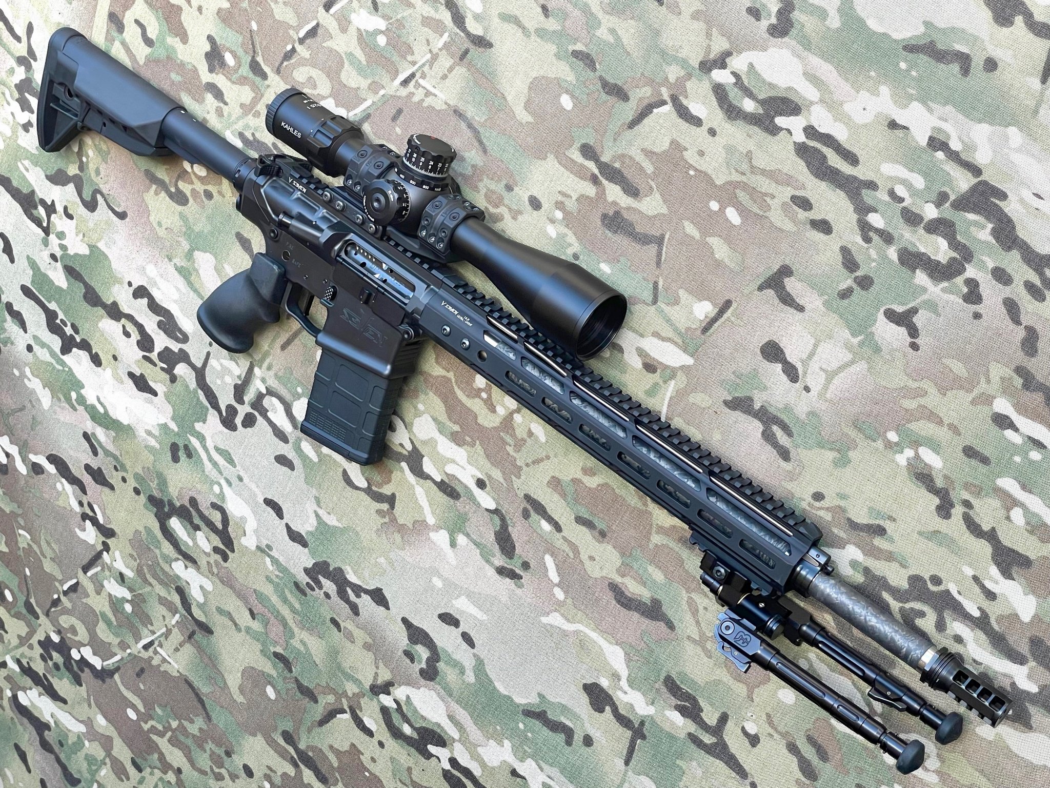

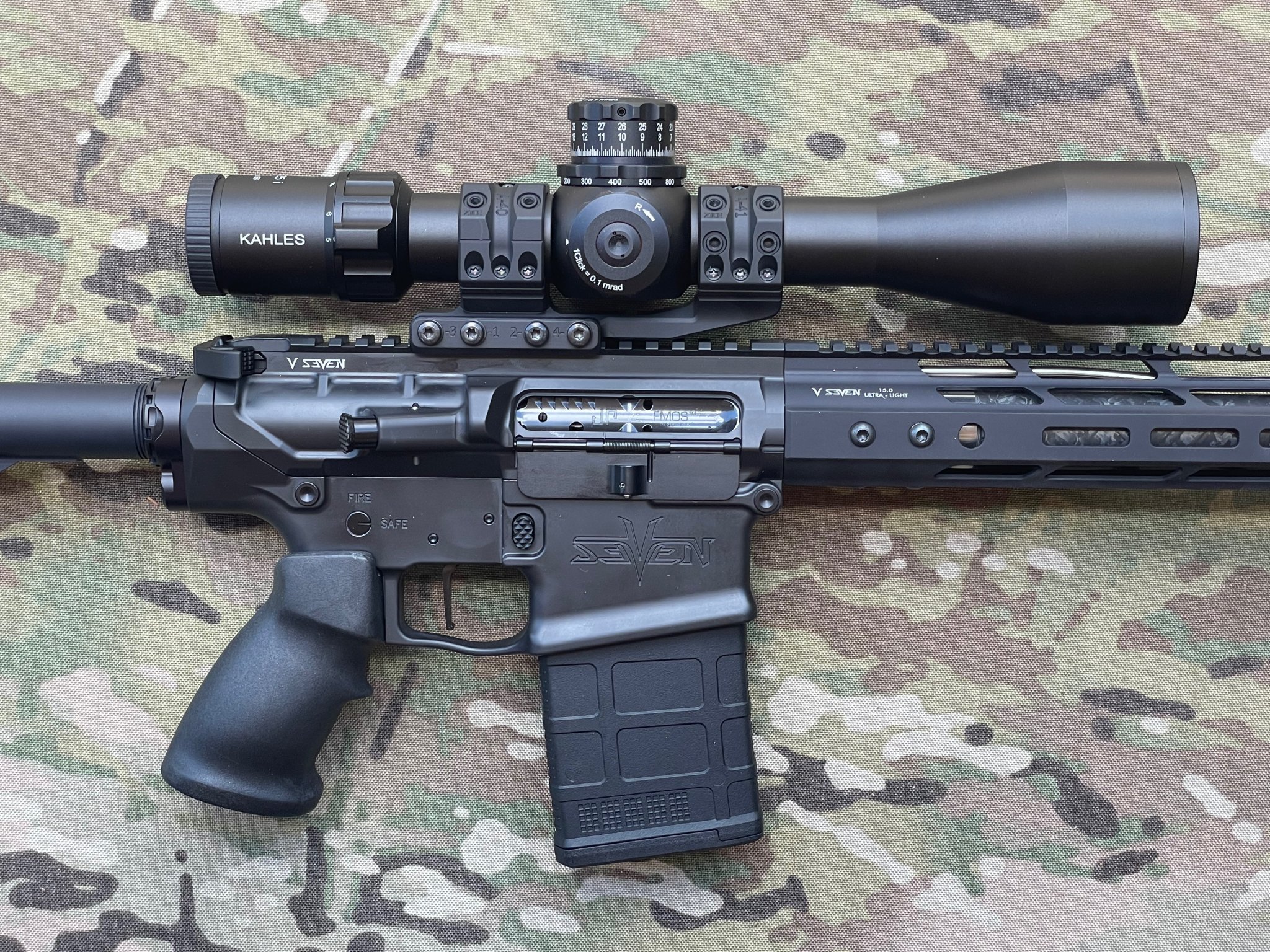

I've built and sold a fair number of big block AR's using the TT Competition, Adaptable, and Black Diamond triggers. Not one single issue to date.
View attachment 7958606View attachment 7958607
That scope is probably heavier than that entire rifle lol
Sick build. My god. V Seven receivers and handguard, JP BCG, Proof Barrel, TT Diamond, Kahles scope, Sphur mount....u have great taste, expect that silly grip lol this build needs the MKM Recce grip =)

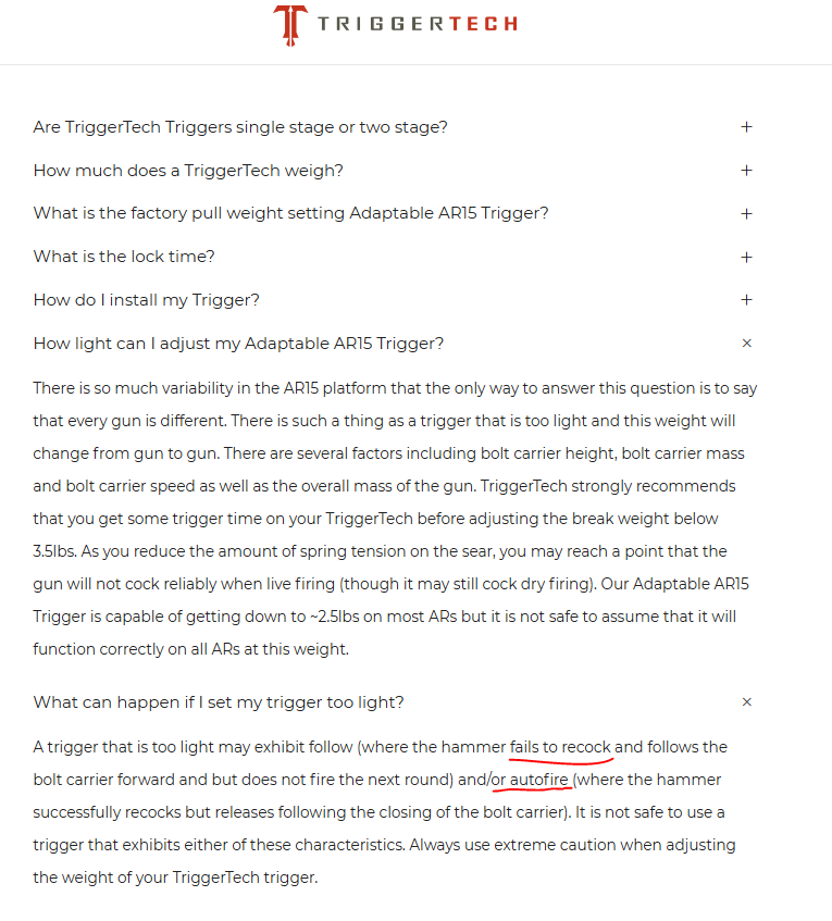

This is what TT sent me when I started going full auto. See where I underlined in red. I just want to clarify that this issue started happening around the 180-190th round mark. Sometimes it would not recock. Most of the time it would double or triple tap. Approximately 3-4 times it went full auto until mag emptied. Luckily my 6 ARC mags are 10rd capacity only. I have NOT had recock or autofire issues once I increased the weight of my Diamond to around 36 oz. A bit too heavy for me, for PRS use.
Unintentionally bump firing a AR10 due to a light trigger is why some companies like Knights spec a 4.5 pound trigger. That bolt carrier is a whole lot of mass coming back forward. Personally Geissele DMR is as light as I go on two stage.
