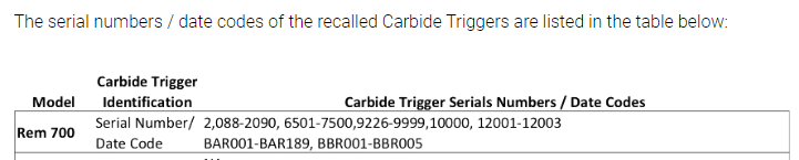

I know you said the timney does it too but: How old is the primary, if its an early one the carbide rollers can crack and lead to issues, they had a recall on it. https://triggertech.com/pages/safety
