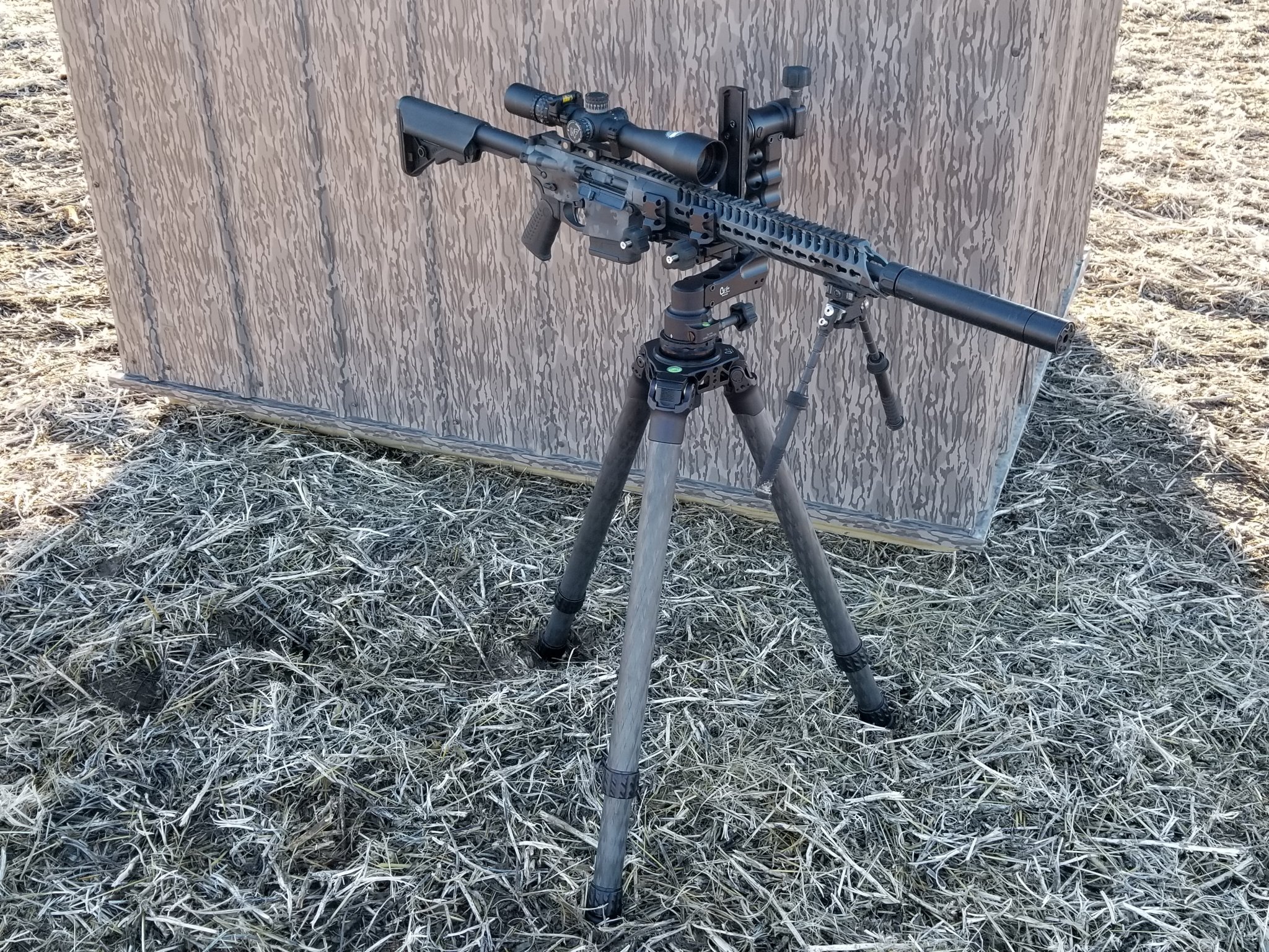

I have a Feisol 3342 with a Benro leveling base and a Fittest Arca QR clamp. Total price is right at $600 and weight is 3.6 lb. It took me a while to get what I wanted, but I love this set-up. I did remove the tension lever on the Benro, thread the stud and attach a knob to get the full tension range as installed on the Feisol.
People told me I would not be able to shoot past 15 degrees with it, but one click on the leg lock and I get another 15 degrees of down. It is smooth and fast. I have borrowed and shot off of some of the $1K plus set-ups and this one is right in the same performance window.
Why did you go with the Benro leveling base instead of the Feisol version? Still happy with that set up? Aside from the cost, it appears to be much lighter than the high end options, and if it shoots as well...
View attachment 6883930Here is my Cruxford minus the Spotter attachment

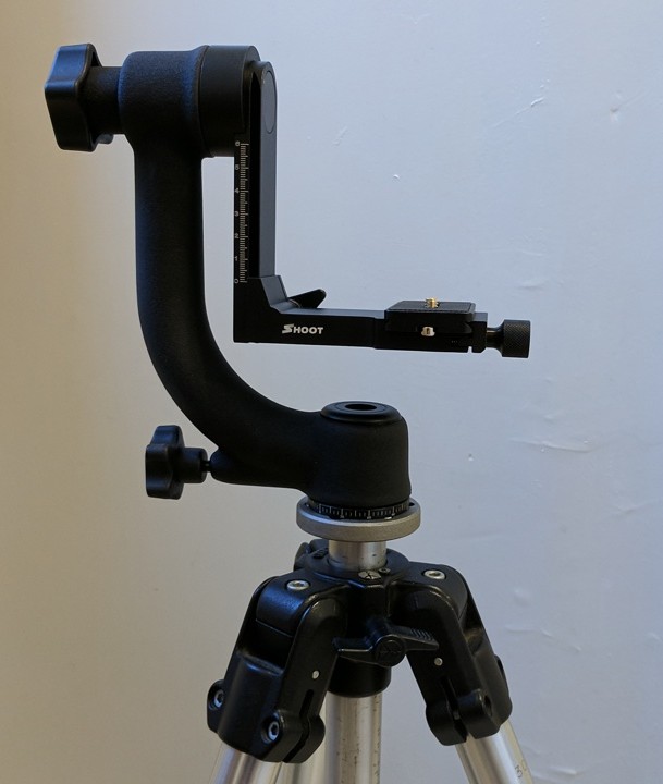

I got my cheapo gimbal from Amazon.
I quickly mounted it to my Bogen 2011 tripod.
It has standard 3/8" threads and screwed right on.
The three grub screws in the tripod column that lock the head on are close to the edge of the gimbal base but with at least 75% overlap, it locks tight and I think it will be fine.
The panning made me worry for a moment, when I tightened it to create drag, it hit tight spots as I panned. Loosening it removed the tight spots and it spun ~freely but not wobbly as far as I could tell.
The tilt seemed to be able to tighten to create drag but tilting with drag seems to play with the clamp setting.
I will have to take this apart to see if I can improve on that.
I'm pretty confident that it will handle the weight and recoil if my tripod can. It seems pretty stiff in the tube portion.
I'm going to mount an Arca rail on the side of my chassis and mount the Arca clamp on the vertical portion of the L shaped mount. It will go from "L" to "I" with the clamp mounted near the pivot (at the top of the "I").
For about $100 worth of Craigslist used tripod and Chinese gimbal, I don't think it's too bad but it does need a little work to make it what I'm looking for.
Cheapo gimbal update:
I was fooling around and removed the tilt lock knob. The tilt arm rides on two plastic bushings and the knob has a thrust bearing and washer setup that squeezes together the bushings to lock the tilt.
The washer seems to be your garden variety nickel plated hardware store washer, not flat ground for the bearing to run on. Worse than that, it was installed with the bottom side of the washer toward the bearing. I flipped the washer, reassembled and suddenly I can set tilt drag that doesn't change due to moving the tilt arm.
One axis down, one to go.
On the pan axis I can't figure out how to disassemble it. It seems like the cap in the middle should pop out or unscrew but there is no good way to grab it. I tried some light prying but I stopped before I gouged it too bad and no progress.
After that I thought "what if I could wear in the track so the drag is consistent?"
So I set a small amount of drag and then spun the gimbal. The drag got tight and loose as it went through the high and low spots but it started to even out.
Occasionally as I spun it the lock would loosen a bit reducing the drag, not good but it gave me an idea. I'm going to try to remove the locking screw and place a jam nut between the knob and the threaded aluminum piece. This will let me adjust drag and then lock in the tension. If it loosens over time I can adjust it and lock it in again.
I don't have the jam nut to try the idea but I think it will work.
So if everything is square in the gimbal, I think it is going to work.
I just need to mod the pan lock, mount the clamp and get my rifle together so I can figure out the Arca rail position I need.

Well, that's one of the reasons why I'm trying a $50 cheapo, if it absolutely sucks I can forget about it.
If I had bought a $500 Whimberly and it sucked, that would hurt more.
That $2,500 Cruxford setup should work but that's a bit out of my budget for a shooting tripod.
Any way, the ratings of tripods are very subjective. I bet I could find dozens of Chinese tripods with 20 pound rating that are way less stable than my heavy old 13.3 pound Bogen. A 20 pound telescope tripod would probably be a lot more Stout and a 20 pound astrophotography tripod looks like it would make a half decent machine gun mount.
I think my gimbal would struggle with a 20kg load as it is currently set up, the "L" bracket would probably flex quite a bit, that's why I want to eliminate that and clamp to the side of my rifle. After I remove the weak link, I think I could probably hang 100 pounds off the gimbal without severe bending or breaking. I think my tripod could handle a static load like that too.
In use the static load is maybe 15 pounds for rifle and gimbal. I've seen plenty of posts with similar tripods and a ball head or saddle. Before RRS and others started making gun specific tripods, shooters were using old photo equipment.
I don't feel like what I'm trying is outside of the realm of possibility.

Working with Really Right Stuff’s mid level gimbal the other day. Works great but would not want to use it anywhere other than a bit moving static range complex or very close to my vehicle. It isn’t that heavy just odd shapes for carrying.
Couldn’t attach the file so here is the link;
That is interesting. Have you ever compared it high to low to see how that changes it's reaction to firing?
I was looking at my Bogen 3011 and it only has one open position for the legs as seen in my photo. It can't get low.
Looking at my other Craigslist Bogen tripods, I have an old 3020 which seems a bit sturdier and has three position legs but one of the leg latches was seized up.
I used a little penetrating oil on the latch and hit it a few times and it started to loosen up. With the legs working in all three positions, I think I'm going to swap heads and put the gimbal on the tripod that can splay out the legs wider.
