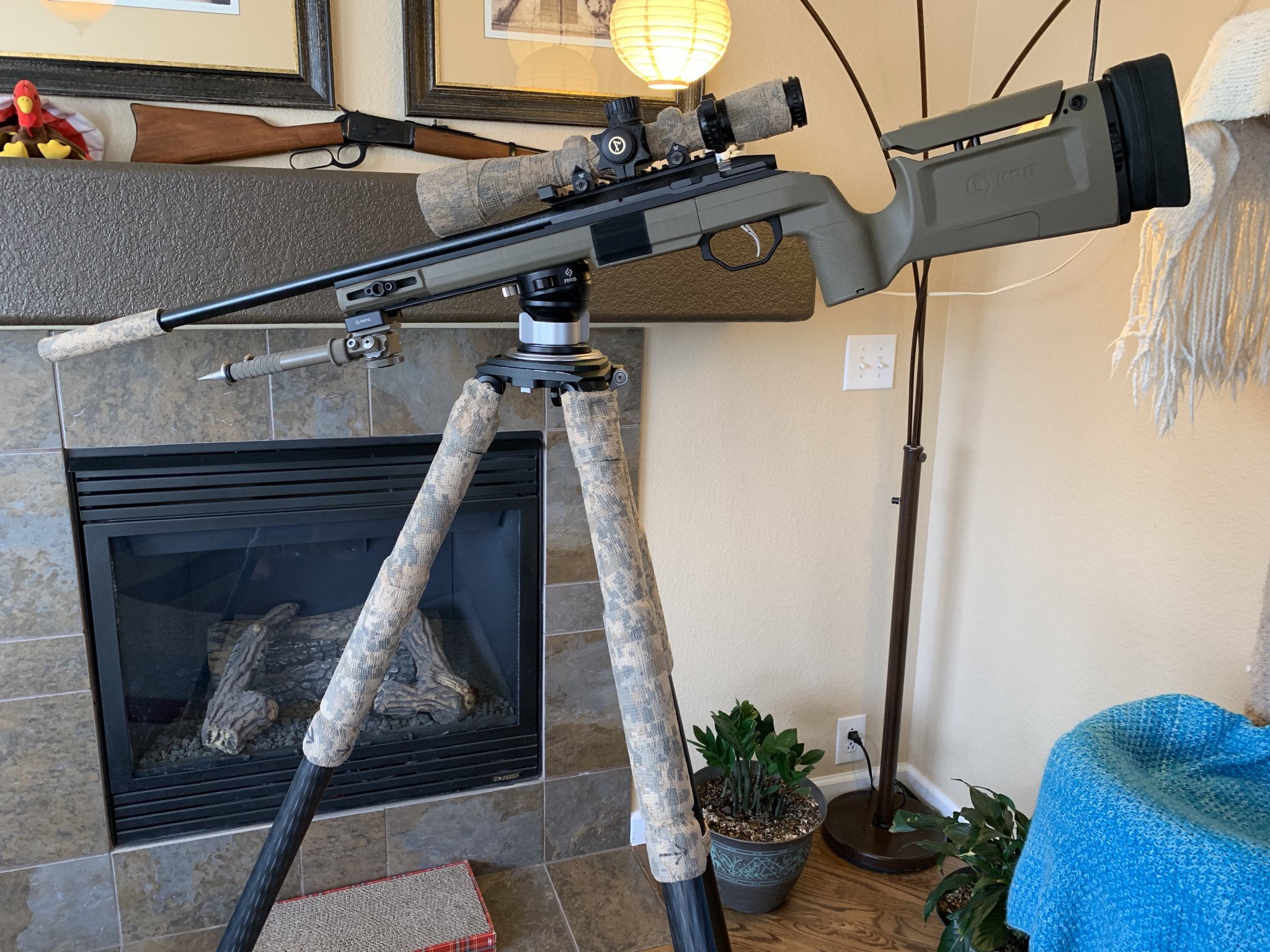

I recently dropped the coin for a RRS 24L with a Anvil-30 head. Used it at my first field match this weekend where it was deployed on every stage in sitting, kneeing, and standing shooting positions.
Was light enough not to be noticed on the hike, stable enough to score hits out to 800 yards, and durable enough dirt/dust didn't cause any problems. I ended up scoring 107/140 possible points and I credit the tripod for doing most of the work. It's totally worth dropping the coin on the RRS gear if you plan on using it a lot and espically for shooting off of.

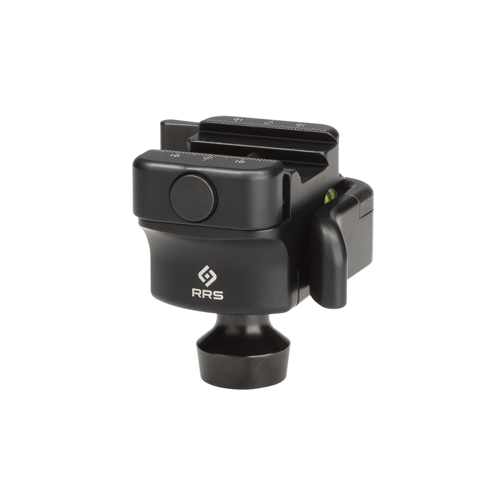

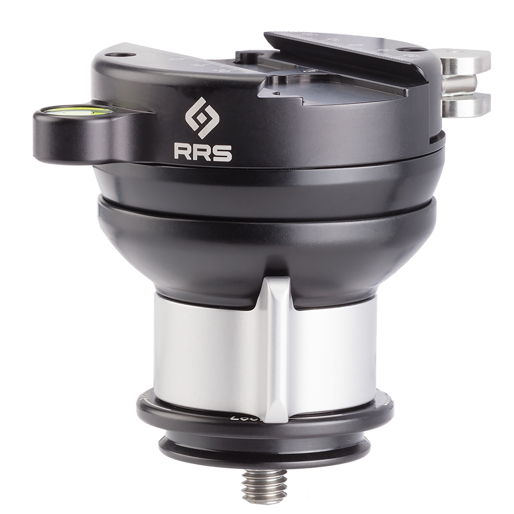

There's A LOT of options out there. Things to consider are; weight, angle of inclination, capacity, how it connects to the tripod.
Because there's so many options on tripods in regards to the fulcrum/connection point, you almost need to know what you want before you buy. Some of it will mix and match and some won't. If it's a simple thread on connection, like a camera, then it should be pretty universal. If your tripod supports a bowl, the bowl size will matter. I've seen adapters and heard of people 'shimming' but this doesn't play well with me.

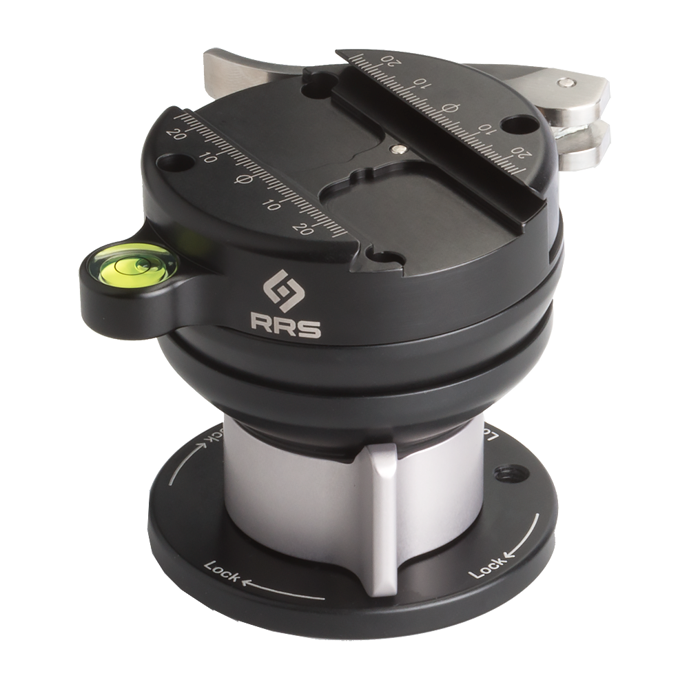

For example, I have the Innorel RT90C but wanted a specific RRS leveling head. I needed a TA-U-LC NOT a TA-2-LC. Basically the same but the TA-2-LC will attach in a bowl in place of the plate where the TA-U-LC attaches on top of the plate in the bowl. You may be able to attache the TA-2-LC on top, but not sure and I wanted the additional contact of the larger lower plate and security Allen head nut.
Hopefully you can see what I'm talking about by looking at the two pictures below.
This is a really sturdy yet light and very quick set up. The downside is angle of inclination. You can't get much angle up or down. Not really an issue unless you need some extreme angles. For that I'd suggest the Anvil 30 ball head. It seems to be the choice du jour but may be limited to what tripods it will work with due to how it attaches. Not sure because I haven't had one in hand to see. See third pic below.
I have a clone BH-55 that works very well. The Amazon reviews state it operates nearly the same as the RRS version but I doubt and hope it doesn't. It's fine for a <$200 ball head vs. the $500 RRS version (last pic). Their cons are weight and cost (RRS). The angles and panning or limitless. There are smaller versions too (BH-40 & 30). My personal recommendation would to be get the RRS first. I'd recommend either of the TA's, I just bought a TA-U, or the Anvil 30. I 'think' I shot off an Anvil 30 a few months ago and it was awesome. I was not familiar with it at the time and its sturdiness vs. its size was impressive.
It's really about budget and spending more on your tripod than rifle or scope is daunting. As I stated above, the RRS ball heads/leveling heads seem to sell quickly and for top dollar. But they are sub $500 and usually sub $300. The tripods are a different ball of wax. You're double to triple if not quadruple those numbers. Harder to find a buyer w/ the kind of money who just wouldn't rather spend a few extra hundred to get one new. When you're spending $1500 on a tripod you might prefer to not save $100. So I'd imagine you'd have to discount the tripod a bit more. That's just an assumption on my part though. I can tell you I've been very happy w/ my Innorel and I've talked to others who are also very pleased. Especially at the price.

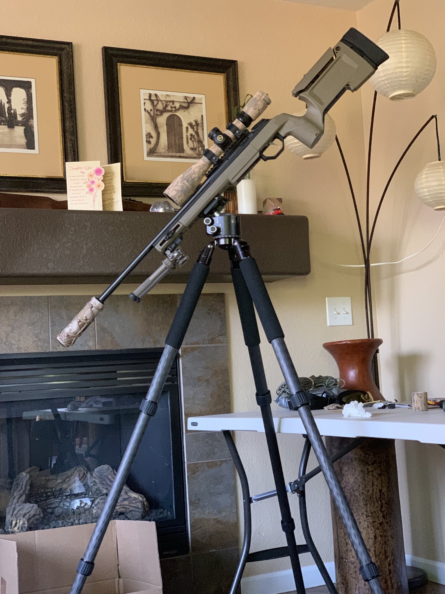

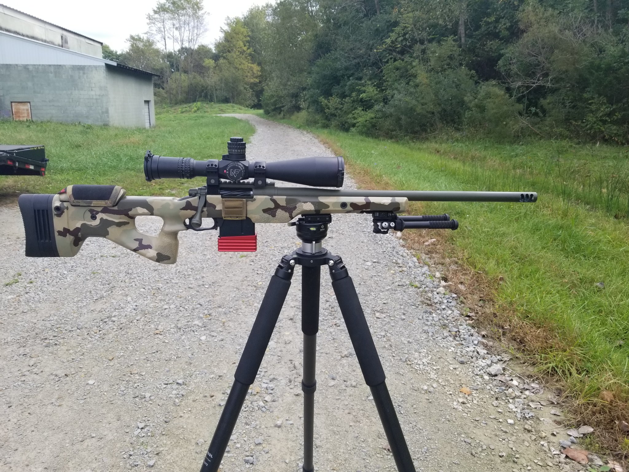

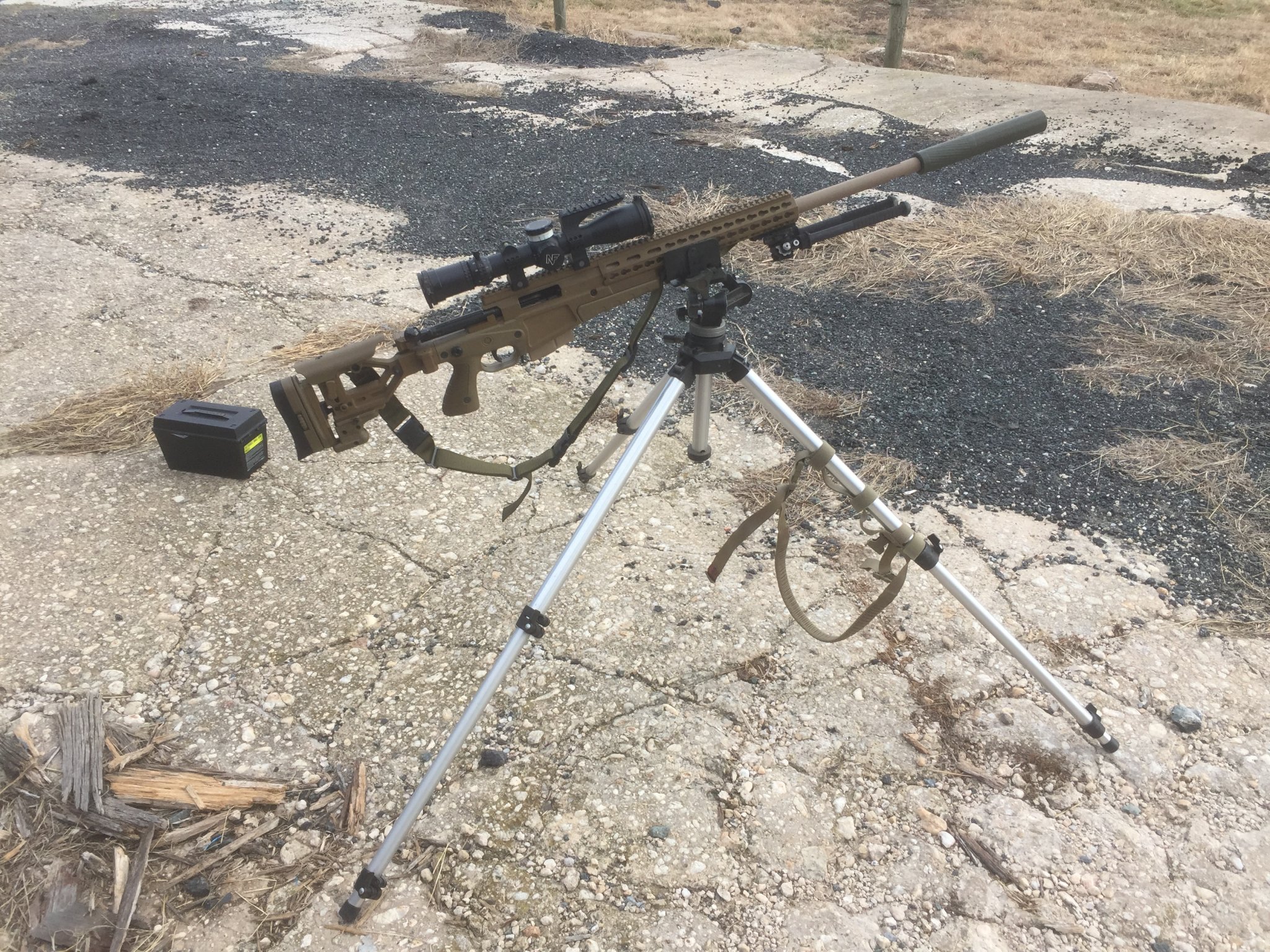

Two pics of my current set up.
DLOW 55 ball head (RRS clone) It's pushed to the edge of the ball head. There's two slots to get more angle if needed. This is outstanding for tinkering with your rifle as well. I shoot very well, usually :geek:, with this set up.
Edit: This is the RT80C before I sent it back for the 90. One of the legs came out when extending it and I couldn't put it back together properly. At least I didn't think I did. It worked after I "repaired" it but I wasn't confident and decided to return it while I still could. I'll take the little extra weight and bulk of the 90. It's beefy.
RRS TA leveling head. It's tilted as far forward as it goes. You can see it's a HUGE difference to the BH55 clone above. The Anvil 30 fills the void between these two and why it's so popular. I haven't shot of this set up yet but I don't believe I'll be hindered by the lack of angle. Time will tell.

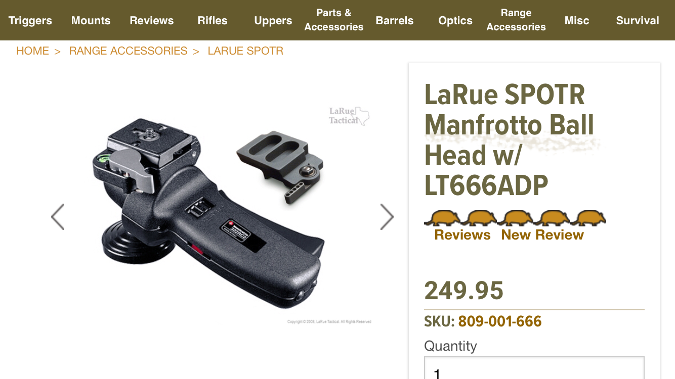

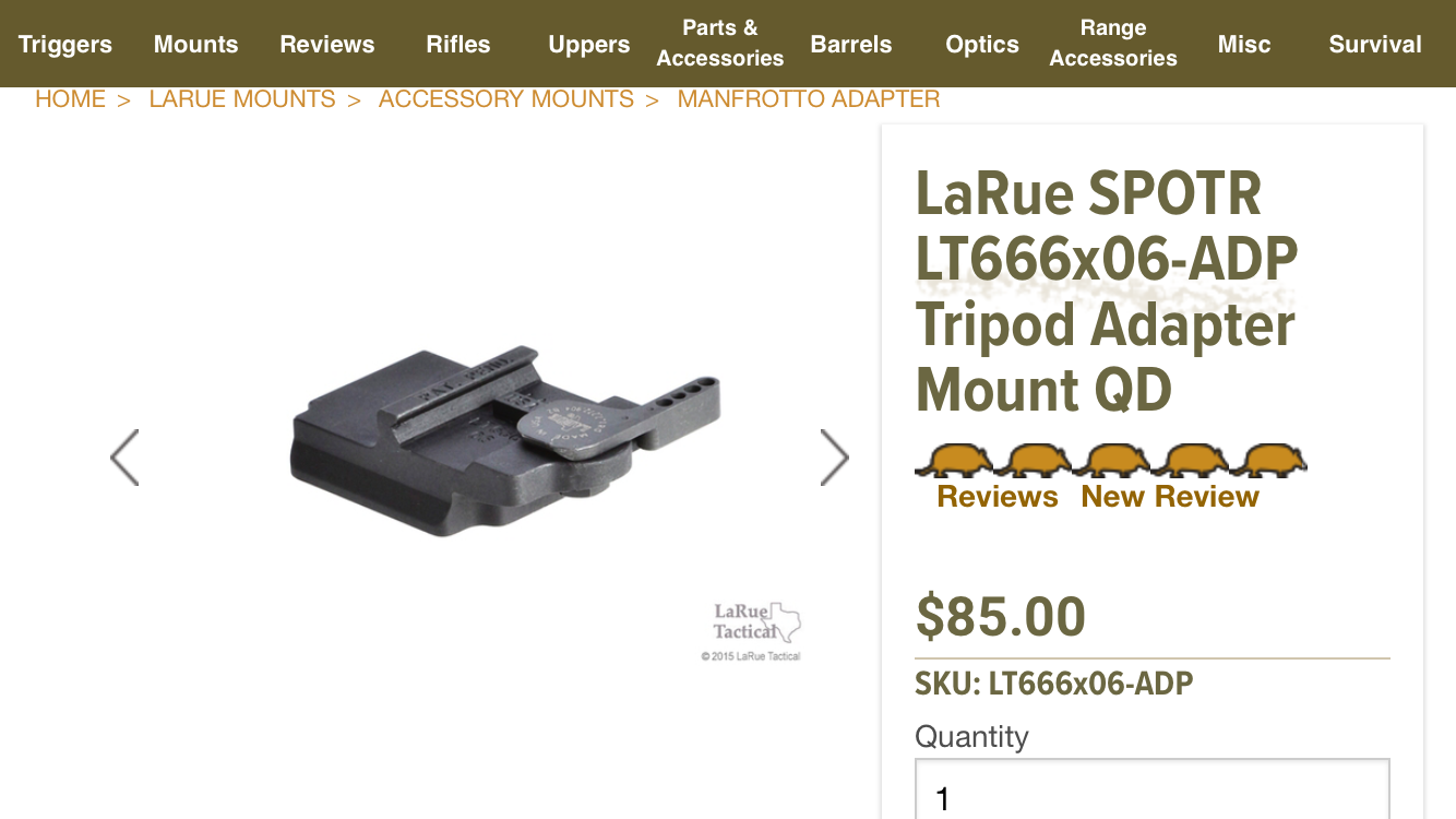

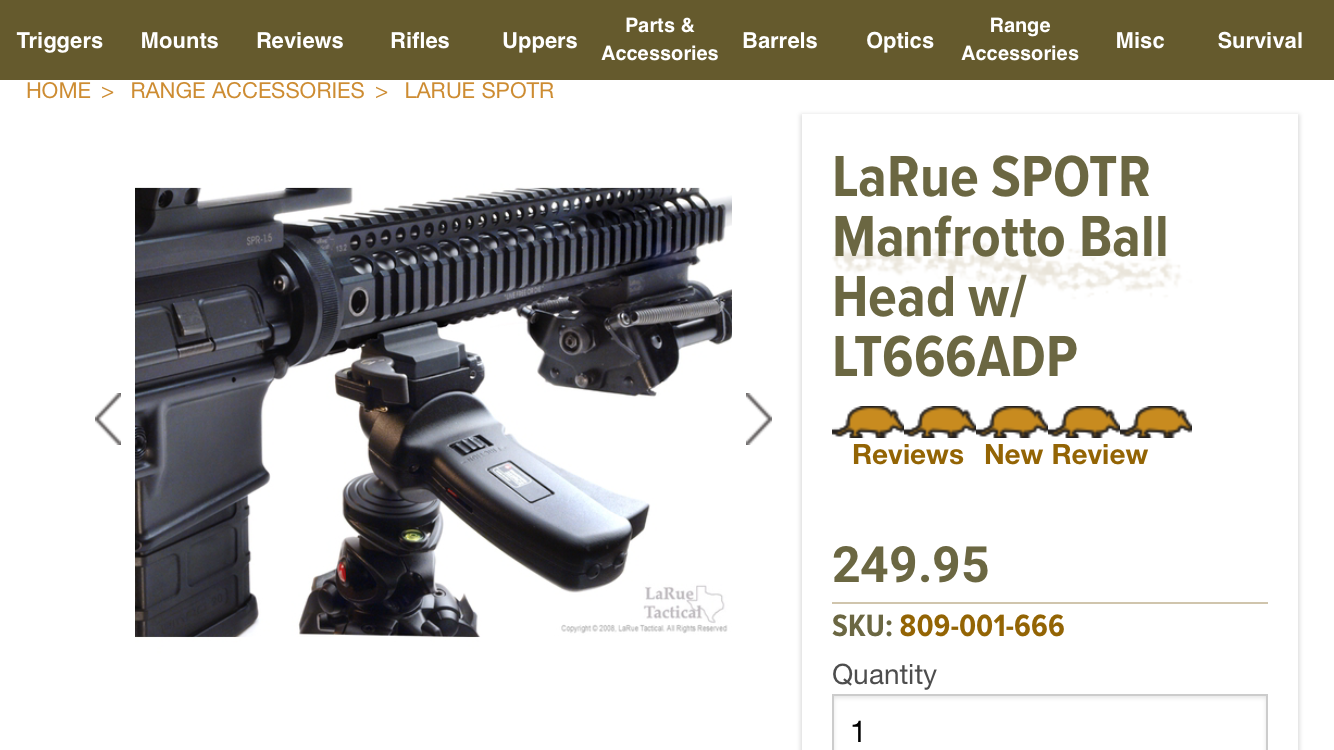

What do you all think about this versus a pig saddle? I have a cheap Bogen tripod with a pig saddle but just found a cheap rc22 head that the Larue picatinny Mount will work on. I don’t want to switch to Arca at this time.
I've used all 3 (above, saddle, and arca) the larue was the least stable of all-it flexed a lot), the saddle came in 2nd, and as others have noted the RRS anvil is hard to beat. That being said, I still prefer the Manfrotto for my spotter setup. It's very fast to get on target.

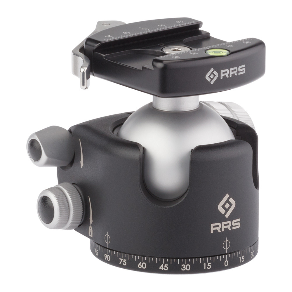

Yes they are, the stability of a 3 series RRS and BH-55LR ball head is stupid.

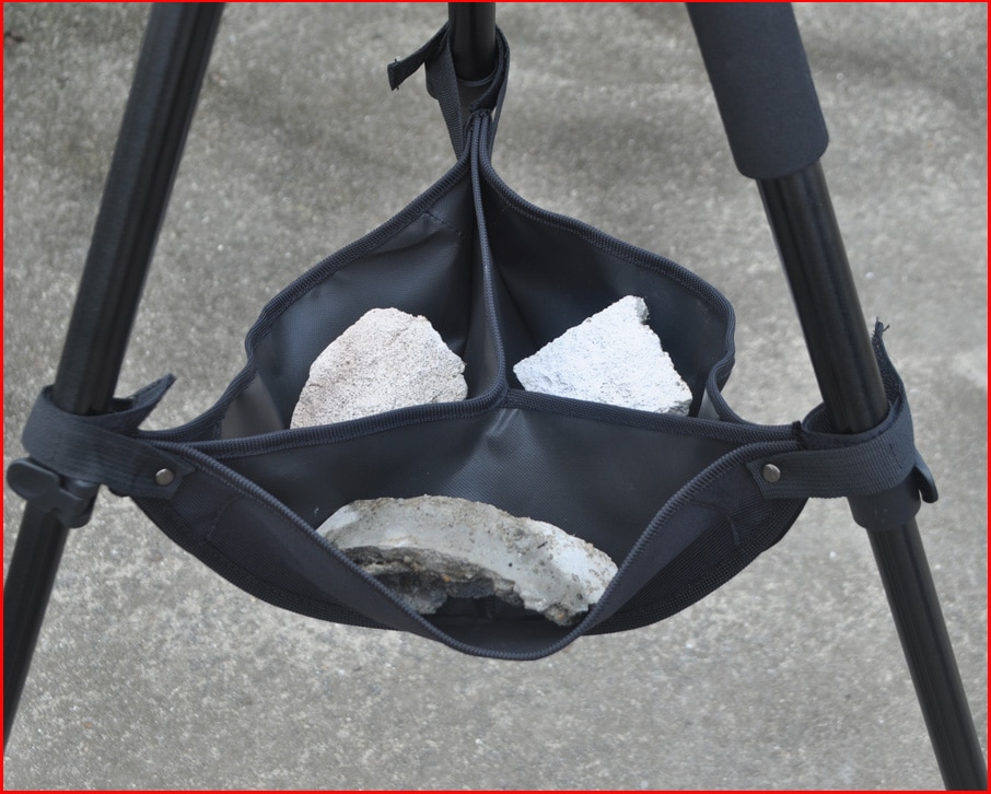

Just hang your pack off the hook to add weight or use a stone bag and fill it w/ rocks when you set up.
This always sounds like a good idea, until the stuff you hang under the tripod starts blowing/shaking around (think sail). Or worse, falls off. Or if you want to move the ‘pod and the extra weight flops the opposite way you’re trying to go. Or the one place you set up only has mud for weight.
The device in the pic you posted looks nice, but will pull your tripod inwards unless you have spiked feet placed deep in the ground. And it takes time to load up the tripod each time.
In short, adding weight to tripods only makes sense if you hike with the thing, requiring a light tripod. If you never hike with it, go heavy. I know it sounds dumb, but man, a heavy wood tripod is a luxury. You just don’t worry about the thing like a dainty featherlight carbon wonder. Sand in the joints? Psshaw! Salt water? Yawn. Just rinse the metal feet (or not). Mud? Hose time. Hitting rocks? Meh.
