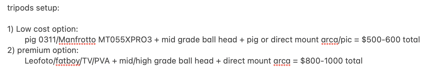

Tripod setup, budget: $500-1000. Seeking advice
colt.45
Nov 25, 2020
91
2
Alabama/Wisconsin
That's the for the total price including a ball head. I know people say to avoid the HOG/Pig saddles in light of modern options, but for my first setup I am drawn to its universal function, as none of my bolt guns have a rail. I figured I could simply use a Pig saddle in the meantime, to understand where I best like to balance/attach my rifles, before I make that permanent decision of screwing an arca plate into my fiberglass stock. That's my thinking anyways.
I'm most drawn to the Fatboy elevate and the two vets inverted models. Both are close in price.
Weight is not a concern. Ergonomics and quality of design are everything to me. RRS is not in the budget.
Anybody have opinions on the Patriot Valley Comp-40? Its the same price as the Leofoto LN364C but advertises a much higher load rating.
