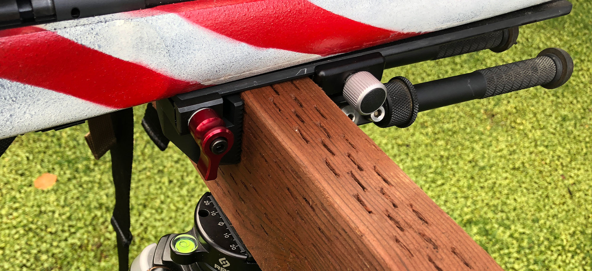

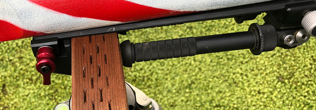

But, in a match you’ll get many more miles from your full length rail than a tripod. Not only can you do the obvious and use your bipod on smaller items like a drum, but you can use your bipod in front of barricades or whatever and let it help manage recoil if the match gods have you twisted out of position.
You can also run your bipod down but in front of the front bag, and do kinda the same as in the image below.
So along with Rob, Sheldon and a few others I would say wait, unless you wanted to use it to practice with a barricade simulator.
