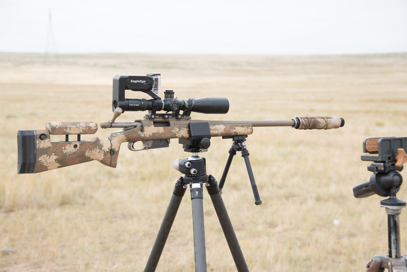

[IMG2=JSON]{"data-align":"none","data-size":"full","src":"https:\/\/scontent.fapa1-2.fna.fbcdn.net\/v\/t1.0-9\/16708589_10155002500477953_1050272576378125972_n.jpg?oh=1bdb1553348810c8988045b88e8d4230&oe=5900BB57"}[/IMG2]
You can see how small the ball head is, one way around it is the leveling base like posted above, or here below:
This direction connection and very low leveling base will take a metric ton of wobble out of the system as compared to the photo ball heads. A great compromise is to get the cheaper legs but then get the RRS ball head too. It's much more robust when it comes to handling a rifle.

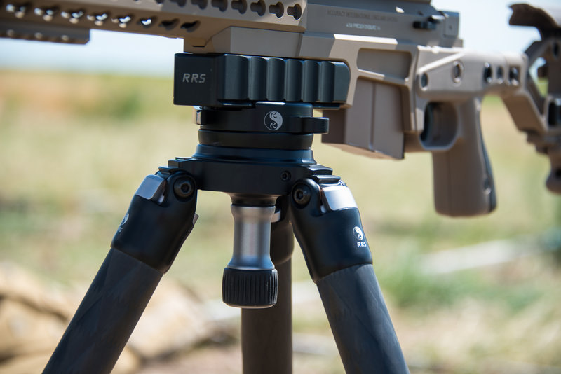

With a KRG stock all you need is to screw on an arca plate. I think there are already screw holes in the bottom of the chassis that you can use. No need for a special plate, any Arca style plate with 2 screws should work. Worst case, drill and tap a couple 1/4-20 holes.
RRS TA-3 leveling base is the low profile model pictured in my photo and Frank's photo with the AI rifle. It will only work in the RRS 3 series tripods (or Gitzo 3 series). The RRS TA-U-LC is the universal leveling base that will work with the Feisol tripods. Two advantages of the TA-3 are that it sits lower with a lower center of gravity, so it's more stable even on the same quality tripod. Other advantage is that the handle underneath is a bit easier to adjust and more intuitive to loosen/point rifle/tighten. Both are very good, and both have an advantage over a ballhead (even RRS's very good BH-55) since they sit lower with a lower center of gravity that has less leverage on the pivot point.
Can't stress enough how awesome a RRS tripod plus TA-3 with hard plate mount is. Very stable, it's like cheating to shoot off of it.

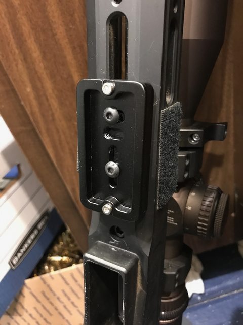

I've not looked closely, but has anyone done the plate install on an XLR element chassis?
Easy peasy for the XLR element. Used one of the existing threaded holes and drilled and tapped a second. The upper screw uses existing hole and I drilled and tapped for the lower screw. The aluminum is very easy to drill and tap.

I'm not sure how much yours weights, but I can tell you that the Feisol 3372 with a RRS TA-U-LC weights 4.5 lbs. Its silly light and silly stable with a hard mount directly to your rifle. Saddles kinda suck for actually shooting out of. The rubber allows your rifle to move more than one would think. I'd suggest moving away from ballhead and anything with a center column. I know 15 degrees doesn't sound like much but its plenty for most things we do with a rifle when it comes to a leveling head.
Lots of guys are also using the 3342 which is a touch smaller version of the 3372 (which is a direct competitor with the RRS legs). I haven't heard of any issues with the 42 series but I prefer the beefier and stronger 72 series when it comes to Feisol.
All that said, if you are wiling to spend the money, I'd highly suggest going with the RRS set up the OP went with at the bottom of page 3 of this thread. Its just stupid good.
Update on my purchase.... I decided to go with the rrs tvc-34 legs, ta-3 LC leveling base for my manners and KRG rifles. All I can say is wow! Very nice unit. Thanks to shanerbanner, Sheldon, lawnmm, and Michael at rrs I know I made the right decision for me at least. Michael suggested for my use to get the 34 instead of 33 because I will also use it for long range hunting and the 34 packs down about 5 inches shorter and he assured me I wouldn't give up anything noticeable on stability with the extra leg section. He was right. This thing is practically like shooting off a bench.
Awesome! Congrats on the purchase, couldn't have chosen a better kit.
Anyone else thinking about pulling the trigger on RRS, give Michael at RRS SOAR a call. He's good people and will steer you right.
