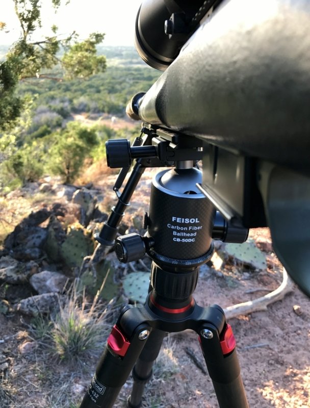

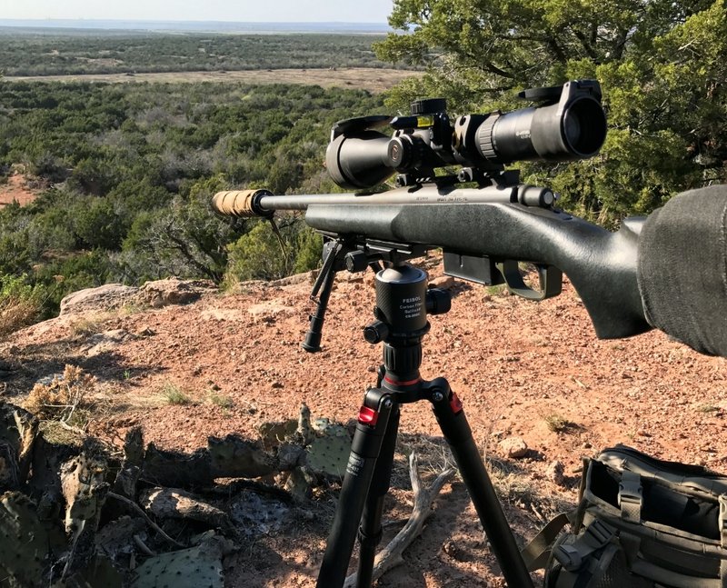

Out in the field with the $370 budget option. No complaints here!
Yes! Happy to see that Desmond is treating you well. Looks like a great setup.

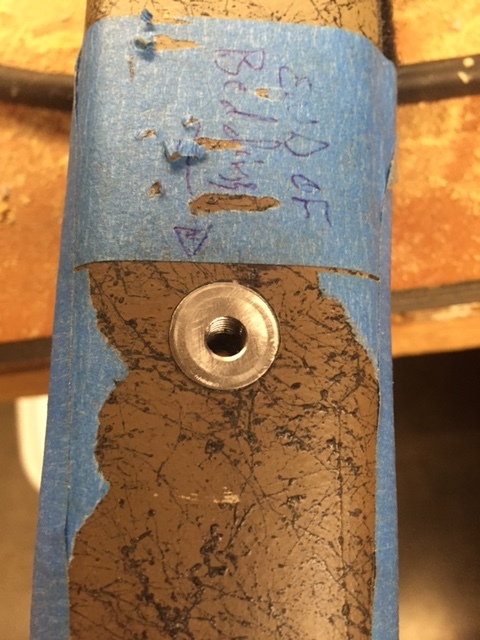

Snapped a closeup pic of the work Travis did for me. I'm very happy I had him do the install for the RRS QD plate. I'm positive my handywork would have looked botched. Mounting the plate under the stock is so much more steady and secure than the HOG Saddle when possible. The HOG will still be great for some things that you just can't mount a plate to though.
I used knockmdown's supply list from this link on the Scout Hide: http://www.scout.com/military/snipe...57929-po-mans-arca-swiss-stock-tripod-adaptor

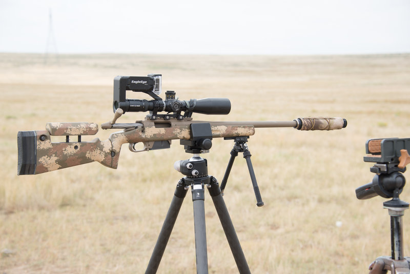

I know I may get flamed for this, but I haven't bought a specific tripod yet. I've been using my caldwell field pod magnum and it has been holding up and serving its purpose. It's a real budget option if that's your main concern...

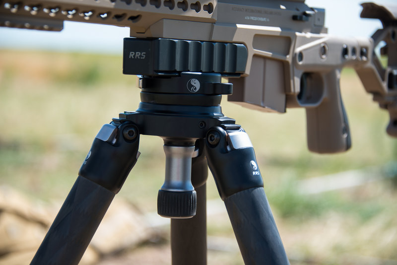

I'm really digging this TA-3 leveling base 4.5" with hook and lever release clamp. I'm assuming this clamp is not designed for picatinny use similar to the SC-LR or Anvil's dual clamping system? If so is there an option to purchase or configure a TA-3 with dovetail/picatinny compatible clamp? Thank you.

You can see how small the ball head is, one way around it is the leveling base like posted above, or here below:
This direction connection and very low leveling base will take a metric ton of wobble out of the system as compared to the photo ball heads. A great compromise is to get the cheaper legs but then get the RRS ball head too. It's much more robust when it comes to handling a rifle.
Another shortcut to take, if you are using something else is to mount the Hog Saddle directly to the tripod without a inferior ball head. If you don't have a very heavy duty ball head, go direct with the Hog Saddle, the lower it is mounted the better.
Now with all these direct connection options having the Swiss Arca / RRS Style mounting plates, we have a much lighter and faster option to work with. For legacy stocks the Hog / Pig Saddles or the RRS Vyce are the best options out there, but for rifles with mounting points the RRS Plates blow away the Manfrotto RC-2 plates.
