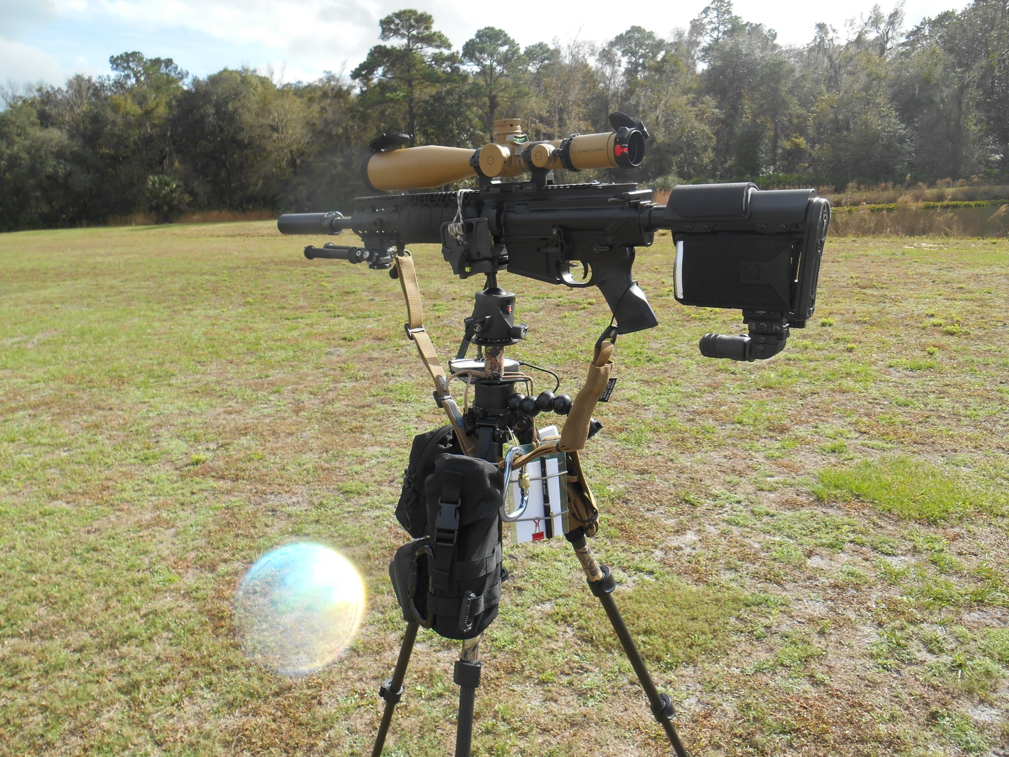

Using a pig tripod you will probably need to learn to use a sling to steady it. Tbey aren't a very stable tripod. That's why people shell out for high end carbon tripods. As for shooting groups. I consider it nesicary for practice no matter what you are doing. Unless you use a very small plate. If your just banging a large plate and using all of it you have no room for error in wind calls. Shooting groups on paper tells you everything you are doing wrong and then it is easier to improve

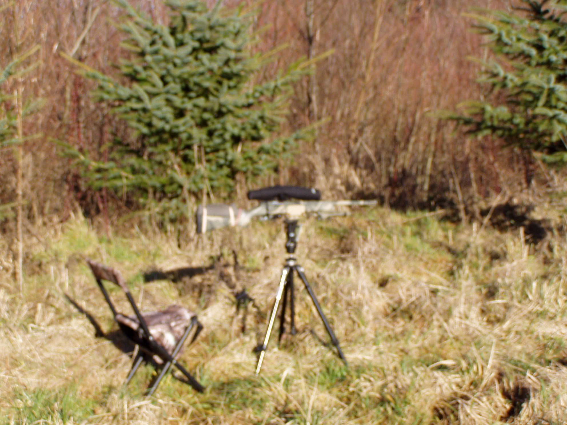

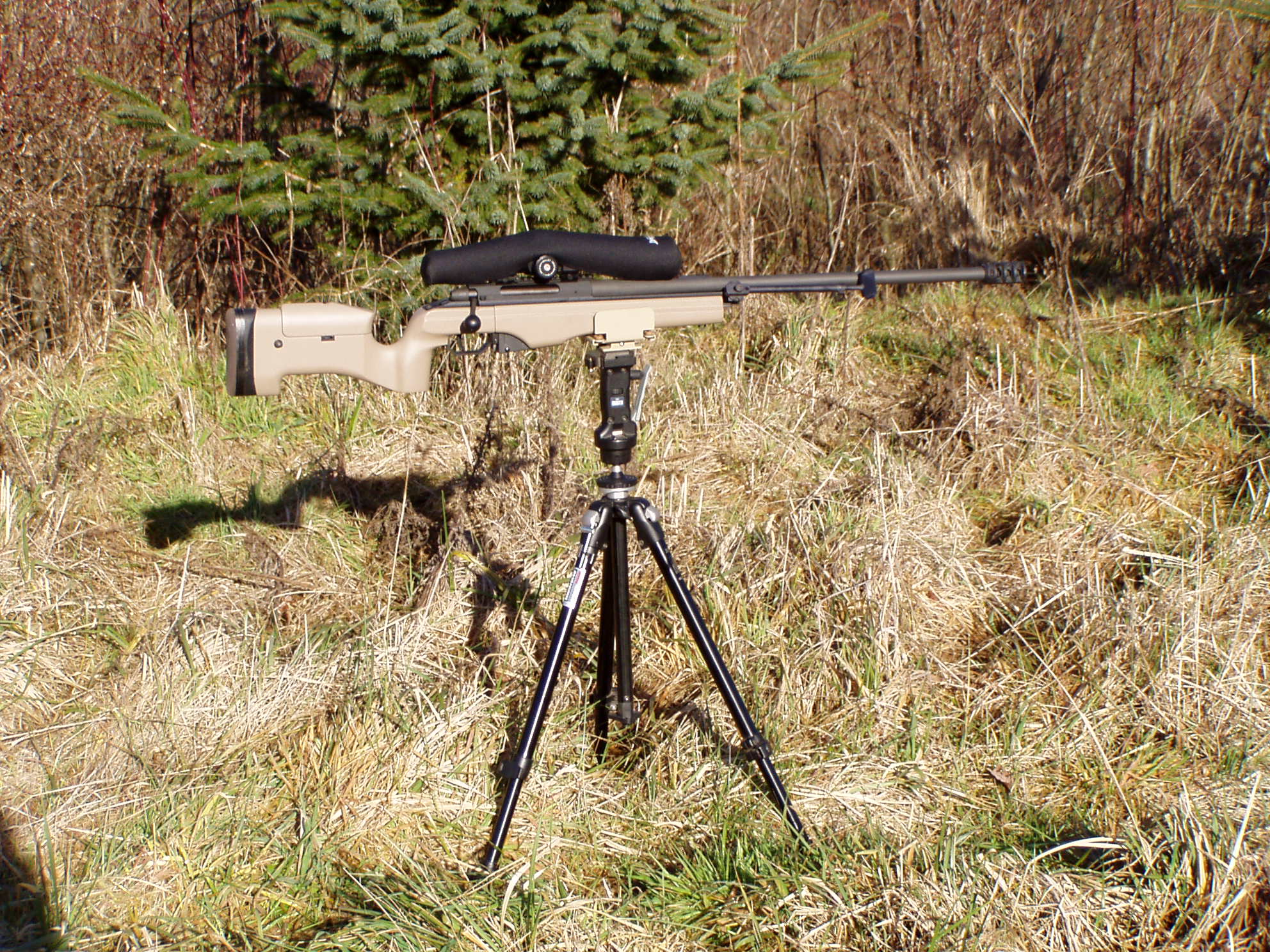

I've used a tripod quite a bit for shooting rockchucks. The set-up is a dove stool to sit on and a Manfrotto aluminum tripod with a pistol grip head and pig-saddle. Sitting on the dove stool you need minimal height on the tripod which makes for a pretty steady set-up. I use no connection to the tripod. The forearm is in the pig saddle at about the balance point and I reach across my chest, grab a bunch of shirt above my armpit on the strong side and rest the butt on my fist. Now, I put my elbows on my thighs and I have a stable platform.
The question is obviously how stable? The answer is my varmint guns are about half MOA off a wobbly round patio table using bi-pod and rear bag. With the tripod and stool they are about one MOA.
First pic is one of the .223s set up. Third pic is a TRG42 to show the set-up will hold a heavier rifle. Second pic is results from a stand and about an hours work. Sorry about the quality of the first pic. The weak spot in all this is the pistol grip ball head. I should have chosen a lever lock ball head.

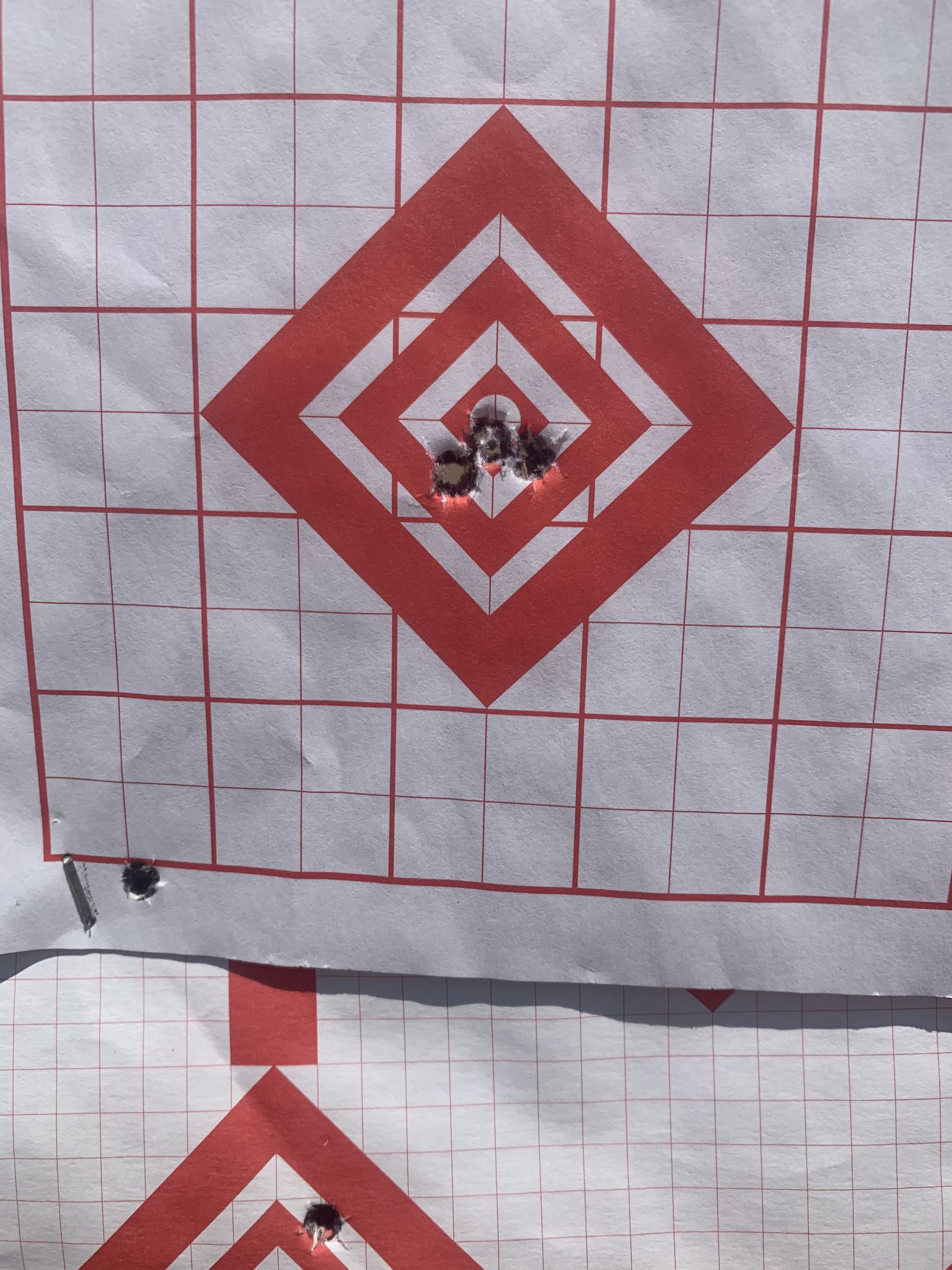

@McMillan, @Dthomas3523
im shit off a tripod because i dont shoot it that often

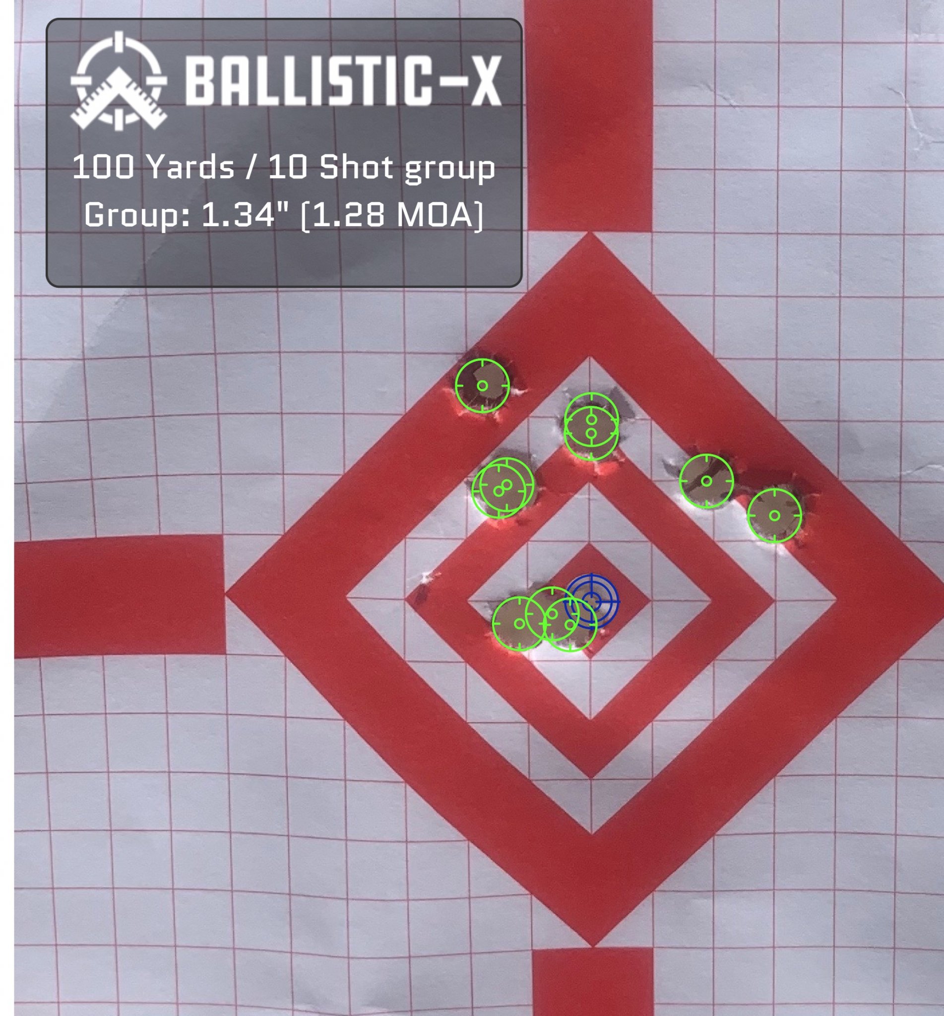

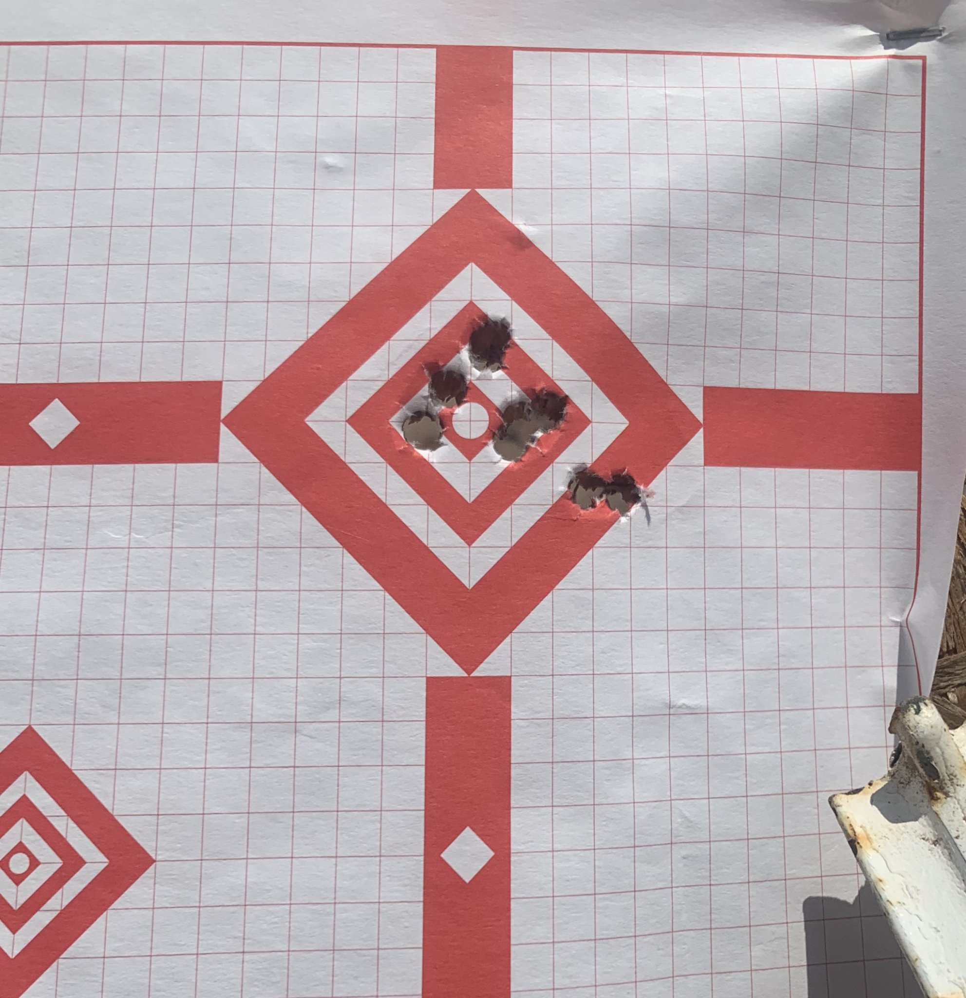

ive seen groups from DT with a pretty thorough explanation
id love to see mclillan pics with the same, maybe even a video
i might learn something and retain it for more than 5 min lol
saying around here "if there arent pics it didnt happen"
shoot groups to gauge your hit probability
hit is a hit, when its for score/game...but if youre shooting a 2x sized group at x distance under no pressure, your just hoping to get lucky shooting at an x sized target any other time
i wouldnt be comparing results closely from a rrs or similar type carbon tripod direct attached against a pig tripod and saddle...arent even in the same ball park and require much different approaches
