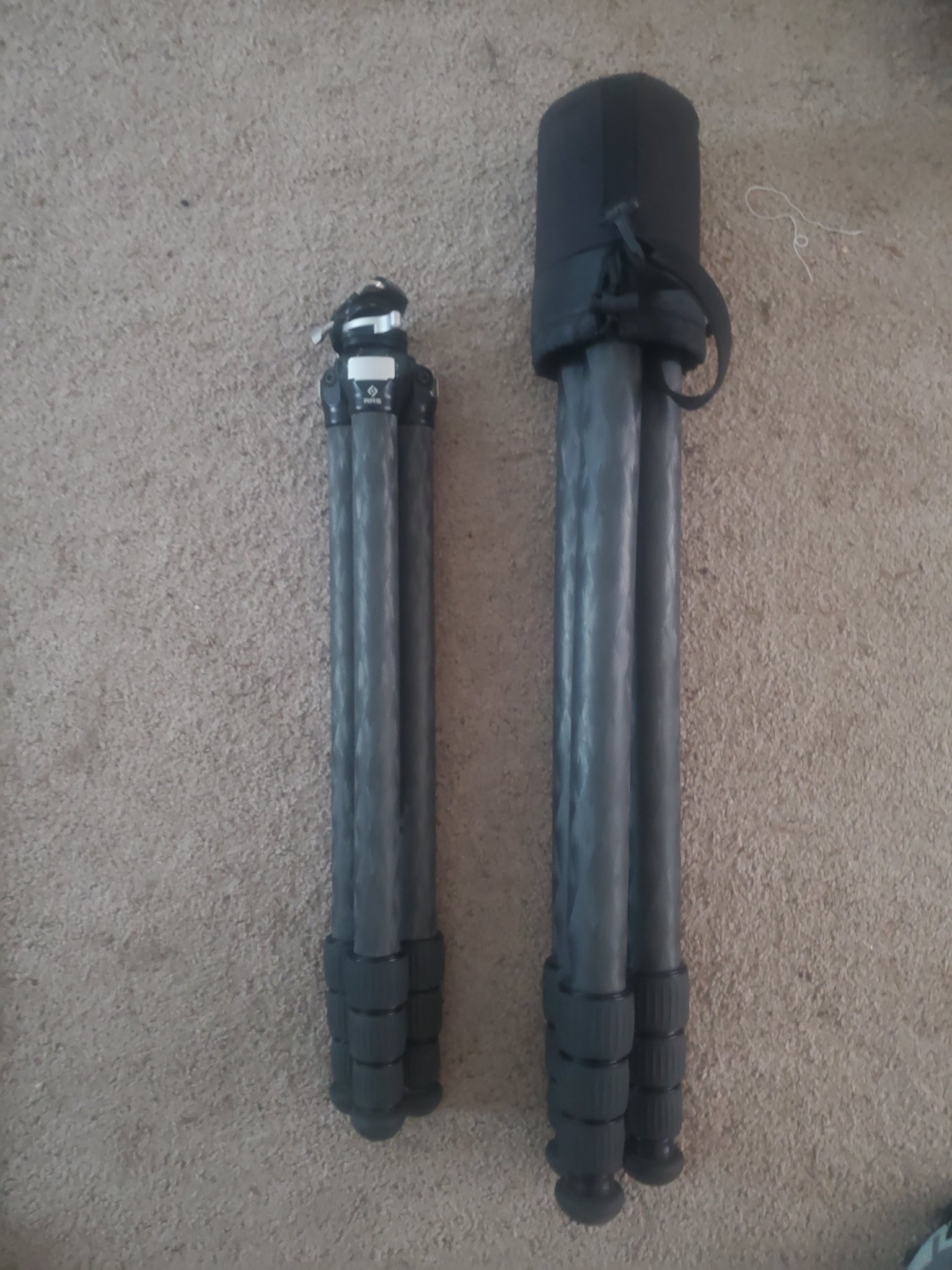

There is no comparison on the stability of the 34L and 14L. However they both serve a purpose. I need the height because I run a straight spotter, my hunting partner runs the regular 34 and it fits in his pack better. He also runs a angled spotter. Both are plenty high to shoot off of.
