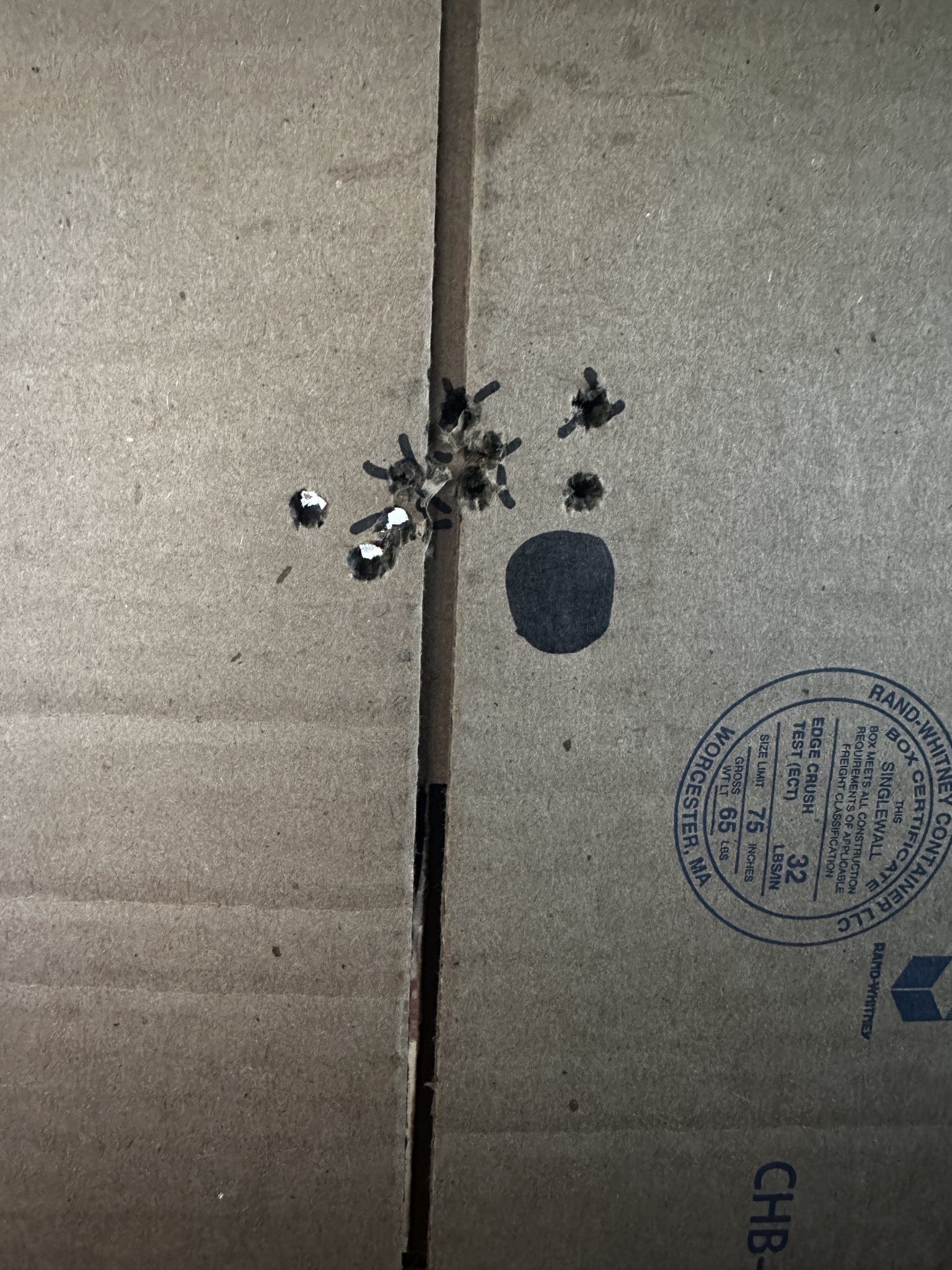

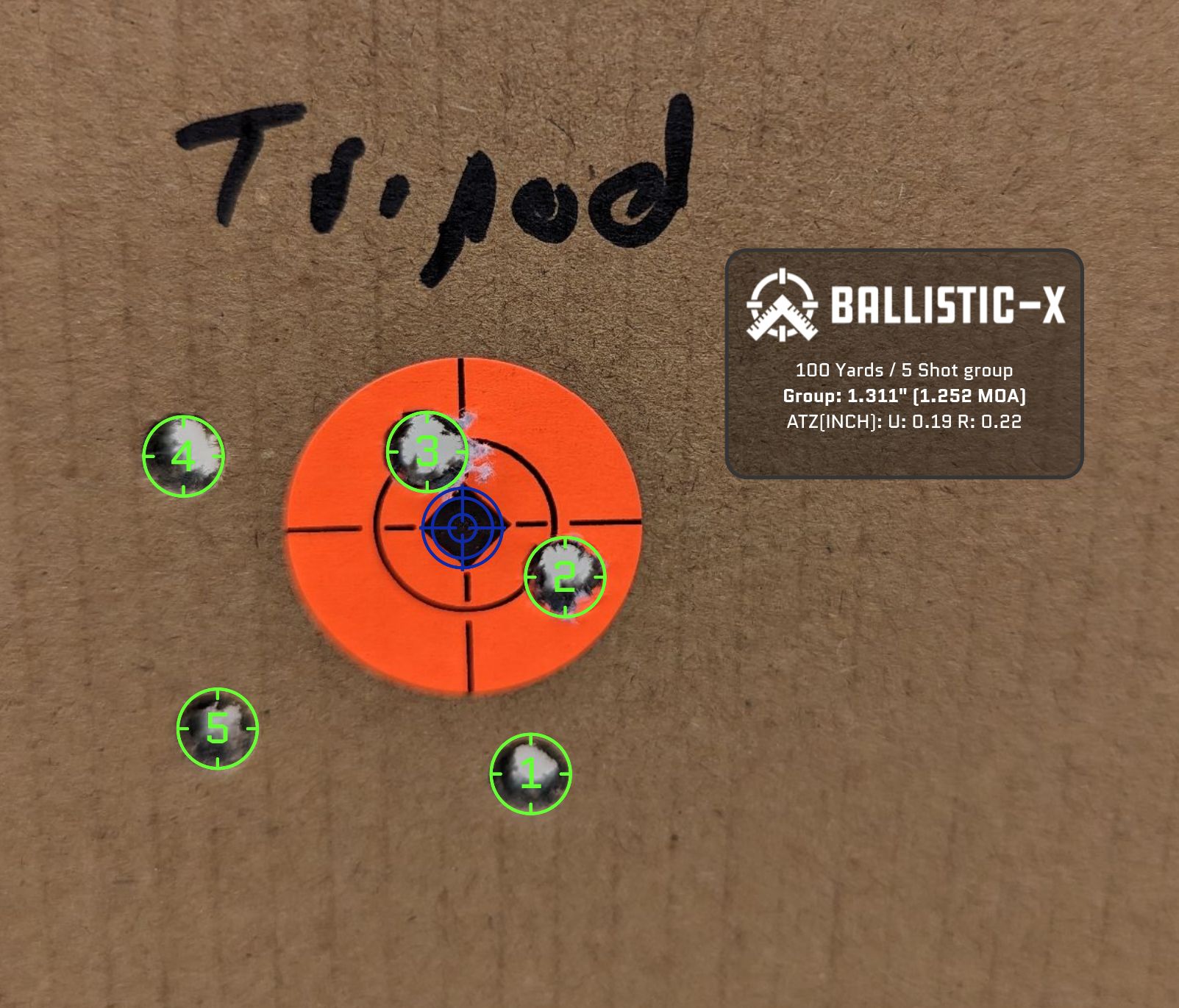

Here's a group I shot yesterday off tripod.
Its .75" at 150yds or
.75/1.5 = 0.5 iphy
Standing off RRS/A-30 with rem700/criterion 22" hbar/krg bravo/harvester suppressor, NX8 2.5-20x t3, hdy black amax 155
Its definitely possible to get 0.5 iphy !

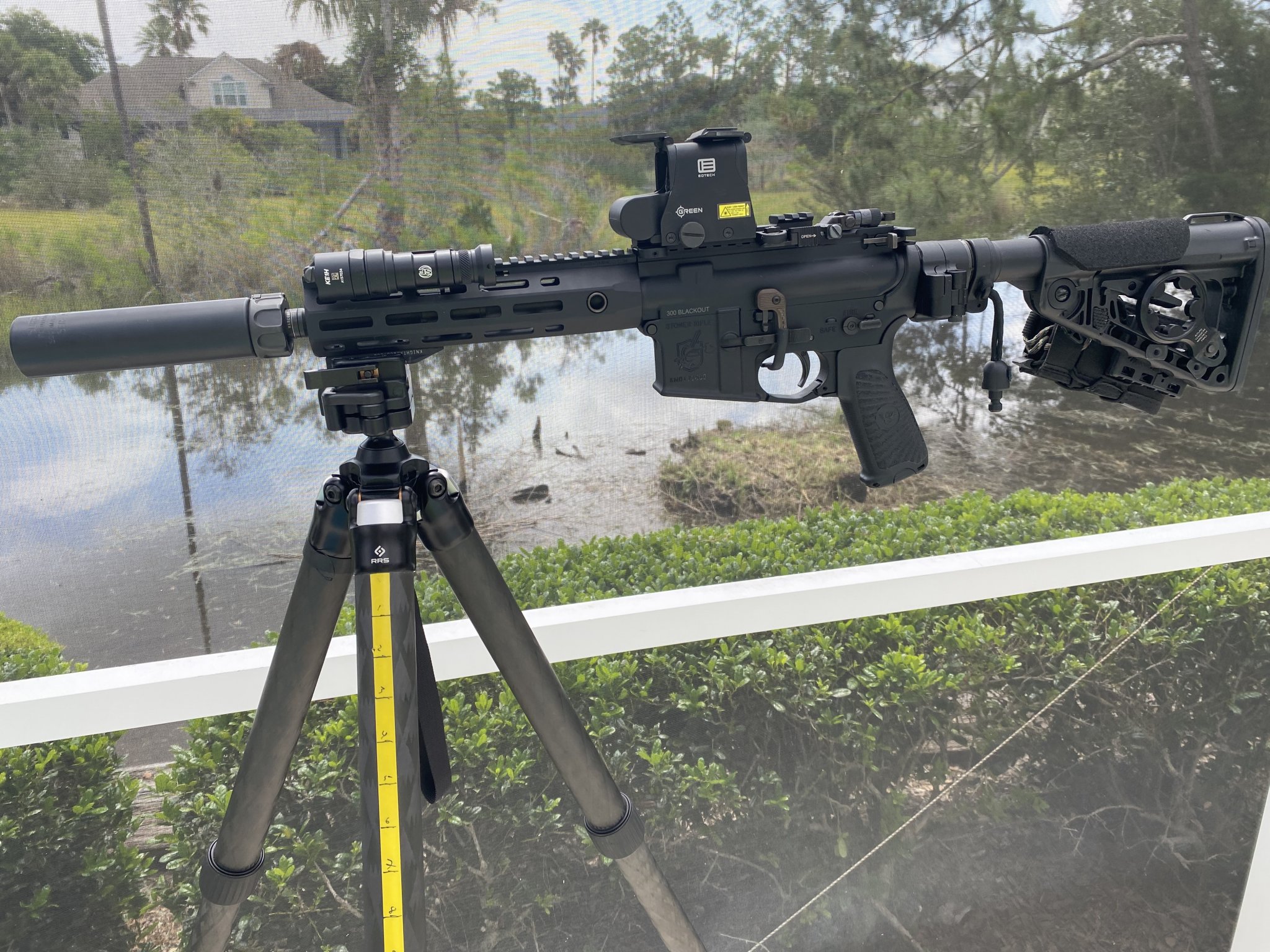

I've never understood why tripod companies don't laser etch a ruler down the tubes so you can quickly put it exactly where you want it if the situation dictates it.
I ended up applying tape with measurements to top segment. Not perfect but it gets close fast. Maybe RRS will step up with label tape decal measurements to apply to the legs, retro-actively.

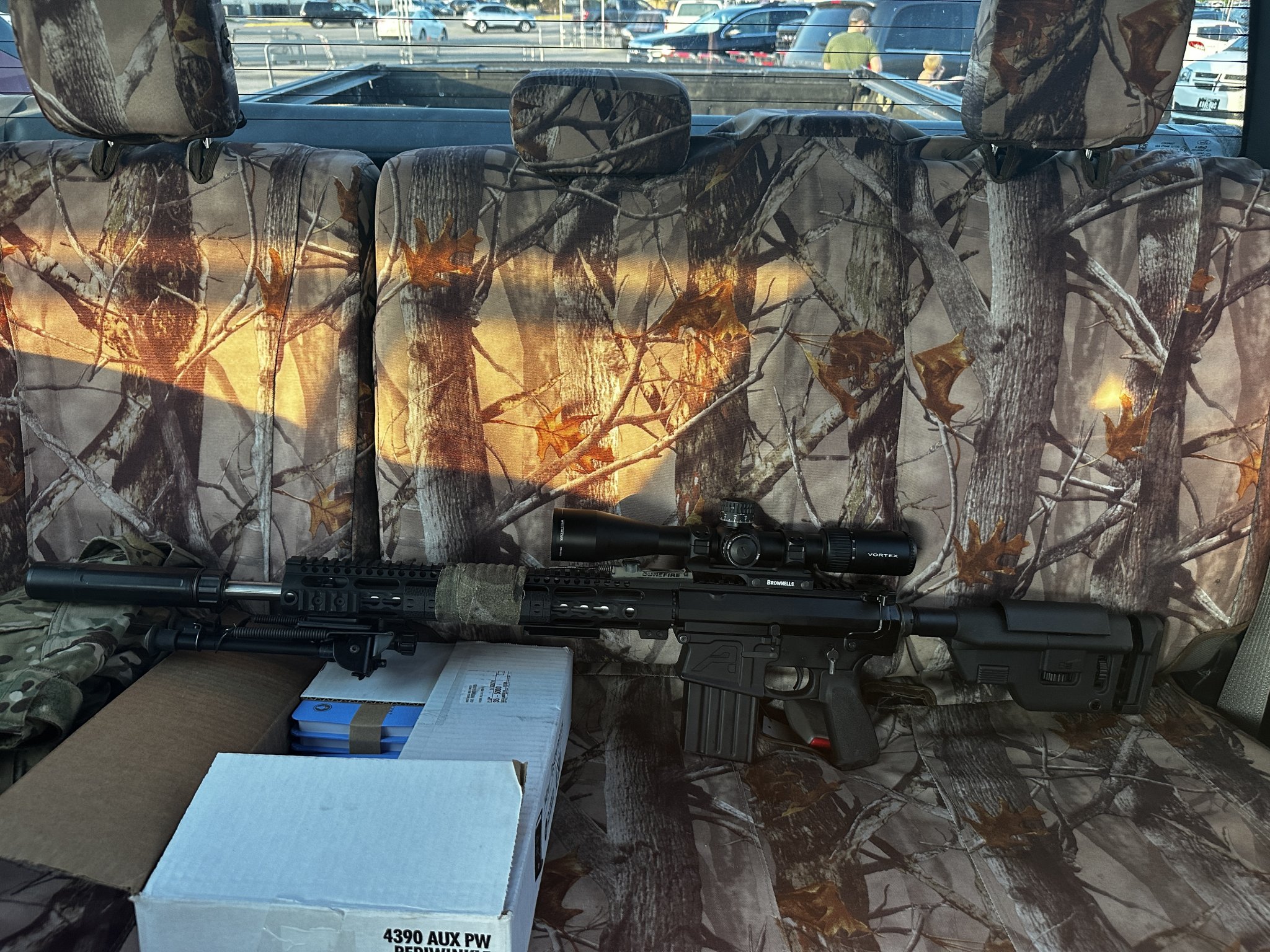

IMG_7226REALLY RIGHT STUFF CT-34 WITH ANVIL 30 POOLSIDE RIFLES 05.19.23KAC SR-30 copy.jpg
IMG_0182KAC SR-25 WITH SUPPRESSOR BLACK SCOPE & SLING RMR MOUNTED POOLSIDE 07.30.21 ANNOTATED ...jpg

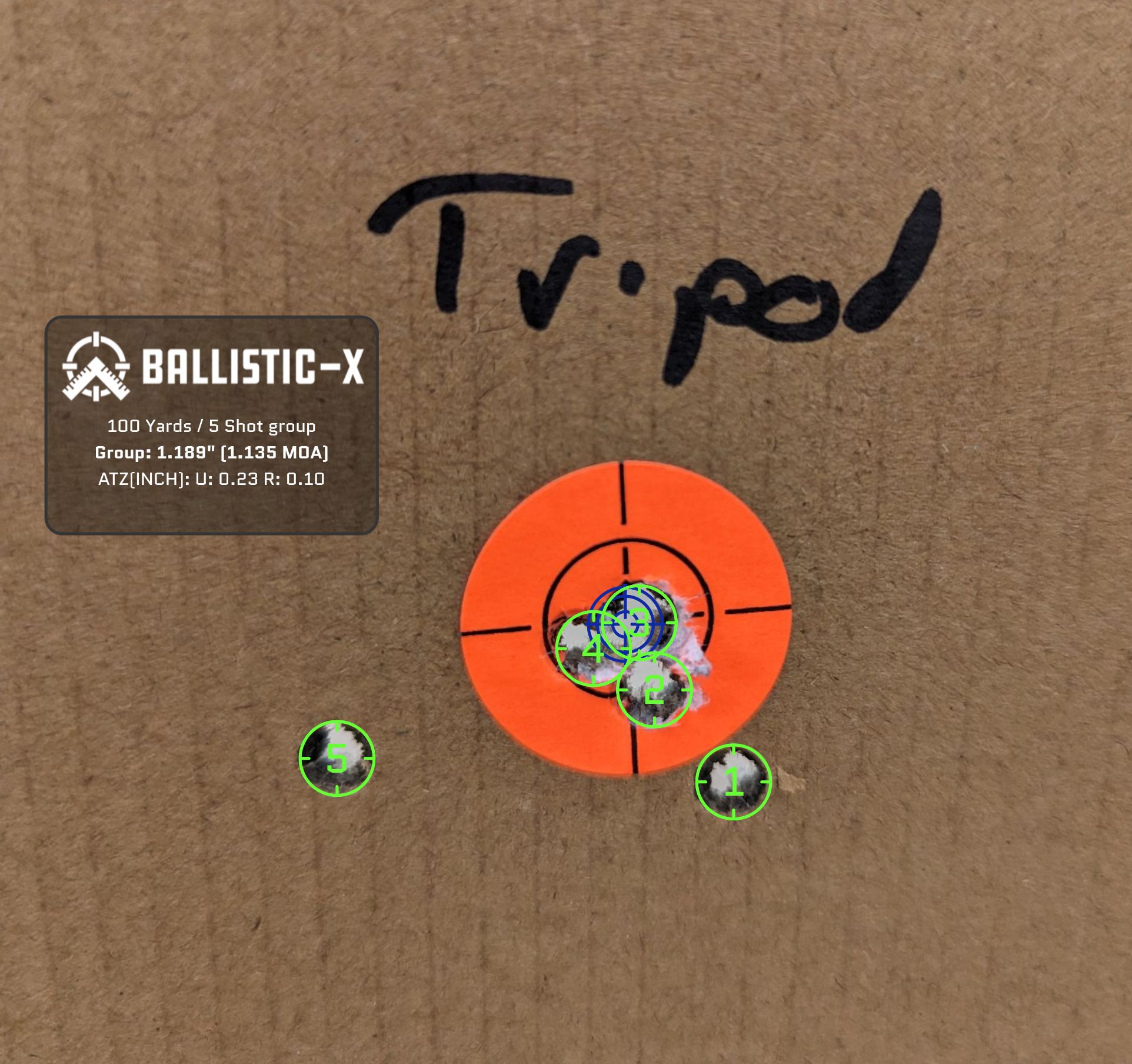

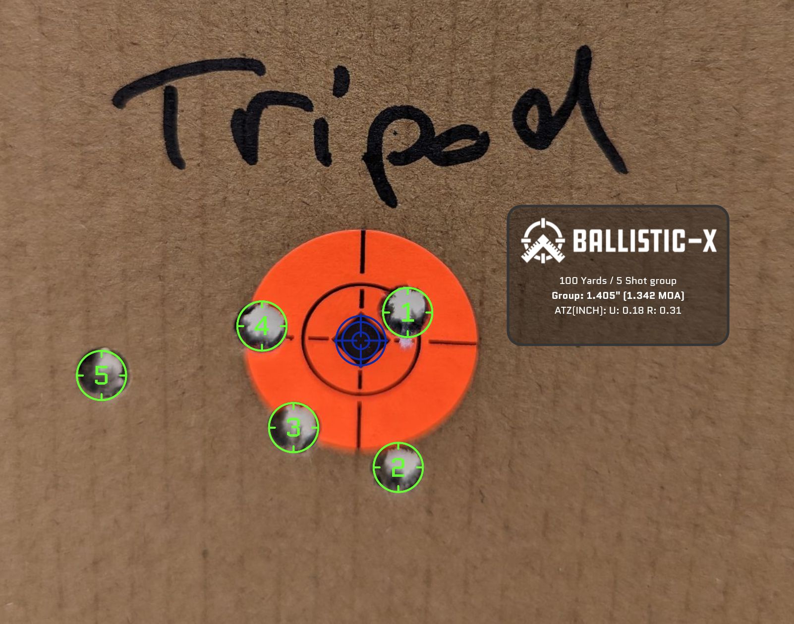

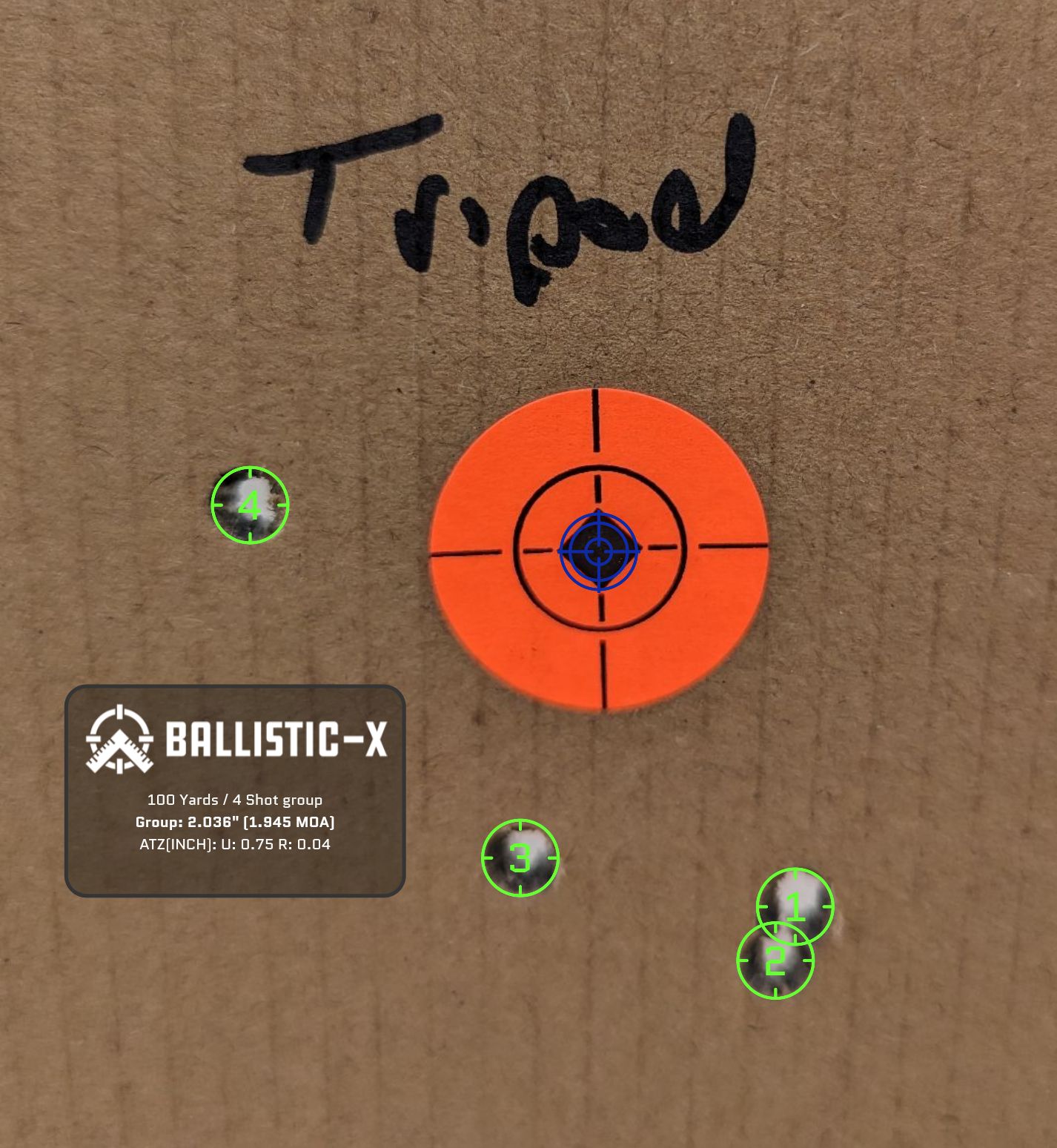

I decided to see what I could group with a tripod today. I knew it wouldn't be anything to impressive but it was a good exercise to try. I'd shoot a group from the bench, then change over to standing off a tac table with a bag. I'd shoot a bench then tripod group then go do something else and come back to it throughout the range time.
Off the tripod I'm trying to time the wobble and the results aren't often timed right or the impacts aren't where I was expecting. Also if I put too much input into the tripod the group goes to hell. The second group is an example of that, leaning into the tripod too much. I'll try this again in the future plus it would be interesting to compare clipped in.

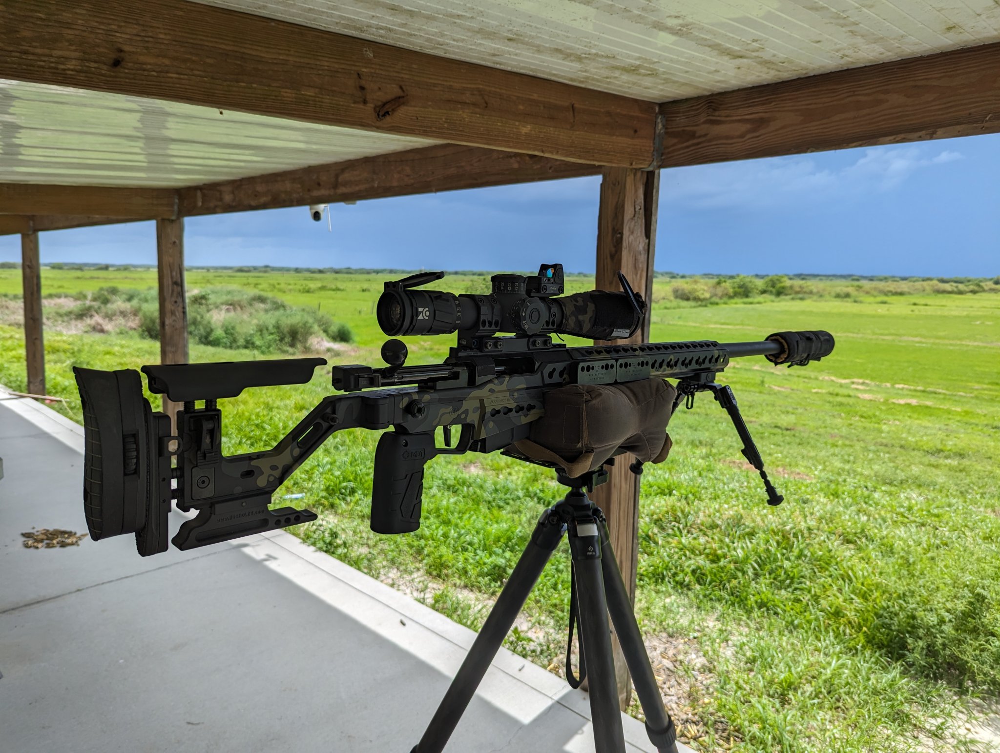

Use a tripod to shoot 338 Lapua from a variety of field positions. Rifle is heavy, around 21 lbs so recoil is a long heavy push. Currently use a PIG saddle set up on the point of balance and lock lightly on the target. Find dropping the magnification and not chasing the wobble gives better results. Run a simple single baffle brake so muzzle blast does not strip everything loose in the vicinity and throw it in the air. No silencer as the barrel is 29"
Always learning and interested to hear a better technique for heavy rifles with more recoil.

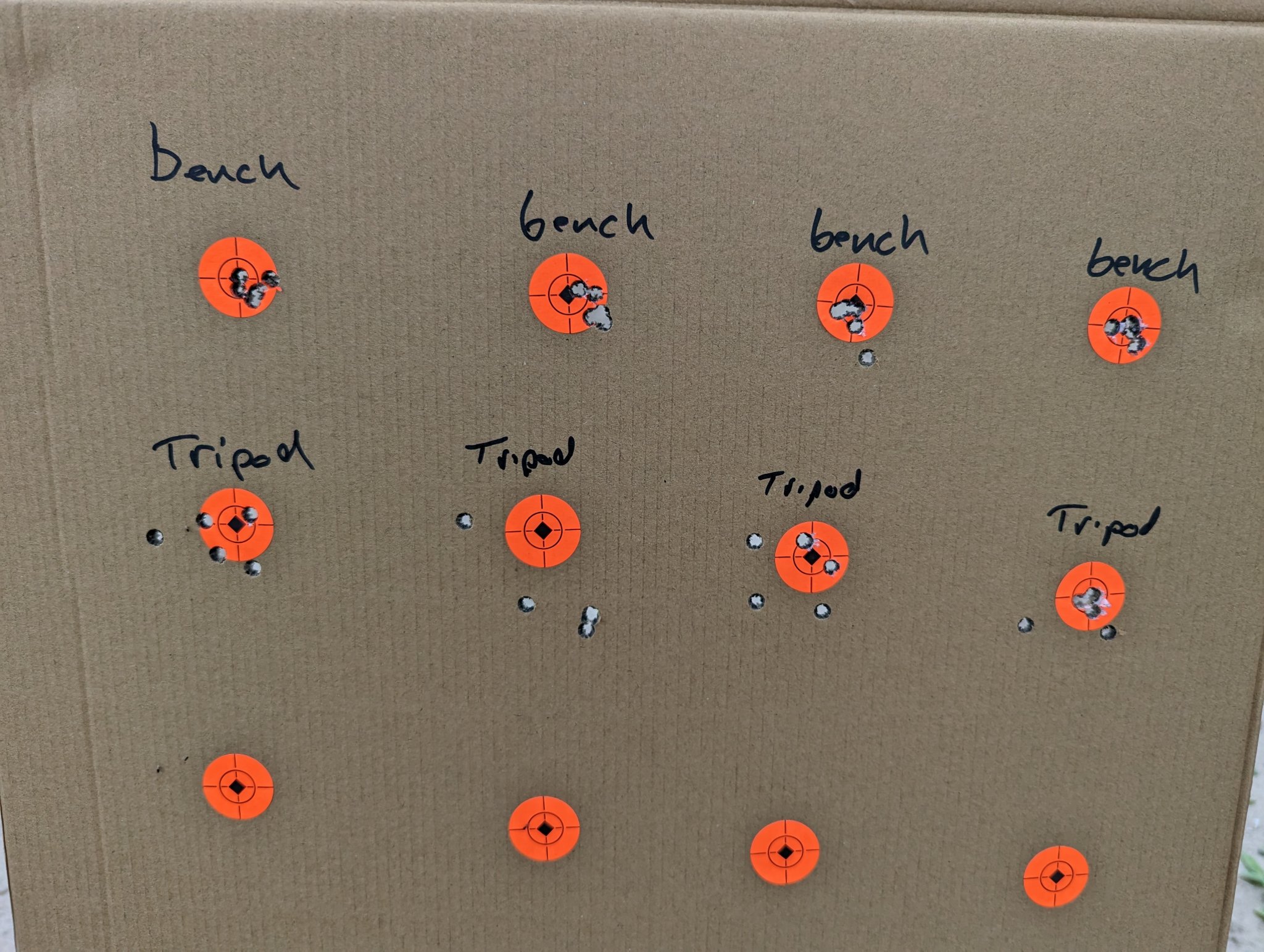

Shot 5 prone and 5 from the tripod (standing) and expected a lot more variation. As best I can tell, my groups opened up to about 1.5x what they were. Prone rounds were marked and tripod shots were left unmarked.
Will measure groups later, but I had one flier go 2 o’clock from each group which I just need to eliminate.
After these 10, I adjusted 0.2 mil right and shot a blackbird at 150yds to 175yds prone. Second pic is the rifle I was shooting (18” Criterion 6.5CM which I’ve come to love)
