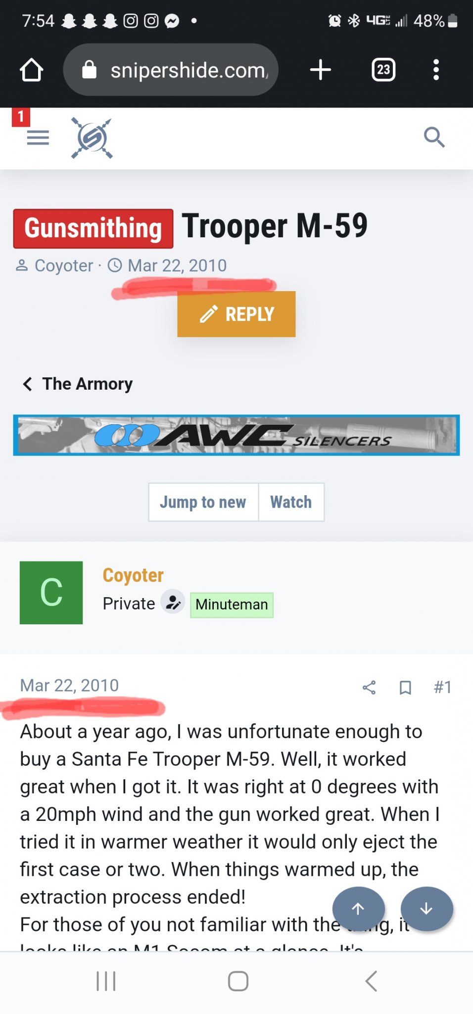

Hey thanks for contributing helpful info. Welcome to the forum. Just a heads up, this thread is almost 13 years old.
