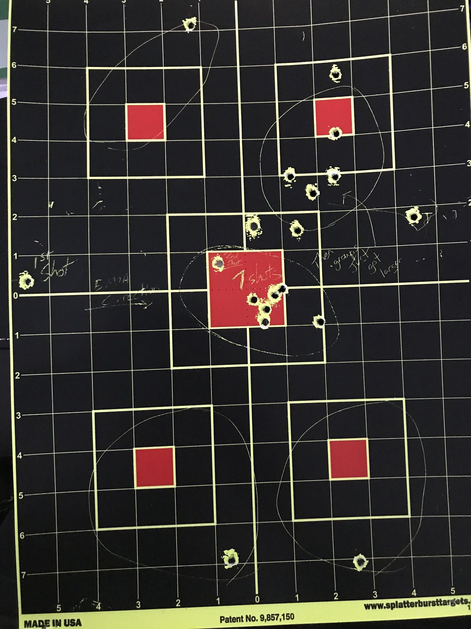

I am just starting out shooting as a serious hobby the past the last two months. I have a custom AR-15 that I bought from a family member gunsmith which has a EoTech VuDu 1-6x optic. I took it to the range today and tried to zero at 100 yards. Bore sighted at 25 then took first shot and hit left approx 5 MOA off. The scope adjusts 0.2 mrads per click so did the conversion and adjust 7 clicks. Second shot was in the red but a little high. I adjusted 0.2 mrad down then fired off a 5 shot group that I was kind of happy with. The next shot however was low and to the right, followed by high in the center, then high to the right. I figured it was just me and moved to the top right target and couldn't get a group at all. I then shot the top left, bottom left, and bottom right to see if I could pick up on something I was doing, but there was no consistent pattern. Set up a new target and it was all over the place and eventually missing completely. I am not home at the moment to check the scope mount rings but I suspect that may be the problem. Other then that maybe the barrel got too hot? or maybe i just need to stop sucking. Any advice?

The rifle is a custom AR15 built for me chambered in .223/ 5.56 and the spec sheet he gave me for the barrel is a Ballistic Advantage 16" barrel with 1:9 twist rate. Just shooting factory ammo (Federal American Eagle 55 grain FMJ .223). Shot off sand bag and little home made sand sock as a rear bag. Was at the range for a hour, and this target was 20 min. Rest of the time was trying to troubleshoot, which included 10 min cooling off then trying to get back on target at 50 yards without success.

Thanks for the replies. The scope mounting screws were pretty loose when I got home so I think that may have been my problem. Will start using match grade ammo as suggested. I just went out to get it zeroed quickly and ran into this problem and didn't want to repeat it next week. All this info though gives me a lot more to think through now as I get more involved in shooting. Much appreciated.
