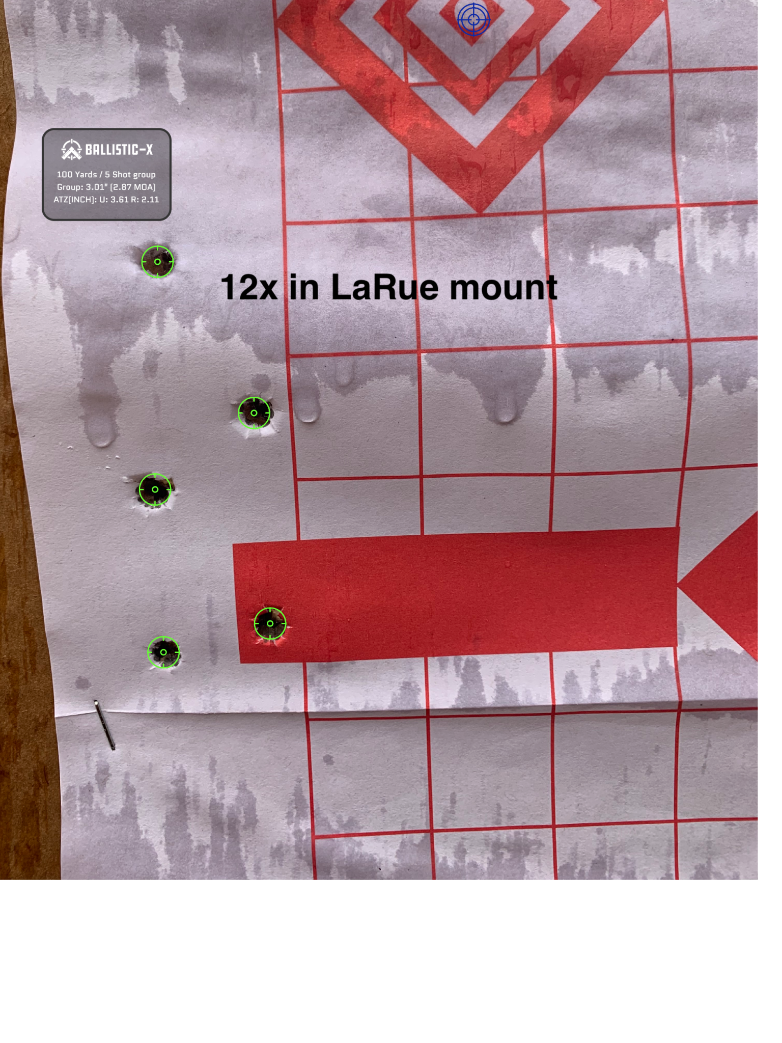

I picked up a 6.5 Grendel upper on here last week that has been...disappointing. Looking for tips to trouble shoot.
18” Wilson Recon barrel
Odin works AGB
Warcomp brake
I was told only 80 rounds through it. I’ve run about 75, all with results similar to the attached images.
It cycles perfectly, piles brass up in a nice little pile right at 4 o’clock.

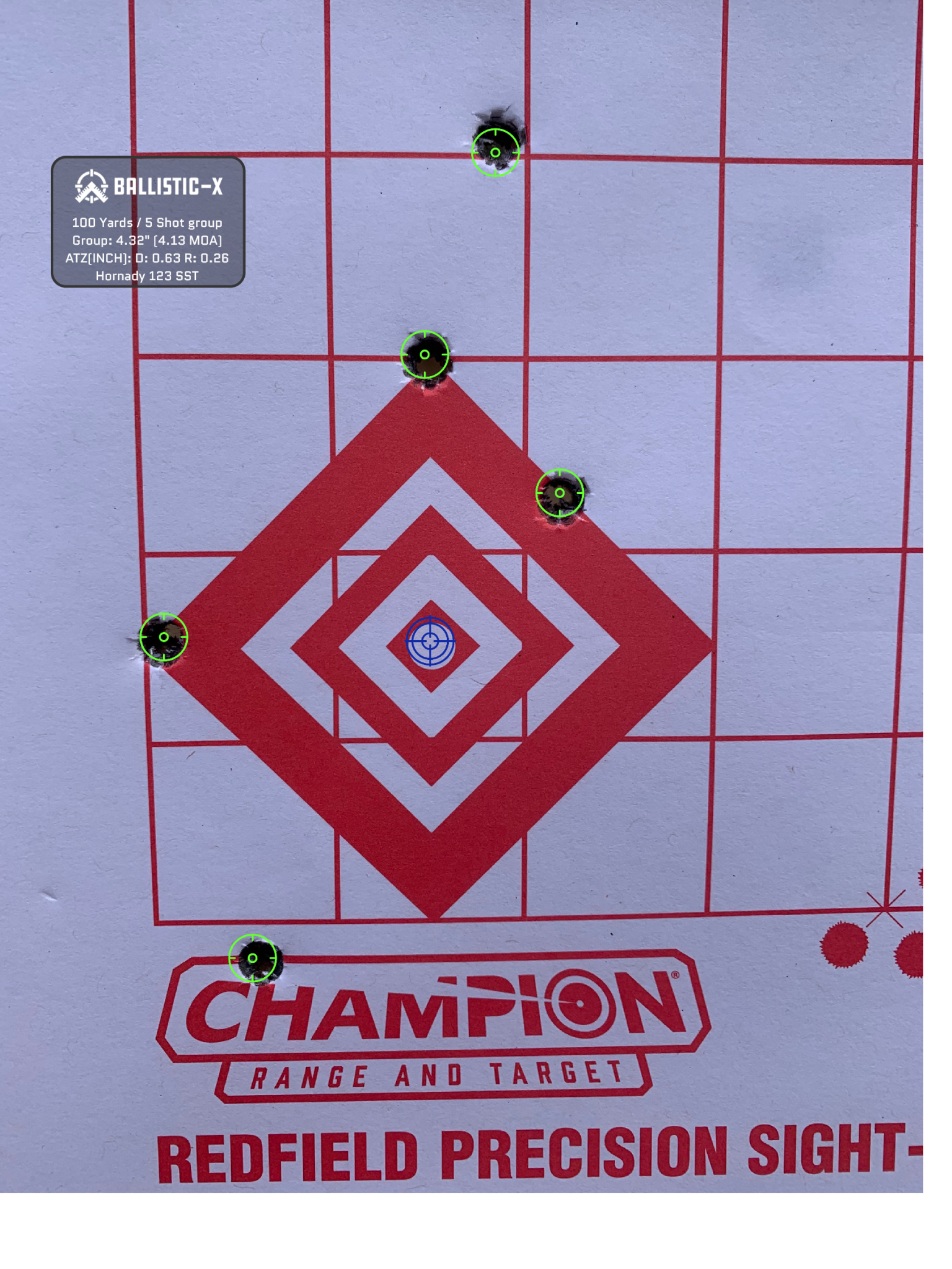

1st image is Hornady SST 123 that came with the upper. 4+” @100
2nd is American Gunner 123 also at 100.
Shot from a solid bench, with a mechanical front rest and quality rear bag. Burris XTRII at about 12x. This scope was repurposed from a .308 and is in a LaRue QD Mount.
The lower has a PRS stock and Geisselle trigger, this has been my DMM lower for a couple years with a .223 upper.
where do I start? Tear it down and true the receiver face? Remove the muzzle device? Or??
for sake of argument, let’s assume the shooter (me) is plenty capable of sub-MOA accuracy.

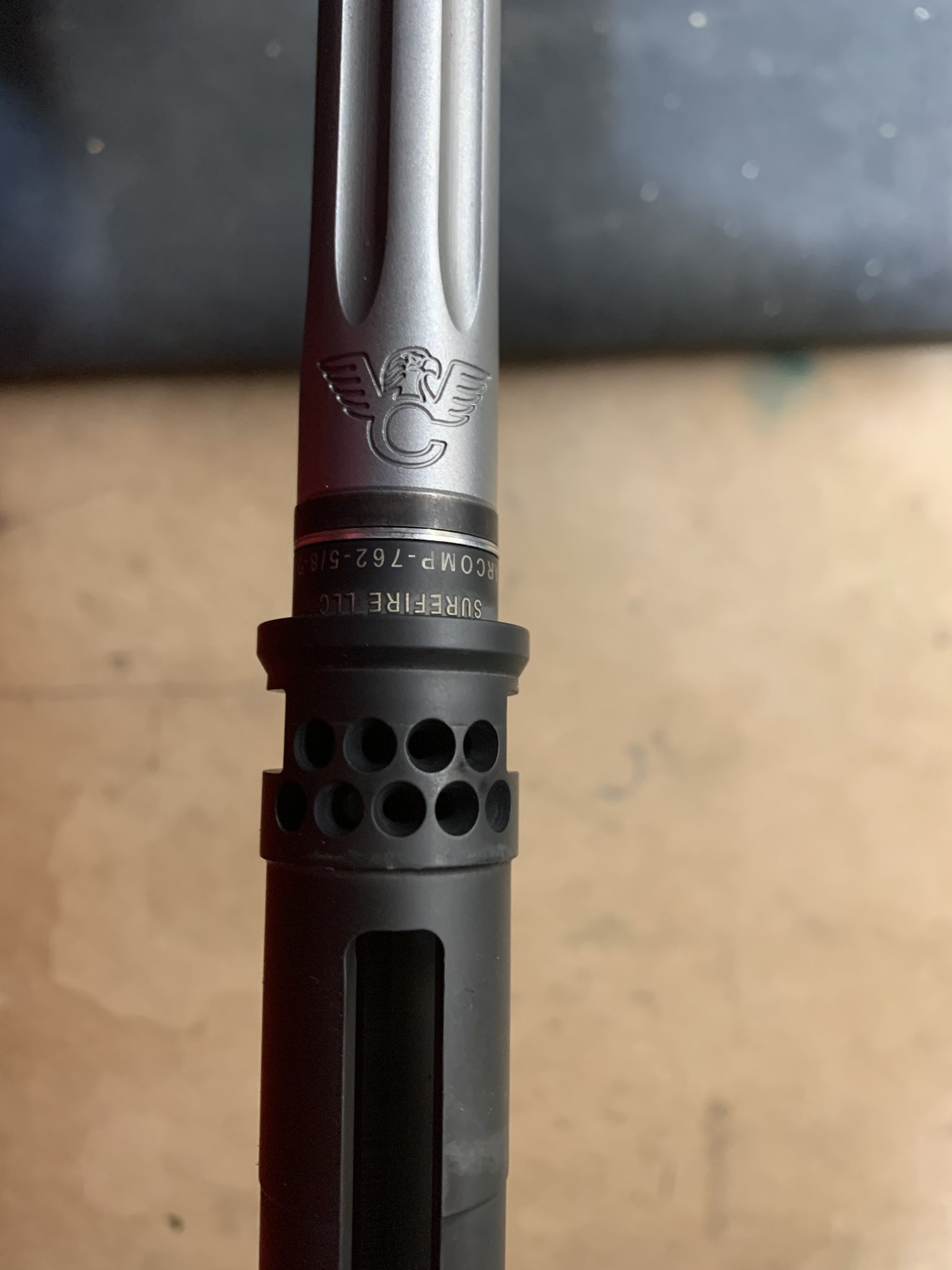

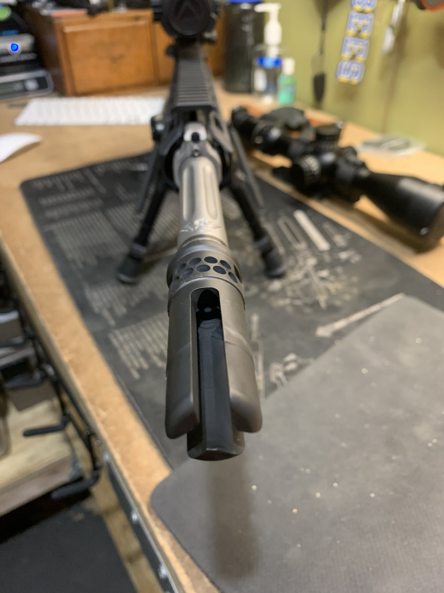

Take a picture of the Warcomp.
I run several of them and don't have issues with them
the Warcomp may be ever so slightly canted to the 11o’clock, but not much.

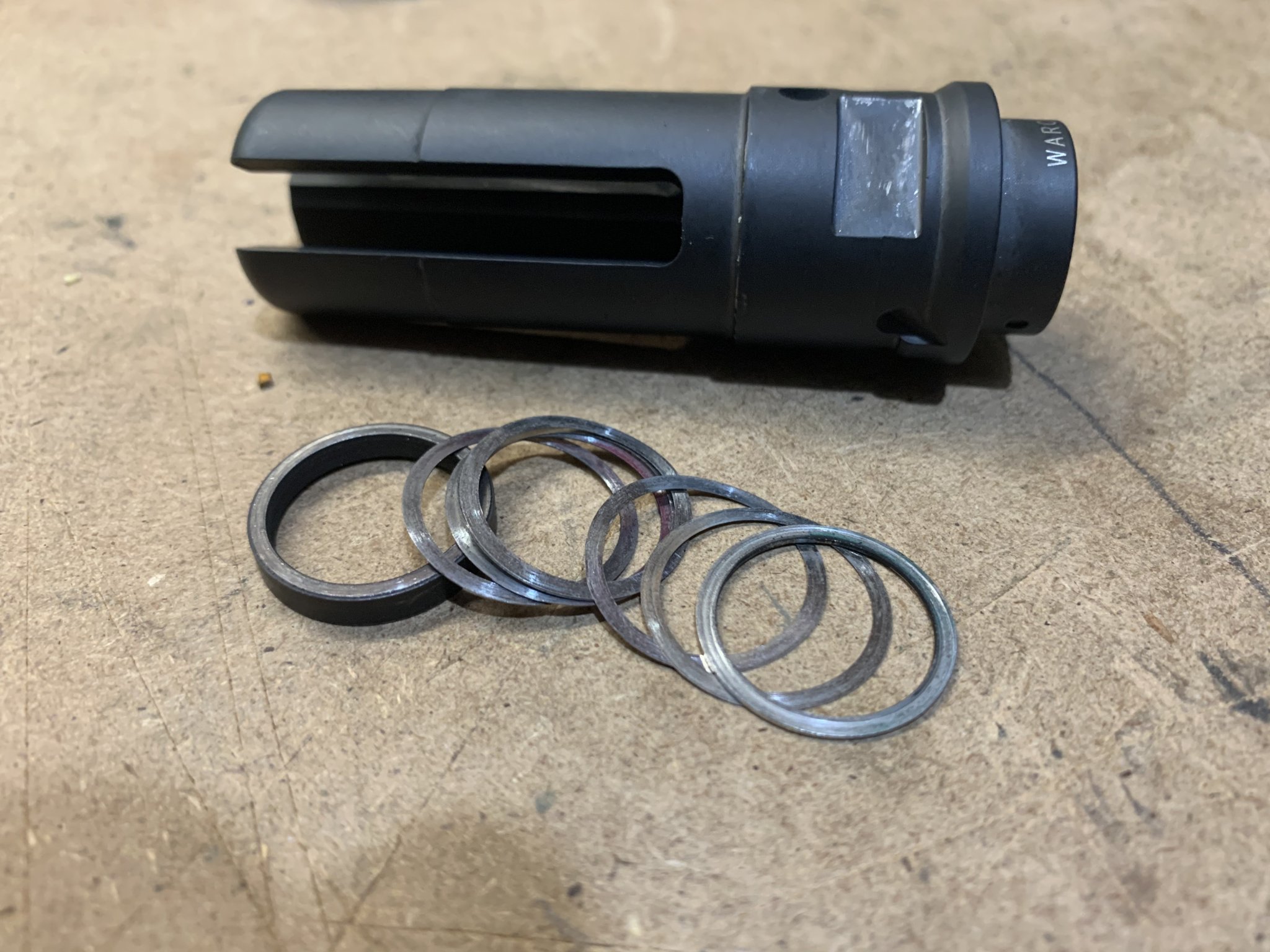

Check out the shit show of shims that were used to mount it...8 of ‘em.
I’ll throw on a simple thread protector for transport and I’ve swapped optics out.
Back to the range for day 3...
That's pretty normal actually. The big shim goes on with the countersunk end towards the barrel shoulder and then you install the comp and tighten by hand. At that point you use their clocking chart and add the amount of color coded shims until it clocks and torques correctly.

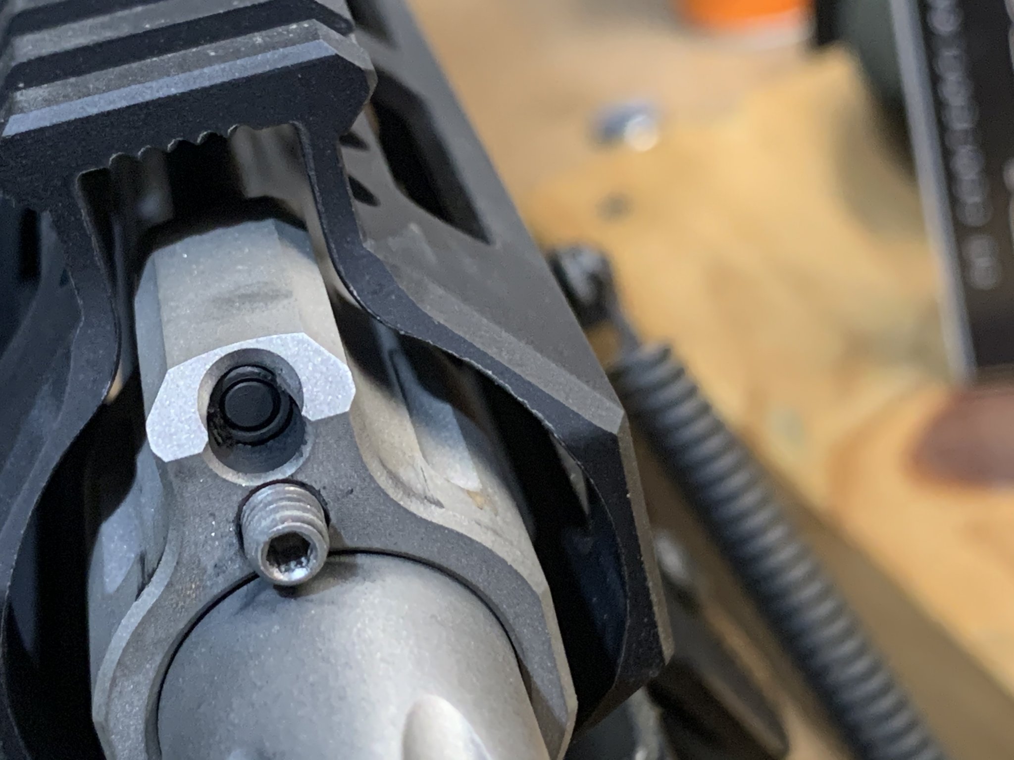

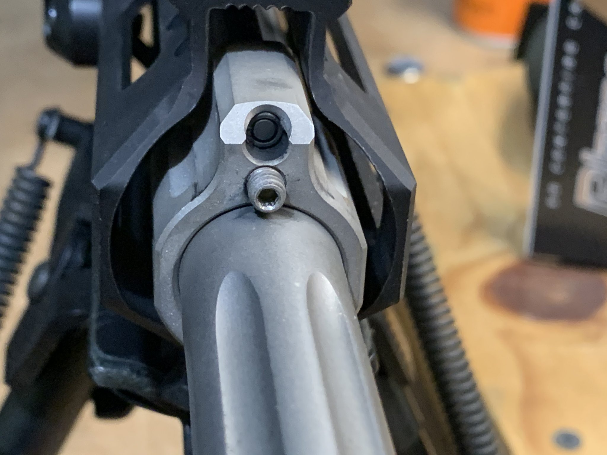

On another note, that gas block looks pretty close to the handguard.

I can generally get mine timed with 2 to 3 shims of various sizes.

Any signs of the gas block hitting the handguard?

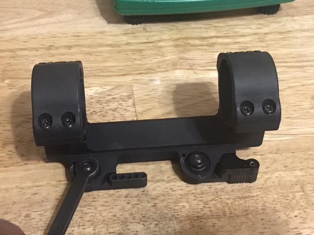

1. Look over Larue mount very closely. Clamping levers and the rings themselves.(I'm 0/3 with Larue mounts, never again)
2. Try without muzzle device
3. Disassemble upper and check barrel fit, barrel nut torque etc.
That's where I would start anyway

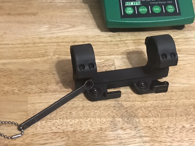

Agree with the Larue Mount and wonder if the Larue “lever nut” tool was used to set the clamping force on those levers for the upper. If not adjusted, the levers will be loose on some pic rails, just right on some and super tight on others...
Huh. Never thought about using "the tool". My bad. I just kept tightening the nuts by hand until I had to use a good amount of pressure to close the levers.

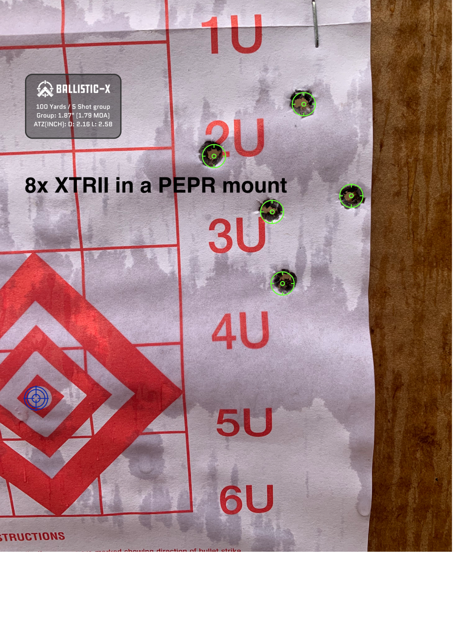

I removed the muzzle device, inspected the crown (looks good) and went back to the range. A little bit better, but not acceptable as of yet.
I got a full 1" better with the 8x optic in a PEPR mount vs ~12x in the LaRue. It was cold and rainy....so maybe it IS the LaRue mount, either my not using it properly or it being a POS.
Next will be verify barrel nut torque (anyone have a BCM barrel nut wrench?) and putting the optic in a different mount.
I'll also pick up some different weight ammo....but I really really want it to work with Am Gunner as it's a decent bulk option!

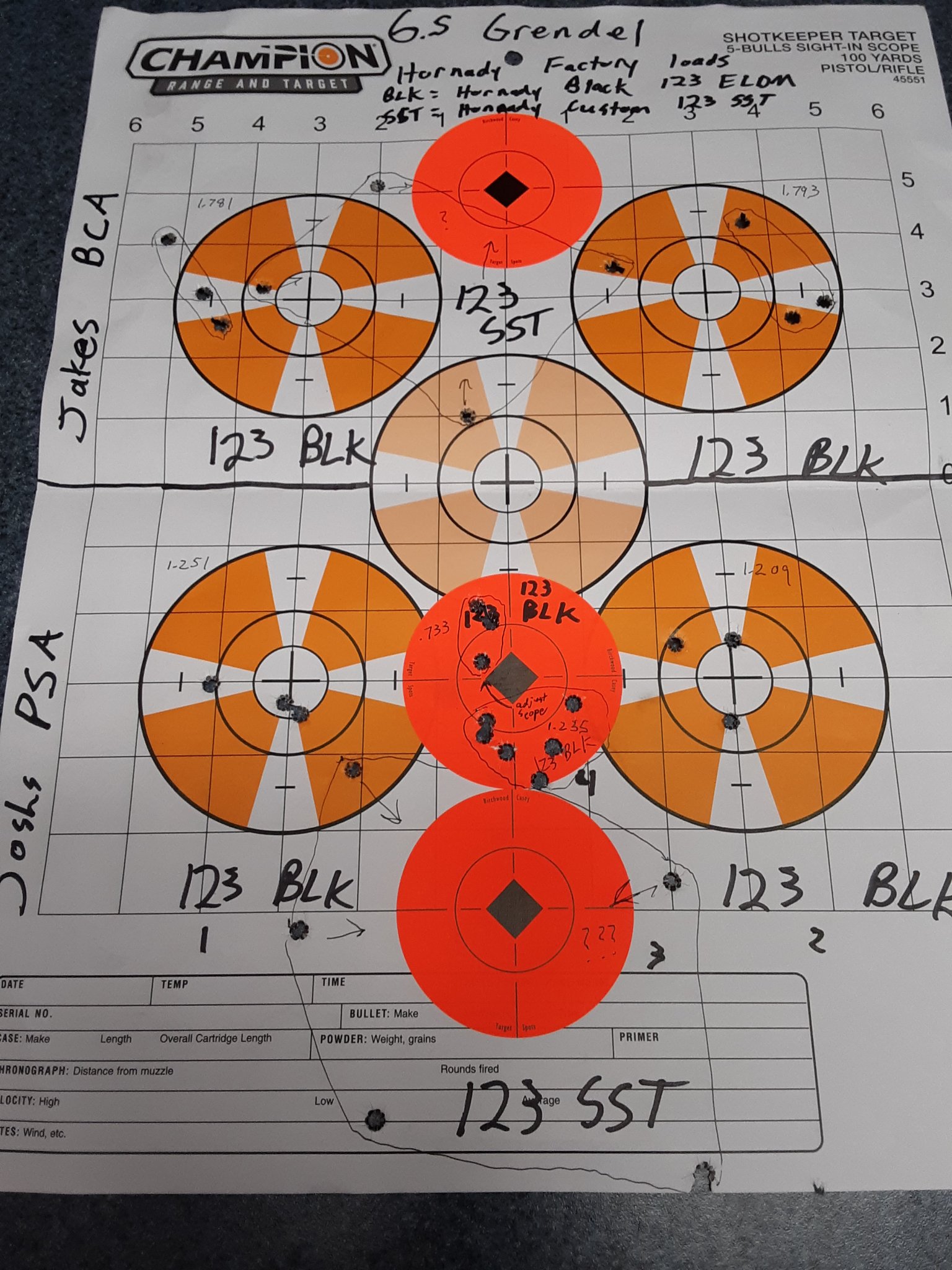

Like others have said, I would try different ammo. I never tried the American Gunner, but I could not get the Hornady custom 123 SST to shoot worth a shit. In two different uppers with two different (cheap) barrels, the Hornady Black with 123 ELDM shot roughly 1-1.5 MOA while the Hornady Custom with 123 SST shot like 4-something MOA. It was the damnedest thing. I'm glad I only bought one box of the SSTs.
So what load did you end up with?
I actually swapped that barrel out for a 243 LBC, which was always the plan for that upper. I just shot it a bit in 6.5 mode while I was waiting on the 6mm barrel. Those two loads were the only ones I shot through the 6.5 barrel.
The other one is my brothers. He seemed to be ok with how the Black ammo shot, not sure if he's tried much else.

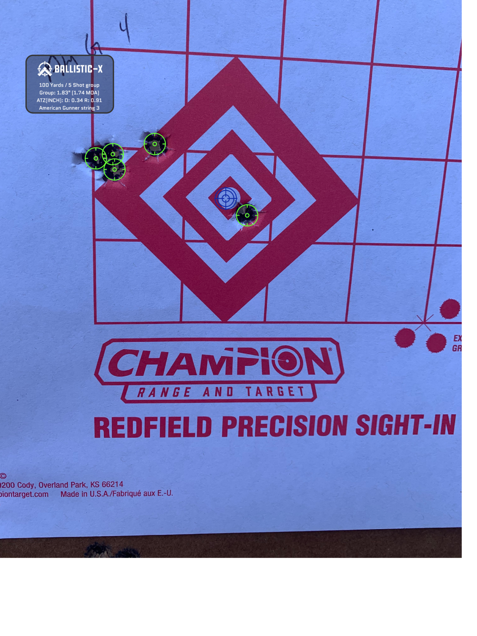

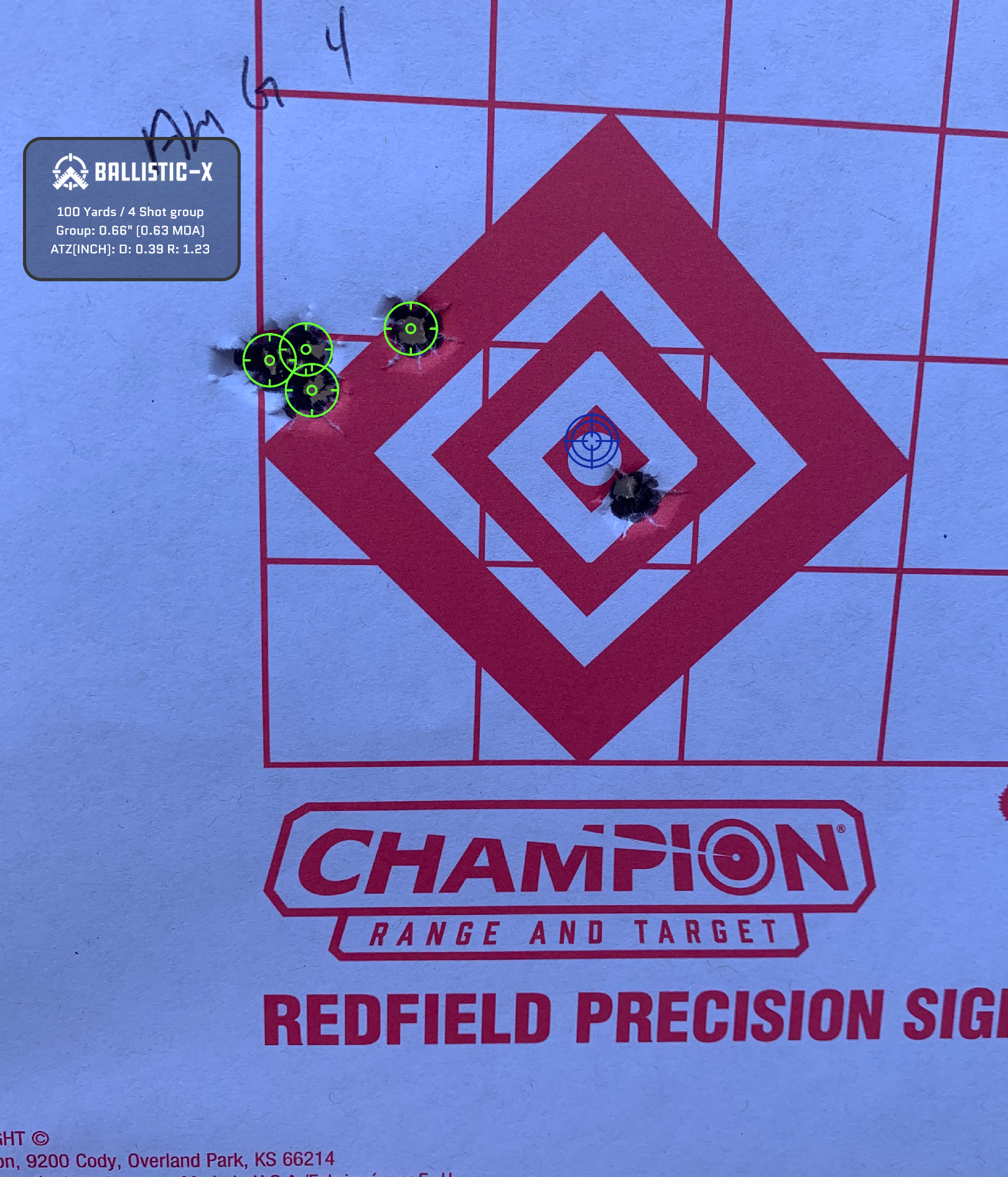

Moved the scope (XTR II 3-15) over to a Burris PEPR Mount, properly torqued but not precisely leveled and eye relief a bit wonky.
I had 30 minutes to hit the range and came away with this group. American Gunner 123s
That really errant shot is 100% me. I pulled across the trigger instead of straight back. I knew it as soon as the shot broke.
If that 4 shot group is the new normal I’ll be ecstatic. Of course it’s only 1 group, but it’s given me hope!
FWIW, the Hornady SST (5 shot, 2.47”) and Black (5 shot, 1.47”) were better than before, but still worse than the Am Gunner.

And since I can't tell... on the LaRue mount rings... always tighten the lower screws first, then the top ones.
I have seen LaRue's instructions somewhere saying this... and Matt LaRue has confirmed it.
Even then, properly torqued all 3 that I have had were prone to let the rings shift up and down on the base. It's a shit design.
