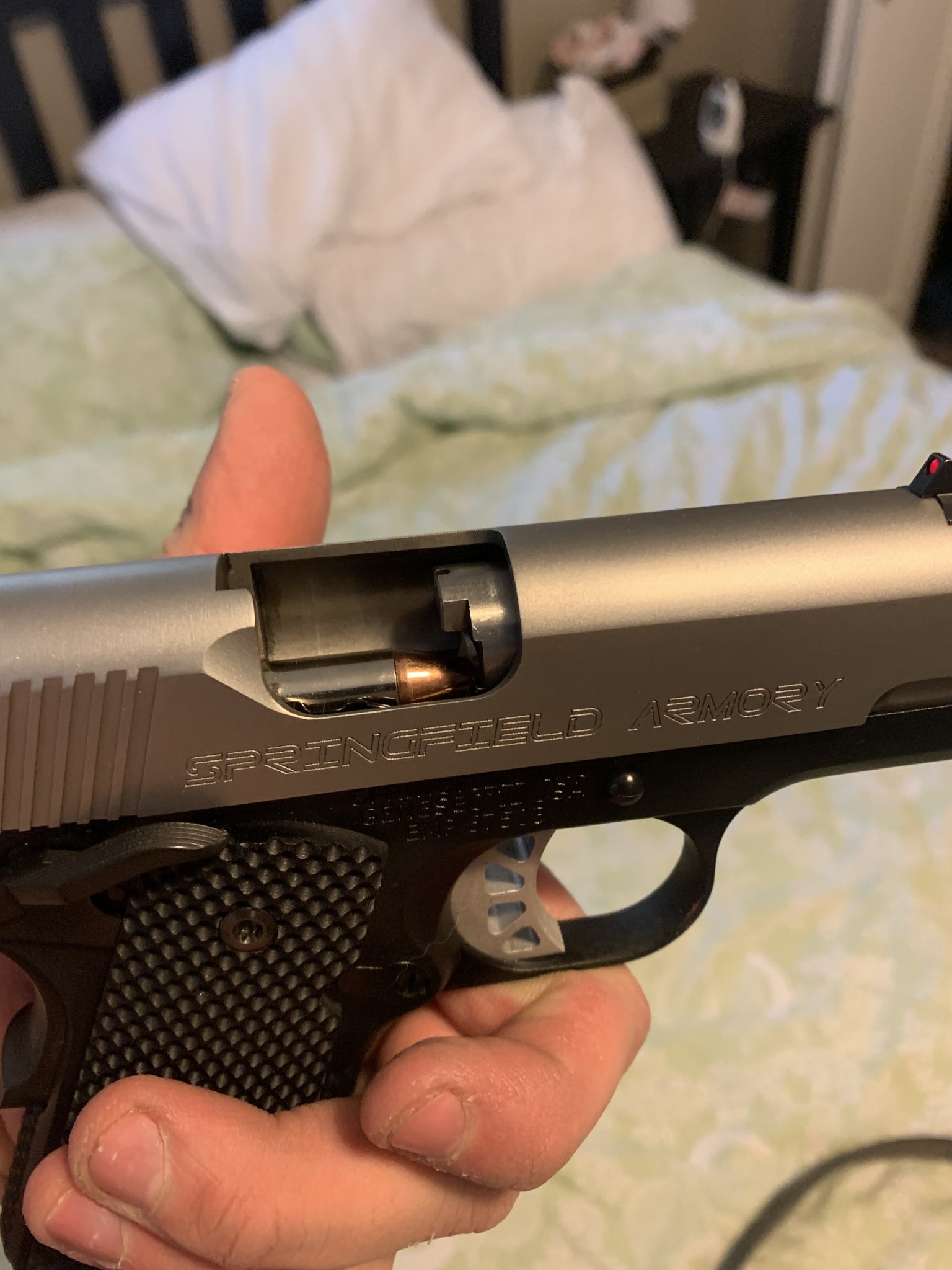

Just took my new Springfield TRP 6” to the range for the first time. I had hornady 180gr XTP and Underwood 200 gr flat noise hard casts. Neither would fit into the chamber far enough for the slide to close. I guess I’m going to call Springfield tomorrow to see what they plan on doing about it, but I’m wondering if anyone else has had the same problem.

Either a .40 reamer (looks like more than .125 protruding to my naked eye via pics) or a faulty reamer or poor craftsman work.

Just spoke to Springfield and they quoted me a 4 week turnaround to get it back. I’m checking with the distributor to see if I can return it and then go with a dan Wesson Kodak. But to answer the other questions I tried multiple ammos and they seem to be going up the feed ramp at too steep of an angle. I originally thought the chamber was too short since the casing weren’t going in far enough, but if you drop a round into the open chamber and then drop the slide it will close. It is just feeding from a magazine that isnt working. And I tried both of the mags that came with it as well as a Wilson Combat magazine. As of right now it’s just a $2k single shot piece of crap.
So it's not chambered too short? If you pushed that round shown in your picture with your finger, it would chamber completely?
It was really tight so I didn’t want to start shoving it in further while I was at the range and risk damaging the chamber. I found some threads on 1911forum where some others had similar issues with this same model and had to send them in to be worked on. Ive owned several pistols from the XD line, but this is my first Springfield 1911. It’ll definitely be the last as well. I almost ordered a 9mm Ronin at the same time. Glad I held off on that. Everything is good now though. They are going to let me send this one back in and I’ll be picking up either the DW Kodak or Bruin. Trying to decide which one.

New gun and yes with hollow points. If I hit the back of the slide it will go in. And then have about a 50% failure rate while firing. It seems to be an extractor issue as it is super tight and practically tears a chunk out of the casing. With ball ammo it won’t feed the first round 75% of the time.

Sounds like the chamber is a tight / undersized . Maybe the tool they finished the chamber with broke down / regardless it shouldn’t have passed quality inspection. I prett sure they will make it right if you send it back though. Not an excuse but anything manufactured can have a issue . Usually there is a spent case with the gun from test firing, at least they used to do that. Did you try cleaning the chamber out Good and try firing it again?

You can finish ream it yourself. Not hard to do. Also, it sounds to me like the extractor is probably too tight along with any other issue.
There are plenty of well built 1911s that don't like certain magazines. Even Wilsons. You are limited in 10mm, but in my experience, the CMC magazines are best in a lot of calibers.
None of that is to say don't send it back, but with 1911s you eventually have to know yourself how to fix and tune different issues or it is a losing battle. Kind of like having a classic car.
