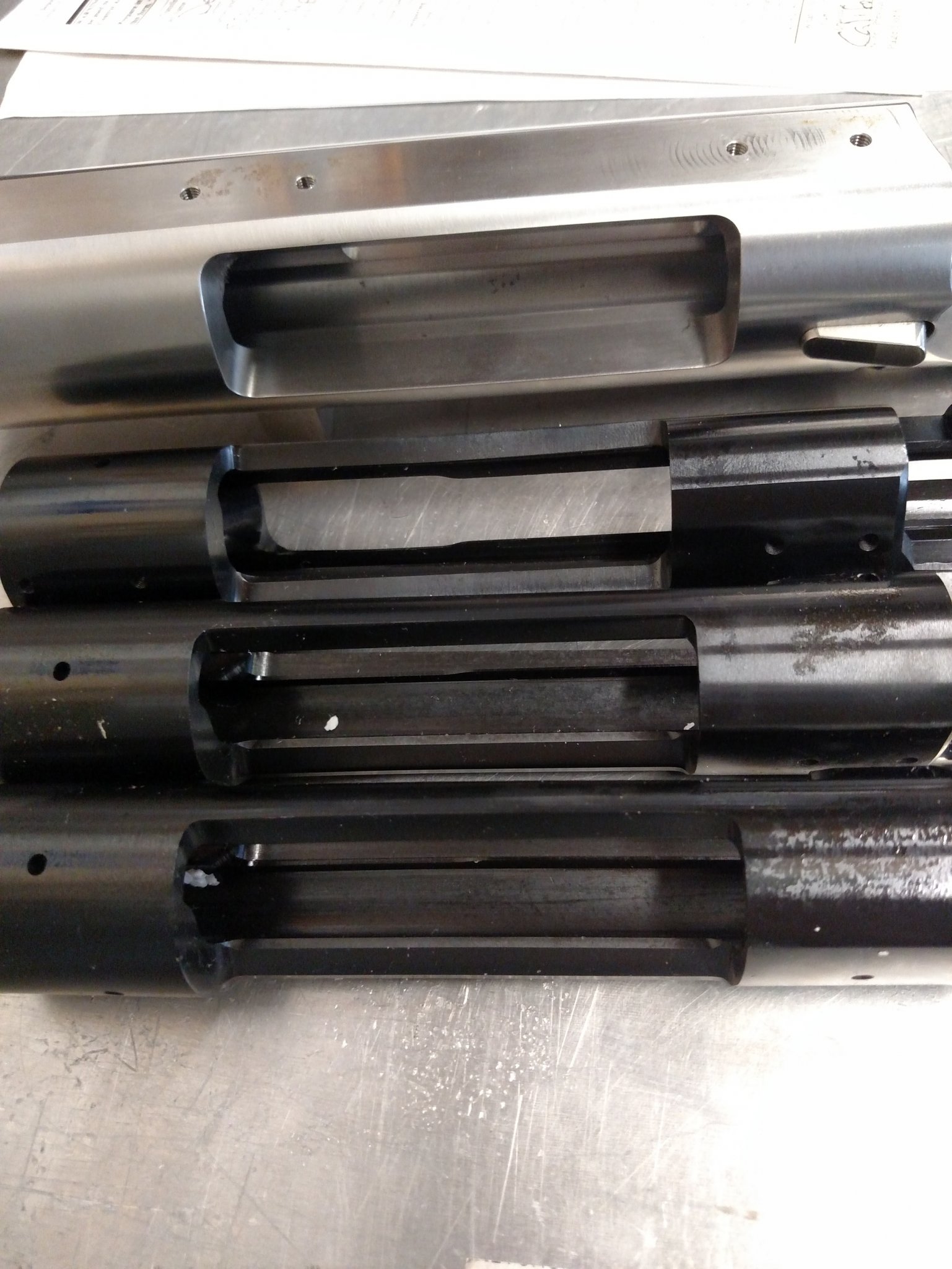

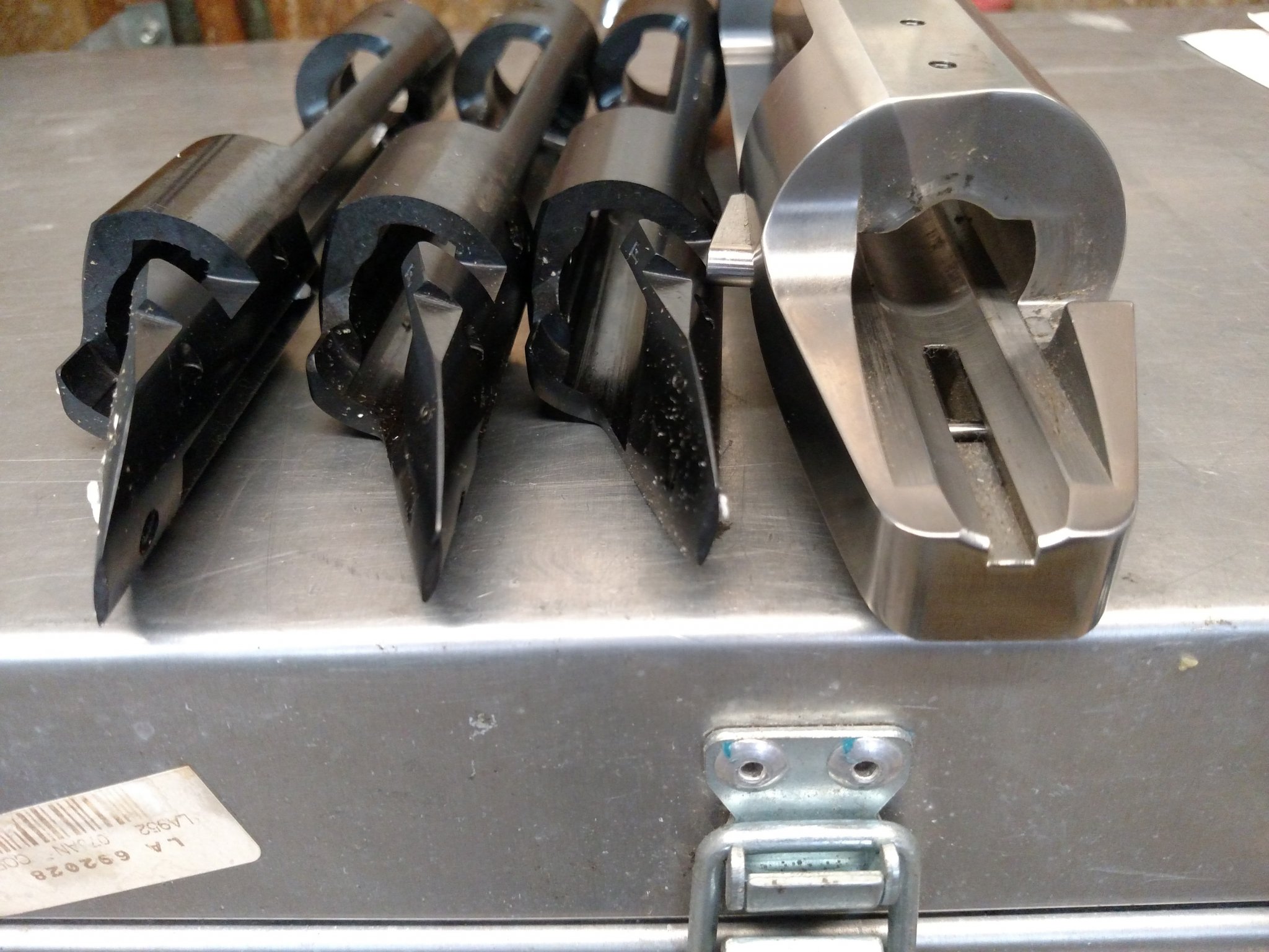

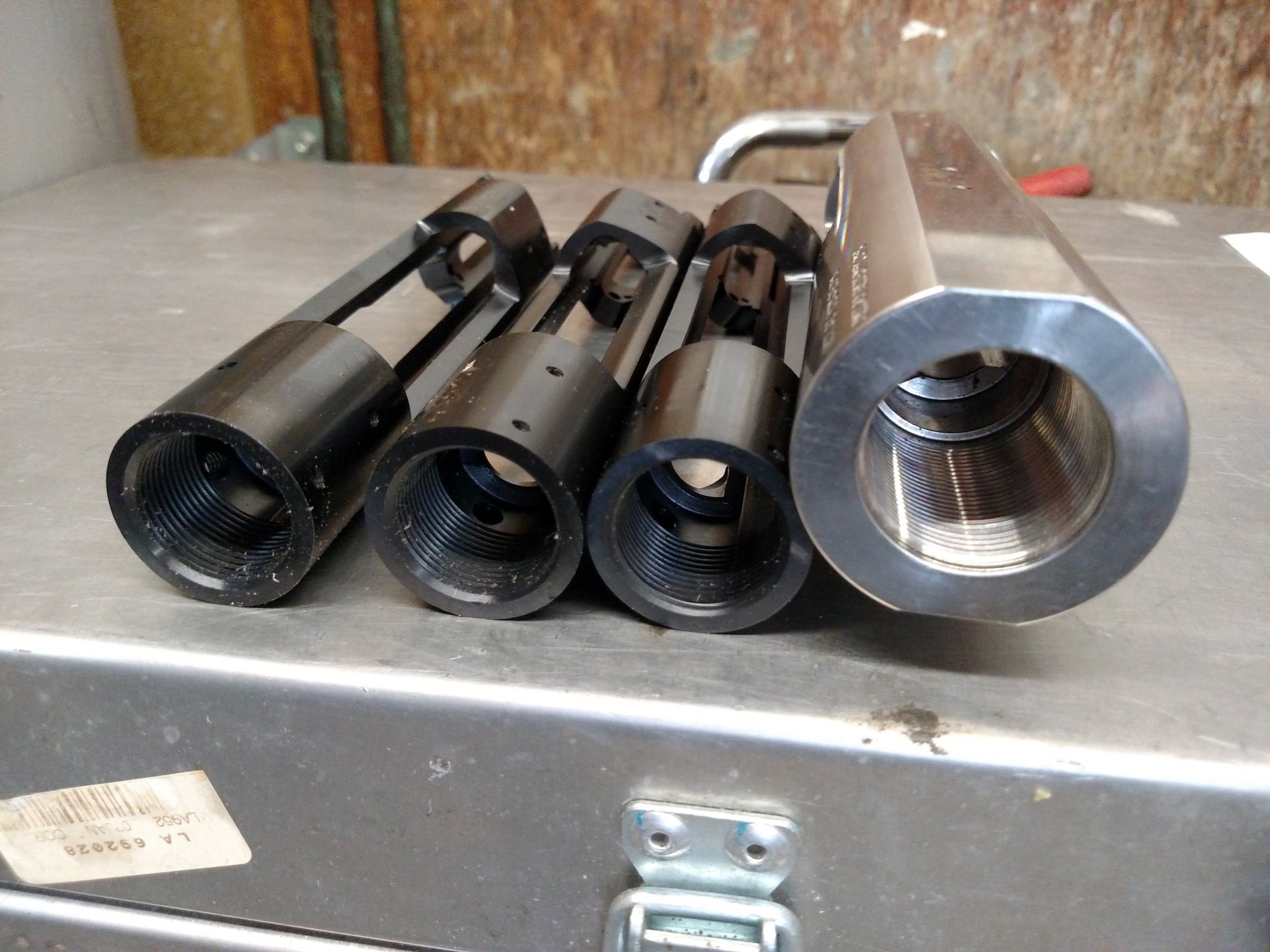

You hear alot about custom actions but most of them offer very little to the average shooter.
With a custom you get a side bolt release which is a $20 upgrade for the 700 action.
I don't use sandwich style recoil lugs so that is a throw away item for me but it's worth $30 if you need one.
You get the choice of which side you want the empties to eject from so it offers a little more speed.
The bolt fit on most tactical type custom actions is too sloppy for great accuracy.
The biggest thing a custom offers for me is a beefier bolt tenon and less bending.
With the added rigidity you can hang a much stiffer longer barrel on the action without ruining the bedding a problem you don't have with a chassis and the relatively light barrels used on those type guns.
The pictures show a BAT action used for unlimited type Benchrest shooting with a very heavy type barrel weighing over 20+ pounds compared to a few 700 actions for comparison.
