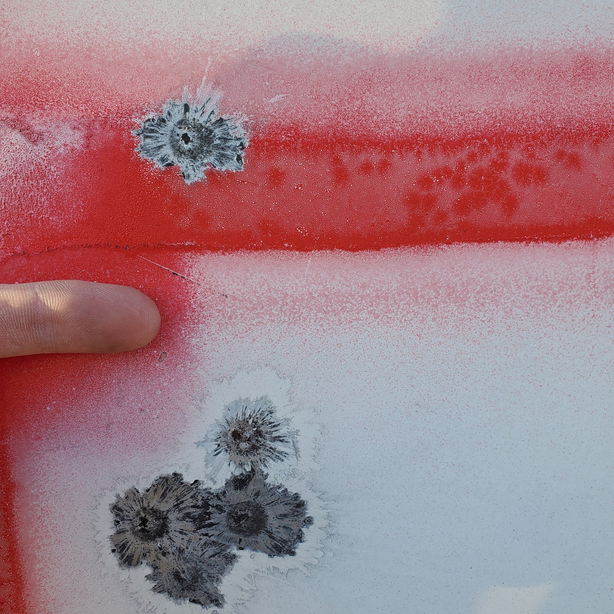

I am running 109 hybrids. When using a G7 of .299, I can stack up rounds on the water line at 988 yds. When I come in to 732 yards I am 5" high. My zero is confirmed and is half a tenth high at 100. I have double checked all my input data but obviously I am missing something. Gun is shooting good as you can see in the 1k group below.

How sure are you of the yardage at 732? Just throwing some SWAGs into Hornady’s G7 calculator at sea level or so, 3000 fps MV, if that plate was actually at 720 yds with a 732-yd DOPE you’d see impacts 5” high. Pretty much same story at 2900 FPS.
