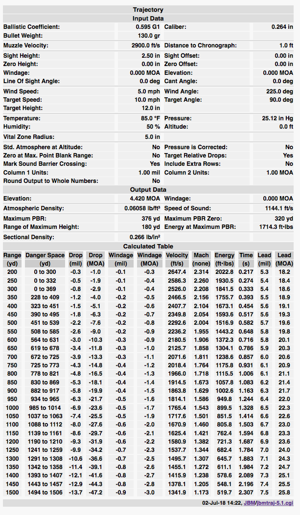

But try gathering all your data, and then using the ballistic features in JBM to fine tune them for other software.
Using the above I shot the new Kelbly rifle the NYX this weekend and here is the actual vs the corrected JBM
Here is the actual recorded data
Using JBM 100% you can see the modified data, BC changed from .583 to .595

Also, I'm missing something on LL's. The first image is his data sheet. The JBM data with new BC is what?
I'm just trying to keep the process as simple as possible.
He adjusted the BC from .583 to .595. The actual dope at 1500 was 13.8 mils and JBM predicted 13.7.

Actually, he adjusted his BC to line up with his 800 yard dope. But it is off reconciling to the rest of his data sheet.
I don't know how you would true at 800 with BC when it comes up 4.8 mils with either one listed. If they are the same, what are you truing?
I re-ran it with all the inputs on JBM, exactly as listed on the JBM table shown in post #58. At 800 yards, with the listed speed of 2900fps and all other inputs identical, It is 4.8 mils with a .583 G1 and 4.8 mils with a .595 G1.
So, near as I can figure, Frank had to be talking about the rest of the trajectory.
