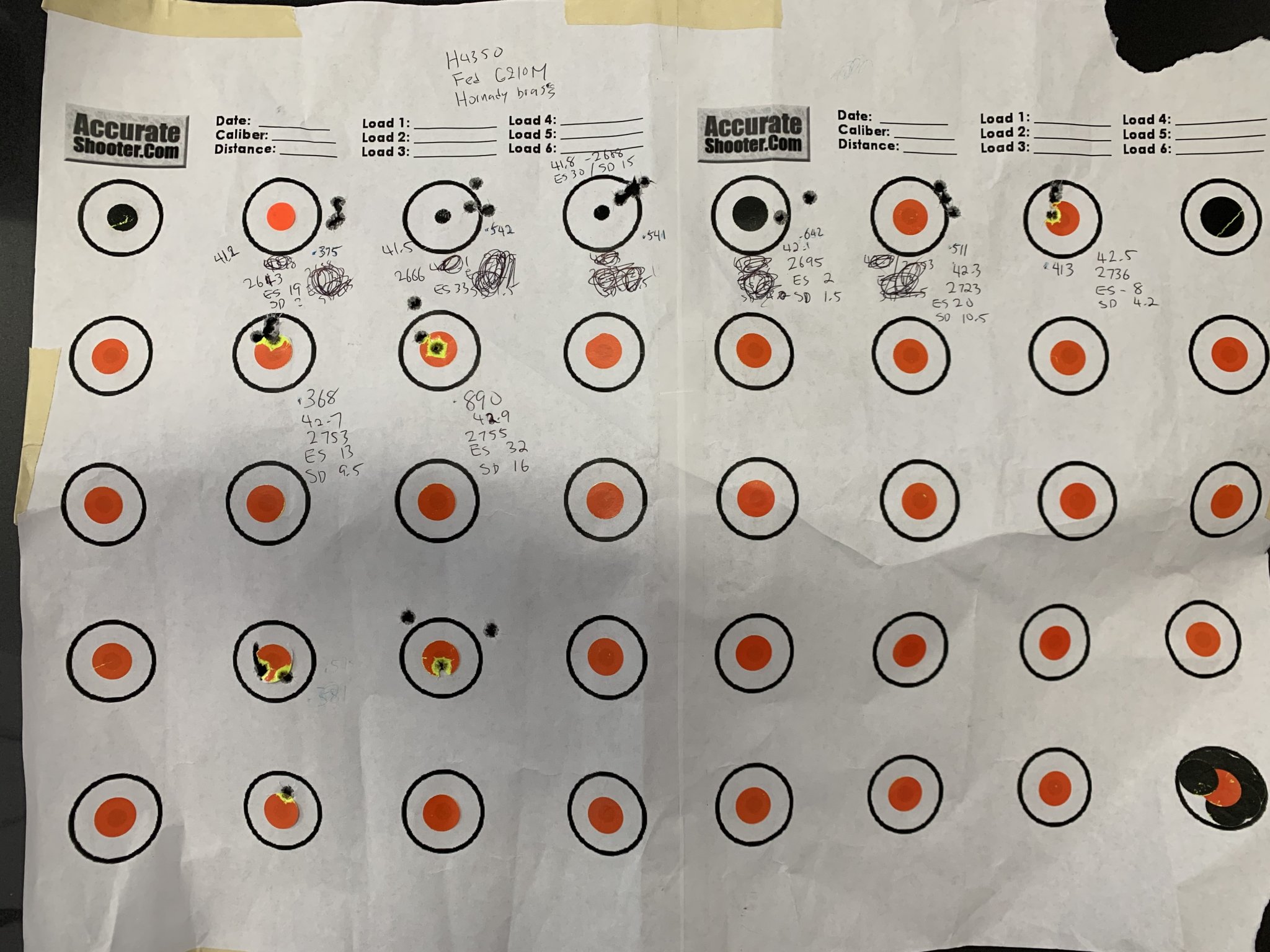

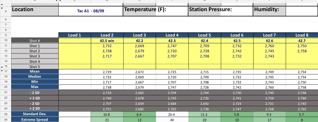

Hey guys. Little background first. Been reloading for over 10 years. Shoot 100-600 yards. Don’t shoot in competitions. obsessed with small groups.
Process and Tools I use are pretty consistent across all calibers: wet tumble, FL size / bump back .003, trim/Debur/chamfer, uniform flash hole, anneal my cases, use standard Forster sizing dies, Forster micrometer seater, Hornady Concentricity gauge.
Normally when I do load development, my process is, I would do 3 shots each load tested, .005 off land, look at a set of 3 loads with the most consistent POI to one another, with acceptable grouping, then test those 3 loads again, sometimes with minor adjustments to OAL, but rarely needed. Have consistently achieve 1/4 to 1/2 MOA with it.
So, last month I decided to take it another notch up and pick up a LabRadar. Perhaps this may, or may not make a diff, but I want to take a more data centric approach to my process. Need your expertise on how I should look at this info, and how does that effect my process in load development.
***Ill share another post below with my recent 6.5 load (New to 6.5CM), data, and results. Any input you can provide would be greatly appreciated.
Ok here we go. Since my chicken scratch is ugly in the picture, I’ll post the results below. If you can kindly share what you would do next based on what you see here.
personally, I’m thinking to focus my efforts on load 5, 6, and 7 from this point on. Or based on data, would you go with just load #6?
6.5cm load
Powder: H4350
Brass - Hornady
Primer - Federal 210M
Bullets - ELDM 140gr
.005 off land
Load 1 to Load 8 from top left to right, and then the last two below it:
Load 1:
41.2gr / 2643 fps
ES 19 / SD 10.1
.375 MOA
Load 2:
41.5gr / 2666 fps
ES 33 / SD 16.3
.542 MOA
Load 3:
41.8gr / 2688 fps
ES 30 / SD 15
.541 MOA
Load 4:
42.1gr / 2695 fps
ES 2 / SD 1.5
.642 MOA
Load 5:
42.3gr / 2723 fps
ES 20 / SD 10.5
.511 MOA
Load 6:
42.5gr / 2736 fps
ES 8 / SD 4.2
.413 MOA
Load 7:
42.7gr / 2753 fps
ES 13 / SD 9.5
.368 MOA
Load 8:
42.9 / 2755 fps
ES 32 / SD 16
.890 MOA
If you’re always shooting in the same location (not traveling around), you can just find a load with the Labradar that has a consistently low ES and then tune it via seating depth to shoot bugholes. Can also add a tuner to barrel to dial it in even more. Especially for a single distance as you can utilize positive compensation.
Also, if you’re 600 and in, you ES won’t matter as much.
I’d focus on seating depth tuning far more than I would the chrono if I was going for tiny groups at relatively close range.
Load 1:
41.2gr / 2643 fps
ES 19 / SD 10.1
.375 MOA
Load 2:
41.5gr / 2666 fps
ES 33 / SD 16.3
.542 MOA
Load 3:
41.8gr / 2688 fps
ES 30 / SD 15
.541 MOA
Load 4:
42.1gr / 2695 fps
ES 2 / SD 1.5
.642 MOA
Load 5:
42.3gr / 2723 fps
ES 20 / SD 10.5
.511 MOA
Load 6:
42.5gr / 2736 fps
ES 8 / SD 4.2
.413 MOA
Load 7:
42.7gr / 2753 fps
ES 13 / SD 9.5
.368 MOA
Load 8:
42.9 / 2755 fps
ES 32 / SD 16
.890 MOA
I like load 7/8 are looking like a flat spot in velocity.
But I don’t like the ES/SD on load 8.
Honestly, I’d try it again with cci450 or br4 primers. See if you can get some more consistent numbers in your ignition/combustion stage.

Here the shot data for each shot in that string. Does this change anything?
Load 5:
42.3gr / 2723 fps (2726, 2711, 2731)
ES 20 / SD 10.5
.511 MOA
Load 6:
42.5gr / 2736 fps (2741, 2735, 2733)
ES 8 / SD 4.2
.413 MOA
Load 7:
42.7gr / 2753 fps (2747, 2760, xxx I guess last shot did not register)
ES 13 / SD 9.5
.368 MOA
Load 8:
42.9 / 2755 fps (2741, 2773, 2752)
ES 32 / SD 16
.890 MOA
So, here’s what I look for in chrono data, ideally:
A .3 grain node where average velocity is within 10 fps each way.
All three charges <10sd and <20es
For example:
30.0 = 2550fps
30.1 = 2560fps
30.2 = 2570fps
Then I’m loading 30.1 and worst case my velocity should stay 2540 to 2580.
I’d like to see better. But this is acceptable. For example, my 6x47:
35.0 = 2955 w/12 es
35.2 = 2956 w/4 es
I load 35.1 and worst case is I’m between 2949-2960 fps. Theoretically speaking. Even if I’m 2940-2970......I’m in great shape at distance.
After that, I can tune via seating depth. I tune seating depth @100yds as the only reason it won’t hold at distance is because of shooter error or BC variance from bullet to bullet. And I shoot random distances. If I shot all at 600 or 1k, I’d be tuning seating depth at those distances to work on positive compensation.

Hi all, I want to thank everyone for taking their time to chime in on this thread, and provide knowledge / assistance.
In the last 2 weeks, I started prepping using mandrels, as a few here had suggested.
Based on the data collected last time, I loaded 3 strings from 42.1 to 42.7. 42.1 did not record. Missed a shot on 42.7. All else is the same. Seating depth and components.
Let me know your thoughts gents. I’m leaning to 42.5 as my load to start testing seating depth to tune my groups. These are seated .005 off land, and got .413 and .455 respectively in group size.
