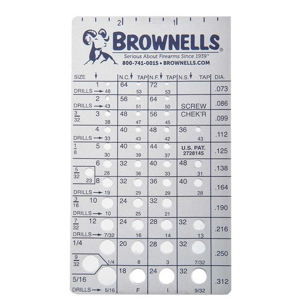

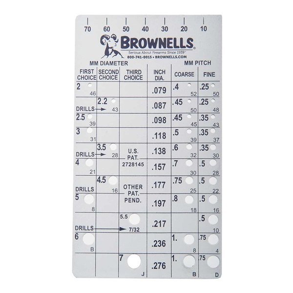

How does every guy not have several of these lying around?
I talked to another person at Browning and got this answer. 10-24 rear and for pre 1998 Abolts/Abolt-II's the front was 1/4" x 20 and for post 1998 Abolts/Abolt-II's was 1/4" x 28. However when I tried screws this size on a 2007 Abolt-2 the 10-24 didn't work. It was like talking to the DMV dealing with Browning.
Go to Fastenal. Bring your action with you, but leave it in your truck.
LEAVE THE ACTION IN YOUR TRUCK.
Go in the store, tell them you need to use the thread gauges on something big and it’s in your truck.
Go out to your truck, figure out the thread size, go back in store and buy your bolts.
