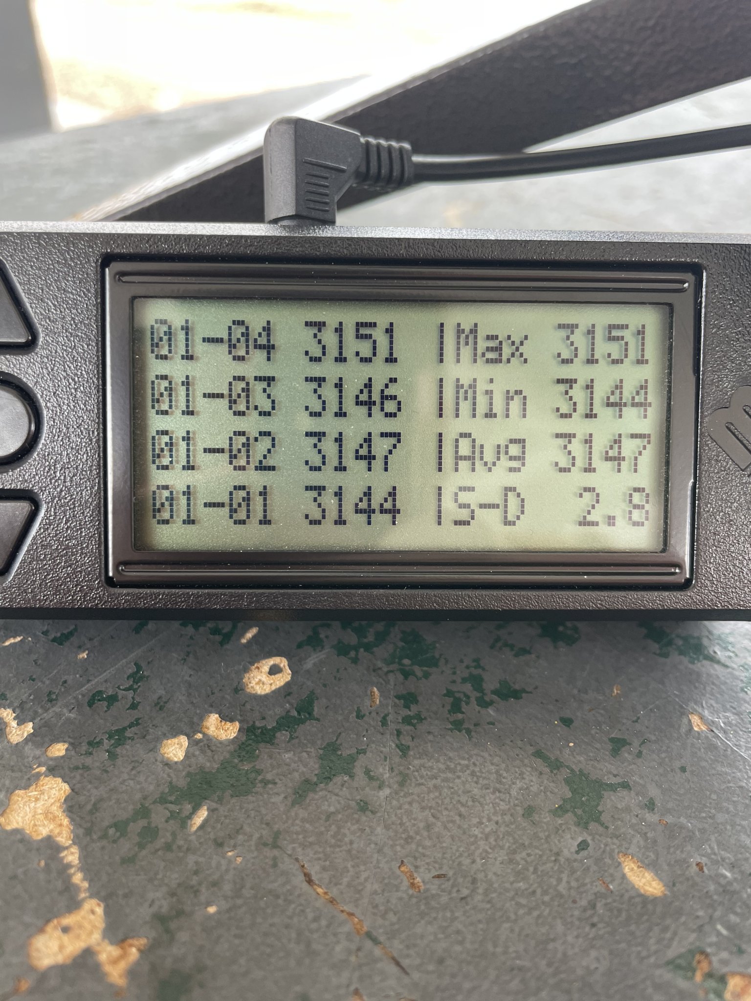

7mm-08 Freak Medic Full Member Minuteman Jul 11, 2010 339 119 San Angelo TX Nov 23, 2022 #2 Nov 23, 2022 #2 Well this happened today while messing with load development. I do believe that is the best I ever loaded. think im gonna like them TSX bullets and RL-16 Attachments 52E4D9ED-EB31-41B0-8522-07661931110B.jpeg 540 KB · Views: 40 09E50DD4-58F0-4FB2-BE95-B81D4A8D4721.jpeg 533.5 KB · Views: 43 Reactions: shootmo
7mm-08 Freak Medic Full Member Minuteman Jul 11, 2010 339 119 San Angelo TX Nov 24, 2022 #3 Nov 24, 2022 #3 reubenski said: But how do you know the deer are going to appreciate your low SDs? What do the groups look like? Click to expand... I’m hoping they won’t see it coming haha. 1/4”ish clover leaf. Plenty good for hunting out to 300 Last edited: Nov 24, 2022 Reactions: reubenski
