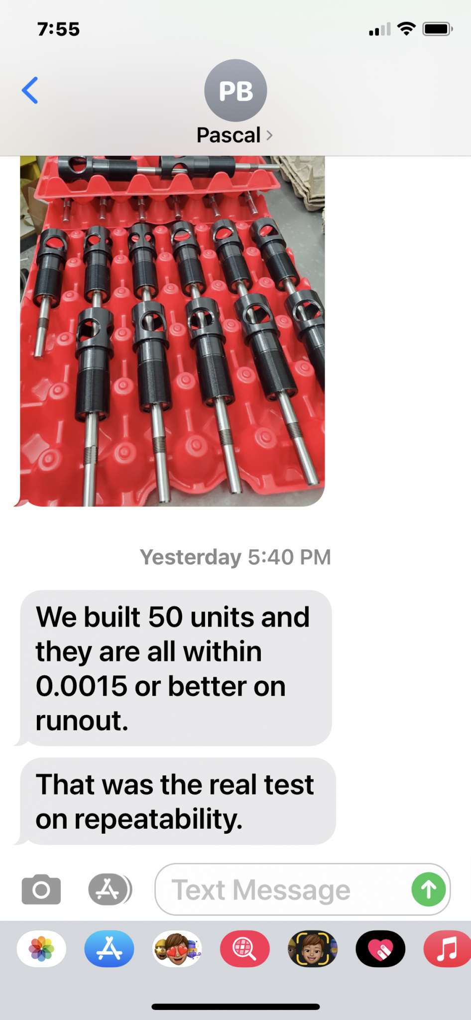

    I can tell you that it’s a manufacturing issue holding up release of the tool. After talking to the designer of the tool last week about the nose ring cutter it’s getting the manufacturer to produce the tool body to the required specs that’s the problem.
