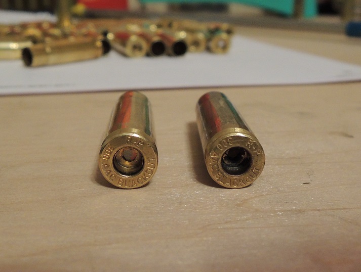

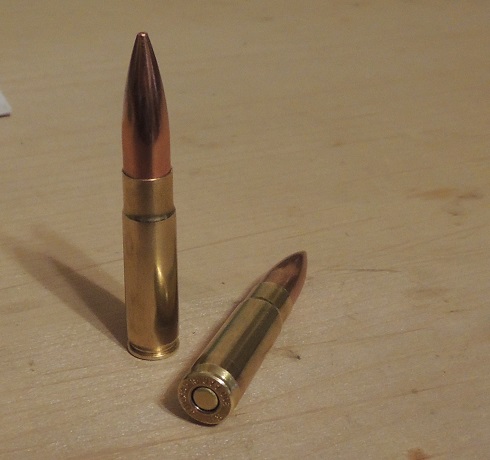

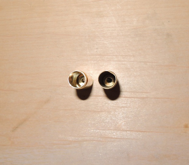

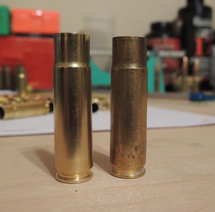

    FWIW....here's some brass I just did yesterday in my Harbor Freight double rock tumbler, SS media + water, dawn detergent and and pinch of Lemi Shine. Clean brass next to dirty one. I did 54 pcs of brass split between the two tumblers. Room for more, thats just all the 300BO brass I needed to clean at the time. Its a fantastic, economical set-up for small to moderate amounts of brass if you wanted to try it. I resized/deprimed....then cleaned, dried 'em with a fan overnight, and loaded it up this morning (last pic).
