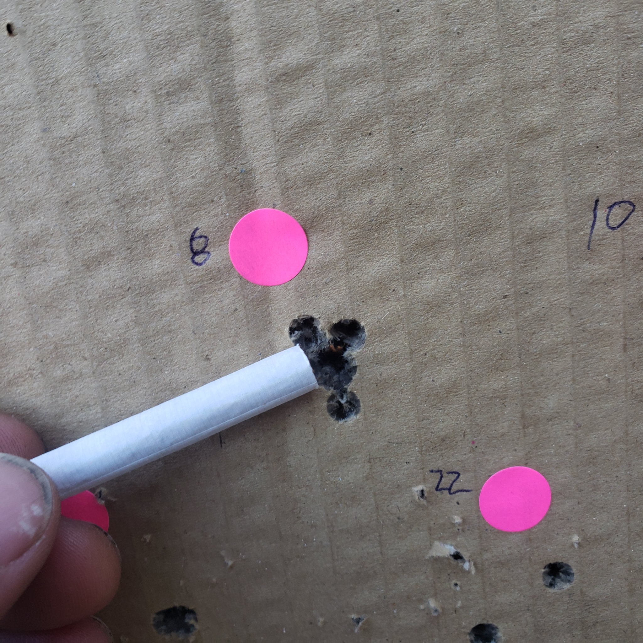

    Didn't stress load development because I wanted to play with the tuner. After testing #8 was a single hole. So dialed back to that setting and shot 10 more on same place. 12 rounds
    at #8.
    I hate shooting groups by the way.
    Mirage was bad and I broke position each shot..
    This rifle with normal development will be 1/2"
    Just an FYI for guys.

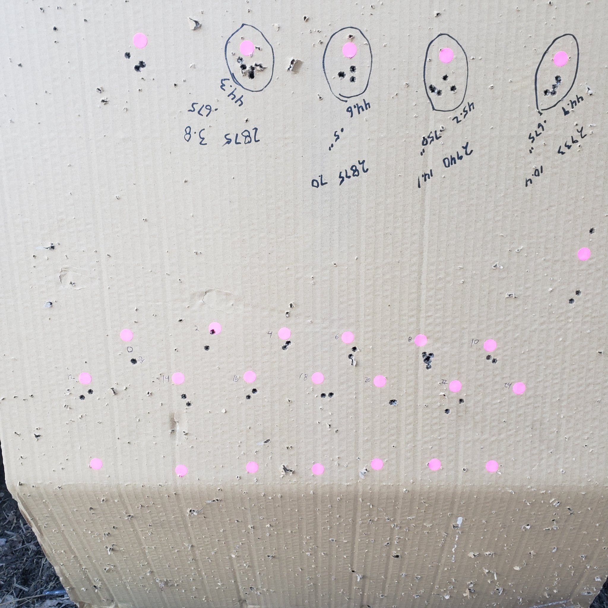

    As an addition.. usually I fully develop a load for a rifle. This one i started over because I haven't really shot it in 12 months. Additionally im going to leave its twin with a buddy so if he's at a shoot and I can fly in and he's got one of my rifles. This way hopefully I can get 1 load for 2 rifles by tuning what is an average and consistent load for both, without tuning 100% by seating depth and charge weight.
