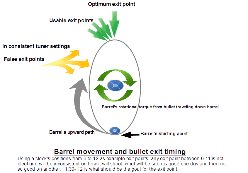

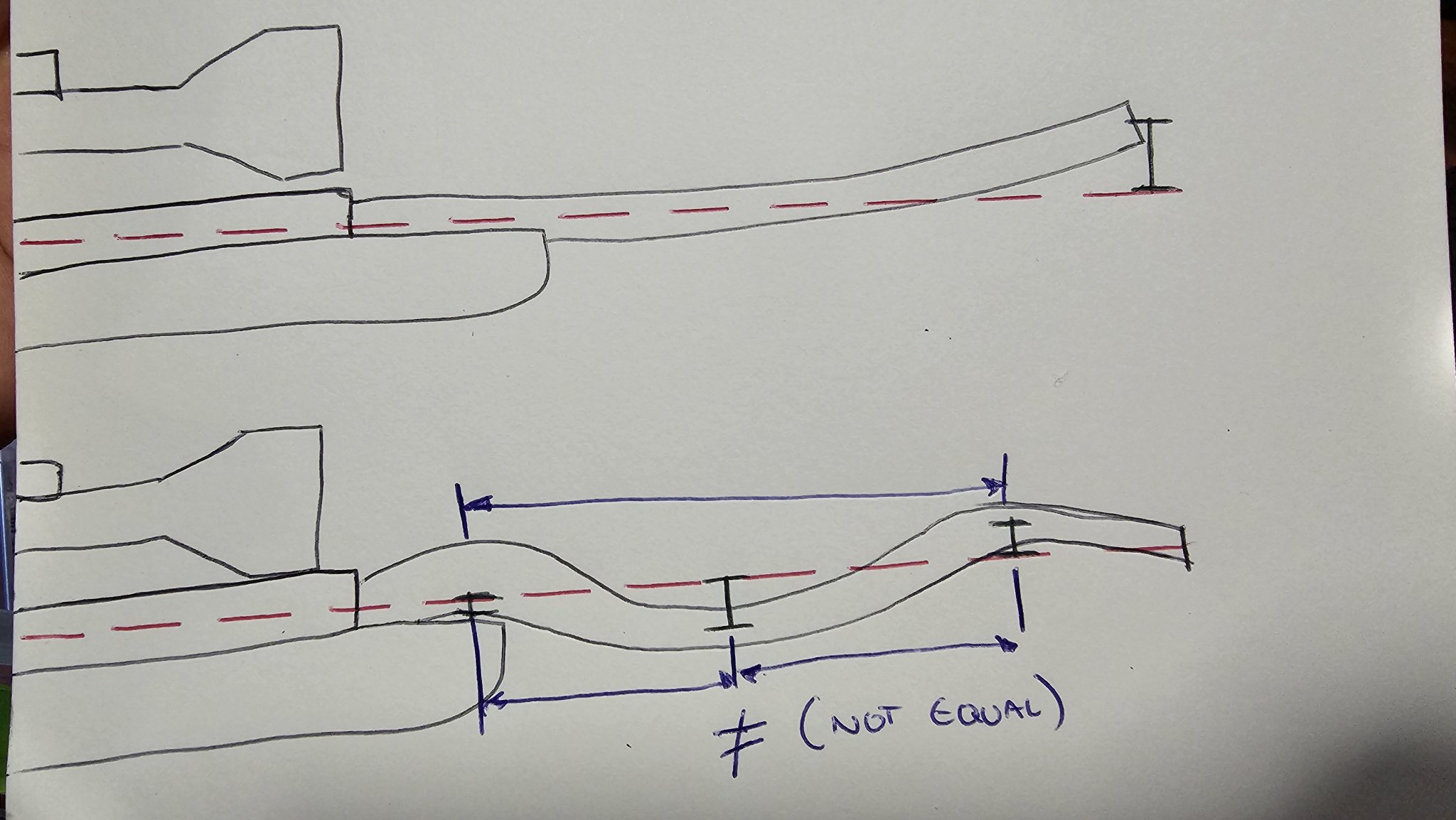

That's fairly old as far as an example. Been read through many times.
After done reading that......take a look at every high speed camera footage of barrels where there is no noticeable movement until after the projectile leaves the muzzle.
Which would easily be enough to recognize when claims of compensating 100fps @ 1k yds are made. Since you're talking about .7 mil of compensation required for about a 50es, let alone 100fps.
No one is saying things don't move or vibrate. The lack of evidence is how to tame said movements and if they even happen enough before the projectile leaves the muzzle AND if they are consistent enough to tune out.

Tuners... hell of a thing.
Disclaimer: to my knowledge, this can NOT be "proven" (theorum -> peer reviewed -> accepted proof) as the maths involved is beyond the average human. (Paging Richard Feynman ?) The variables are just too random and immense to create a formula, or physical standard (datum or reference example). In saying that..
Im no artist (autist ?), so ill try to break it down.
We have amplitude, frequency, and duration.
We also need to understand the difference between waves, frequency, nodes, antinodes, and a few others. Heres a 9min video which will help you get up to speed, try not to go cross eyed, and pay attention.
Here is a VERY (overly simplified, so its actually incorrect, but we can build on it).
"As the bullet travels down the barrel, we can tune the barrels node to give us better accuracy".
Ok, so whats wrong with that, and what the hell does it actually mean ?
We cant "tune" a node, we observe its position and duration and amplitude.
Lets observe multiple at the same time.
As you can see, different strings vibrate differently.
BuT WaiT!! I hear you screech, THe SecONd VidEO DoESNt LooK liKE ThE FiRSt !
Yes, well spotted.
Camera shutters are taking a "snap shot" of its position, and you need to look up how shutters work. (amazingly easy video to watch, its worth it.. then come back here, and this is the 'duration' part in the formula).
While the 2 strings appear to be different, (for our example) they are actually the same.
In the slow motion video, it introduces a new term, osillation. (This will be important later).
Now lets get back to shooting.
You barrel moves when shooting. Thats not disputed. Does it oscillate, resonate, or vibrate ? I hope you said all 3.
Within this barrel movement, the bullet is travelling down the barrel and will eventually be spat into the world, to meet its quick demise on animal, steel or paper. Or in @308pirate 's life,.. dirt, becuse he missed (sorry, i couldnt resist a quick jab).
Imagine your finger on a guitar, or a capo which changes the pitch or tune.
A weight on the end of your barrel will change the frequency, and thus the nodes / antinodes at which your barrel can vibrate in. As you move your finger up and down a guitar string, you change its tone (note) and can hear it. Moving a tuner forward and backwards does exactly that.
As the bullet travels down the barrel, exit the muzzle and does its thing, you need it to exit on an antinode when its velocity (muzzle movement) is as near to zero as possible. For a few reasons this is potentially IMPOSSIBLE (bonus points if you know why) So... you want the best combination of amplitude X frequency X duration.
Look at the slow motion guitar string again. It has an oscillation. You may tune you bullet / barrel combo to a "node" and it shoots, but the next day (weather, temp, whatever) its slightly off. You are not in an optimum duration zone. See the string move hard one side, pause, come back again ? Thats what we want to exploit.
Not to completely screw everyone over but, barrels go all wibbly wobbly. They DONT do their thing in just one axis, and have harmonics too ! Then add in Pendulum geometry. Your muzzle does this, but while it does it, its vibrating, not smooth.
I think ive covered enough so most people get the idea of whats happening.
Now to really make it hard to understand. Know the phrase "energy in, energy out" ? Some is lost by heat, some sound, and other motion. We are talking about gun powder boom here.
Different powder charge is different energy, thus how the barrel moves, which also effects bullet speed. Im not going to theorise if they are connected or try to prove one way or the other, but at this point id say they are not connected. Meaning a soft load can produce a higher frequency node condition, and a marginally lower charge will completely change it, its NOT linear. Bullet will go in preportionally slower, but frequency can be higher. (Just an idea, not a theory !! But its got a sound basic in physics 😉)
Ill summarise it all like this. There is too much going on to reliably say how a tuner works. What CAN be stated is that if the muzzle is moving from the peak of one antinode point to another antinode point, you will get a "flier".
There is so much here i could do in a 30min video with a white board and still not fully cover everything, its scary.
Also, barrel contour effects its ability to tune easily.. some contours are better than others. fight me.

Thank you Sir!! :)

Much has been said about barrel harmonics, vibration and other more elaborate descriptions on how a barrel reacts as a bullet travel through the bore. based off my experience and observations when tuning a barrel that bullet exit point of when and where the bullet will exit the barrel as it moves is critical on how it will shoot.
It is also my belief again based off my experience and observations that the barrel moves in an elliptical pattern. because of right hand torque induced from the rifling the movement is from left to right or clockwise. below is an illustration of the barrel's movement and where the best bullet exit points are. again, this is based purely off my experience and observations. with no measured (equipment recorded) proof except my targets and how my rifles shoot.

Mr. Lee
Thanks for the pic....nice, simple and easy to follow. Probably not technical enough for some. LOL!!
I shot a 6 card ARA Outdoor Unlimited Tournament yesterday with a new lot of ammo. Getting ready for State and figured I better try it out first. Used the same tuner setting I've been using and everything went great.

Sir,
I'm in for the White Board if you ever get the time!!

You're welcome. Good luck in the tournament. I just got back yesterday from shooting a state tournament. I used a new untested CX lot never shot in competition and only the second time used in my ARA UL rifle. tuner hasn't been moved in 8 years. very good match only 75 points separated 1st and 2nd place. had two bad targets.
The new regional sales manager for Lapua was there he never saw a RFBR match. his background is PRS, the MD set up a rifle and rest and he shot an ARA factory target. I believe it was 2150?

Tuner settings can even change with different lots of the same ammo. It can be a constantly changing tuner adjustment to stay on top of things, or some claim once they find a setting that shoots the best, they never change it. Your results may vary.....
Tuner settings shouldn't change unless the setting is not at the optimum setting. POI can change with increase and decrease of velocity, but the POI should stay within the same vertical plane. if you change lots and start to see change in horizontal POI you are not at the optimum setting.
