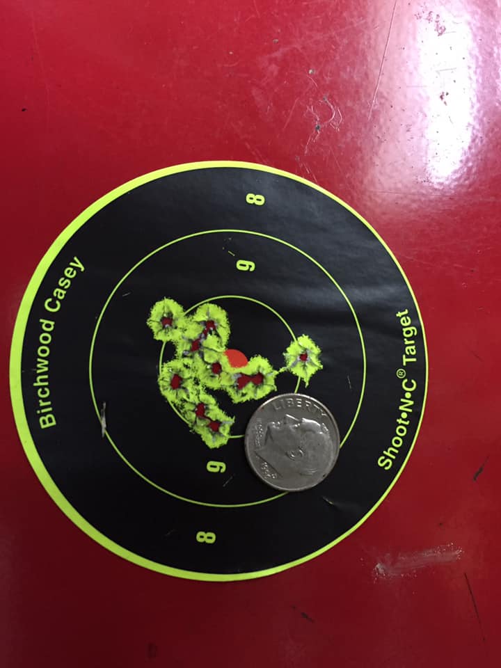

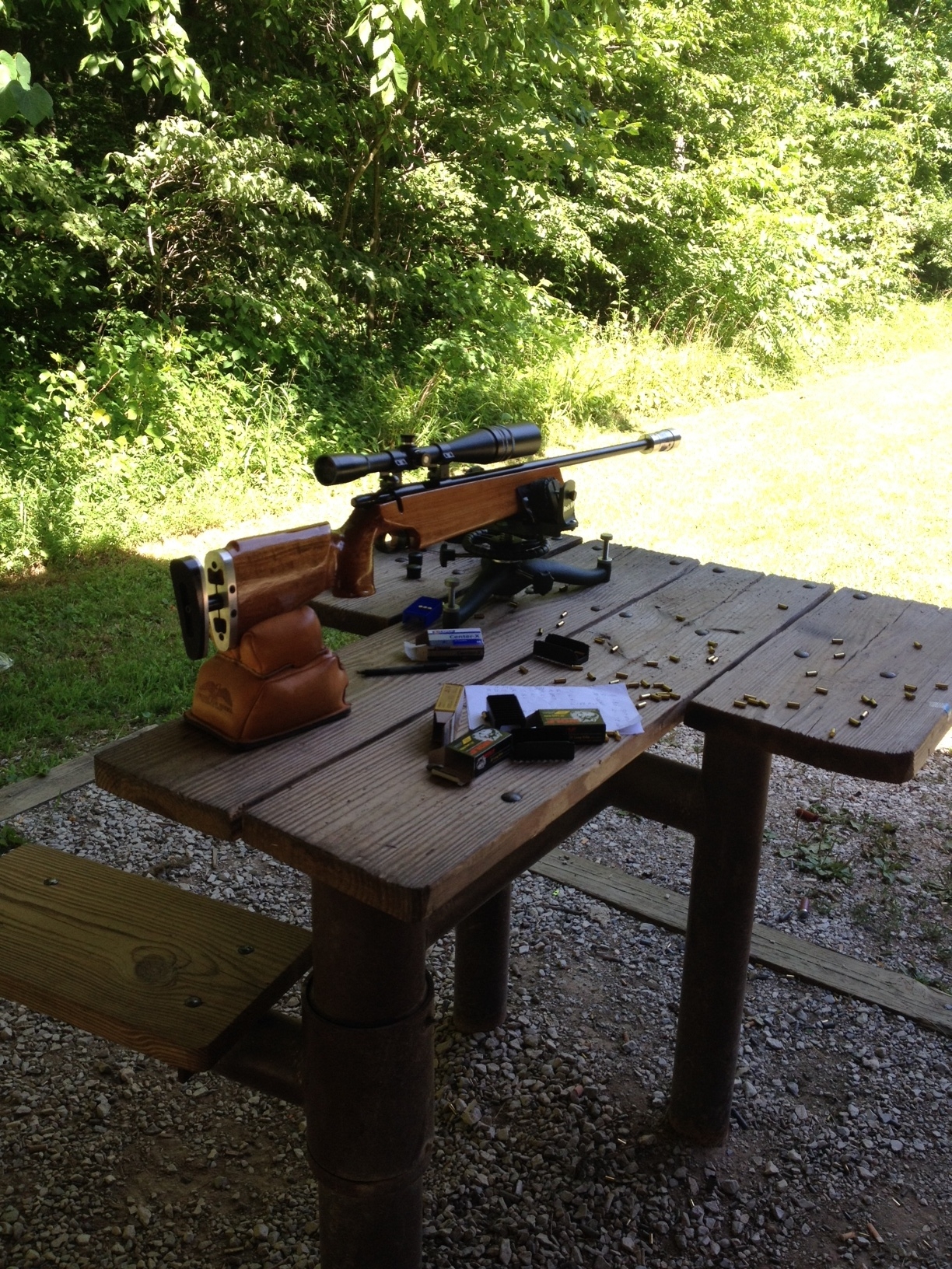

My experience with tuners is very limited. A few years ago, I purchased a tuner from Mike Ezel. I spent the time consulting with Tony Purdy about the barrel and how to set the tuner. I installed in on an already very accurate Remington 540XR that I had (see gen1 of 6x5 challenge). After spending a whole day and about 300rds of ammo I had it tuned to a specific lot of Lapua CX that it already shot well. Results? Reduced ave group sizes by 20% (more in some cases). Example 5 shot group attached.
In my case I found that anytime I switched ammo or even lot numbers of same ammo I had to retune the rifle. Very tedious and I was not competing with it at the time. Since it was an old vintage Remington, it was not good enough for unlimited and could not shoot factory classes with a tuner so, I removed the unit from the rifle. I have been using it with good result in the new ARA factory class this year but the rifle will not be allowed in 2021 since it is not a repeater. Thinking about reinstalling the tuner and giving it a try in Ivan's BP150 matches next year.
Irish
Reactions: Seymour Fish

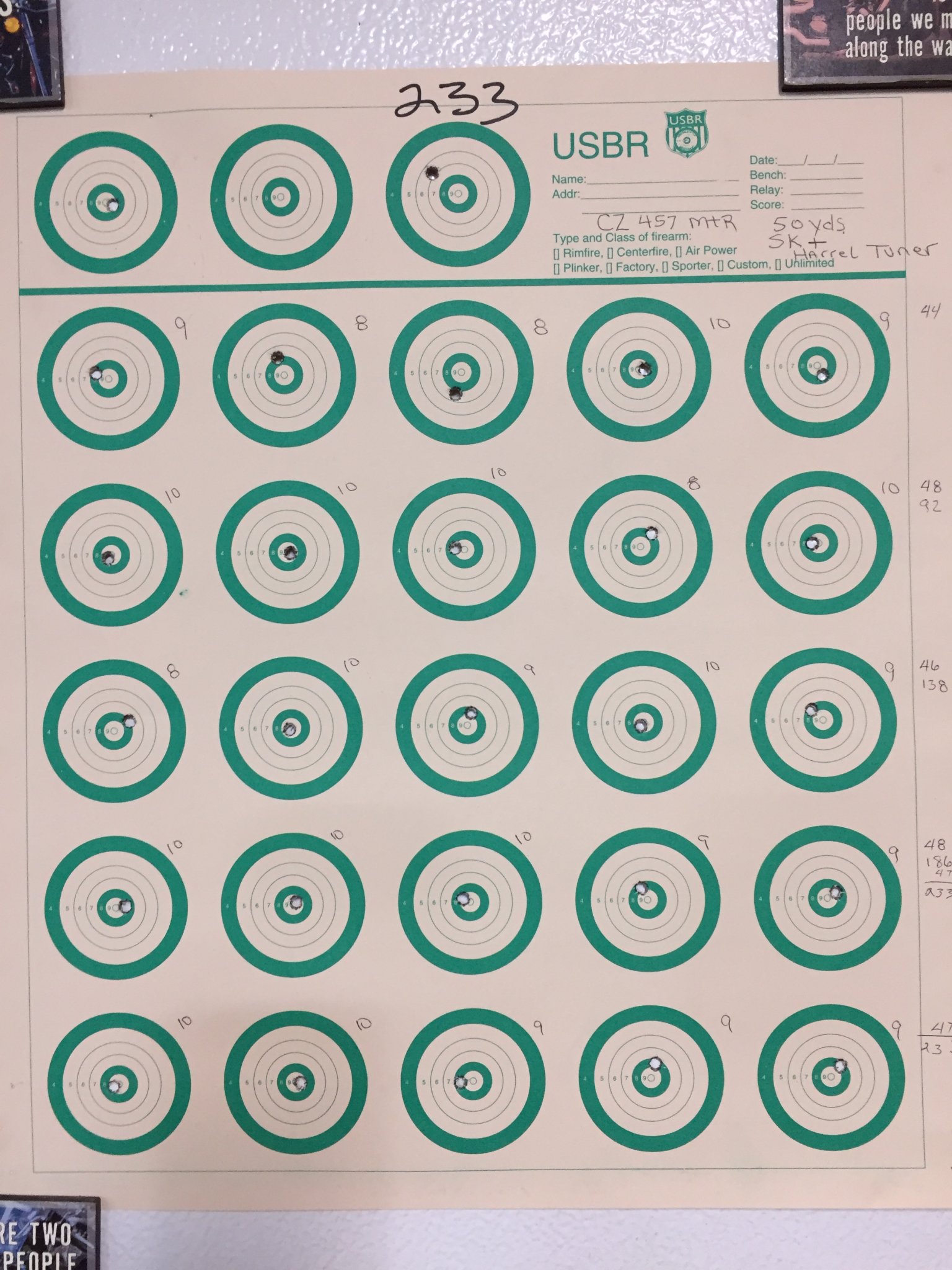

Put a tuner on my 457 mtr .22lr, made a big improvement. Tightens the groups and really cuts down the fliers. 10 rnds at 100 yds, good enough for me.
That is some nice shooting. How big were the groups without the tuner?
Using the USBR target, my best was around a 212 score before the tuner. My first try at it with the tuner, I scored a 233. The tuner made the gun much more enjoyable to me and well worth the 150 bucks.
