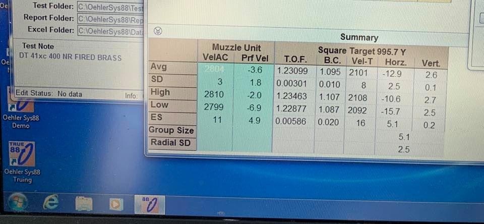

Here’s a post from Facebook related to the Nose Ring. I’m not sure how it’ll add to the conversation other than showing it does reduce the BC as David has already said it would.
The 505 WFL advertised BC is G1 1.200
David Tubb had a 3 shot group at 1000 yds yesterday with TUBBGUN™ in 41XC that had a SD3 of 3 and vertical spread of .2 inches. His 41XC brass is on its 5th firing. 128 grains H1000 with TUBBDUSTmixed in powder shooting a Warner 505 grain flatline with 1:8 twist 33inch Schneider barrel
Oehler 88 shows a muzzle velocity of 2804 fps but that’s more than 12 feet away from end of barrel. Magneto speed velocity is 2825 fps.
David says he has been consistently been getting 10 shot groups with SDs less than 5. There has been no annealing.
