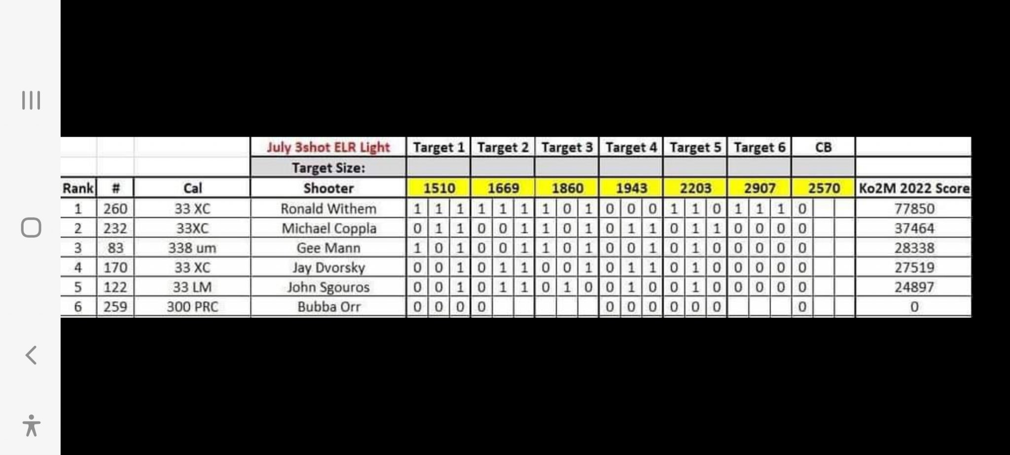

Im about to build one..But cant decide which route.. Either 112 because of bigger action or the route my friend and shooting partner Rodeohas .His 33XC is built off of a Savage Elite 110. I will say this. He won a match in ELR at Spearpoint Ranch,KS in the Light guns and against Heavy guns..And the next match he came in 2nd. His is built with a Shouldered Barrel and not the Savage nut.
My thinking is purely money wise..The 112 Target comes in a Wooden stock.The 110 Elite in a aluminum MDT Chassis which is what I already shoot in my 300 PRC.. and I absolutely love it.So if I buy the 112 I have to spend another 1500 to get the stock. And the 110 338 LM come with it. So my buddy is winning with his so if someone has negatives I just say his works great.

He won Spearpoint shooting a light gun? Who?
Reactions: TreyMeTrey
We were there the last 2 matches. He won the July match.Beat heavy guns too.Call Steve Wirth. at Spearpoint.Its easy to verify. I have the results on my phone.I will find them.
Going to the same match shooting at the same targets at the same distance match after match does not make you a great contender. Nor does using a less desirable platform. Credit where credit is due congratulations on the win but his chosen platform does leave a lot to be desired to be optimized and safe. Will it work yes but it is nowhere near the 1st and best choice but I understand that sometimes money is a factor
It only shows him shooting the August match and he got 85% of the winners points…
And he beat the heavy guns by about 40k or 50k points.

That was one of the requirements to be ko2m compliant for the longest time spearpoint was not moving their targets in my understanding is once they did start moving the targets they only moved them just a few feet basically not much change at all. None of that really matters he did a good job and won the match the question is will we see this consistently from this individual if the platform and the person is competitive for hops we will see this again
