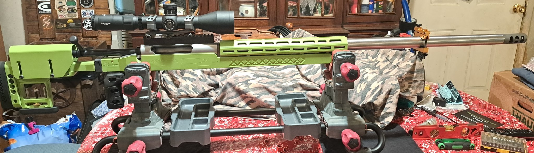

Here is my Heavy gun.Its a 375 Cheytac on a Stiller Tac Driver 408 1.6
In a McKees Precision Chassis with a K&P Barrel 1n7 twist to shoot the 427 grain Cutting-edge solid.Has a 50 MOA Rail and Athlon Cronus BTR Gen 2
4.5-30×56 FFP Mil/Mil.

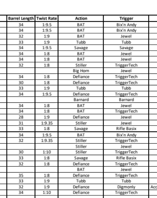

How about an equipment list from ko1m. I feel your having selective listening. No one says it can’t be done and made to work. There are better options. I’ve put a improved Cheytac sized chamber on one and made it work just fine. (After it rattled everyone single fastener loose at one time or another) But if I were like you, and money didn’t matter, there’s no way it would be my action of choice.
