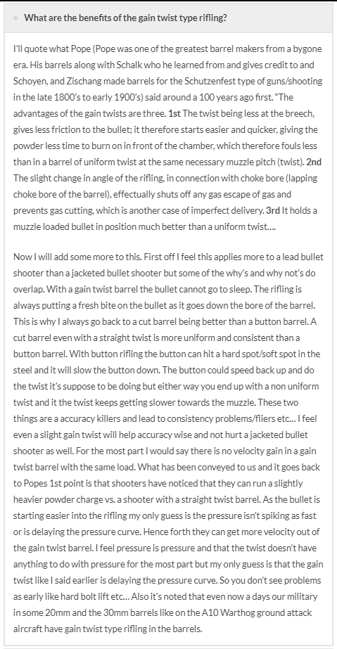

stello, i've not seen that twist noted on some of the barrel manufacturer sites....could you please tell me more about it. i would imagine that it's like a carcano rifle where the twist rate increases as you go from breach to muzzle.
are these increasing twist barrels well received and noted to improve accuracy. would love to learn more about it. thank you
They are exactly as you describe.
Bartlein does em https://bartleinbarrels.com/barrel-faq/

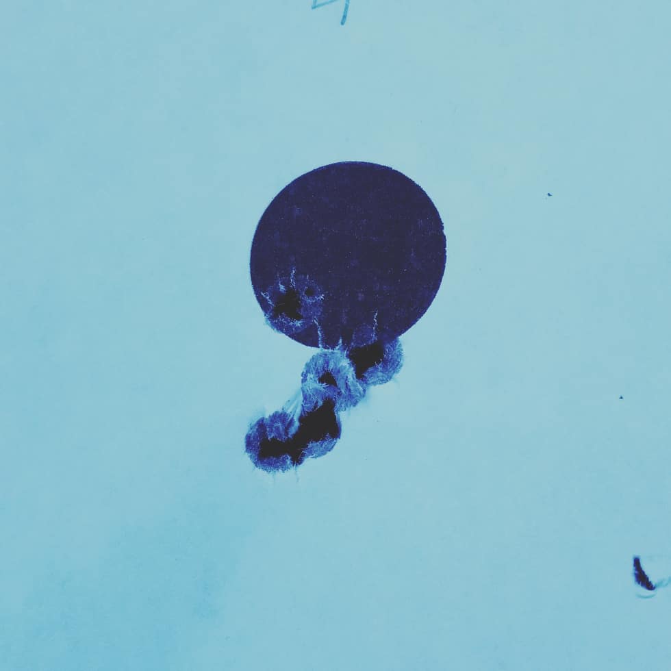

I went with a proof barrel from straight jacket armory prefit for my origin in 6.5x47 and it took 4 weeks. just during load development on a wild guess charge I produced a .466" group. 8T
24"
