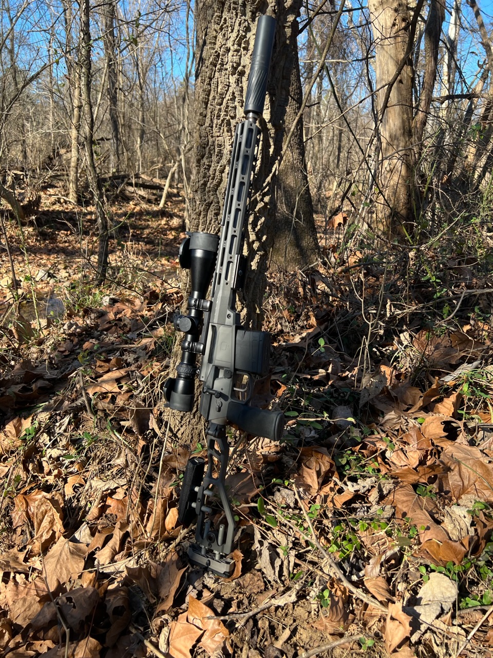

I had a LHT 4.5-22 on a hunting rifle and hunted with it. It wasn’t a bad optic but didn’t stick around long because it’s just not a great optic for the crossover use like it’s marketed for. It’s a far better long range optic than it is a hunting optic for probably 75% of hunting. It would be great on a varmint rifle but it just lacks the FOV and ability to easily pick up the reticle down low for a hunting rifle.
Reactions: opherman47

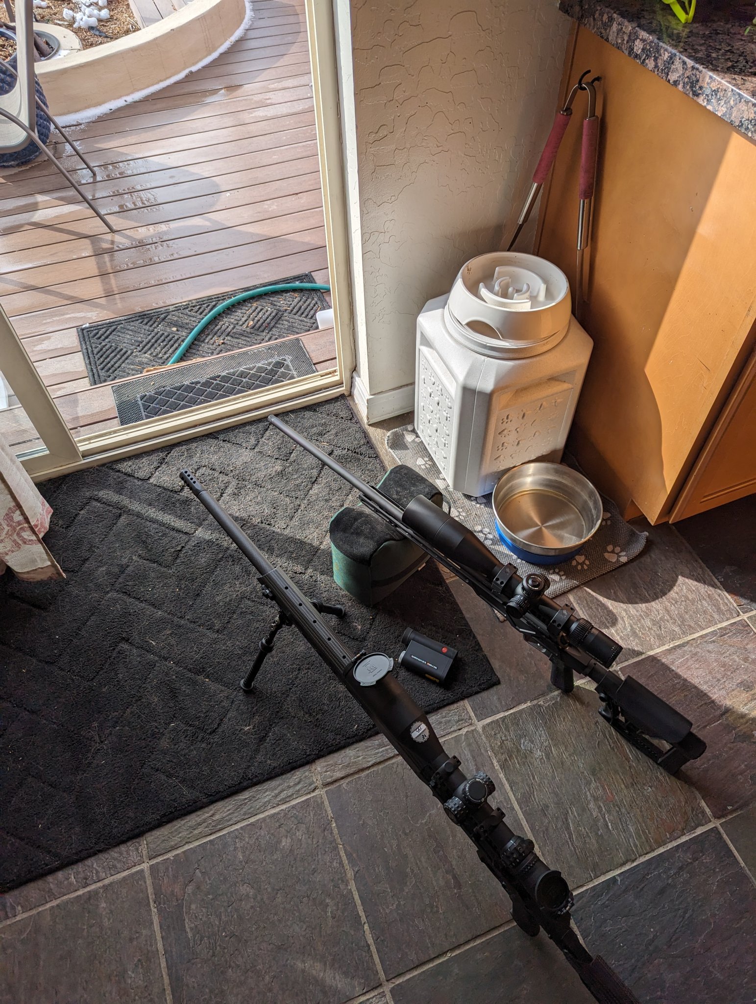

Okay, I thought I had nothing but venoms for our family 22's but apparently I did get a strike eagle 5x25 for my CZ 457.
I have got these two scooes looking at them side by side.
Se 5x25 and the nx8 4-32.
I can tell a bit of difference between the glass. But both are absolutely serviceable optics to hit pie plates out to 1000m per my Leica range finder.
And on top of that sighting The street sign across the way at 46 m. No problem making the shot at minimum zoom. Like the reticle is totally fine.
I've got the tremor 3 on the NX8 and whatever on the 5x25 strike eagle.
What am I missing here?
Try that the last 10 minutes of legal hunting time.
Reactions: Aftermath
^^^ that and animals in woods that aren’t reflective street signs LOK
I’m done here, buy whatever you feel will make you happy. It’s no skin off of my ass if you spend thousands of dollars to go hunting and miss your chance at an animal because you can’t find your 3x FFP reticle.
