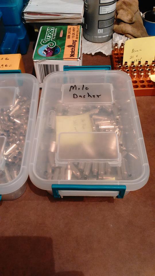

Sorry, I should have probably stfu on that one, here in our circles, we got away from bins and now use "Butters" boxes in varying sizes, named after a friend we call Butters, he invented them. I can honestly say the lid saves me from myself, lol
