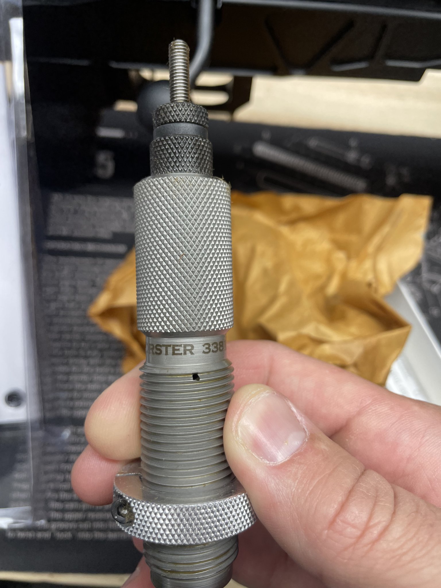

Just picked up my first Forster die for my 338 from Midway
and noticed a hole in the threads. Is this by design? Looks like a QC issue to me. Anyone have experience?

Just picked up my first Forster die for my 338 from Midway View attachment 8498259and noticed a hole in the threads. Is this by design? Looks like a QC issue to me. Anyone have experience?
Awesome thanks!It's by design, air has to escape somehow, I'm pretty sure all dies have them.

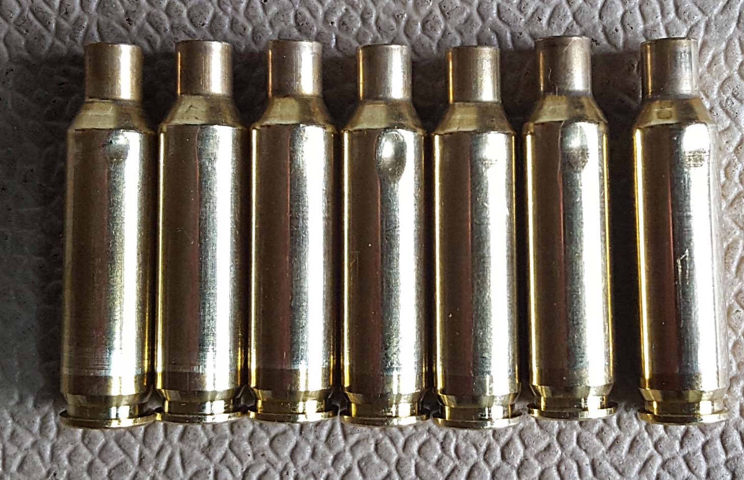

Yes, it's by design. It really helps in preventing dented cases, as below pic, from too much lube when sizing.Just picked up my first Forster die for my 338 from Midway View attachment 8498259and noticed a hole in the threads. Is this by design? Looks like a QC issue to me. Anyone have experience?
Weep hole would be the correct name of that feature . Oil will escape thru it in case you over do it.Just picked up my first Forster die for my 338 from Midway View attachment 8498259and noticed a hole in the threads. Is this by design? Looks like a QC issue to me. Anyone have experience?
