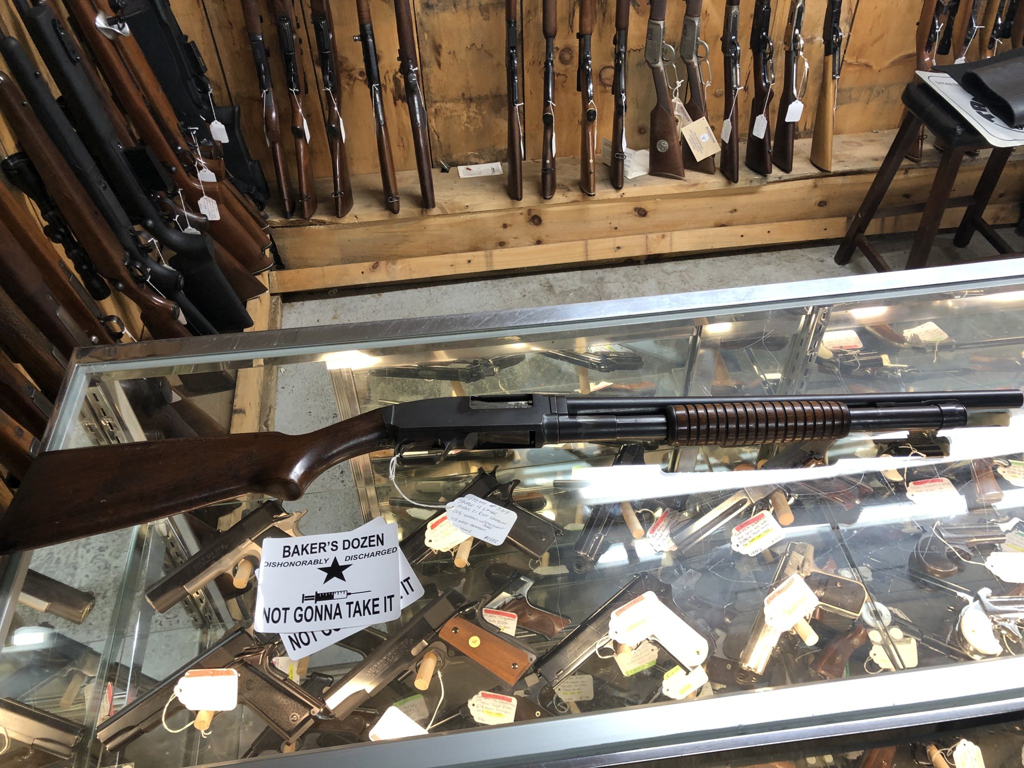

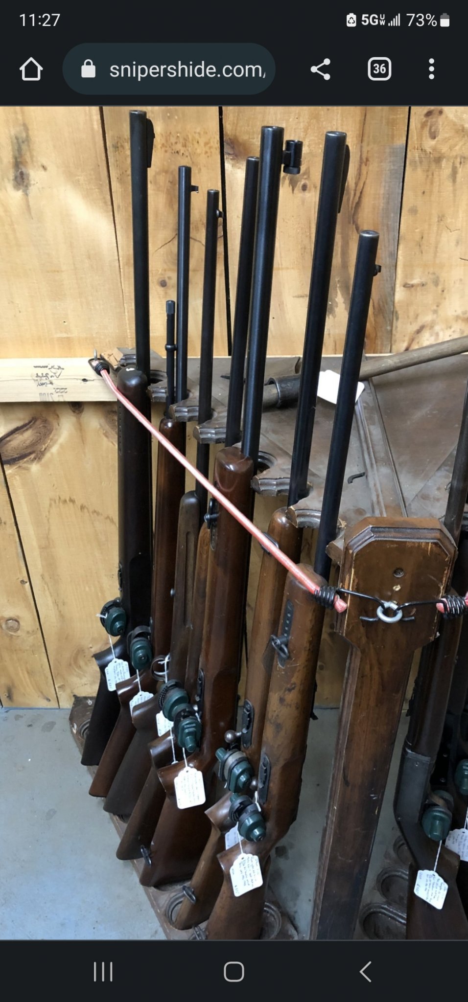

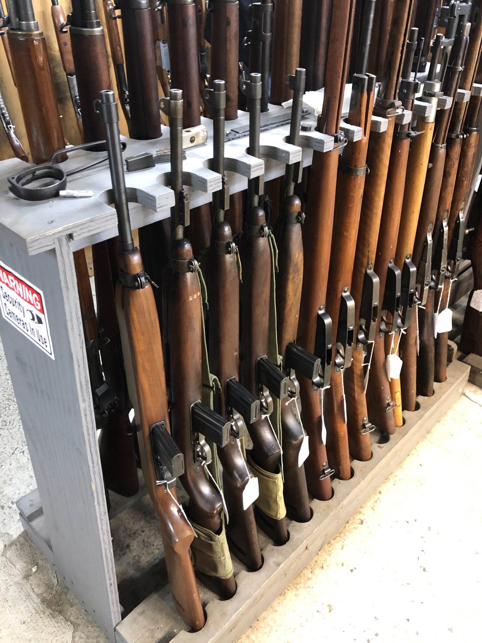

Heading to the honey hole today, good friend is looking for a K22 and there are a bunch there.
I’ll make a post of what’s available today.
Can do- is there anything in particular you were looking for? Just trying to come back with more than- "handled them at the gun show, they look very nice, I might buy one".
-LD
General build quality / attention to detail (metal fit and finish / stock inlet gaps). Product knowledge of the people working the show, and their general attitude towards engaging potential customers. Basically if they seem to give a shit about putting out a quality product or not.
Reactions: LuckyDuck
Not many 03s at the honey hole today.

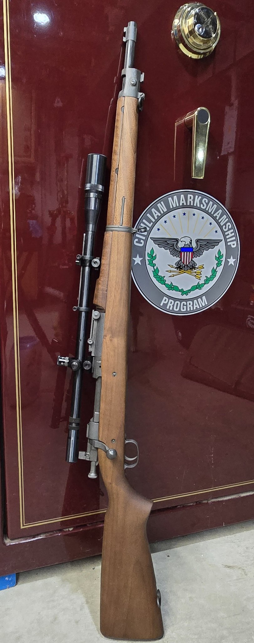

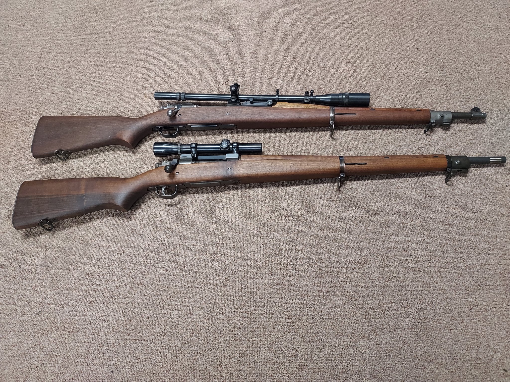

1903A1 and 1903A4 (A4gery)
The 1903A1 was built from a Sporter had to hunt down the rear sight and front stock metal. It was the only 1903 donor rifle I had. The Malcolm 8x optic is a Hi-Lux Repro. The stock was an old Boyd 1903 C blank custom inletted
The A4gery was built from a 1903A3 Drill Rifle needed a new barrel, had to used my last NOS barrel for the build. The optic is a 65+ year old 2.5x El Paso Weaver which is CMP match legal. The stock is a new Minelli 1903 C
The CMP armorers have to approve the rifles for use in Vintage Sniper matches. They can grade hard, one year we were limited because of an aftermarket safety tab. Drilling and tapping these receivers are tough, we take the top hardness off with an end mill, before drilling, then spot annealed the holes before tapping. Tapping the barrel for the A1 was easy by comparison. AND YES THE 1903 WAS NOT A DOUBLE HEAT TREAT EARLY SN SO CALLED "BRITTLE" RECEIVER. They still certainly seem pretty damn hard to drill & tap, compared to a Remy or Winny commercial receivers.
I forgot to mention, and why I kinda posted off topic... the stock re-enforcement screws for the Minelli stock were from US Armament . They were reasonably priced, shipping was fast, they were in spec, and of good quality. On the subject of stock screws, if you build your own get the longer action screws.
I've seen a (USAC) US Armament Corp 03A4 build, the fit and finish were good, the price well, I'm an old boomer as a kid 03's were a dime a dozen (actually 20-25 bucks). So the USAC price tag was why I built my own. Of course a nice 03 or 03A3 donor rifle will set you back $800-$1000 and if you can't do the work yourself... The USAC price tag is probably worth the bucks, especially if it's built a real 03A4 receiver.
