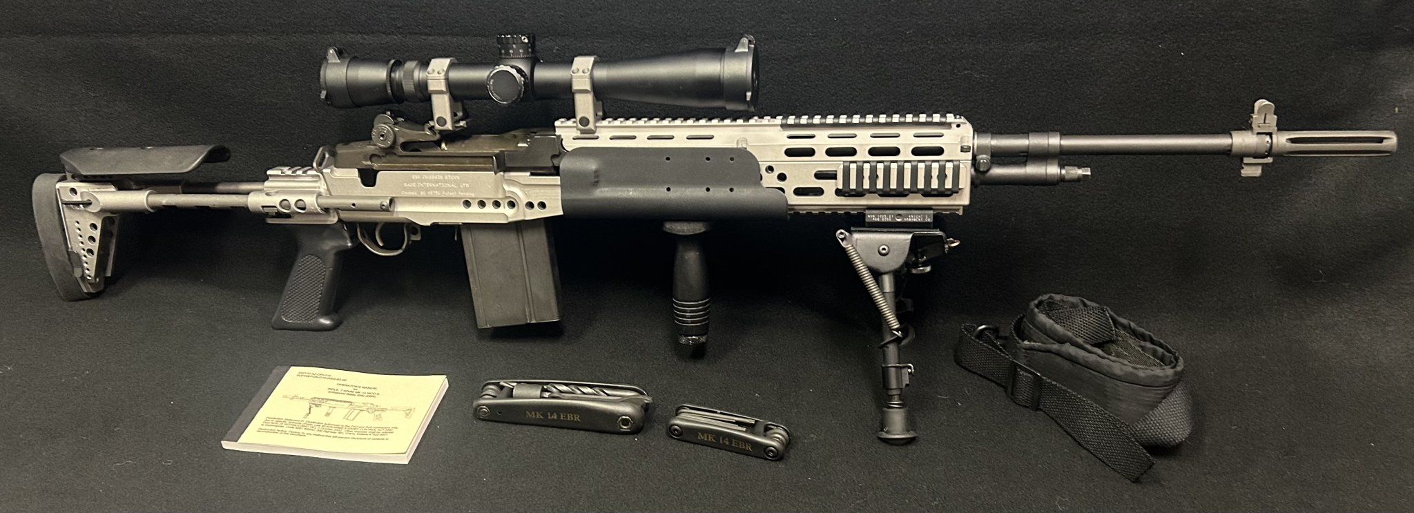

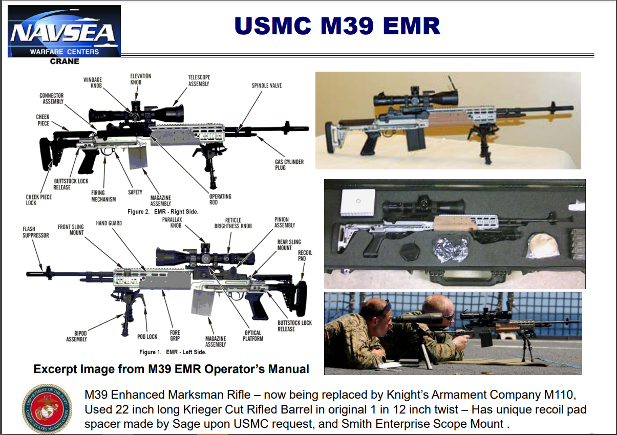

Speaking of EMRs (tool kit is for earlier green DMR but carried over)
Thanks for sharing that older tool kit I had never seen that before. Still haven't been able to track down either the TM 11473A-IN/2 or the TM 11473A-OR/1A but I have the actual PWS build guide. These posts made me want to take mine out so I did lol and it turned into quite a stormy range day.

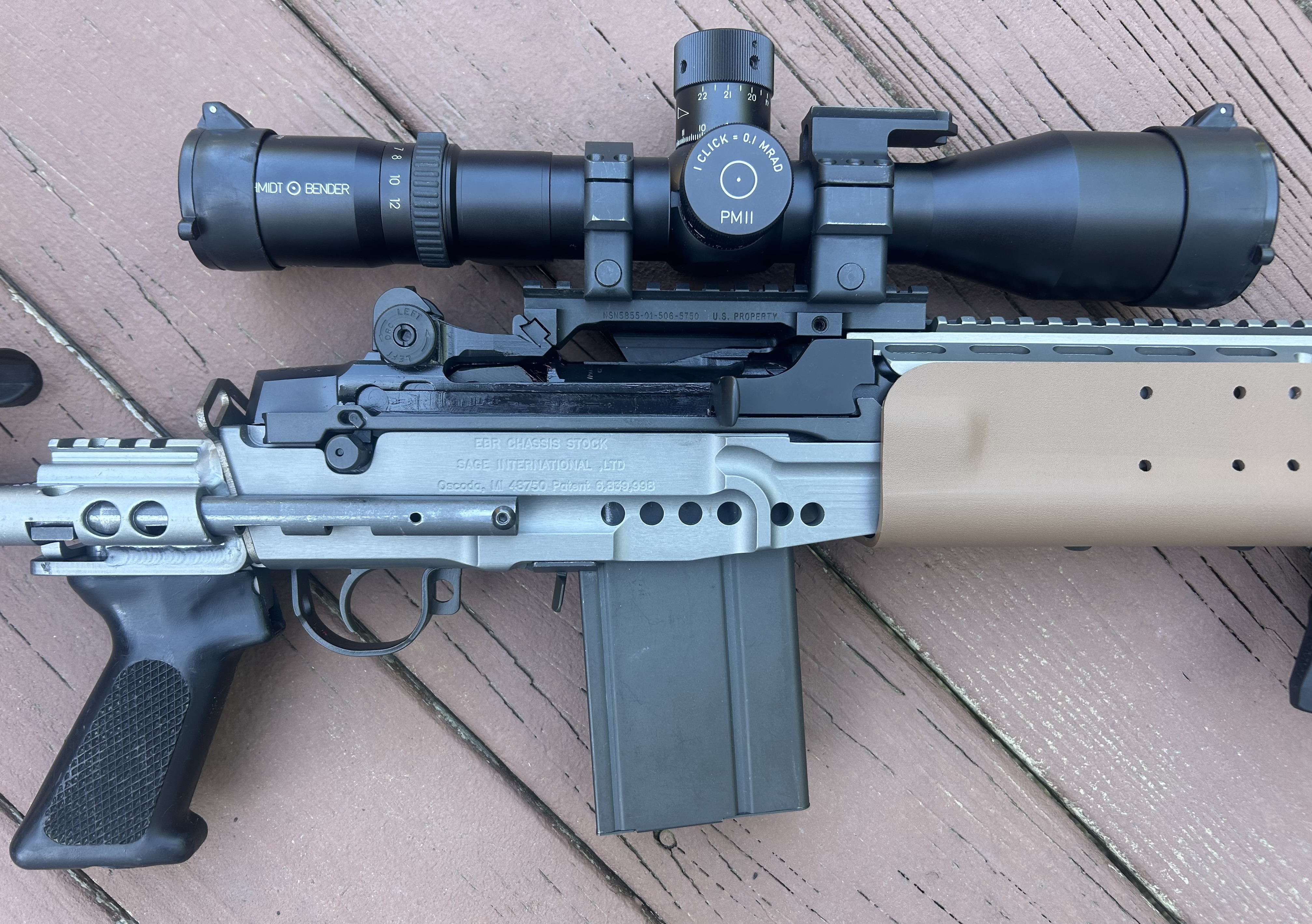

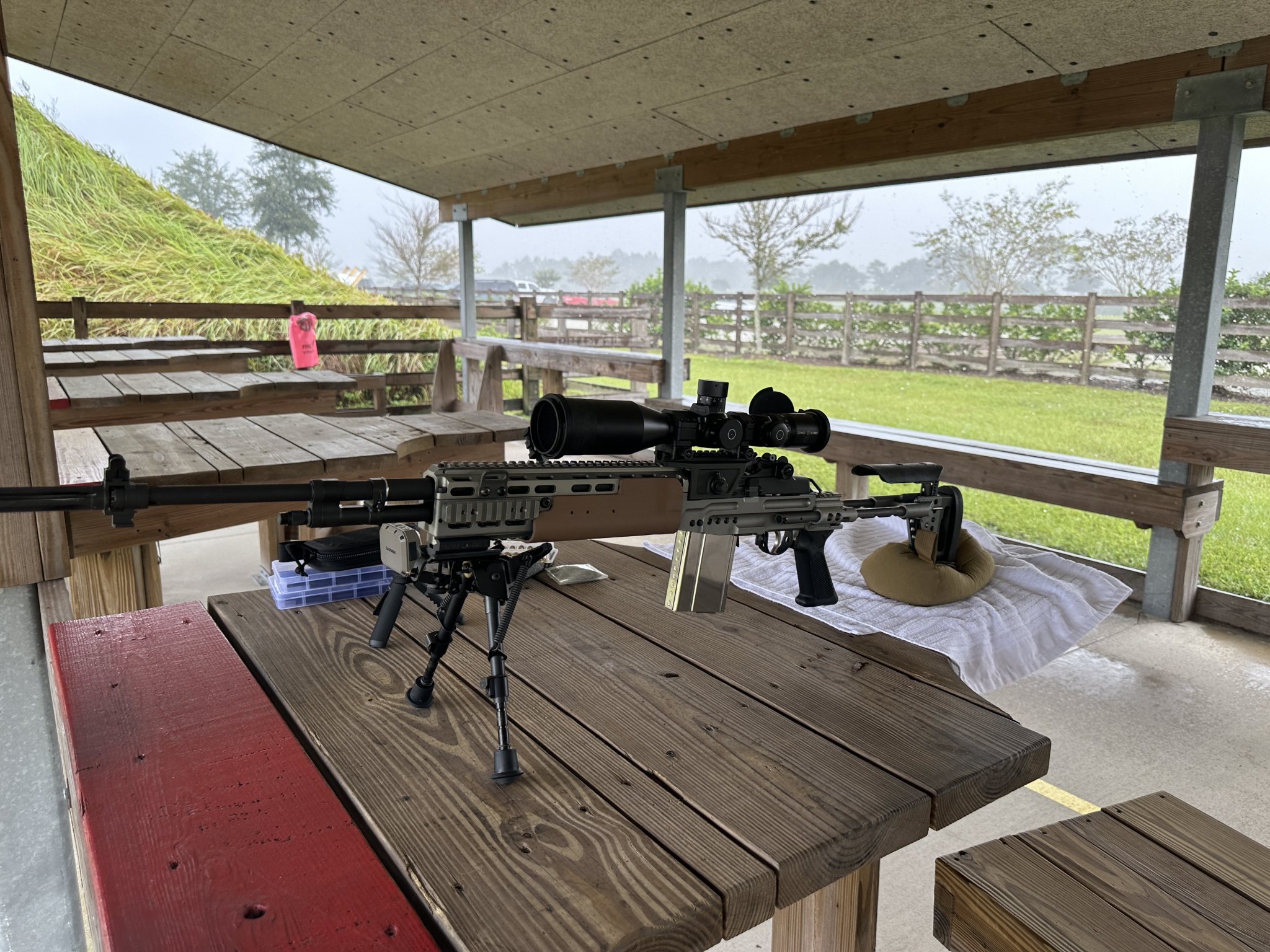

That is one SHINY magazine! Is it chrome plated for extreme pew-pew-pill feeding?! 😂
Reactions: macethetemplar
HAHA my dad calls them the terminator mags.... The standard CMI Stainless mags come high polish like that, and with the conditions like that every day in FL I tend to lean stainless when I can. I hadnt really thought of it until now but I really should brush them to match the chassis.
My pocket carry for a bit was a Ruger LCP, the slide rusted within a month, sent it back twice to ruger for a recoat before I finally found a stainless slide.

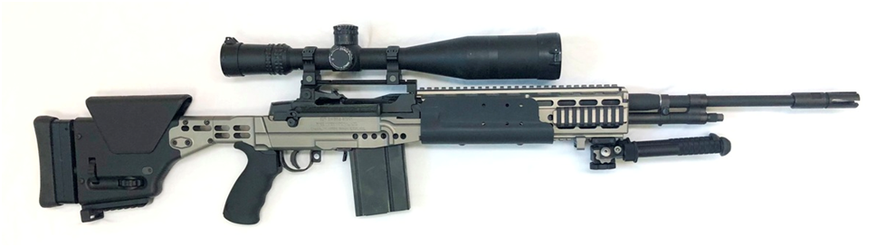

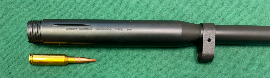

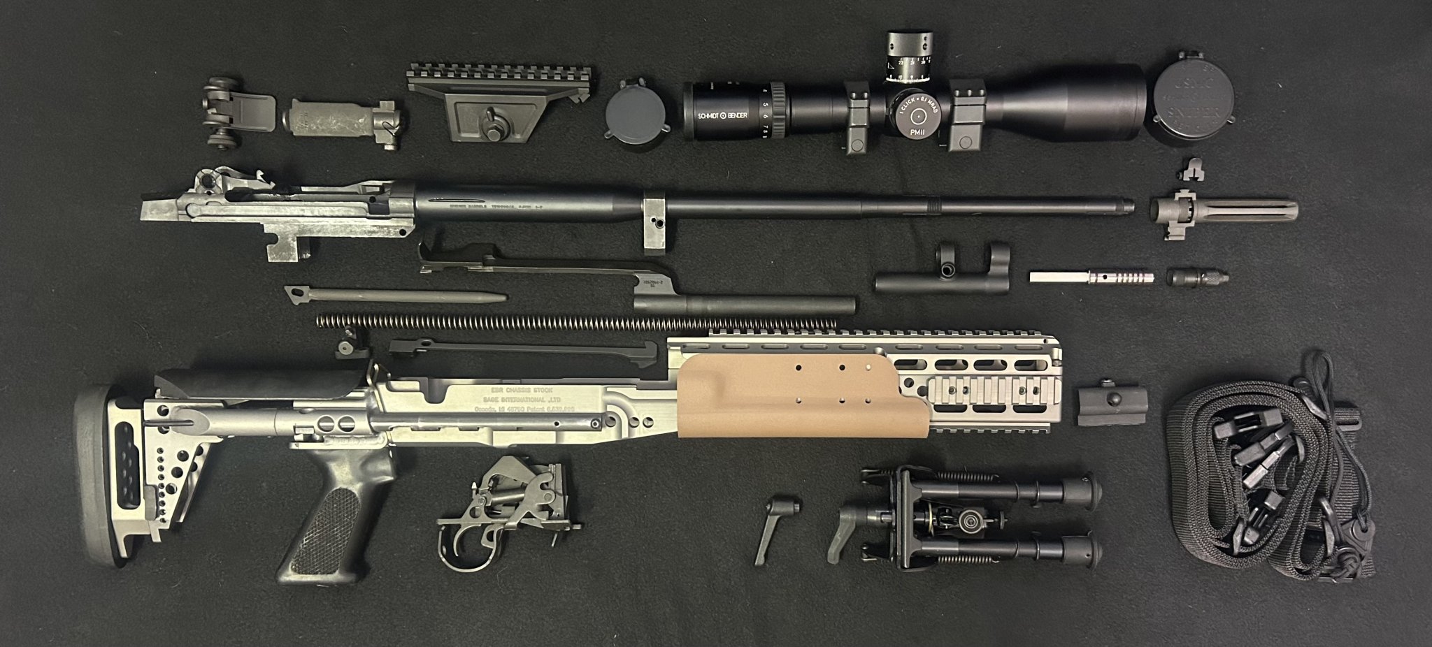

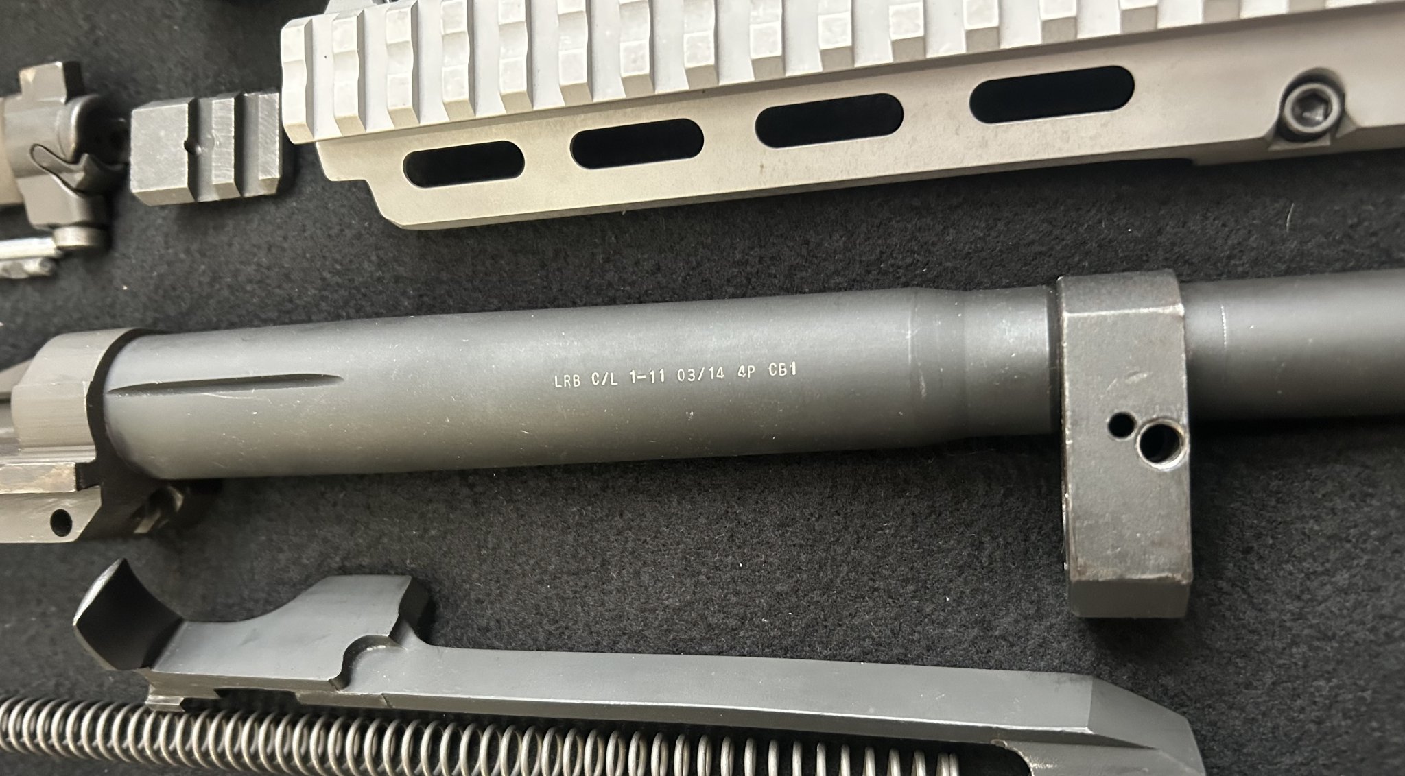

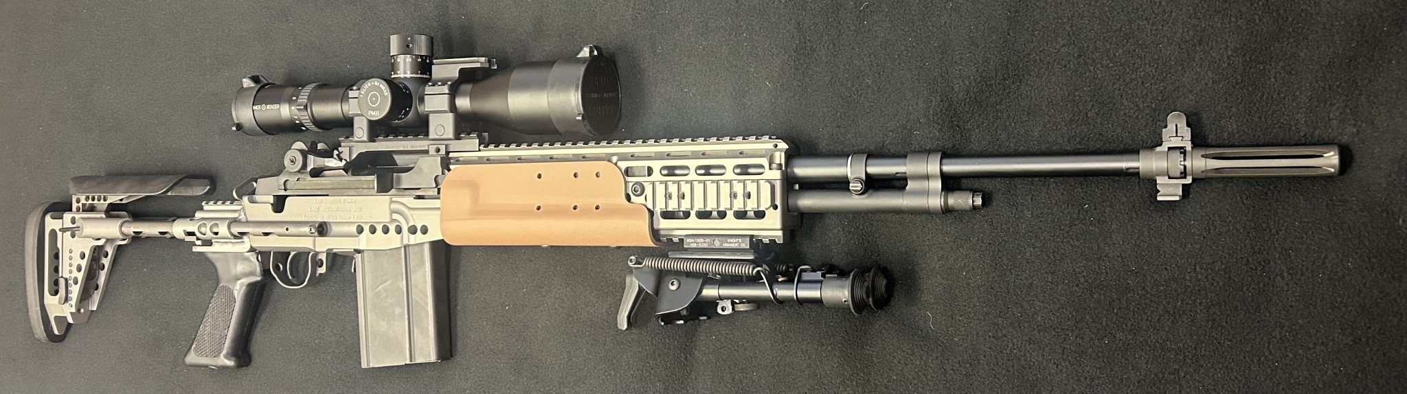

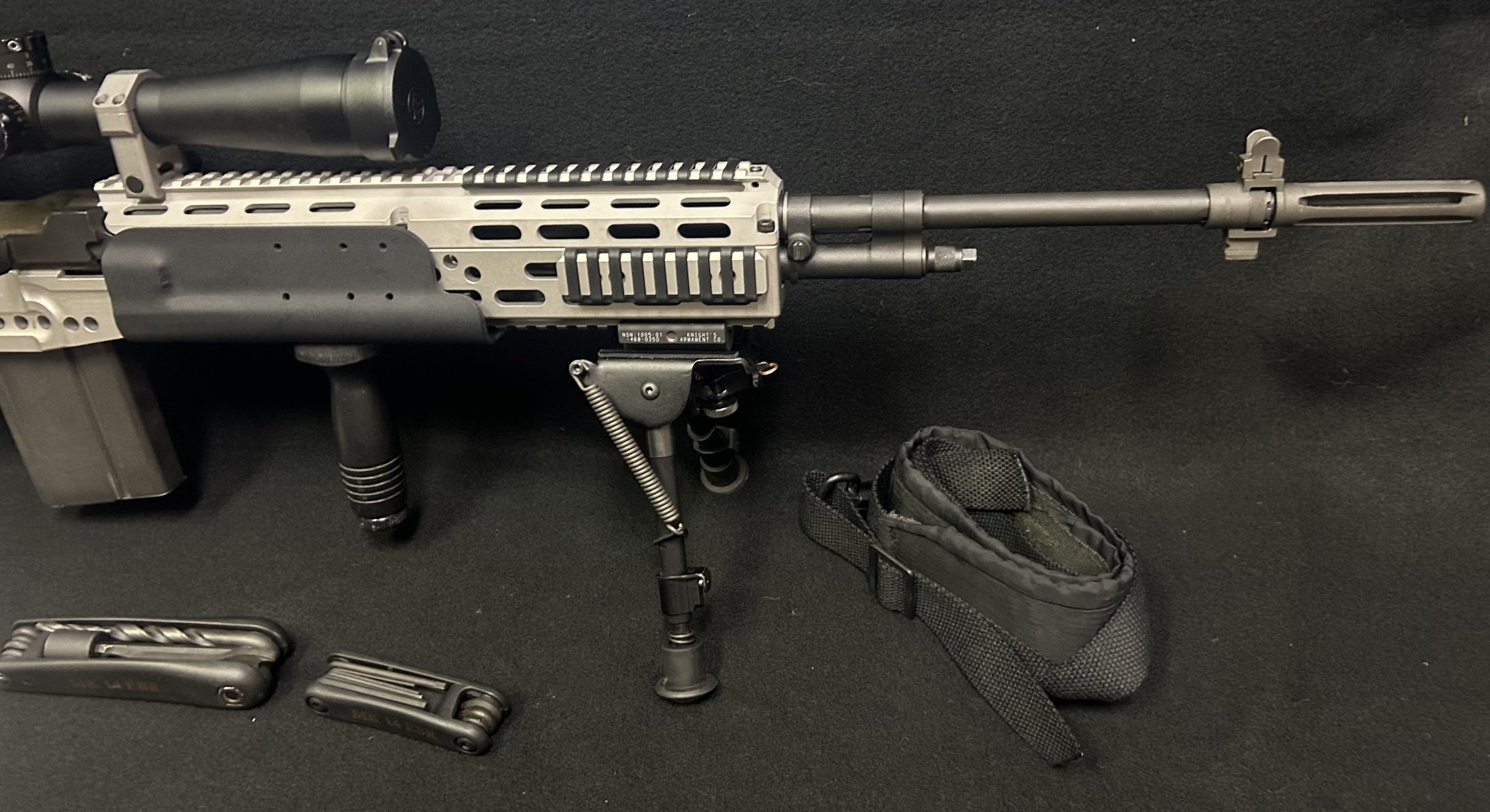

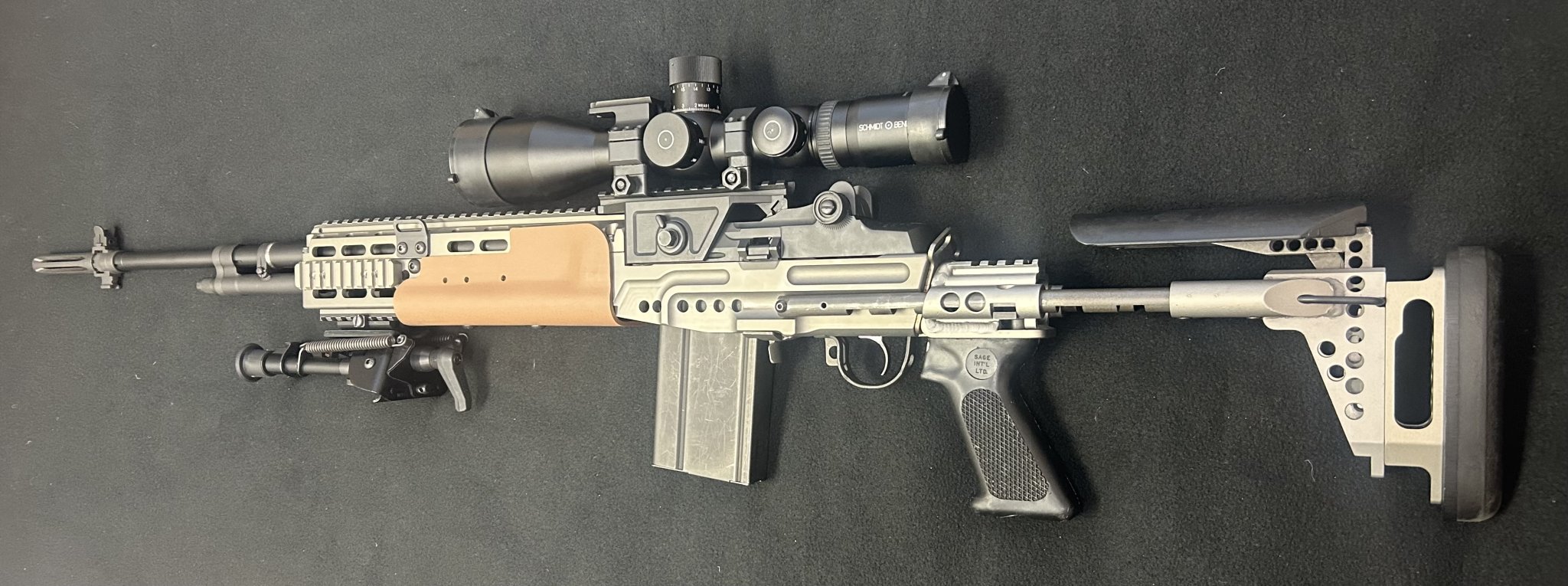

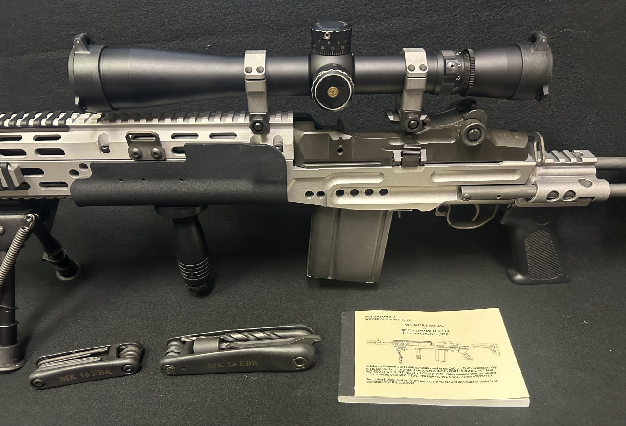

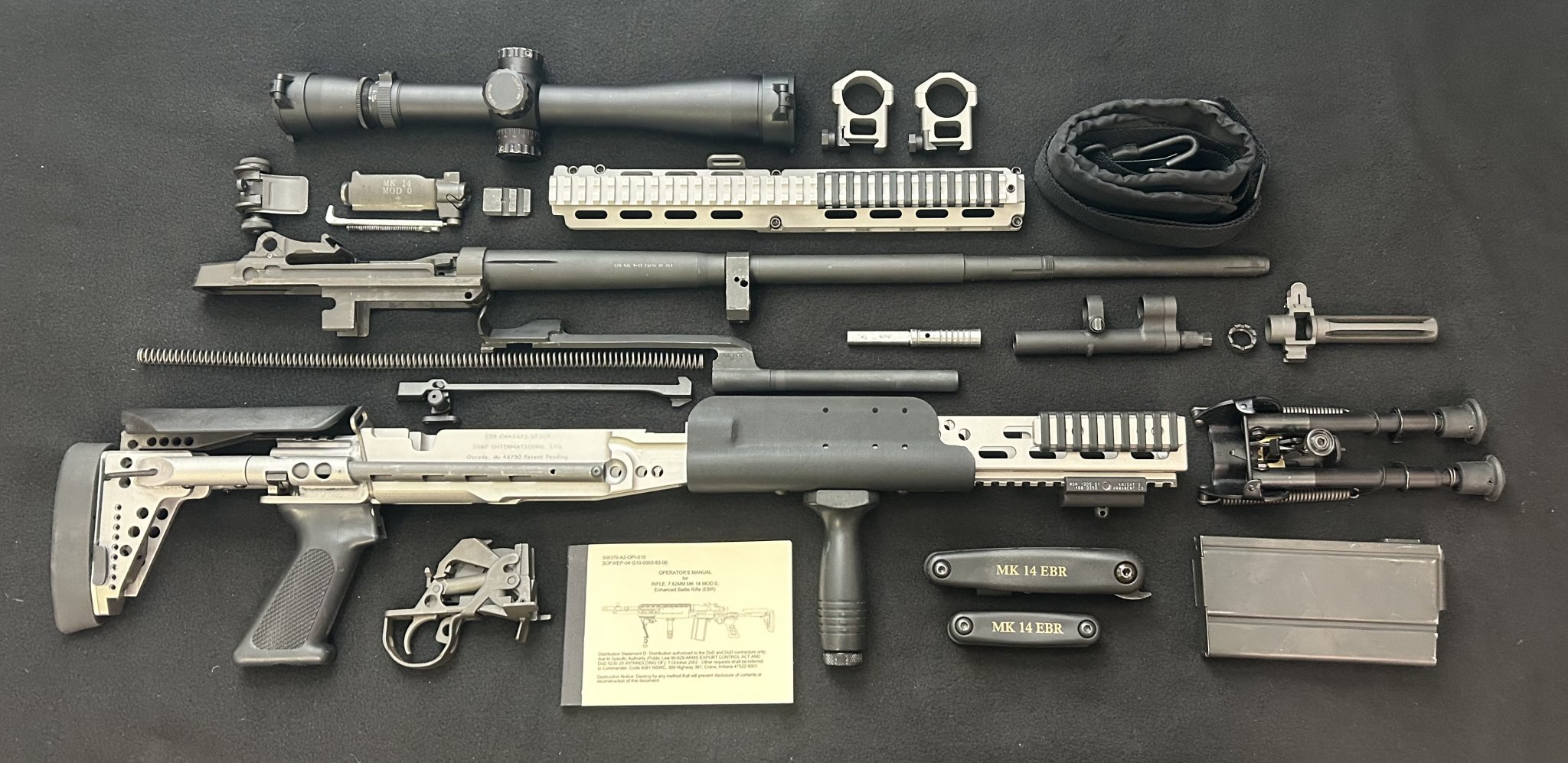

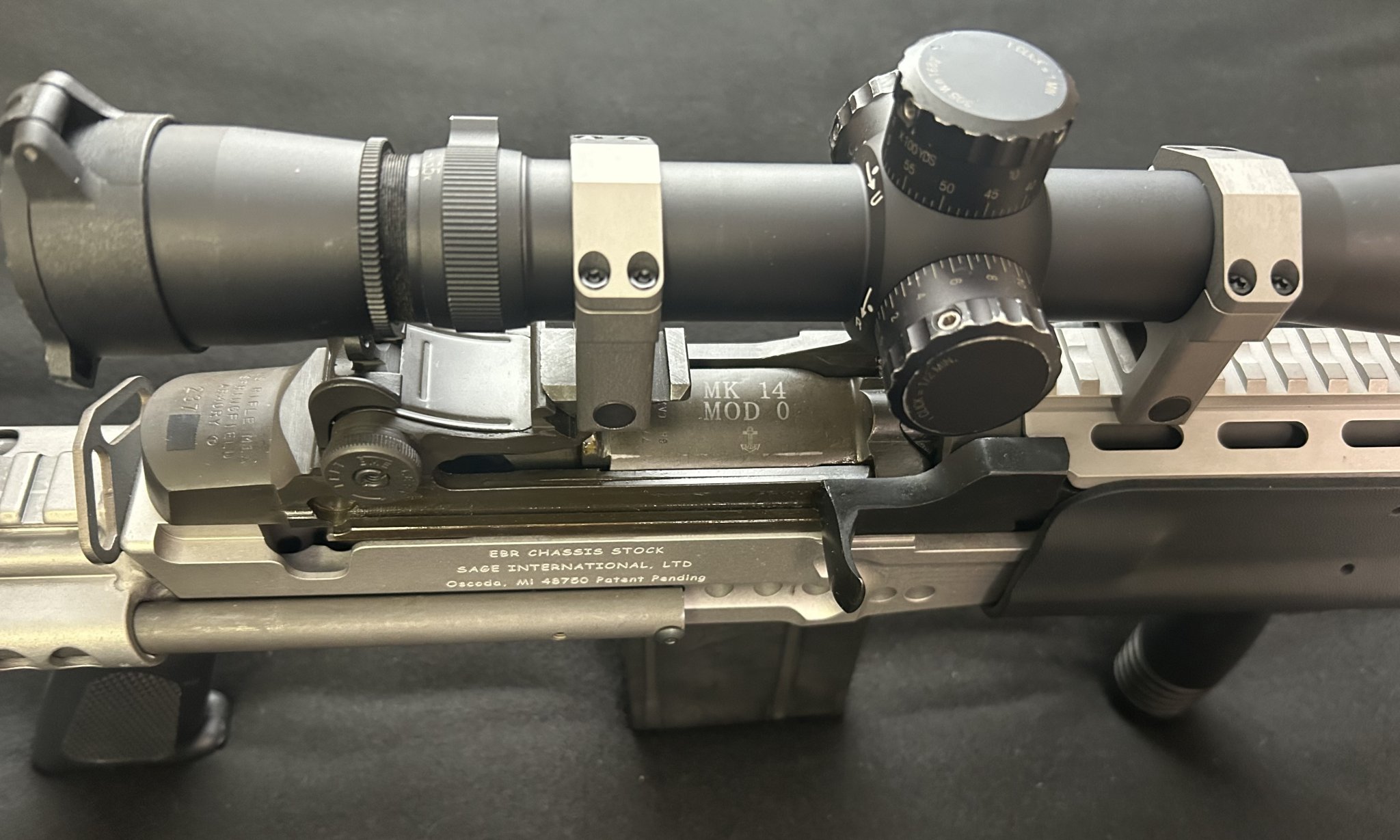

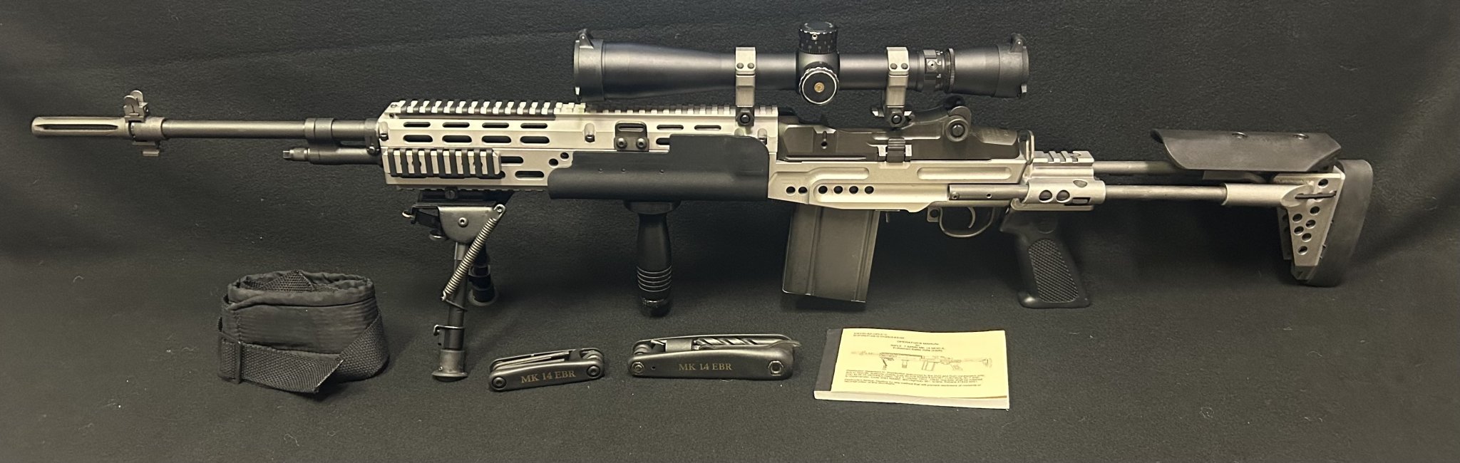

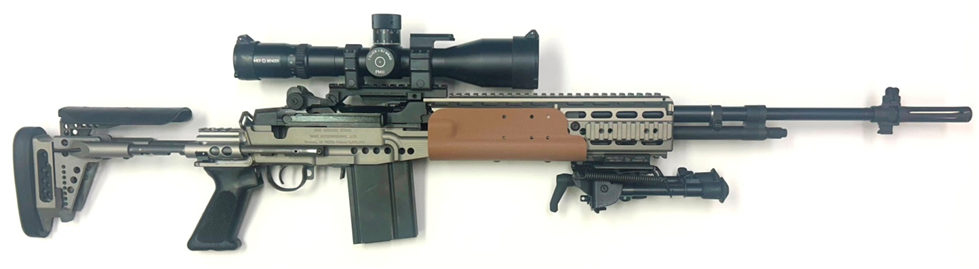

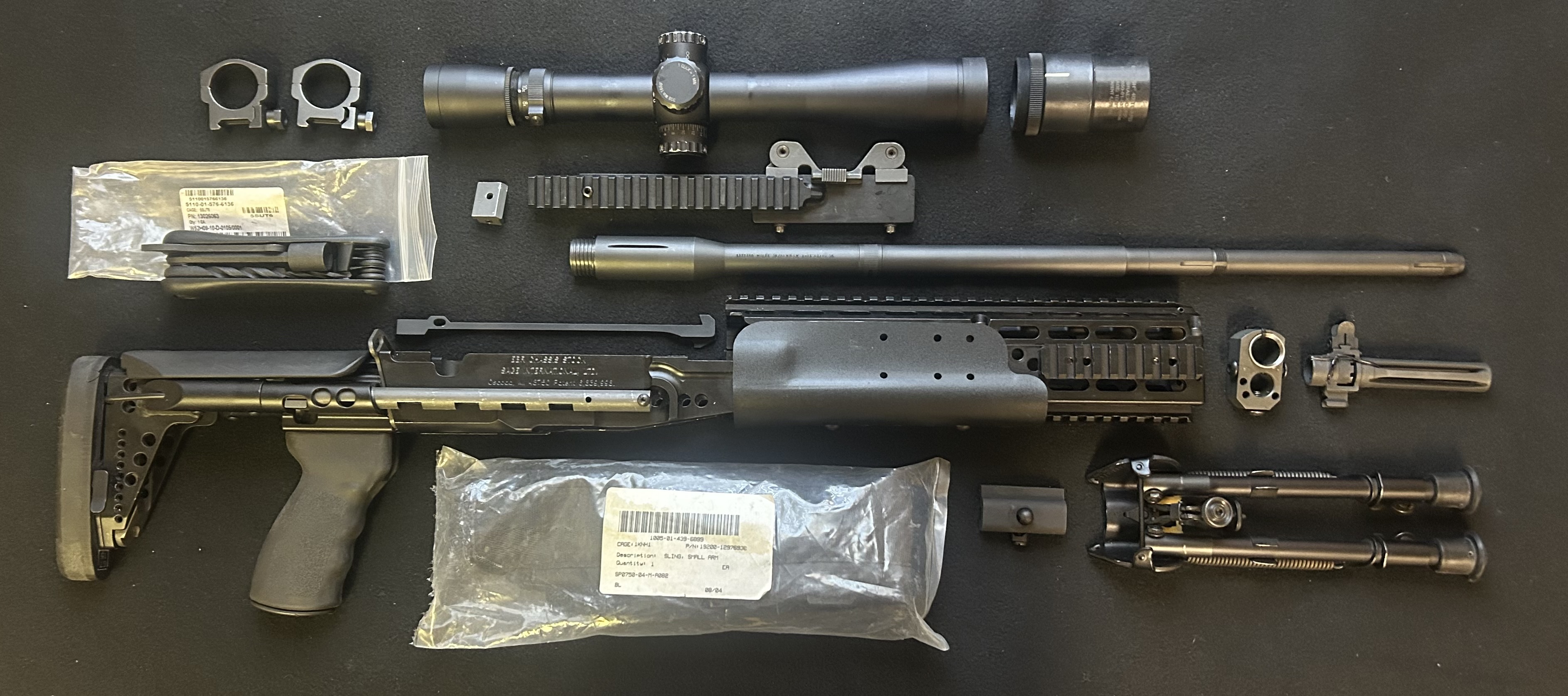

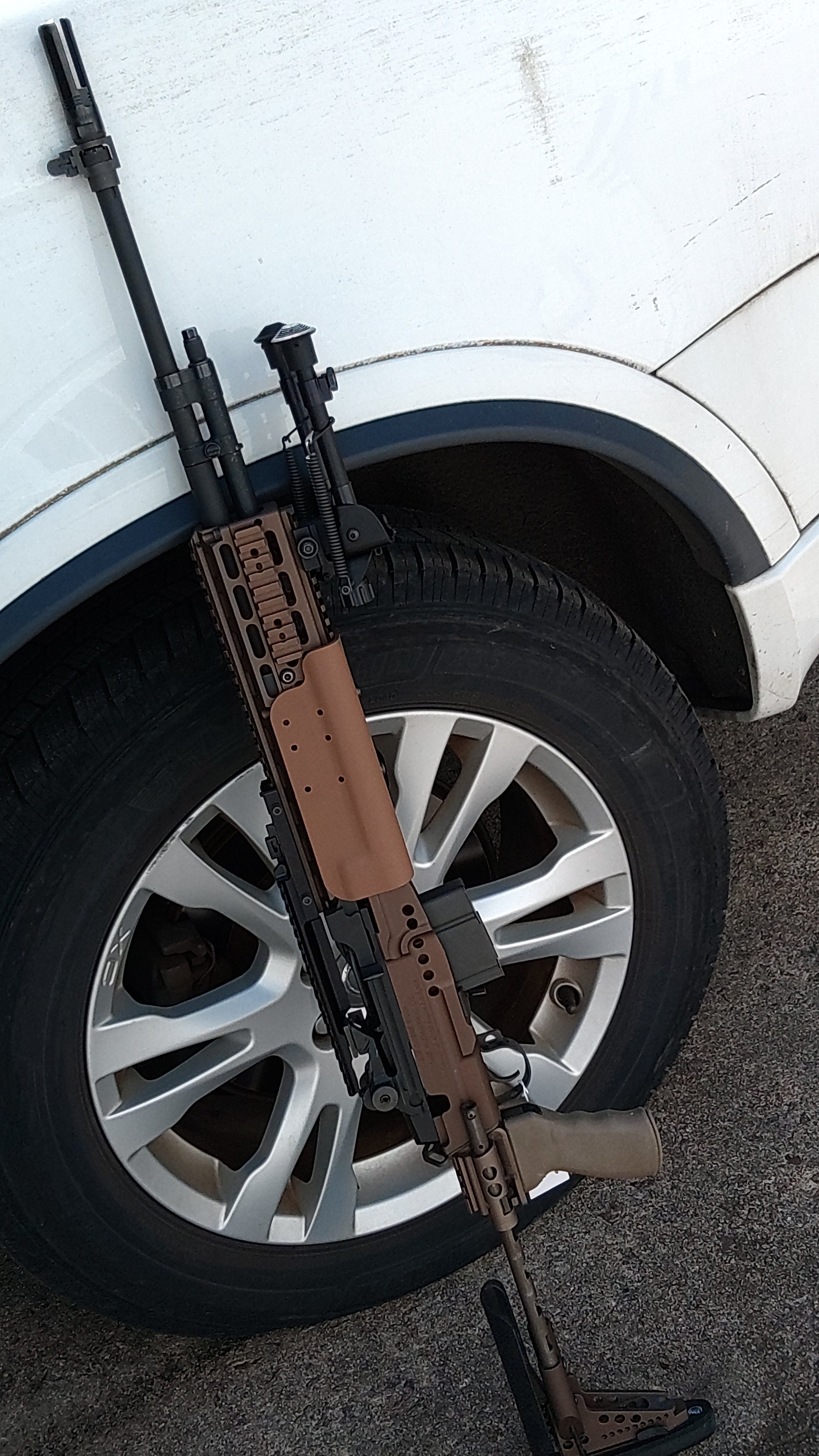

For anyone interested, here are some pics of my latest M14 replica project - an early Mk 14 Mod 0 circa 2004ish. First, two pics provided some inspiration. What is unique about these early Mod 0s is the 1st generation SAGE chassis with 13” long forend, and full length 22” barrel. These would be 2004 era SAGE chassis, but feedback to Crane included a request to lighten the rifle. So, beginning in 2005 the production Mod 0s had the shorter “chop mod” forends that were 11.25” long and the barrels were shortened to 18” length. My replica is the earlier version.
My project parts collected between 2020-2024:
Notable deviation with my replica is a medium weight chrome-lined match barrel, instead of a standard profile USGI M14 barrel.

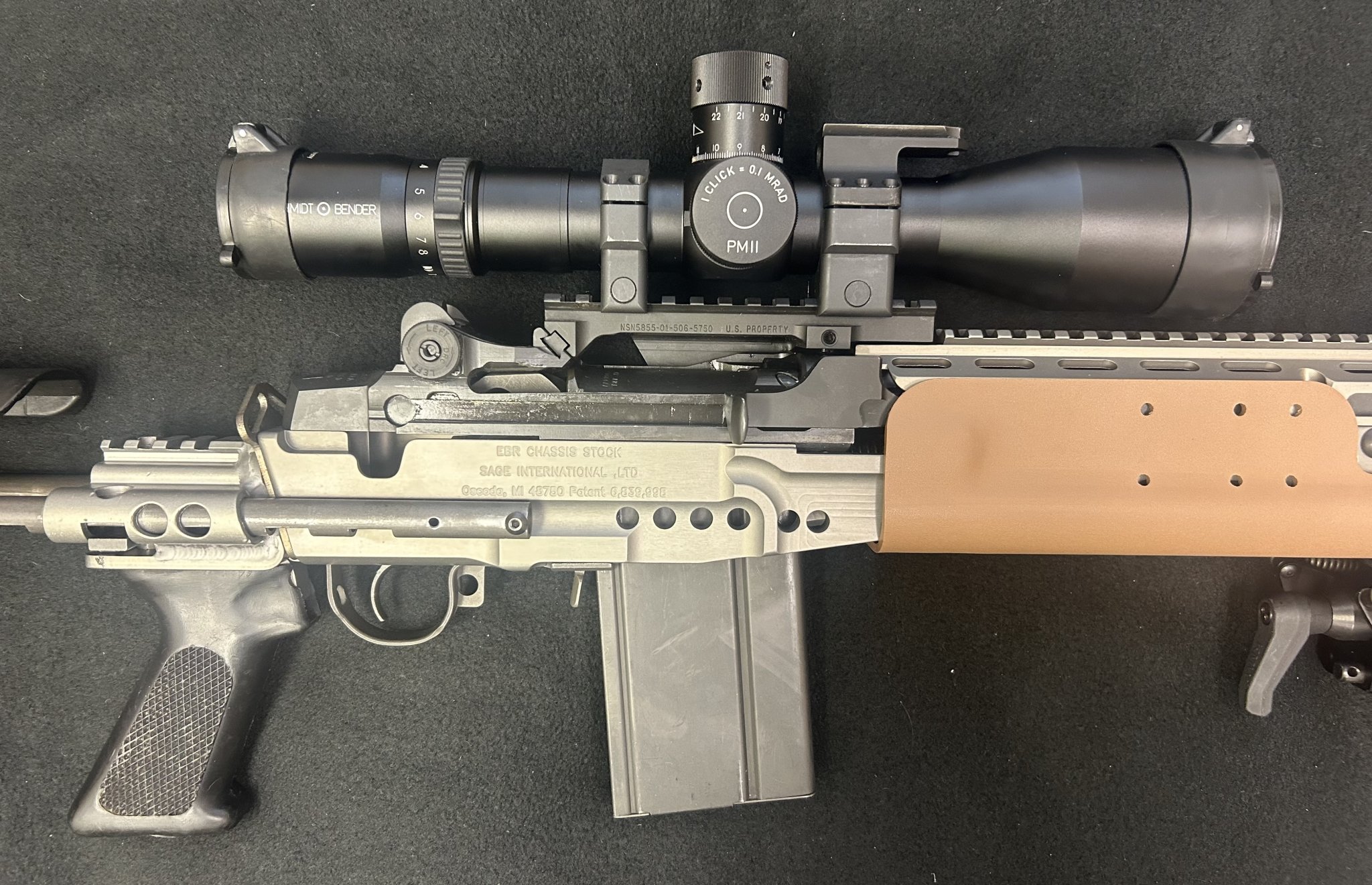

Mock-up (still need the SAGE op rod guide mounting bolts and to install the faux M14 selector lock). For those curious, the rifle will weigh about 15.5 pounds unloaded with the padded M60 sling. Durable but heavy.
So that’s my latest M14 replica project.

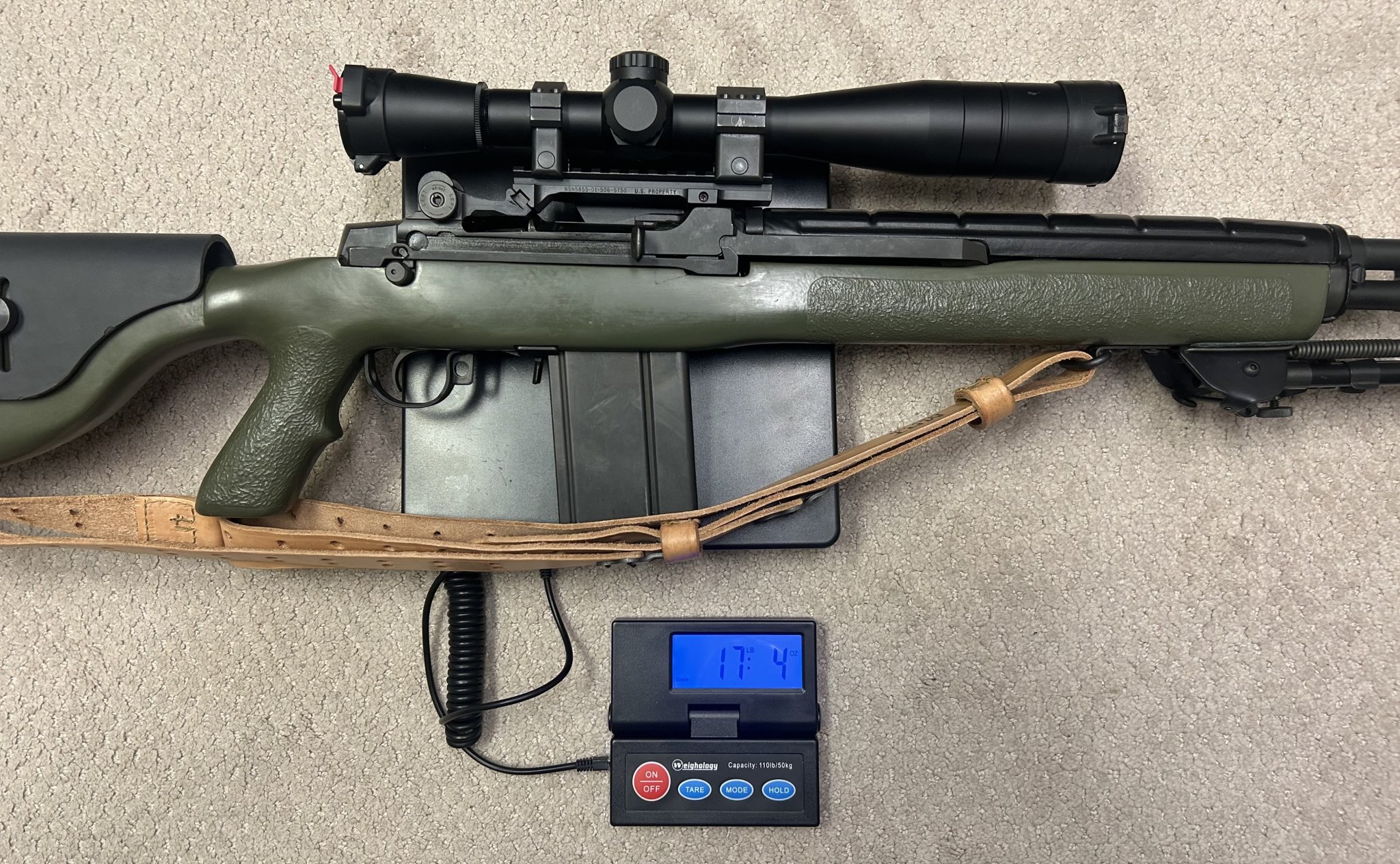

My replica early Mk 14 Mod 0 is heavy and is best shot from the bench or prone. Folks might be surprised what a DMR or sniper type M14 weighs when built around a heavy McMillan stock. USMC M14 DMR w/ bipod, sling and empty magazine being weighed:
As noted, the feedback to Crane from soldiers regarding the early Mk 14 was it was too heavy, so chassis was shortened 1.75” and barrel was shortened by 4” (going from 22” to 18”, and it was the standard skinny profile, not the thicker, medium weight barrel that I used). I think the production Mk 14 Mod 0 weighed about 14 lbs unloaded. The SAGE chassis adds about 2.5 to 3 lbs over the standard M14 stock, depending on configuration.

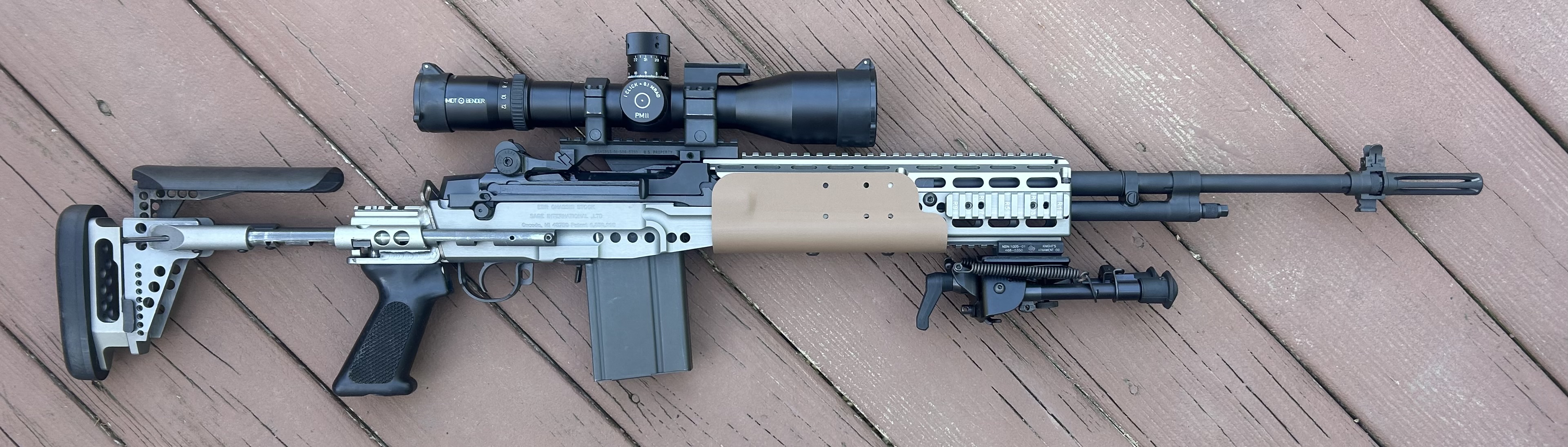

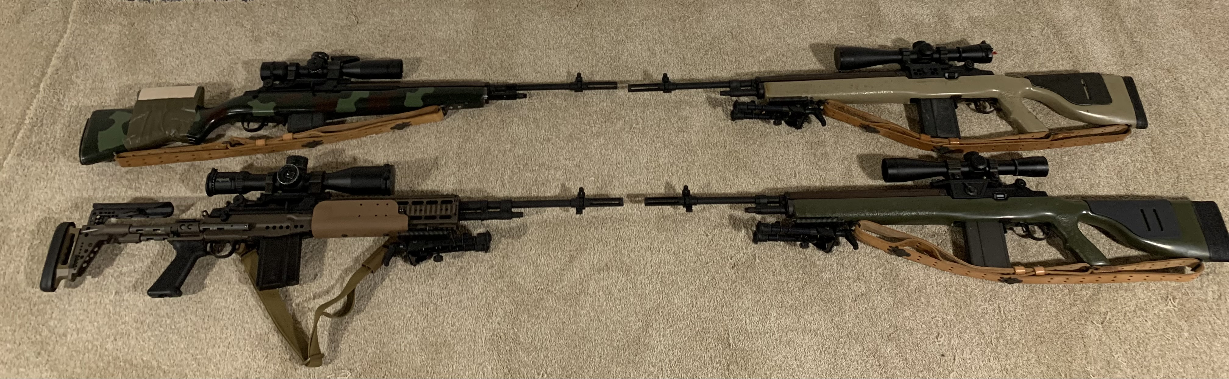

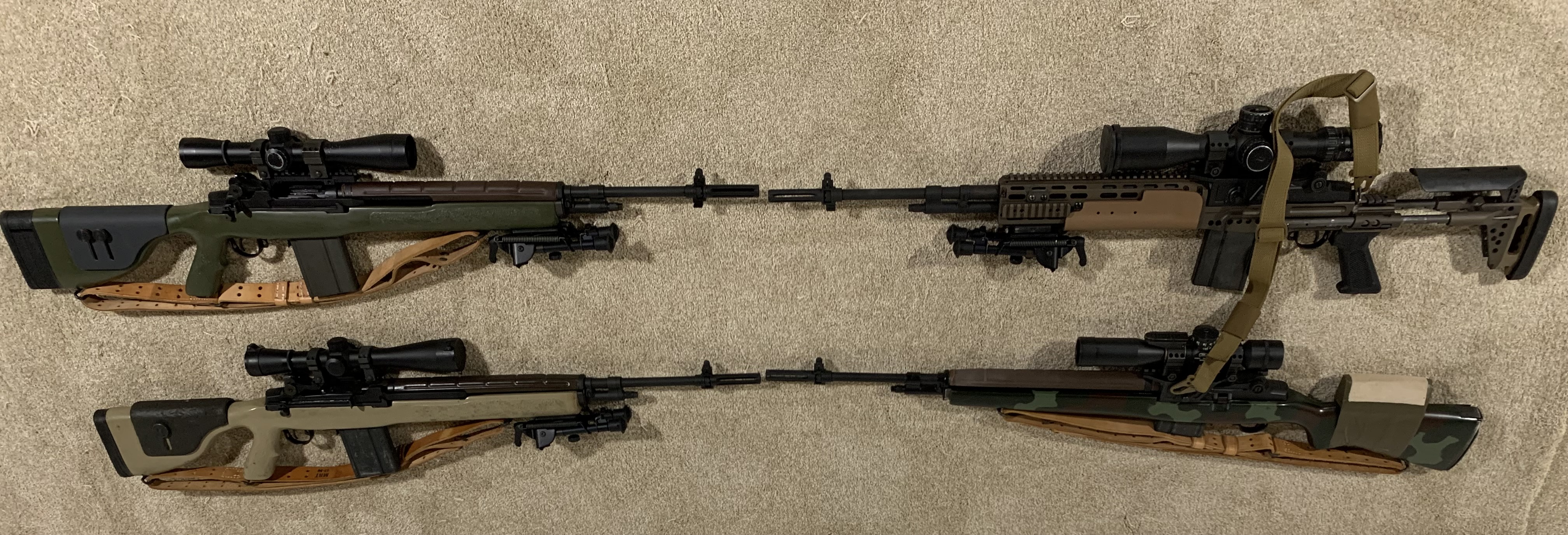

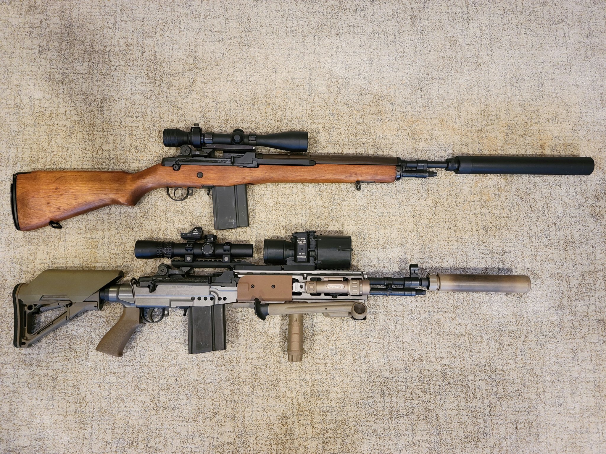

Well, at least one of them is vintage, lol. Both of these clone M14's are built with 100% military used/issued take-off parts (except for the civilian semi-auto receivers). Even the Sionics style MAC M14 silencer on the XM21 was made in the early 1970's, and it's probably the only one (or one of the only) vintage Sionics/MAC M14 silencers in a private collection. These builds took a very long time to assemble, but it was worth the effort!

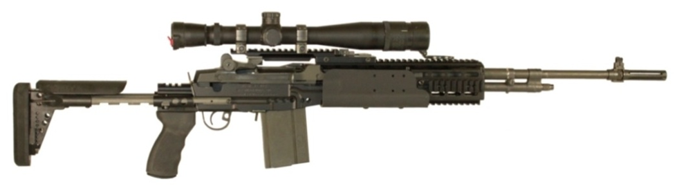

XM21 vs Mk14 Mod 1:

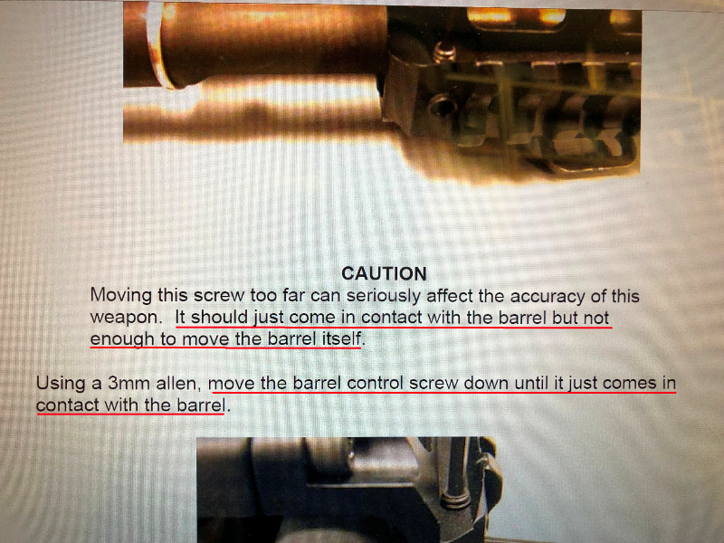

XM21 vs Mk14 Mod 1:
They ‘aight 😉

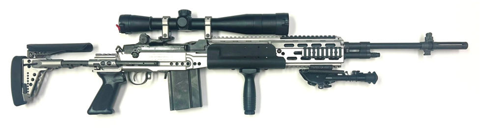

Finished a USMC M39 EMR replica, aside from installing the fake M14 selector lock. These were issued circa 2008-2012, and designed to replace the fiberglass stocked USMC M14 DMR rifles. The M39s were subsequently replaced with the KAC M110s. It fits my collection interests.

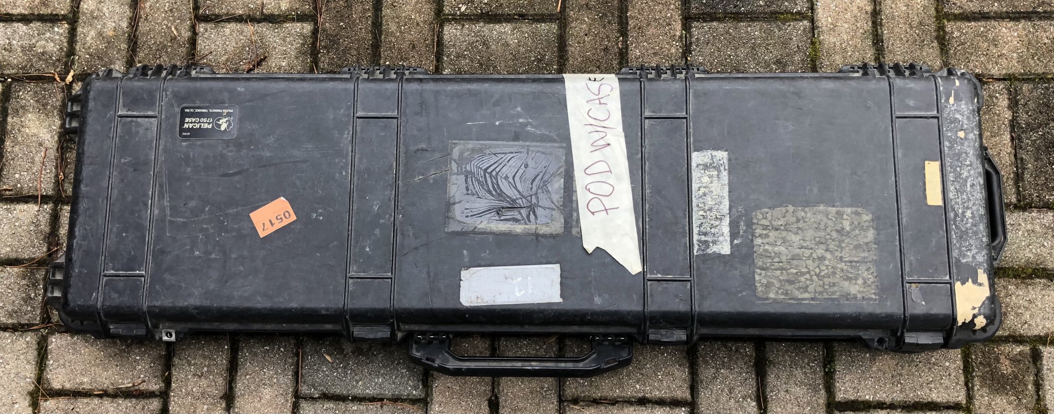

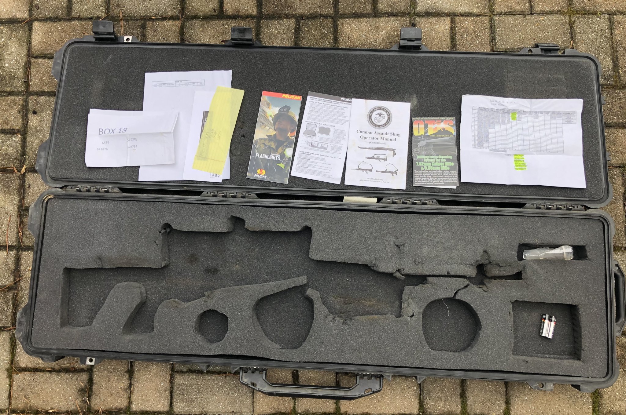

Here's how it started...a salty original M39 case.
...still need a few items to fill this old case, mainly an M39 Operator's manual, and the proper Tenebraex ARD with black plastic case that fits inside the small circle cut-out on the left. I'm guessing the 2 AA batteries that were in the case may have been from an AN/PEQ-2A?
(If anybody has an M39 manual that they can live without, please let me know. I am a motivated buyer...I traded mine years ago before I started to build a replica M39, so I'm hunting for one now. One can be seen in the below pic in the picture of case contents)

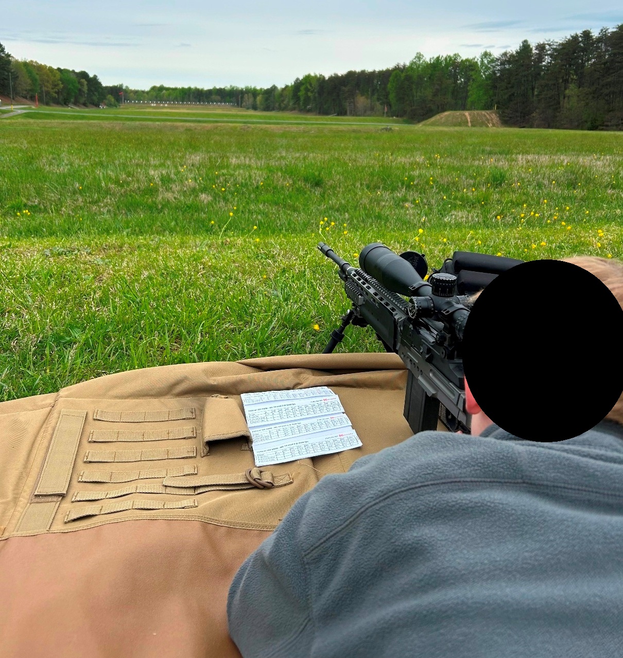

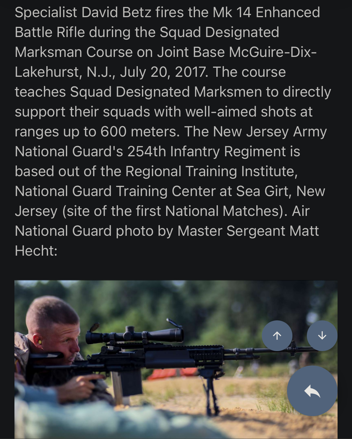

What barrel did you used on this lady
The one big deviation from a replica of an original M39 is the barrel I used. It’s the proper Kreiger medium weight SS DMR profile, but it’s in caliber 6.5 Creedmoor. Krieger only made 5 of these barrels for a custom order by Jon Wolff back in late 2107, and I later obtained it in a trade deal. It’s also nitrated and I was told these barrels were very pricey. One can’t tell the caliber once it built up, but here’s the markings:
