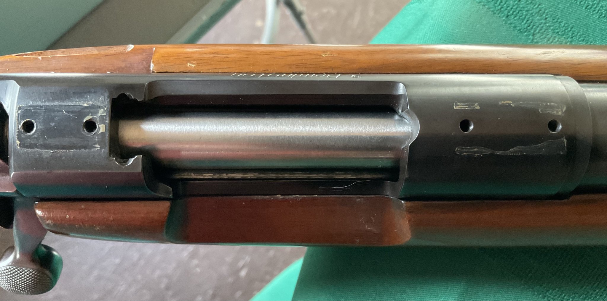

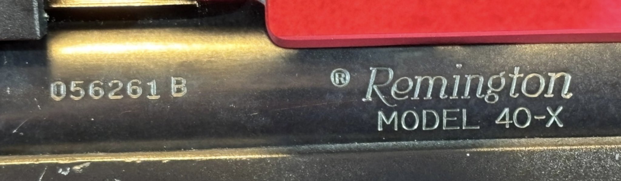

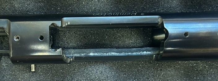

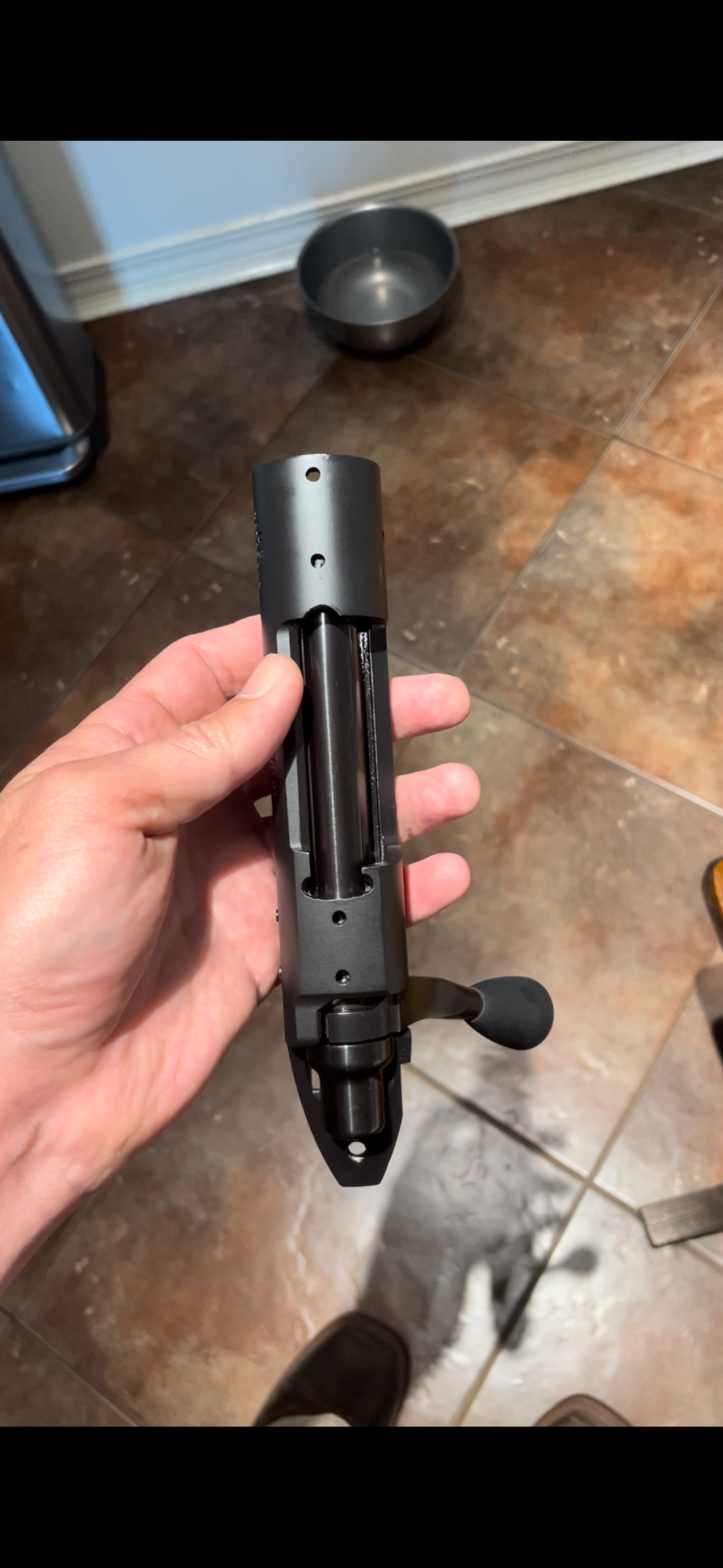

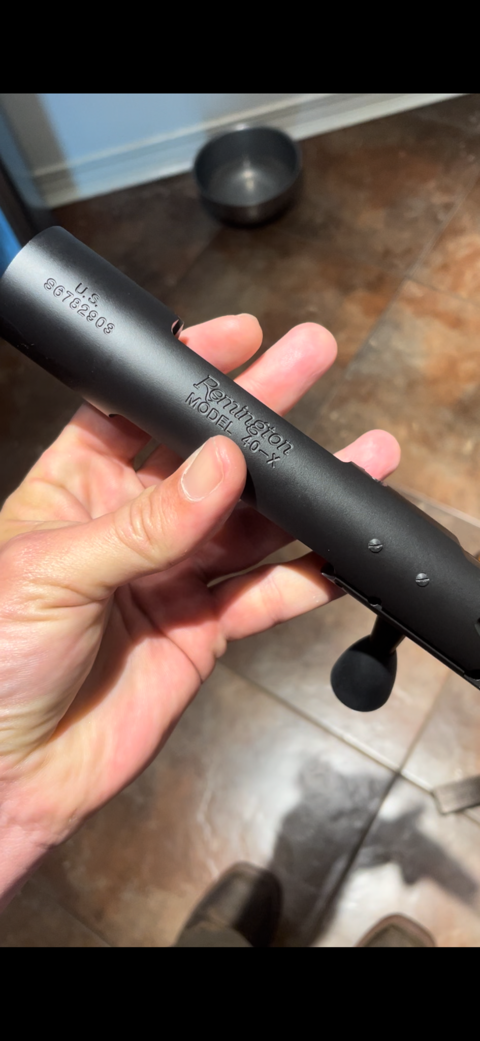

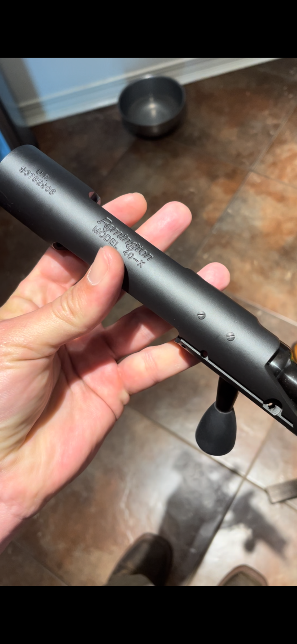

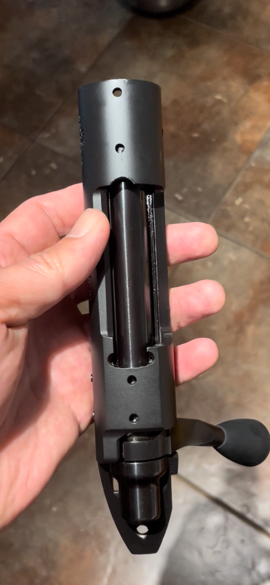

Purchased a 40x action that’s US marked above the serial number and clip slotted as well as drilled and tapped for iron sights on the right rear of the action body that was from the best of my knowledge all done at the Remington custom shop and was NOS from their closure that was picked up by PTG, the entire bolt assembly is all PTG which I did myself and is a one piece bolt with small diameter firing pin, m16 style extractor and swept handle. My question is, what would this action have originally been used for?

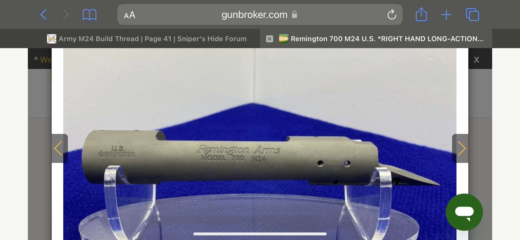

Yeah that’s a PTG abomination. They were trying to pass off Remington Arms “M24” marked actions that they marked.
Looks like they added the U.S. Still looks like a nice action but there’s no U.S. affiliation with that one.
Here’s an example of the BS they tried to pass off as real.
As you can see they added the “Arms” “M24” and the “U.S.”
I will only note that PTG’s ad hoc laser engraving of “US” and “M24” is well-done, but it’s not perfect. A close examination shows the font PTG uses is a little different/deeper relative to the original Remington stamping. Nice 40-X action for sure, but it’s not a left-over military item.

I'm pretty sure that PT&G put the "Model 40X" on this receiver... I've never seen, nor can I find a picture of a 40X rifle that matches your markings.
Looks like a Remington 700 receiver that PT&G made into a "40X" when they added the "US" marking.

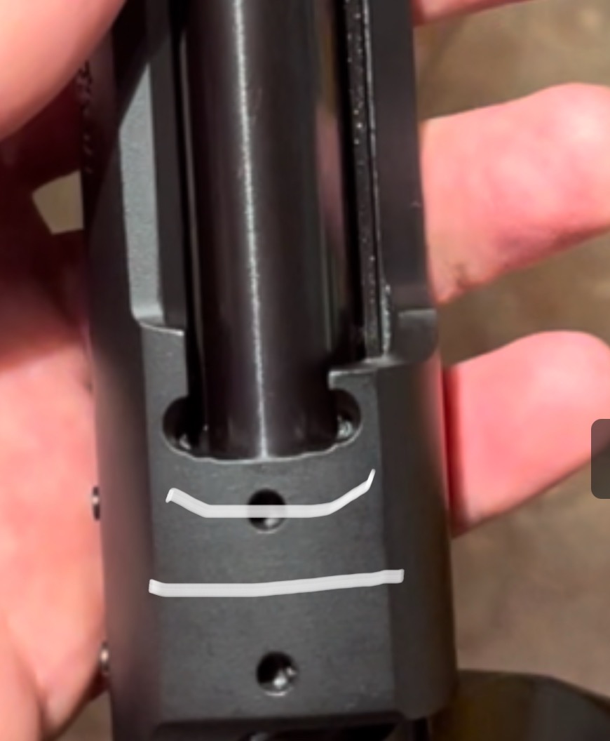

Unfortunately, as everyone else has said, you got swindled by PTG. They modified that receiver, it wasn't done that way by Remington. A 40X with a Model 700 serial number? That's a new one. The US marking is blatantly fake, PTG is throwing that marking on all their receivers and claiming that they're some type of "government" receiver. And that clip slot is so ludicrously terrible, I've truly never seen anything like it my entire life! If that clip slot actually came out of the Remington Custom Shop, then I'd have to question the quality of all the Remington Custom Shop rifles in my collection.
Sorry man, but PTG took you for a ride on this one. We've been trying to warn people about the fake PTG stuff, but no one ever sees those threads. The receiver is still fine to use, just don't expect it to have originally been used for anything besides fooling people into purchasing them. This isn't your fault at all, the fault lies entirely with PTG's fraudulent practices.

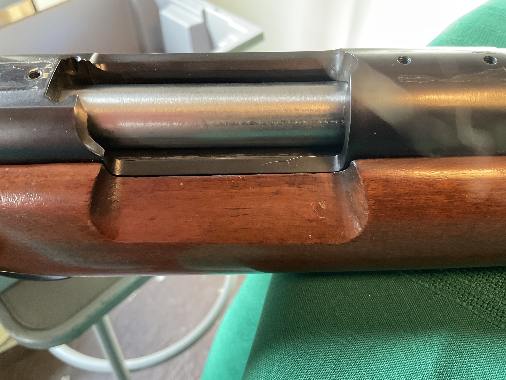

Not to pile on, but the two Remington clip-slotted receivers I have are flat at the rear of the slot. Looking more closely at the OP receiver - it is a slightly ‘concave’ or curved shape at the back.

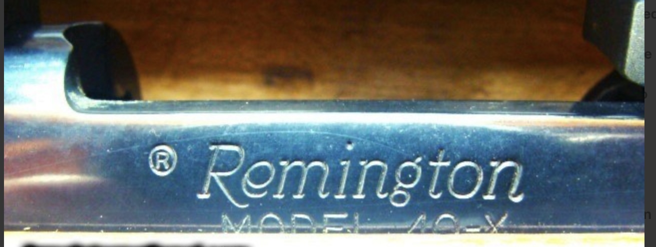

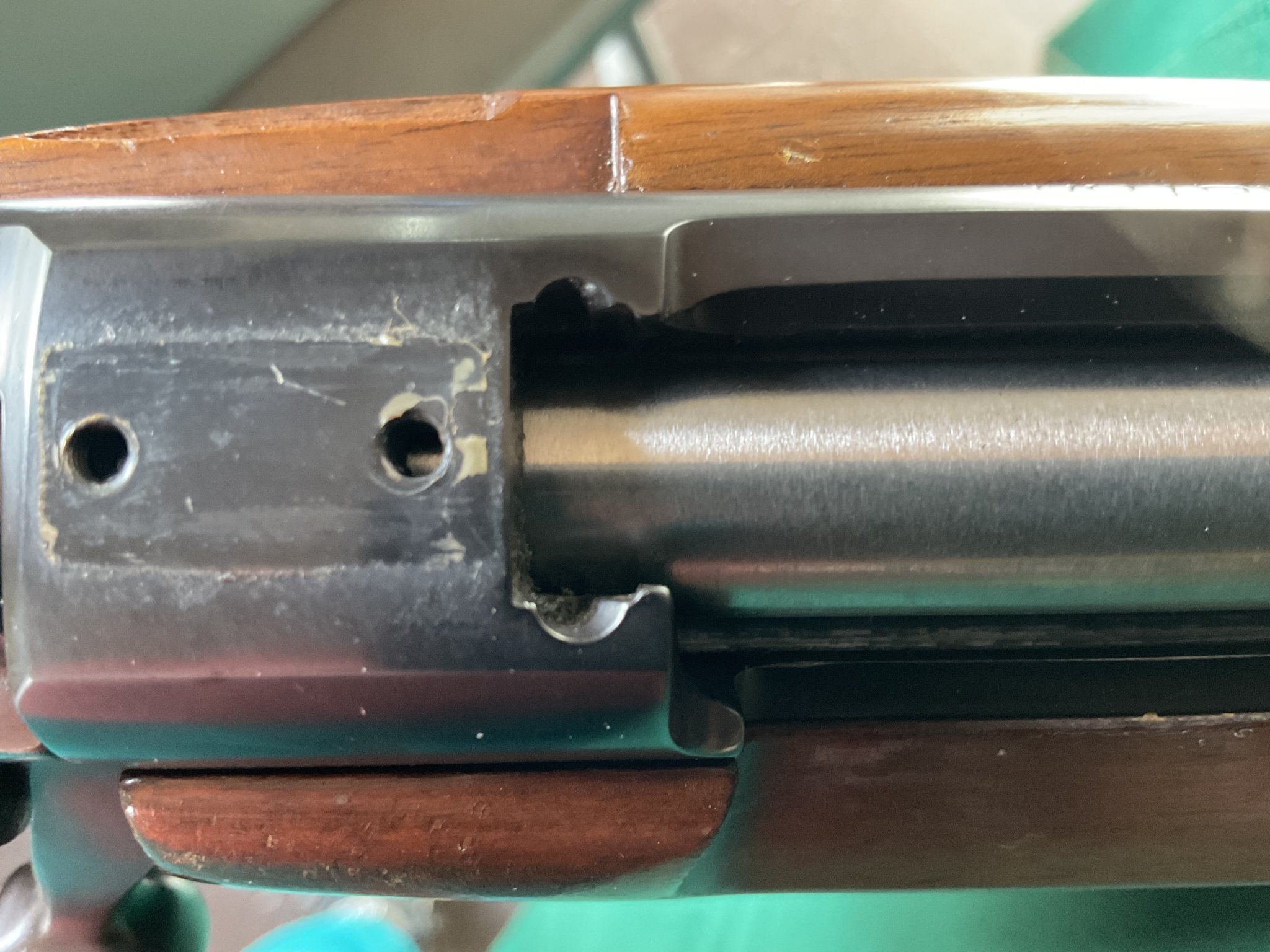

That’s not what I would expect. Here’s my vintage 40-X clip slot for comparison:
From the looks of it the only thing that was added was the U.S. mark above the serial number. The depth and shape of the word remington and model 40x along with the serial number look to have been done at the same time. I think the clip slotting was also done by Remington as well which will be getting modified anyway at least on the back end to fit the correct badger ordnance rail for an M40A3/5. Rear pocket has to be opened for the lug and top rear has to be decked about .135” down from the front.

Not to pile on, but the two Remington clip-slotted receivers I have are flat at the rear of the slot. The OP receiver is a slightly ‘concave’ or curved shape at the back.
Yeah that rear pocket looks to have been broached, that’s the only way to get the corners that square.
That's the most horrible clip slot I've ever seen, there's no way that could have left the Remington Custom Shop like that. Also, notice how the left rail of your receiver has not been cut back to match the right side of the receiver. Looks at the other posts in this thread with original Remington 40X clip slots, and you can see the symmetry on both sides of a legit Remington clip slot. I would be absolutely shocked if a clip slot that bad actually came from Remington, it just doesn't match up with any of the actual known work from that company. The receiver was refinished after PTG engraved the US above the serial number, so it's easy for them to do this half-assed "clip slot" and then have the receiver refinished to make it look like it might be original from Remington.

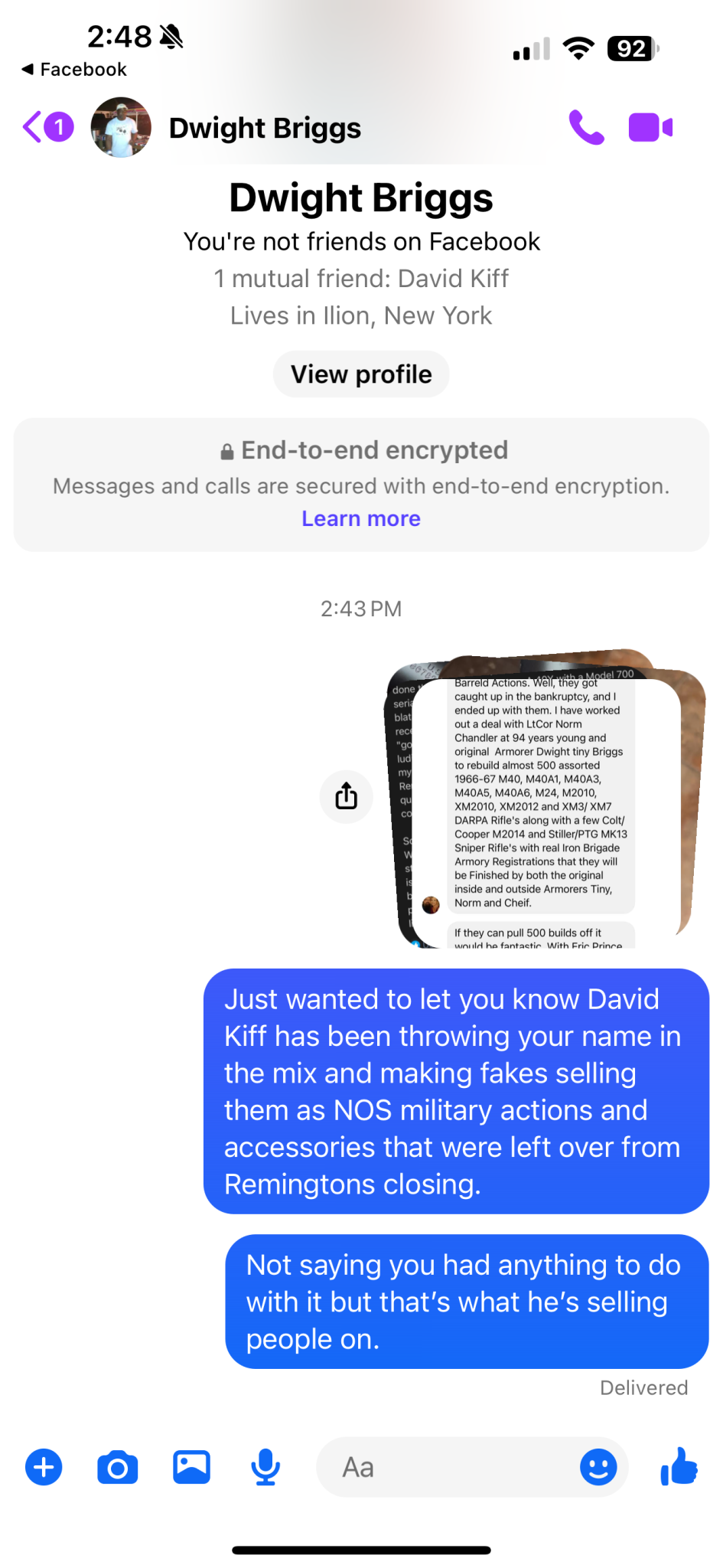

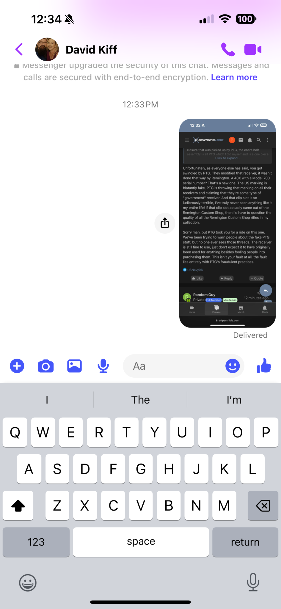

Excellent that you sent him the screenshot, but if you have time, please send him a direct link to this thread and these other PTG threads:

And this doesn't even include the people who have contacted privately asking if their PTG receivers are real. One of my friends purchased 3 Remington 40X receivers from PTG, where Dave Kiff told him that they were ORIGINAL USMC PROTOTYPE M40 RECEIVERS FROM THE 1960'S! He's so full of shit, that it's coming out his ears! The serial number and other receiver characteristics prove that all 3 of these 40X receivers weren't even made in the 1960's, and they certainly weren't fucking prototype USMC M40 receivers!
It's unreal how PTG is ripping people off with a ton of fake stuff. All they had to do is just sell the unmodified Remington products. People are looking for original Remington stuff right now, there's absolutely no need to modify the original items and create fake items.
Read the entire thread I linked to above about the fake 40X base that PTG sold to @fe1 last year (the 1st of the 3 links in this post). I thoroughly documented how the PTG scope base was a blatant fake, even though PTG sold it to fe1 as a real USMC M40 40X scope base! I felt so bad that such a great guy (fe1) was ripped off by PTG, that I decided to send fe1 a REAL M40 issued Redfield 40X scope base from my personal collection. I made things right for the buyer (fe1), who was ripped off by PTG, by giving him a real 40X base that's worth about $2,000! Fe1 didn't ask for a real base, I told him that I would make things right because I was so disgusted with the fake scope base that PTG sold this gentleman (who is a great member of our community).
So, as you can see from these links, the PTG fraud is VERY well documented, and multiple people in our community have been working to warn other collectors about PTG's abhorrent business practices. Quite a few people have taken the time and effort to document everything and prove their fraud. And I've even tried to make things right some the victims of PTG's fake items by giving them real items from my personal collection. I've given up thousands of dollars in parts to ensure that our fellow community members have been taken care of. I did this because I care about everyone here in our community, and I wanted to right these wrongs.
So, please show these posts and threads to Dave Kiff. Hopefully he'll make an account and explain his company's actions. We're not making shit up and trying to ruin PTG's already shitty reputation, PTG has done this all on their own and we've just documented their fraudulent practices. It's not libel or slander against PTG because they actually did the shit that you see in these posts! It's ridiculous and PTG's actions have had a negative impact on our community.

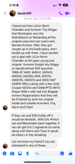

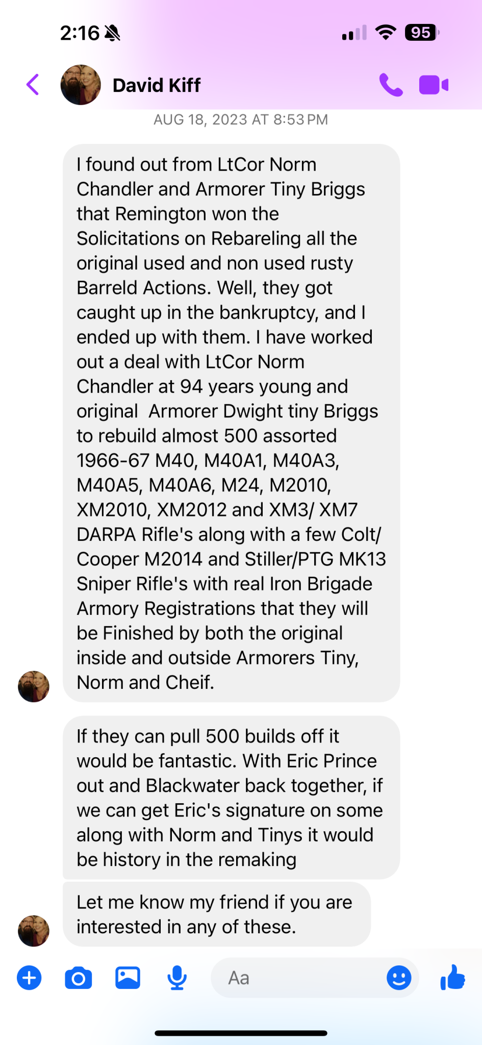

This is what he said to me back in august of 2023 regarding the action, glad I never delete anything.
That's an interesting text from him, so IBA did the work on these receivers. I'm friends with Col. Norm Chandler, and I have purchased tons of original US military items over the years. Besides a few XM3's and an XM1 (that was war used), IBA NEVER had original rifles that are on the list in your text. Had they gotten any original rifles, I would have purchased them.
Also, each sniper rifle contract has very specific language about the manufacturer rebuilding or resupplying rifles. Some contracts (probably the original M40 contract) didn't have the manufacturer (Remington) do anything with the rifles after they were shipped to the Corps, that was a job for the Marine 2112 armors. While some M40's might have gone back to Remington for repairs or replacement, the other 99.99% of them over the past 6 decades were only worked on by Marine 2112 armors. As opposed to the Army M24 contract that stipulates that Remington Defense does all the repairs and replacements for thr M24 sniper rifles.
Additionally, look at the list of sniper rifle's in Kiff's text. There's sniper rifles from various military branches and each one of those sniper rifles had a very specific hierarchy of echelon maintenance (look up maintenance echelon levels for stuff like M40's). And Remington has absolutely nothing to do with rebuilding stuff like Mk13's, that's all done by Crane NSWC. None of this shit sounds legit in any way, it actually makes it even worse for PTG.
So, let me get this straight: Remington somehow ended up with 6 decades worth of different sniper rifles from different US military branches with different levels of echelon maintenance, then took all of those receivers and were somehow awarded a very fake sounding "Solicitations on Rebarreling" contract for sniper rifles that are now completely obsolete in the US military, and then they sent all of those obsolete receivers to IBA for work, then IBA just got to keep the receivers after Remington declared bankruptcy, then PTG worked out a deal with IBA to "rebuild" all of these rifles, and Eric Prince restarted Blackwater and he has to sign something with these "rebuilt" military rifles?
Did I get this right? Did I miss anything? It now sounds like IBA is doing these modifications to the receivers and PTG knows about everything that they're doing. So both companies are involved in making fake military receivers?

Actually, Remington did make long action 40X receivers. I've heard that the Remington Custom Shop had some steel long action 40X receivers built into rifles for customers over the years. But, I can't prove that the steel receivers exist. However, it's well documented that Remington did in fact make 9 titanium ling action 40X receivers! I actually own one, and it's currently at LRI being built into a lightweight hunting rifle. Here's some photos of my original Remington titanium 40X receivers (both long and short action), and a side-by-side comparison with a genuine military used/surplus Remington M24 sniper rifle receiver (not a fake PTG M24 receiver):
Located one of the individuals he referenced and contacted him as well letting him know what’s going on.
It will be interesting to hear what Tiny says, hopefully he has some actual information about all of this. I don't personally know him, but I have friends who do know Tiny, and he has a great reputation. If I'm somehow wrong about anything, I'll eat major crow and make a public apology. However, we know for a fact that these receivers are fake and have been sold as being "real." That's absolutely irrefutable information. PTG also sold at least 1 completely fake 40X scope base to a member here. Again, irrefutable proof of PTG wrongdoing.
I guess we're going to find out if IBA faked these receivers for PTG or if PTG did it themselves and send receivers to IBA or whatever the hell else could possibly happen. IBA claims that PTG makes their reproduction XM3 parts, so IBA didn't make the fake Redfield 40X scope base that PTG sold. That's 100% on PTG.
We're essentially just trying to find out which company did what, and who actually faked the parts that PTG sold as originals. Even if IBA was the company that faked the receivers, we still need to see if this was done at the request of PTG and what that company's specific involvement is with the creation of fake receivers. No matter what, PTG is selling fake receivers and fake 40X scope bases, and that's 100% on them.

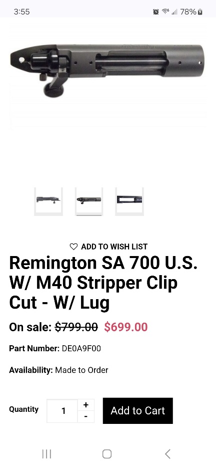

Just poking around PTG's website to see what interesting items they have. Holy fuck, these guys are insane!

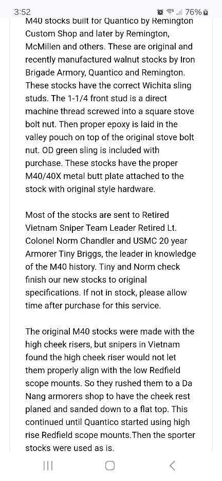

I dare you guys to read this product description for their "M40" rifle stocks without laughing out loud! I don't even know where the fuck to begin with this one. Apparently "Quantico" (just Quantico, no other info) had a hand in making these shitty reproduction M40 stocks. I learn something new everyday! Lol
The original USMC M40 stocks never has epoxy "laid in the valley pouch on top of the original stove bolt nut." This is completely wrong and it's utter bullshit. I've owned about a dozen or more original USMC M40 wood stocks, and none of them have this unique feature that the PTG wood stocks have.
Colonel Norm Chandler IS NOT a "Vietnam Sniper Team Leader!" This is some epic bullshit, Norm never held this billet and I'm not even sure he ever deployed to Vietnam. Norm was the OIC for a training range in Quantico, and the old RTE shop was under his command. That's the closest he got to being a sniper in the Marine Corps. Why the fuck is this nonsense in this product description?
And lastly, my personal favorite part of this ridiculous shit, the high and low cheek risers on original USMC M40 stocks! I'm not even going to bother with being snarky, I'm just going to let everyone know that this is 100% fake bullshit! There has never been an instance where a "Da Nang armorer" has had to sand down the fucking cheekpiece on the original USMC M40 stocks. Additionally, there isn't a single original USMC M40 stock in existence in private or public collections that show this modification.
PTG also, incorrectly, states that this practice of sanding down the the M40 stock's cheek riser continued until "Quantico started using high rise Redfield scope mounts." This is, unsurprisingly, complete fucking nonsense. First off, the Marines used Redfield scope bases and scope rimgs, not scope mounts. Second, there are no "high rise Redfield scope mounts" for the M40. The Marines used low Redfield scope rings on the Redfield 40X scope bases on the original M40's. Third, the Marines started using medium height scope rings on the M40A1, since the A1 had a thicker barrel than the M40 and the additional scope ring height was needed to clear the scope's objective lens housing from the top of the A1 barrel. Fourth, what the actual fuck with this insane nonsense!
https://www.pacifictoolandgauge.com/M40-Walnut-Stock-_p_119408.html

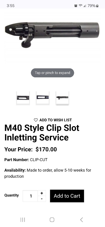

Well, isn't this interesting, the M40 clip slot service that PTG is advertising has the same shitty clip slot as the one that's cut into OP's receiver. Maybe that shitty clip slot wasn't done by the Remington Custom Shop. Maybe, just maybe, PTG cut that clip slot, since it's pretty much identical to the clip slot cutting service photos they have on their website:
https://www.pacifictoolandgauge.com/M40-Style-Clip-Slot-Inletting-Service_p_116771.html

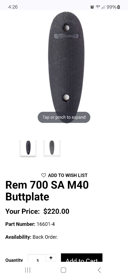

PTG is actually selling Remington 16601 aluminum buttplates for $220 each! $220 for an item that routinely sells for less than $20 on ebay and at gunshows! Hell, I've given away DOZENS of these original Remington 16601 buttplates to members here on this forum. Damn, apparently I could have made thousands and thousands of dollars on them, had I actually sold them at PTG's price, instead of just giving them away to our community members for free:
https://www.pacifictoolandgauge.com/Rem-700-SA-M40-Buttplate_p_118761.html

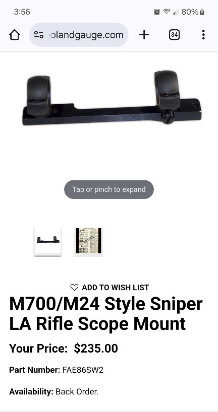

Did you guys know that the Remington M24 sniper rifle actually used a long action Redfield scope base and rings? I'm learning so much today!
https://www.pacifictoolandgauge.com/M700M24-Style-Sniper-LA-Rifle-Scope-Mount_p_116817.html

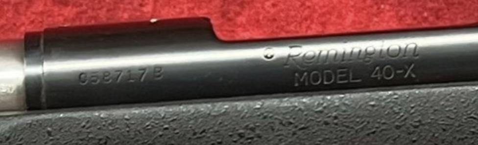

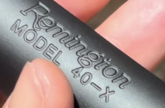

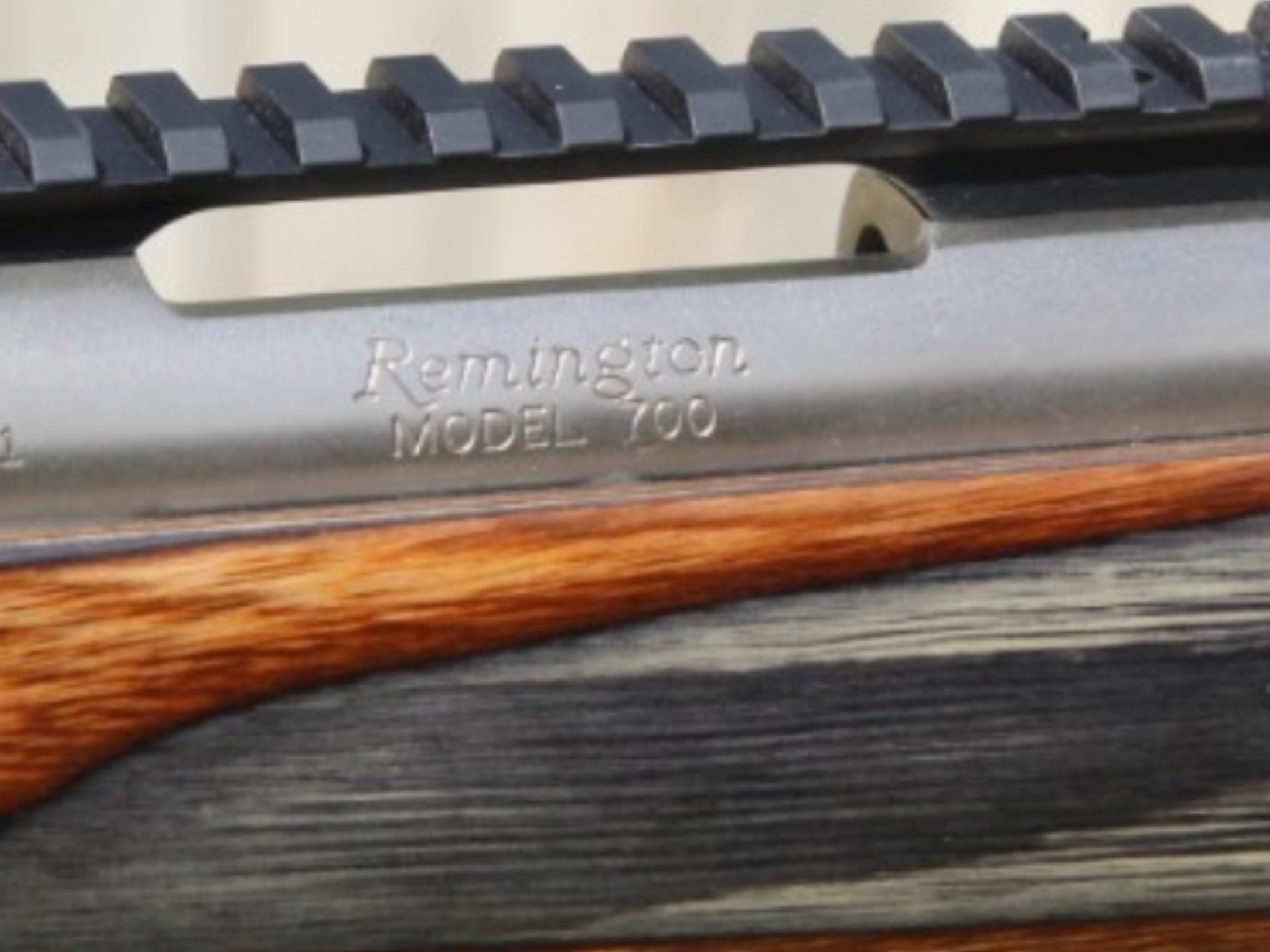

Odd, that serial number would put it at 1968 I believe for a Remington 700 if that’s what happened somehow.
The serial number on your receiver? It's definitely not from 1968. The S prefix is from sometime in the 2000's. You're only looking at the 7 digits after the S prefix, which would put it right after the Model 700 serial number changes that took place in 1968. However, you need to include that S prefix in the overall serial number, which means that it's a stainless receiver produced pretty recently (sorry, I don't have an exact date, but definitely in the past decade or 2).
That is weird it has the Model 40x as being it’s an S prefix. A few thousand after the XM3 receivers were.
Yep, extremely weird that a Remington 40X has a Model 700 serial number. I've never seen that before. No idea how something like that happened
Think it maybe got tig welded and they recut the Model 40x. The letters look off. I’m sure PTG has the capability of putting whatever they want on it.
Is the receiver painted. I don’t want to see the OP mess it up since he’s using it. But it could maybe show if it happened to have the old letters filled in.
Reactions: USMCSGT0331
That could very well be what happened, at this point I would almost expect PTG to do something like that
I'm convinced PT&G put the 40X on that receiver. It doesn't look like any other 40X marking, and as you noted, it's a Remington 700 serial number. I doubt they are messing with serial numbers.
DW
I agree. Stainless 700 receiver, filled and remarked “MODEL 40-X” Or possibly never marked 700 if it was from a bankruptcy. If it was manufactured and put on the books as a Model 700, would changing that be a problem? Similar to altering a SN?
Check the size and placement of the ‘MODEL 40-X” on these rifles. Yours almost looks like the MODEL 40-X is touching the Remington. Also the alignment is not the same. These are from rifles for sale online.
