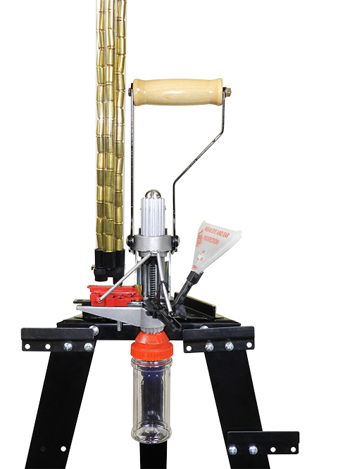

The ACP has been replaced by the APP. I've heard good things about both but never used them. I do really like the Lee Classic Turret and Six Pack presses though.

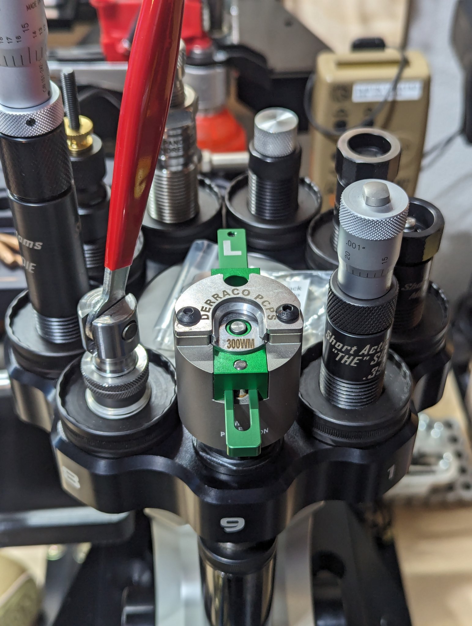

Isn't the Derraco PCPS, albeit more precisely, still based on (hopefully) consistent rim thickness and not the base of the cartridge case, i.e., like headspace?
Correct. It closely resembles the older CPS Lite (discontinued). It uses the same concept as the CPS but much easier to use (I've had the CPS for 4+ years now).

All things aside, the CPS and this PCPS are both a joy to use. At the end of the day, I prime 95% of my rounds using an autodrive. 😂
