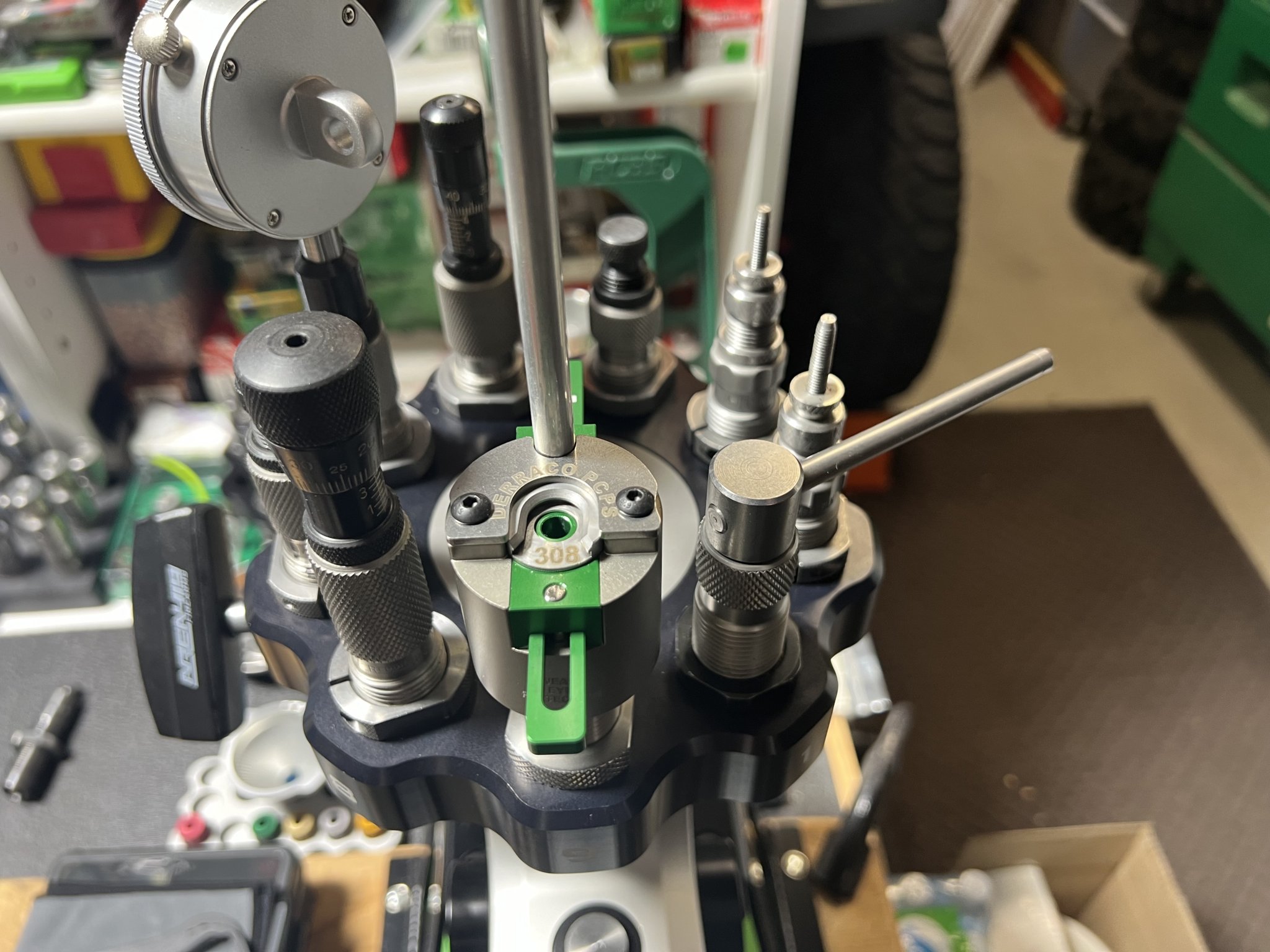

I dunno if this helps, but as you can see the bar is fast and machined nicely on the push/finger end.
Yeah I can tell that it's very easy to push on your video. I called and I ordered so that's done. He said he thinks sometime around end of the month or first of March he will have em ready to ship out. Can't wait to try it out.

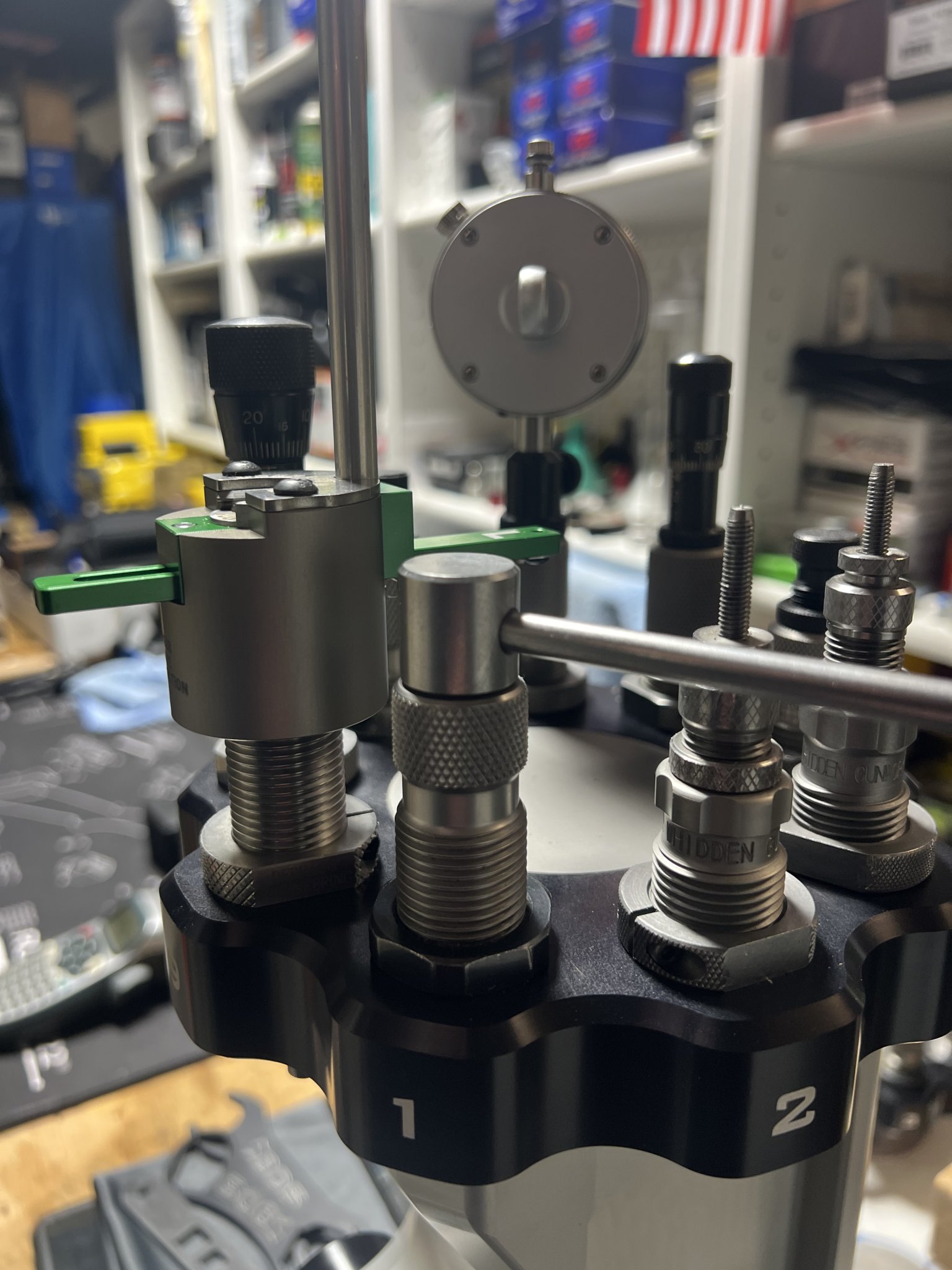

So with the adjustable arm on the 419 a bolt on tab could be put on the arm to press the primer loader on every upstroke. I’m sure that would work on most presses. Every time you raise the handle and lower the ram a new primer would be charged. Shortstroking the ram this dang thing could be fast. This seems like an easy home project or someone like mkm could make a universal one if this product takes off. You heard it here first.

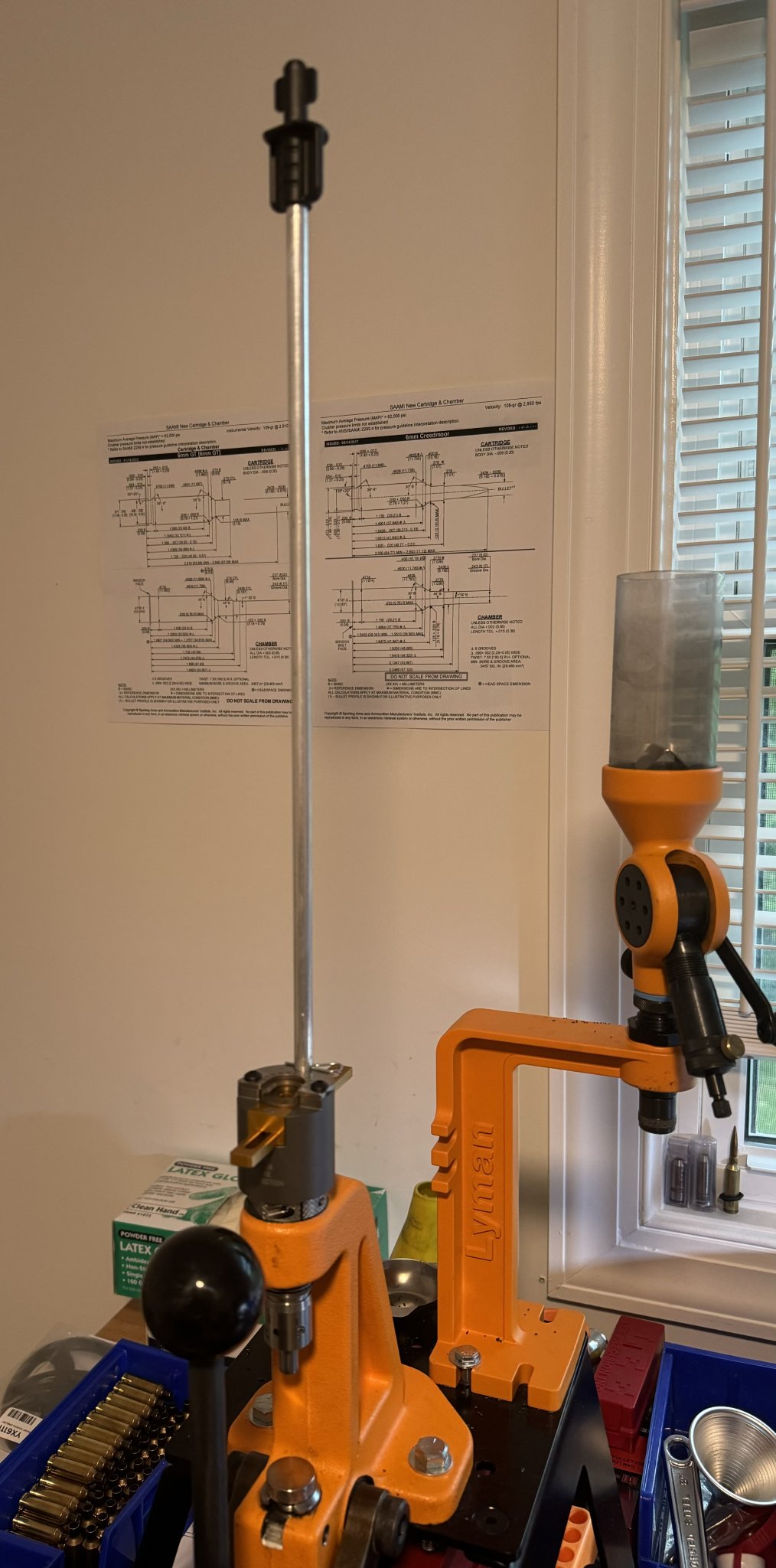

Saw this post about the derraco poor man primer tool. Sorry for late reply but I had recently bought one and I’m not too happy. But maybe I’m doing something wrong. Pls help me…
So I did everything the instruction said. And I notice unlike the hand ones you can’t feel the primer going in. Also I tried even at max setting the primer did not move in the case the large primer was still flush to the head instead of being slightly lower. I feel like have to bang on the press lever to push up the primer but I think this is not right either I did not do it. It’s difficult to tell on a press how much primer moved without a measuring tool. I wish this had a gauge.
I’m going to buy a K&M with gauge although it’s hand priming at least it measures the pocket the primer and how much pressure needed to seat.
Only negative is that it uses lee holders also.

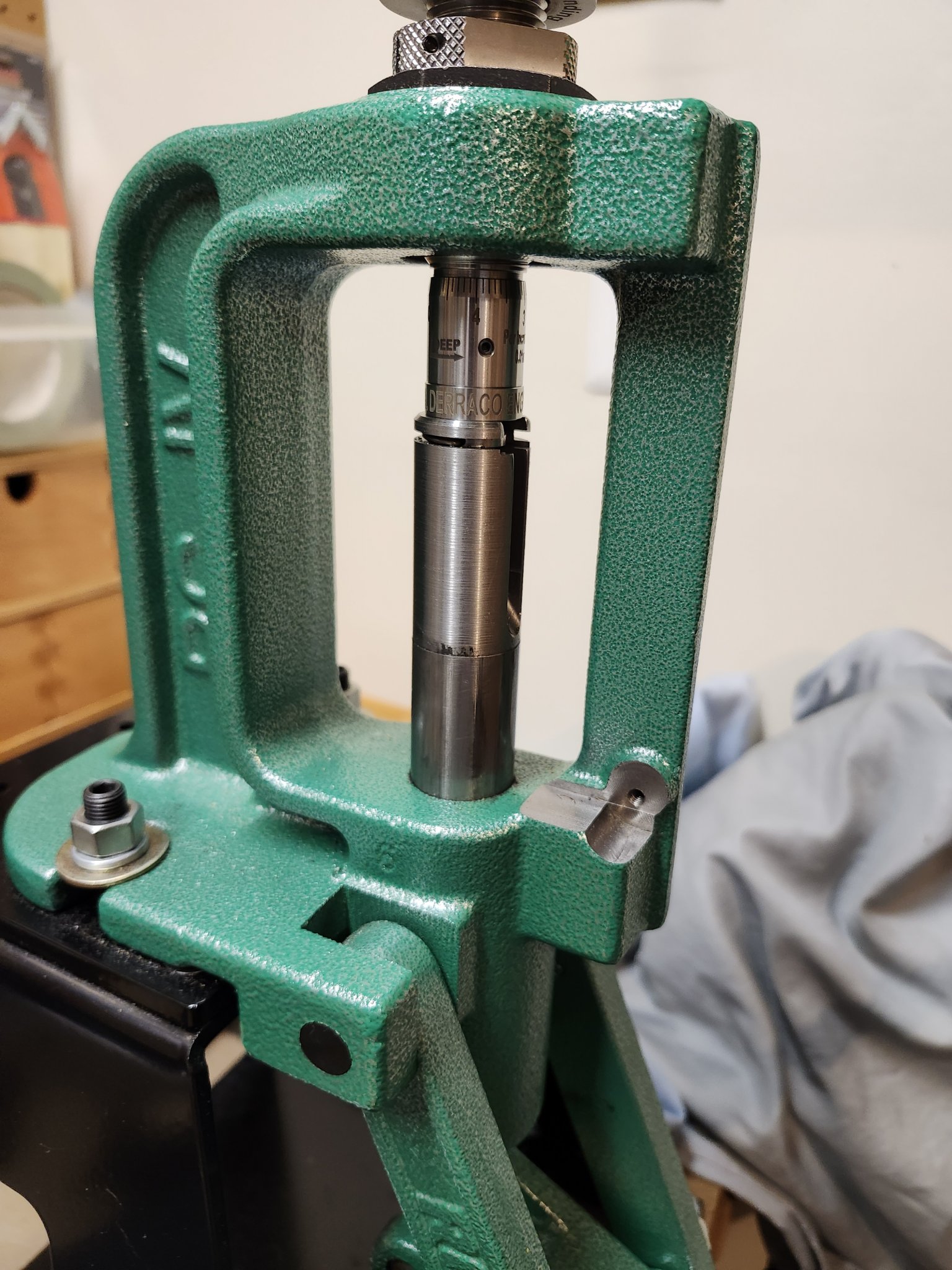

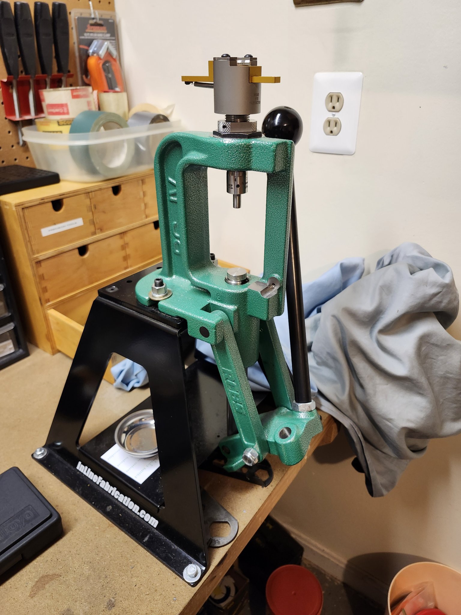

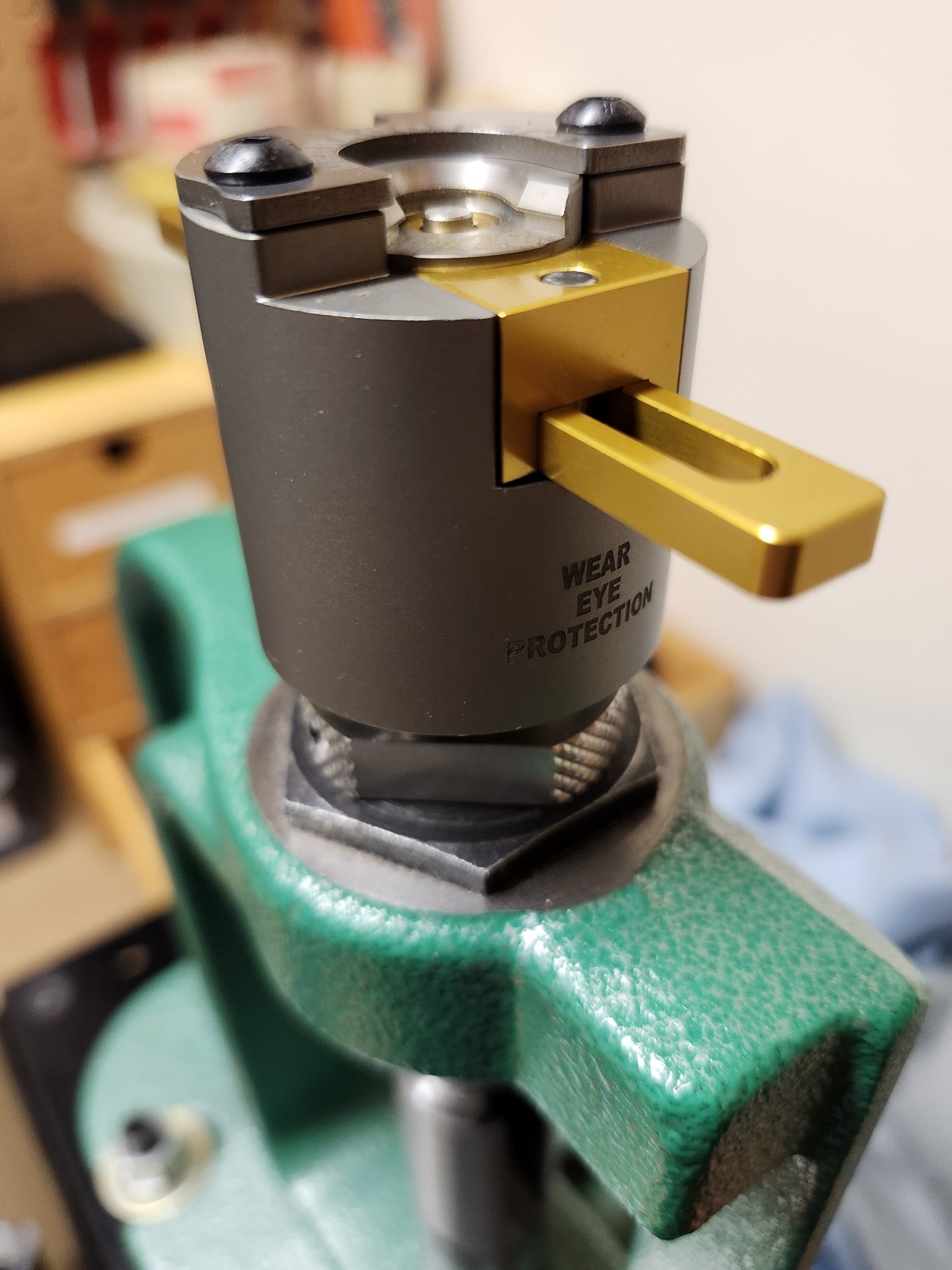

What press are you using? I have a hard stop if I go too deep. Therefore, I can set primer depth right below flush, or whatever I want.
It sounds like maybe you didn't thread the PCPS deep enough to account for adjustments?
Reactions: bmash
I’m using rock chuck supreme Rcbs. I followed the instructions all the way. The die only has about inch between the bottom of die and top of press.
I dialed micrometer to max deep with case on.
Then dialed clockwise less deep till case barely comes out. This is where I started. At first I pushed primer up at this point but the case would not come out of holder as the primer still sticking out so I had to adjust deeper counter clcok. About 60 clicks. The case finally came out. I noticed now that there is gab between anvil and micrometer at this point. The primer is just flush to the head so I go in more deeper all the way to maximum and still primer would not go in further. Perhaps it’s my case. I have never had this issue with hand primers. Plus as I mentioned I like the feel of the hand priming tool that is why I’m getting the k&m there is a gauge to measure how much effort your squeezing also. I wish this had a gauge also.
Here is my setup with the RCBS Rock Chucker IV and the .223 Rem shell holder. I was amazed at the consistency. I needed this because of my arthritic hands more than precision. I measured using the Mitutoyo digital caliper (not the most accurate method). But my shooting style does not justify buying a Mitutoyo depth gauge. Or the Accuracy One Precision Primer Gauge.
The primers slip in smoothly with little effort and I believe I can feel when the anvil touches bottom. Takes a little more effort to push the anvil in.
Doesn't seem right at all. I'd suggest calling Carl. He literally answers the phone 7 days a week at all hours of the day. But I would suggest calling on Mountain Standard Time. 😉😉
View attachment 8428274View attachment 8428272View attachment 8428273
Thank you Conaso this is actually how I set mine up and also as you see in the photo there is a gap between anvil and micrometer. Also the same amount of space between the die and top of press. Perhaps it works so good that as you mentioned you “believe” that you can feel the bottom. Also a little more effort to punch the anvil in as you mention. I guess what I’m doing is correct. I will try new cases and see if that makes a difference. But I also just ordered the hand k&m gauged priming tool. Both together is still cheaper than the primal rights. Lol

Tagging thread. Just getting started with reloading, buying all my case prep equipment first. Bought an Ugly primer seater a couple weeks ago because I'm not sure what loading press(es) I'm going to end up with yet and hand priming tools are a no-go. After spending years of turning wrenches, my hands cramp too easily to even consider using those. Looks like I made a good choice by grabbing a set of their shell holders too.

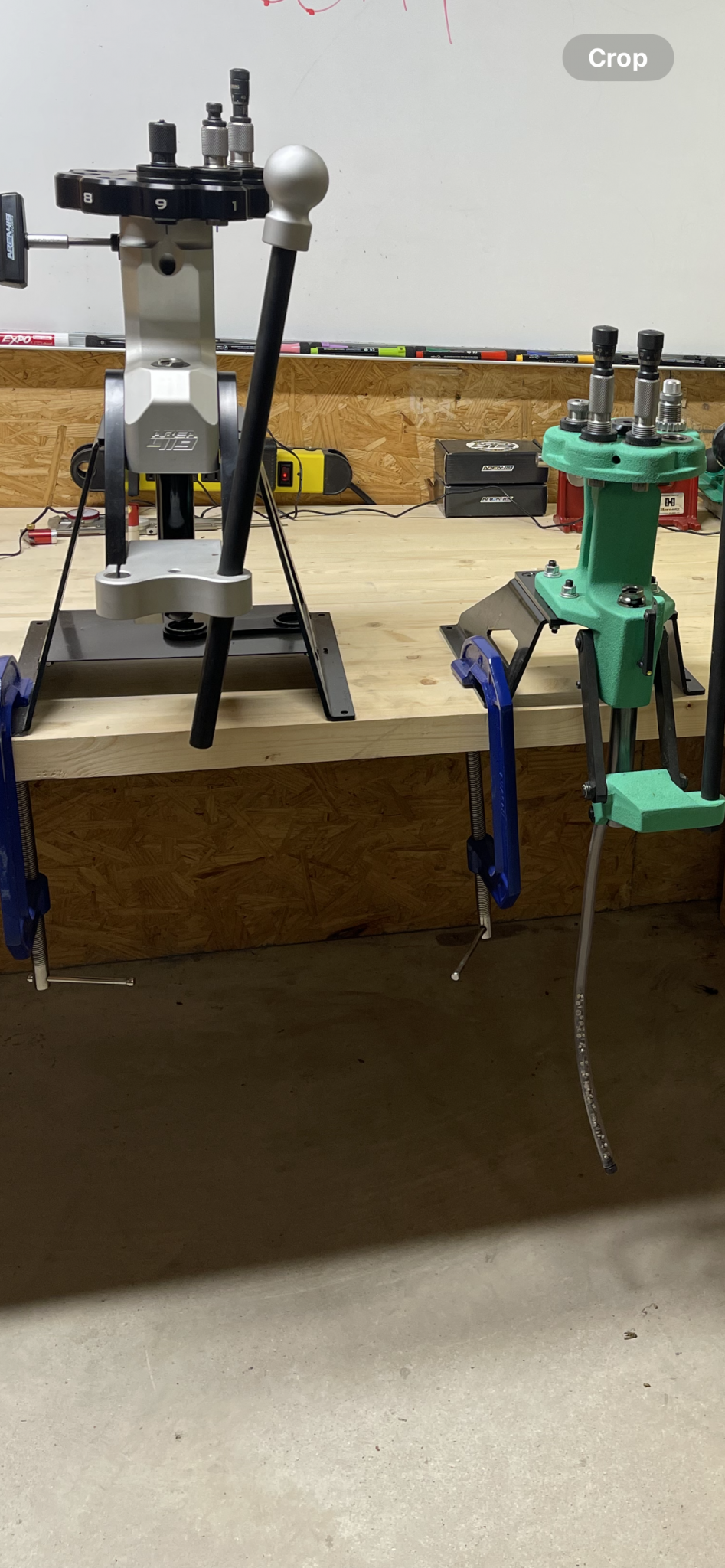

And speaking of presses...... (sorry for the thread derail)
Thanks for that side by side pic of the T7 and Zero. I've been looking hard at turret presses lately. Where does the T7 fall short compared to the Zero and is there anything that the T7 does better?
I’m able to maintain +/- 1 thousandth accuracy on alpha dasher brass with nothing done to the primer pockets. That is using an accuracy one precision primer gauge. I’m happy with that number and it super easy and quick. Will probably buy another one for large rifle primer that way I don’t have to change it around all the time. That is with Hornady lock n load bushing on it as well for quick changes.
The T7 does not have a turret lock s rew , like the zero does, which means there is some play in it, and the zero is just nicer overall. That said, after I honed the bushing in my Lyman 8 (just like a T7) , it has virtually zero play in it and works great producing consistent ammo. Also the primer catch on the zero is a lot better and it holds more dies per turret.
Reactions: papershredder
Lol, every review I've read and watched videos on about the Lyman turret all say they've had to deburr/polish something to get them operating smoothly. But, I've been considering it as well just because of the price factor. The RCBS turret press is the only turret press I haven't done any real research on yet. I like the beefier construction of the T7 over the Lyman, but I'm sure the Lyman is built well enough to do the task. I need to take a closer look at the priming catch of the Zero because that could be a selling point for me. I'm not too impressed from what I've seen with the Redding's or Lyman's primer catches. The less I have to pick up spent primers off the floor and dumping spent primer trays/tubes the happier I'll be.
Neither the T7 or the Lyman have primer catches worth a crap. That said, the Lyman has always operated smoothly, it's just a very tiny amount of slop that I took out sanding or polishing really the bushing , but I am positive the T7 will require the same to get it as tight as my Lyman is. I'm not positive that it would matter with either one though, it's just my nature to want things as good as they can be so don't take it the wrong way. The T7 is also really good, a friend of mine has one and he's who told me to do the bushing thing.
The primer catch thing is not a huge deal but at the same time, the zero is SOOO much easier to fool with concerning primers. The only thing that I like better about the Lyman is the room for my hand has seating bullets. The zero is tight in that area. One guy on here who has an ammo outfit was selling his which he had milled the "ears" off of. Looks like a better design honestly. That's the only flaw, otherwise the zero is fantastic and the locking screw isn't my fave to do but it does make you certain there's no slope. That's the only way to not have slop at all with a turret

@Barzor and @Conaso (and anyone else having trouble setting this thing up) hopefully you guys figured it out already, but what you guys described above about not getting the primers seated deep enough or it taking some decent effort to seat primers, happened to me when I was setting mine up at first... You probably need to back yours out of the press so the anvil interacts with the bottom of the seater when the ram is near the top of its stroke.
At first, I thought I'd be a smarty-pants and I screwed the seater as low as I could into the top of my press thinking I'd be able to short-stroke it and go faster... but it didn't work out that way, it just made seating primers tough, and I ran into the same problem of primers not getting seated as deep as I wanted. Once I backed the seater out, seating primers became incredibly easy and required little effort (due to more leverage with the ram at the top of its stroke) and I was easily able to dial my primer depth (with every one coming out the same once set).
Even with more stroke, it's still fast as shit, and when properly setup it stomps on the dinky overpriced OG CPS.
What tool are you using to measure your depth? I’m getting about + or - 1 thousandth using primer gauge from accuracy one. I’m also using Hornady lock and load bushing could be part of my issue why I’m having some variance. I cannot say I see the difference on paper but it’s a piece of mind knowing everything is pretty much the same.
Reactions: Billdoe708
I’m just using calipers and can tell that it’s close enough for me.
Personally, I wouldn’t worry about it. I put zero stock in the difference of one or even a couple/few thou in primer seating depth having any meaningful effect on anything, how one slept the night before, or what they had for breakfast undoubtedly matters more lol.
For my purpose, calipers, although they are awkward for me to use. The PCPS is seating primers consistently and I am happy with the product. Since I only shoot recreationally, and it would be used only for initially setting the desired seating depth, I haven't convinced myself to invest $210+ in the Accuracy One Precision Primer Gauge.
I’m the same way just like nice tools. I think it’s plenty accurate just curious how to get it more constant seating but sounds like I’m probably getting about as good as expected. I’m happy with it just wanted to make sure I couldn’t squeeze a little better out of it. I doubt it without uniforming the primer pockets.

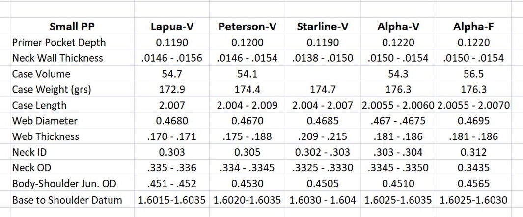

I've tried seating .008 and .010" below flush with a couple different one's and they work, but I just don't get as consistent results. Recently, I decided to actually record this seating depth on my spreadsheet along with the other data and will see what the numbers say over time. :giggle:
See differences in primer pocket depth:
