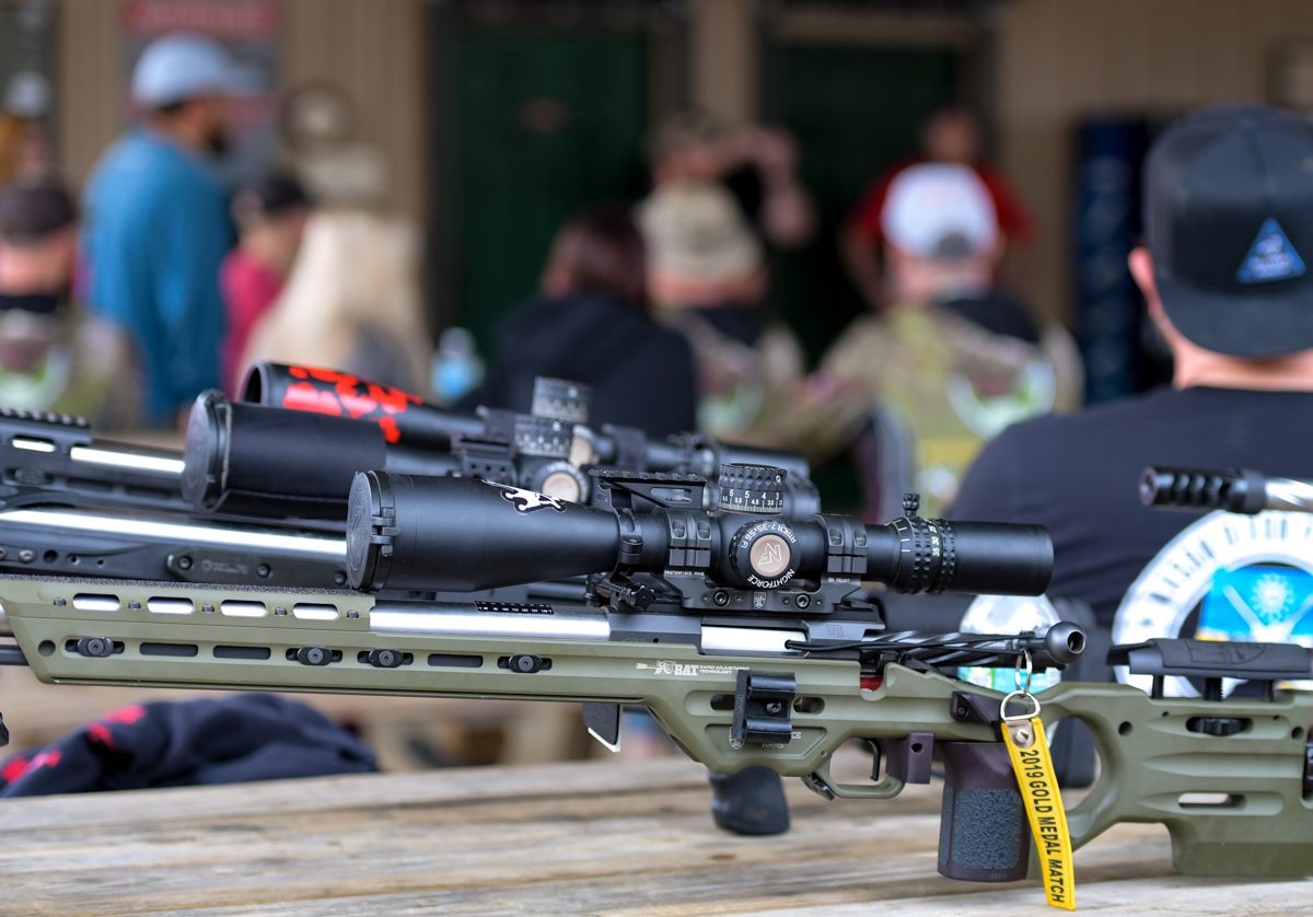

I run an Deadline in a MPA Matrix chassis. Shortened rear action screws and trimmed mag catch. No need to cry about fitment when it takes all of 5 minutes worth of work to drop right in.
Mine runs great with AW mags in 6 creedmoor. It’s got about 700 rounds on it now with 1000s more of dryfiring and it’s super smooth. It does have the updated lighter bolt lift.
Ran it at a two day PRS match a few weeks ago and not one issue.
