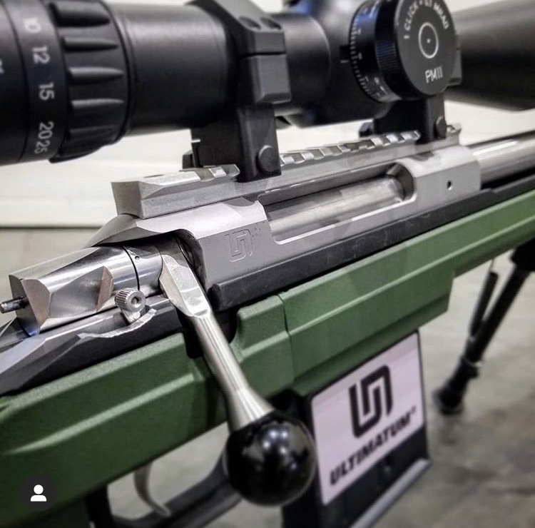

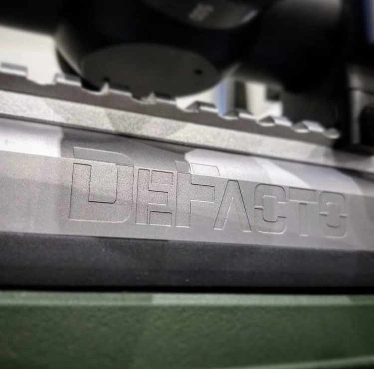

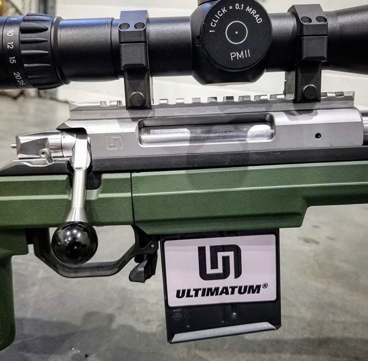

Didn't see this mentioned anywhere here yet, so I thought I would point out that Ultimatum Precision (makers of the Deadline and action for the JP bolt guns) is close to dropping a new action with a Tikka T3 footprint.
Only details so far are from their Instagram, which I'm including below. Since this is in the public domain I assume this is above board, if not I will pull the photos. The text of the post word for word:
Hmmm wait a minute, that's not a Deadline...!? Indeed! That is the first working prototype of our new DeFacto barreled action!
The DeFacto is a 3 lug, solid bolt design, based off of the Tikka T3 foot print.
Just thought I'd give you guys a little sneak peak!
Pricing and release date TBA!
Looks to use the same Tikka bolt handle dovetail (maybe?) which is nice since the aftermarket offerings from Sterk are nice but not cheap something you want to toss with the action.
Also confirmed to use Rem 700 triggers.
Looks like some chassis inletting may be required for some triggers.

Edit: Just noticed the amount of material ground away from the KRG backbone in OP's pictures in order for the safety to work. It's definitely going to require grinding in the trigger well as well.

their IG i believe. same issue with the deadline and the hanger and weird shape.
it's like they learned nothing
pick the Impact/Lonepeak, or Bighorn, or ARC tenon and boom done. hold tight tolerance and easy
Exactly. Always so close yet just off the mark with their design details. It's not exactly difficult to modify, but if you change your mind, any resale value in the chassis takes a hit. The only thing making me consider it right now is the price. If it was the same as the Deadline, it'd be a definite 'miss' for me.
Reactions: kthomas
I don't know why they want to go down their own path, when the road to success has ready been paved and well marked.
Like you say, follow those actions and use their recipe for success. The trend is pre-fit shouldered barrels, ease of use for the end consumer. Ultimatum doesn't have the following for companies to make and stock prefits for them, so why not capitalize on someone else's thread specs so you can use the plethora of prefits already available?
This would also require Ultimatum to hold exacting tolerances, which I'm not sure if they are capable of or not. I've never seen that specific feature of theirs advertised if it does exist.
Beyond that, they've made questionable design decisions that compromises other functions. Like the oversized bolt body, small ejection port, and (initially) super heavy duty bolt lift - I think the original was a 26# bolt lift. It's like they went into it, thinking that current action designs weren't strong and robust enough, and had to come up with a stronger, beefier action. I just don't understand the design ethos.

I've also yet to find any problems with the Tikka lug setup-- it actually has some benefits if you think about it.
I have been thinking, I don't see it. Could you help with a description?
I know a lot of people cut Tikka receivers for a Savage style recoil lug. I don't know the details of that operation but I have done similar on a Savage Axis.
This might make a really nice semi-custom rifle on a decent budget.
If it has an AW cut, a bunch of people will jump on it just for that.
I think a KRG Tikka Bravo chassis is $450 or $500, if the barrelled action is $1,000 and you add a Triggertech Diamond for $200-something, that is pretty cheap if the barrel is good.

well it already comes with a trigger so covered there
if they didnt have the trigger hanger and did a more normal tenon, this would be a fucking smash. but as it is...idk
I gotta be honest, I would be thrilled if someone would just drop a full on replacement bolt for Tikkas, especially given the lack of a Valkyrie bolt face in the lineup.
Yes, 100% agree. If someone that can bring reasonably priced tikka bolts to the market I think would sell pretty well for the guys that want to have tikka switch barrels but I don't know how big that number actually is.
Idk about bolt comment, their bolt design is very close to ai and badger. Are those 2 shitty designs also?
AI has obviously got it figured out, but they build whole systems which have been designed from the factory to work together. Ultimatum makes actions that are designed to mate with other R700 parts, which pretty much all were designed to interface with an action with a 0.695-0.700" bolt diameter. This can be the cause of a lot of feeding frustrations for folk.
AI's don't have feeding issues. Lots of Ultimatums do.
Can't speak for the badger, you don't hear much about them either way. Certainly not near as many complaints about Badgers misfeeding then Ultimatums.
Link to misfeeding ultimatum? I have one, had an origin, both in 6.5prc. The origin had trouble feeding and ejecting. It's gone. Bolt lift on my deadline is heavier than my ae and 2013, but quite a bit lighter than my at. I do have a bix with proper sear height.
